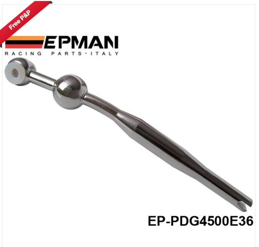

My E30 had the common Gear stick wobble,
Was originally going to replace the whole linkage system/all the bushings, But was finding it hard to get hold of everything in the UK!
So thought I'll try my luck with an £19.99 short shifter off EBay, which had a nylon Bushing.
http://www.ebay.co.uk/itm/261800441320? ... EBIDX%3AIT
The hole for the pin in the nylon bush was to small, so Drilled it out to 10mm, which made the pin a snug fit!
Works great, really responsive and direct, very minimal play
Image[/url]
