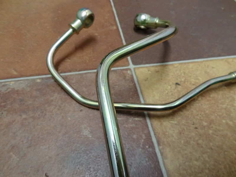

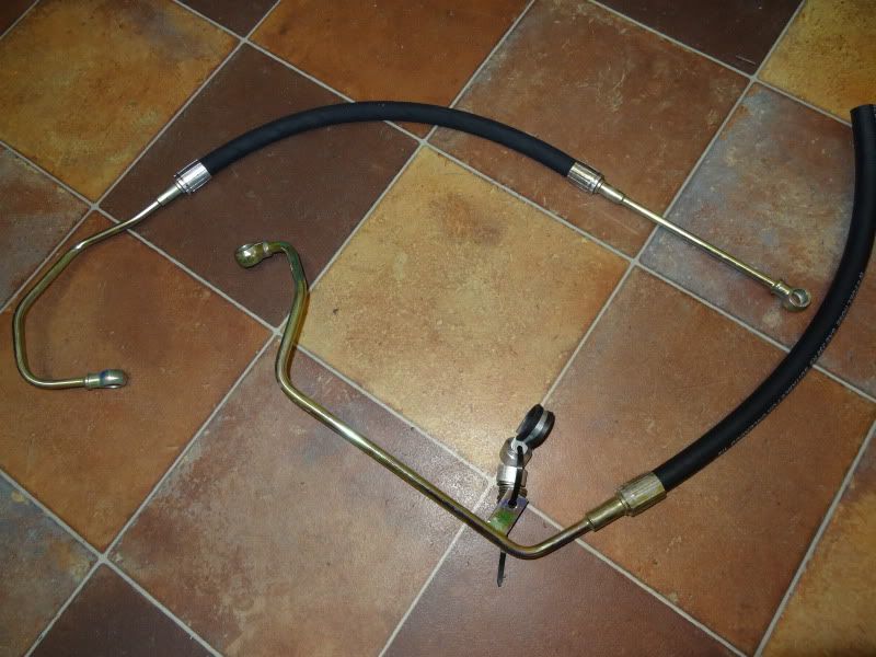

Contact danThe on here. He sells pre made pipes that are really high quality and reasonably priced.

300 euro is more than double the cost of my pipe sets, the problem with hose/braided hose is that they are bulky, so likely to rub somewhere and they also look out of place

Thanks DanThe, didn't think about the aesthetics to be honest...now my opinion is shifting. I'll pm you.
