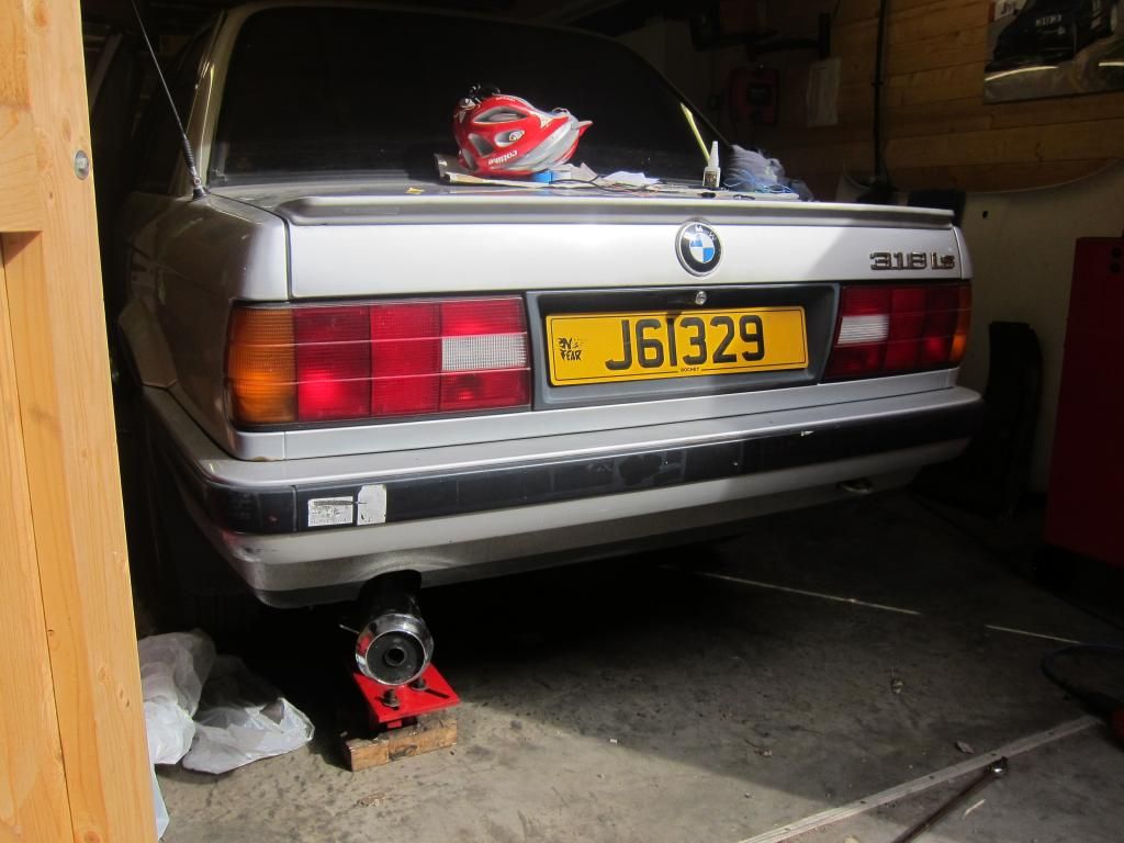

It's been a while since I've spent much time on here having sold my last E30 about 9 years ago to fulfil the childhood dream of owning a Sunbeam Lotus. Actually, that's a lie - I wrapped the E30 around a lamp post quite spectacularly one afternoon. I made a bit of a profit a couple of years into Talbot ownership and have regretted selling ever since, especially when my old car surfaced at Bonham's with a guide price of £25k on it. Let's just say I didn't quite make the £21,250 profit that it now seems I could have done. Oops.
I followed that up by turning to the dark side with a bit of Golf GTi ownership but couldn't resist too long and ended up buying a really tidy E36 328i Sport. Nearly 5 years later I've finally managed to bring myself to part with her for next to nothing and throw money at an E30 instead. Everyone I know has long thrown out all of their E30 spares (which is a painful lesson given how much bits cost now, as I've since discovered) but the shell was too solid to turn down with the only proper rust hole being along the boot shut, so not a big deal. As a bonus, the sunroof tray doesn't sound like a maraca either.

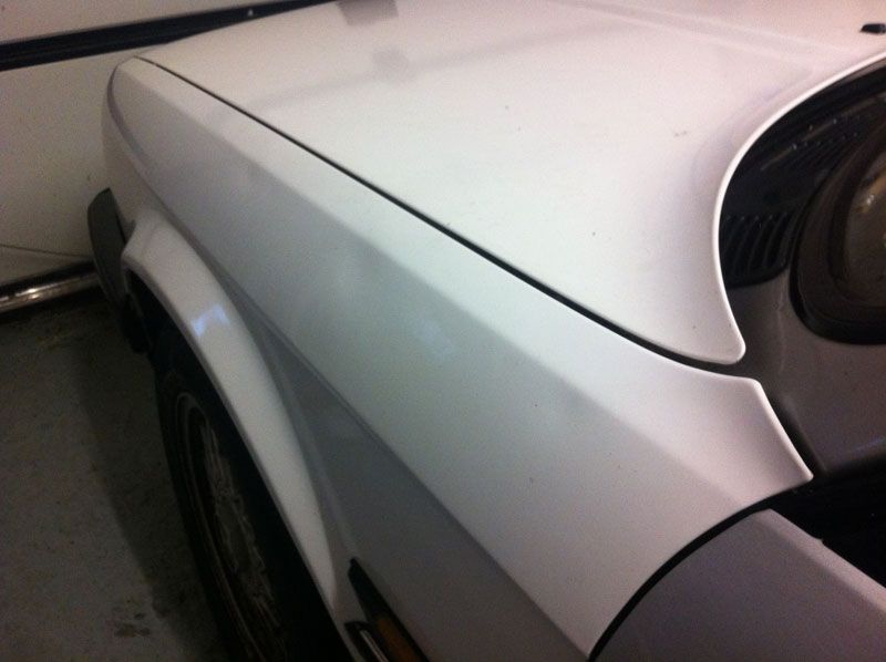

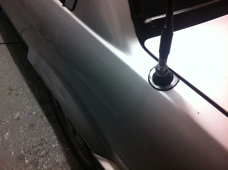

Those of you who are more observant may have noticed that the wings and bonnet are a different colour to the rest of the car and look like a well-used blackboard in a stunning shade of chalky white. It's not bent by any means but there's a small crease in the front sill behind the bumper that'll be pulled out as things progress.
I'm not sure why the previous owner bothered though, as the wings that he used to replace whatever was there before are pretty haggard in any case:

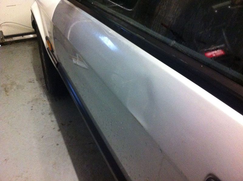

Oh, and the door... An altercation with his uncle's right boot, allegedly:
Other pretty stunning but not game-ending bodges include repairing the probably once rusty aerial hole using a hole cutter, a bit of scrap steel and some Sikaflex. It'll be getting a proper aerial delete when the rest of the small bodywork issues are sorted and she gets a blow over with the spray gun. Let's just say that it looks as if somebody has tried cleaning it with a Brillo pad.
So far, not so bad... But trust me, this is probably going to take a little while.

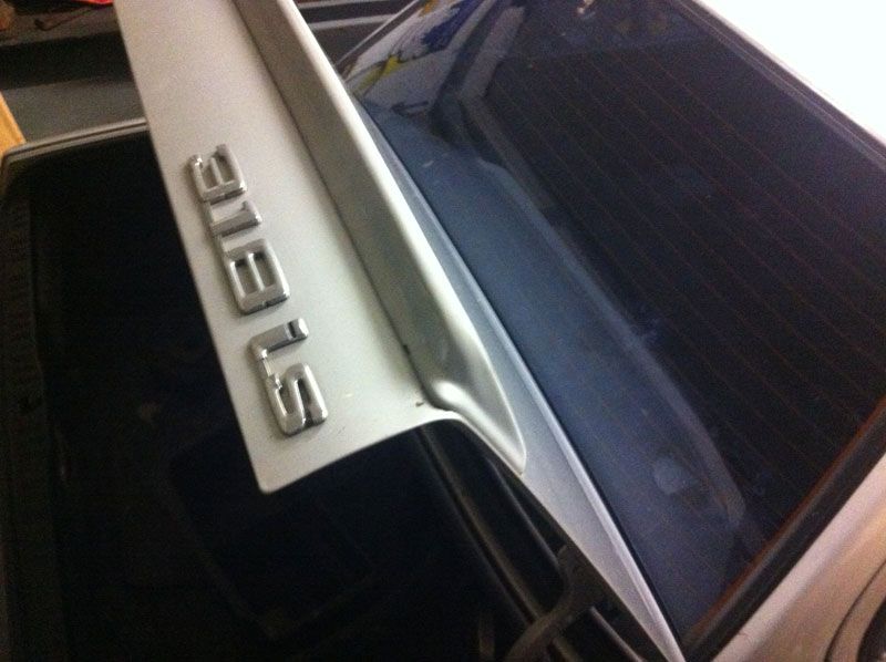

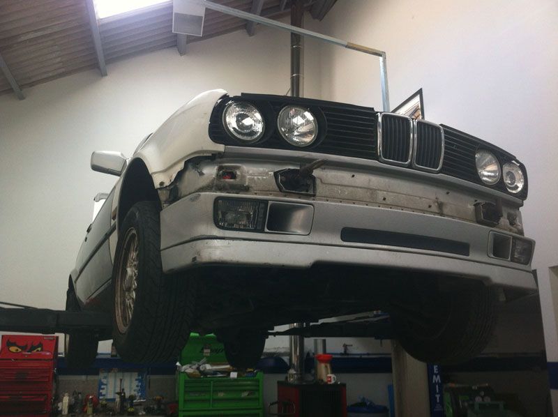

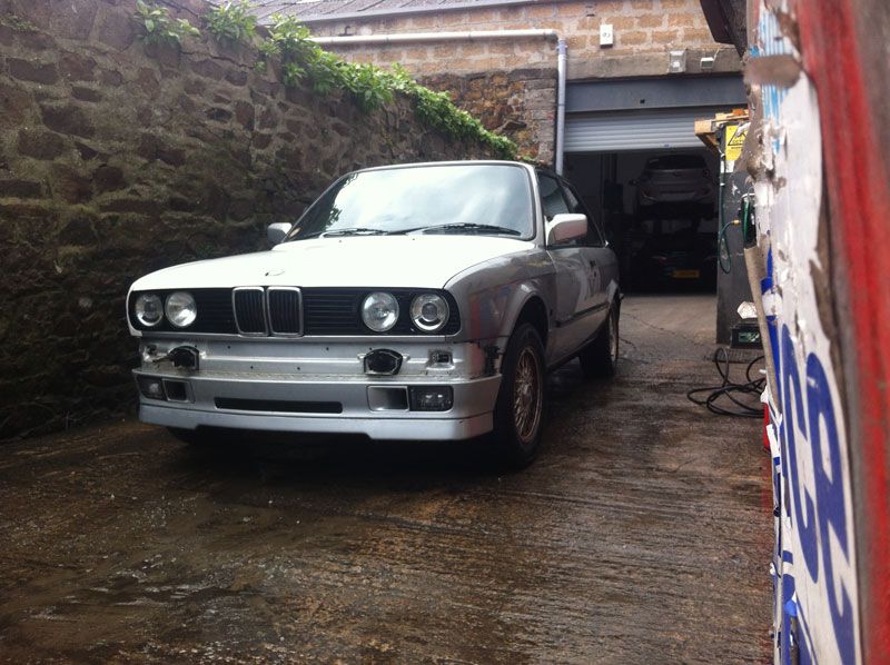

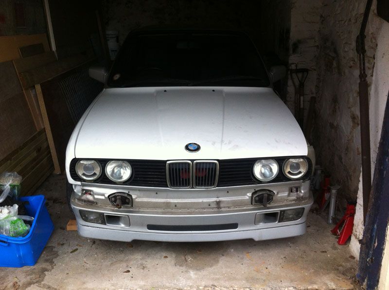

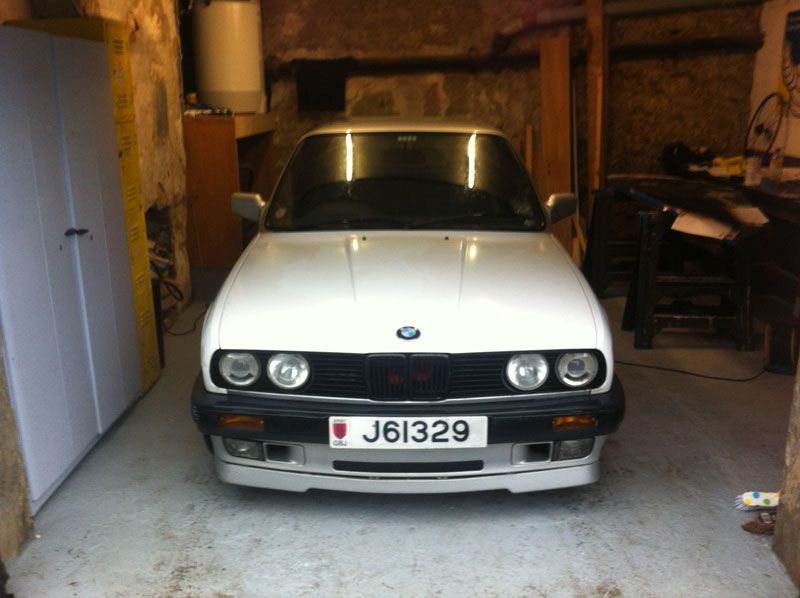

If you've spied the front lip then you'll know just which model this one is. If you're a die-hard purist, you might want to stop reading now because whilst the badge on the bootlid will be staying, the engine won't. I know, there aren't exactly loads of them left (I think we only have 4 over here in Jersey) but it was a solid shell at near the right price (although long gone are the days where you could pick up a half decent 325i for under £100 as I've learnt!) and the M42 was never quite going to cut it for me.
This was the deciding factor though, I've not seen one quite this chocolatey before:
In the meantime I spotted an ad for a pair of wings and set of lowering springs bundled in together locally. Once I'd wiped a bit of the dust from them and realised that they're pretty much spot on I thought it'd be rude not to. As it happened, a few weeks later a wanted ad cropped up looking for some rear lowering springs for an E30 and as I was only after the wings anyway a deal was struck, but my luck hadn't ended there.
Stickers. It was covered in them, which took a good hour and a half to get the worst off. Those ones, irritatingly, are in the numberplate.

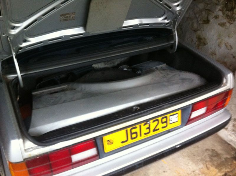

Amusingly, a pair of E30 wings fit in the boot of an E30 with no trouble at all but they couldn't be shoehorned into the back of the E36 when I went to pick them up.
The car came with a load of random trim bits, a grotty rad and a few other bits of treasure stuffed into the boot along with the obligatory 2 litres of water that any E30 that's ever been outside manages to accrue in the rear battery tray (I know, I know, this is a 4 pot so the battery tray is up front but I'm not sure what else to call it apart from sink) but thankfully none of the usual accompanying rot and nobody had drilled any holes in it so it should stay solid for a little while at least. When a mate of mine's E30 was binned fairly spectacularly at a trackday recently with somebody else behind the wheel I donated a few grille bits, one of the dubious wings and a smiley headlamp (I had absolutely no idea that these are now worth a small fortune and that the one in the boot was there with good reason having now noticed that my N/S dipped beam bounces, but in fairness his need was definitely greater than mine) to get it back on the road, which brings me to where we were a few weeks ago:

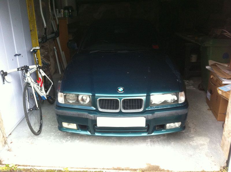

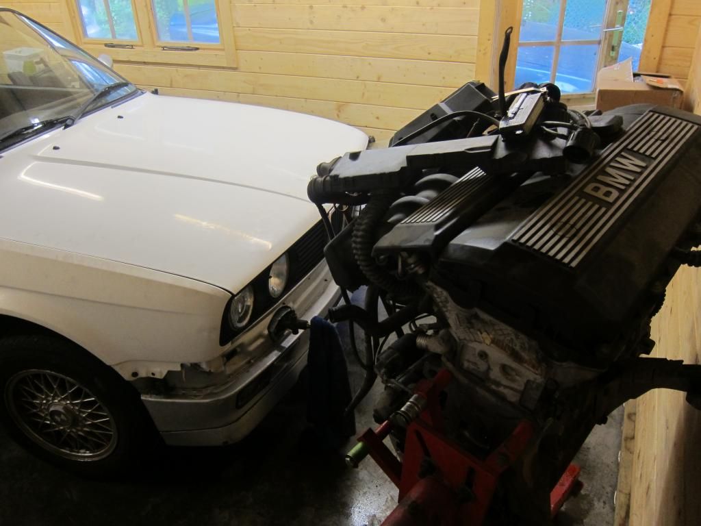

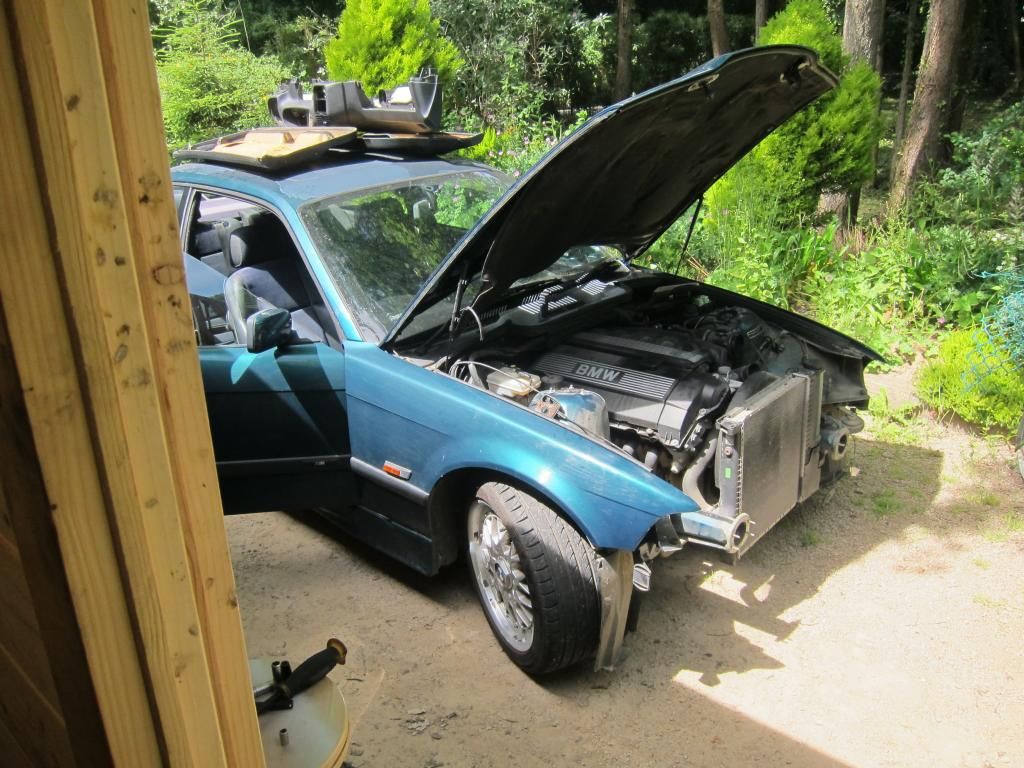

So, engines... I know someone over here who's built an S50 E30 touring and an M62 E30 coupe and was hoping to convince him to part with the touring a while back, but he's pretty set on keeping both. Can you blame him? I can't. The hunt for either an M60 or M62 over here has come up with nothing despite plenty of wanted ads and sticking notes under windscreen wipers and all of the engines over in the UK have intergalactic starship mileages on them compared to what we're used to over here which worries me even though it probably shouldn't.
Having possibly set my sights a little too high at first given that we don't have a great deal of donor cars to choose from kicking about over here and fragging a decent one is also pretty hard no thanks to high postage costs to the UK I've just picked up another 328i Sport to hack around in but it didn't take long to decide it'd be put to better use laying the groundwork for an S54 at a later date by dropping in the M52 and ZF 'box in for now. It probably wouldn't be a bad idea to get the E30 on the road and the much needed space back in the garage, as much as I'm not adverse to cycling everywhere.
The donor is tatty on the outside but mechanically sound with 84k on the clock and new discs, pads and bearings all round so they can come off for a 5-stud conversion at the same time. Plus it's a 1996 so the spare LSD could come in handy one day.

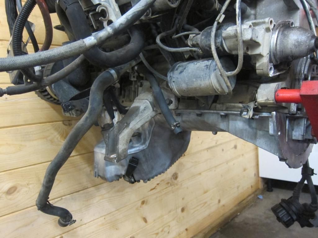

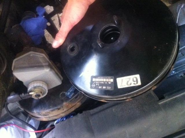

My first hiccup and a word of warning for anyone thinking of an M5X or S5X conversion - I'm guessing that either I haven't been paying enough attentional (highly probable) or most of the threads and wikis I've read were written before the Phase 3 Clio existed. This is because when people recommend a brake servo from a Clio manufactured 2001 onwards they must mean specifically the Phase 2 up to 2006 and before Renault added steroids to the mix because my nice new Clio servo is, well, the same size as the existing E30 one. NEXT!
Oops:

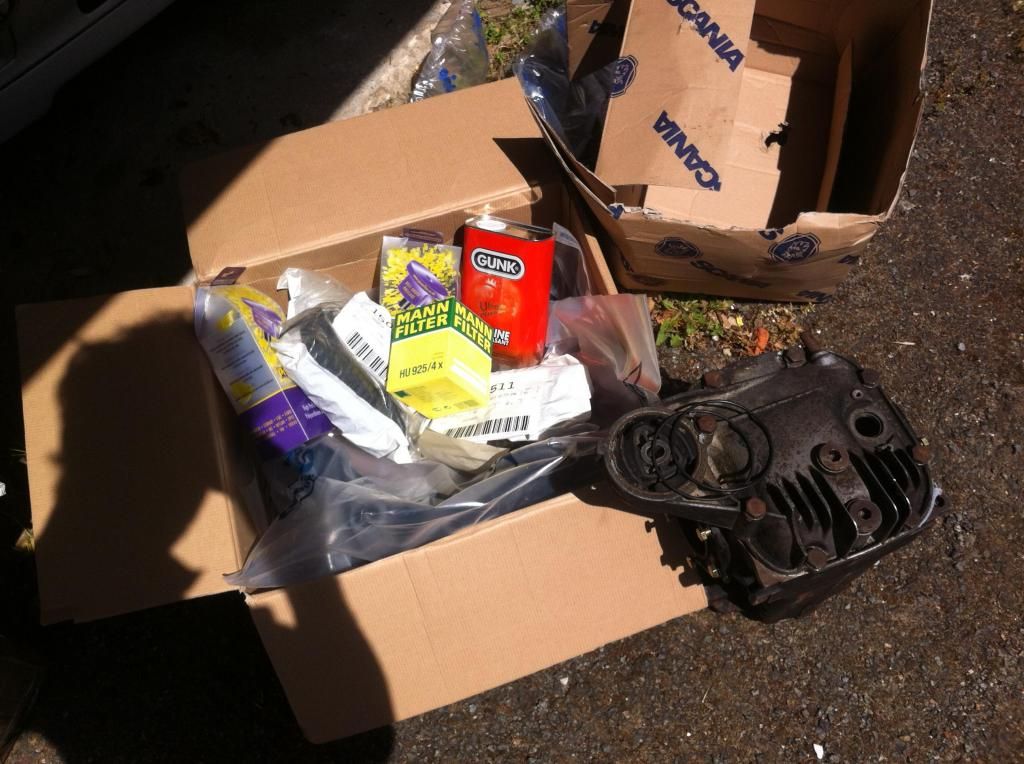

E30 xmas happened when this lot arrived, plus a box of brand-spanking bits from the local stealers a day later:
Managed to find a sump on US eBay what feels like about eight years ago which was meticulously tracked on its voyage across the atlantic thanks to FedEx and USPS. Then it arrived in England, which wasn't too bad until it was passed onto Hermes over here. Mis-delivered, allegedly recovered and even with a phonecall and a couple of emails every day for a week it's still MIA. I'm quietly optimisitc if for no other reason than the integrity of my sanity.

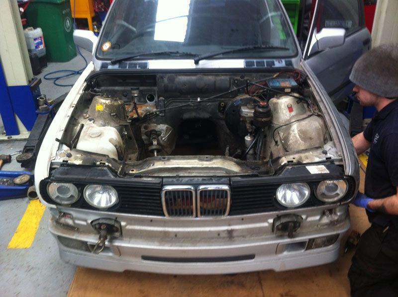

Having given up on trying to understand too much about EWS we started snipping and eliminating wires. Basically, it now takes three pairs of hands to start the car using a combination of conventional key turning and hot-wiring through the window. Today I decided that I'm going to splice it into the harness between the E30 and E36 looms when the M52 is sitting in the E30 and glue the chip to the halo before tucking it under the dash in the tidiest way possible. Job done. Hopefully.

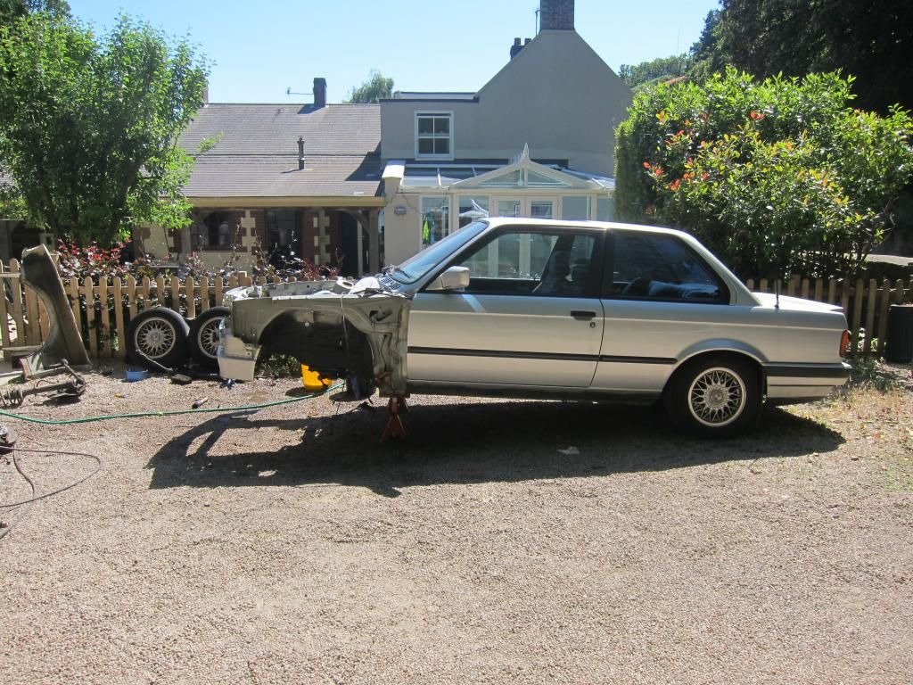

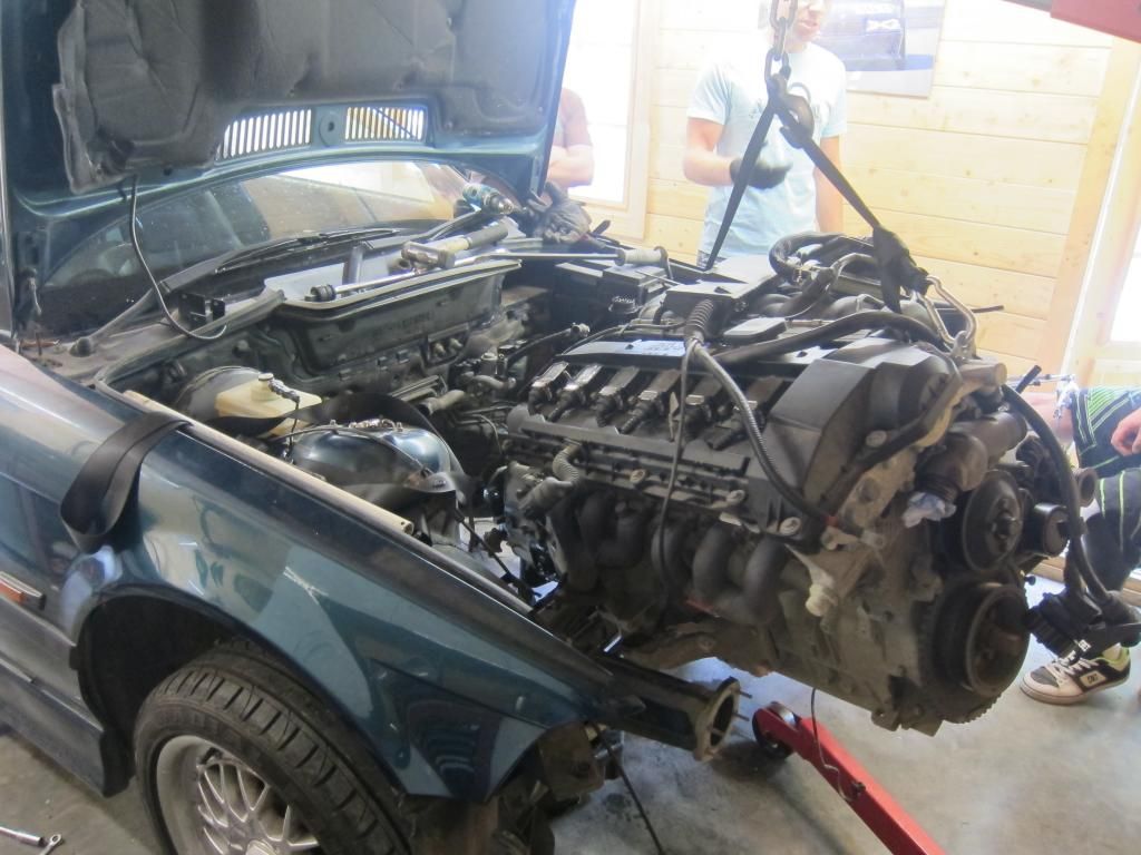

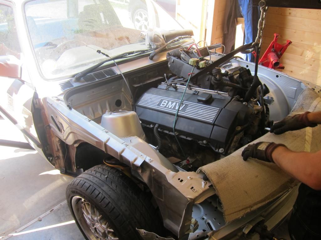

This Saturday? Engine out, E36 fragged to oblivion, have a couple of pints before the sun goes down. Optimistic? Probably.

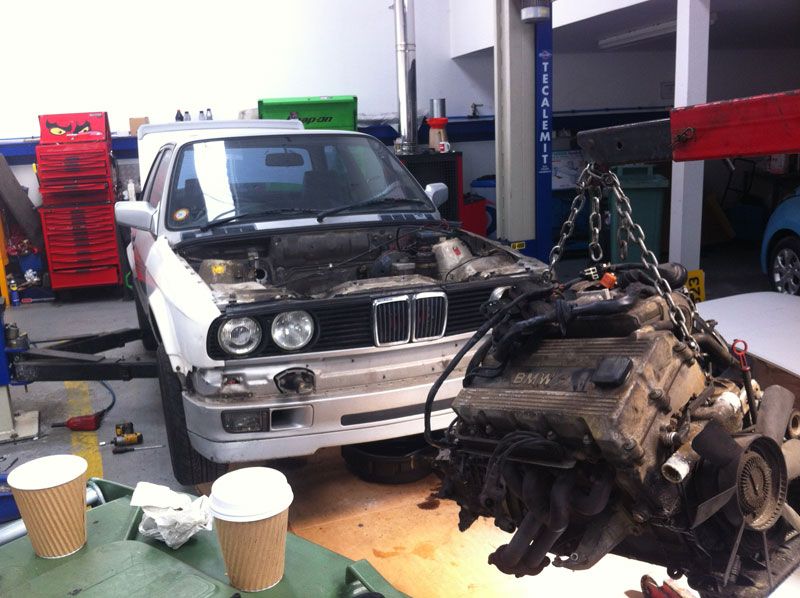

So, after wrestling an exhaust off whole when the centre section bolts decided to disintegrate enough to stop me removing them but not enough to make splitting the exhaust possible and spilling a mix of petrol, coolant and PAS fluid on the garage floor we got the M52 out in one piece without breaking anything. Not one pipe or cable was left connected. Pats on the back all around.

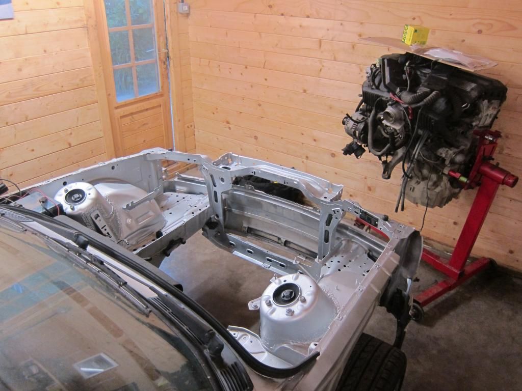

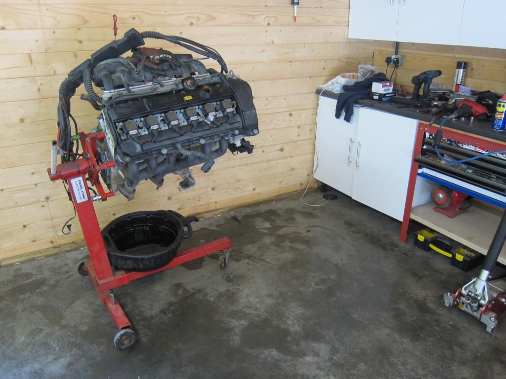

The dual-mass flywheel has seen better days so I'm considering a lightweight S5X one as a replacement but know somebody who has a decent dual-mass sitting in his shed collecting dust so might put that in for now. I don't want to regret not going for it whilst the engine is out though. We'll see...
With everything on the stand it was time to collect the E30 from mine...
Luckily, one of the lads brought this along which made life easier:
Time to get her pushed in and have a bit of a tidy up. You know you're balls deep into a project when you have this much crap inside a garage that isn't yours as well as a car parked outside packed in pieces and full of bits. Must photograph and sell some stuff this week. Anyone after a small case E30 diff or some E36 spares?!
We were optimistically going to swap the sump over (it took less time for it to get from California to Jersey harbour than it did to get from Jersey harbour to my house, which is no more than a mile away - cheers for that Hermes) but it was getting late so we had a cider instead. I've decided to take a day off this week to try and get the engine bay in the E30 fully stripped, cleaned off and painted ahead of the weekend so we can try and drop the engine and gearbox in and get the new front end built up and fitted with the Z3 rack and Corsa linkage. Then the wiring fun can begin.

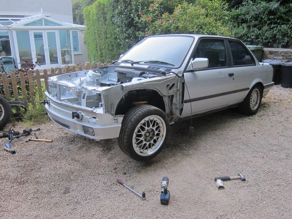

It's said that a picture paints a thousand words, so here are about a thousand pictures. Everybody loves pictures. Yesterday we managed to get a couple of jobs done...

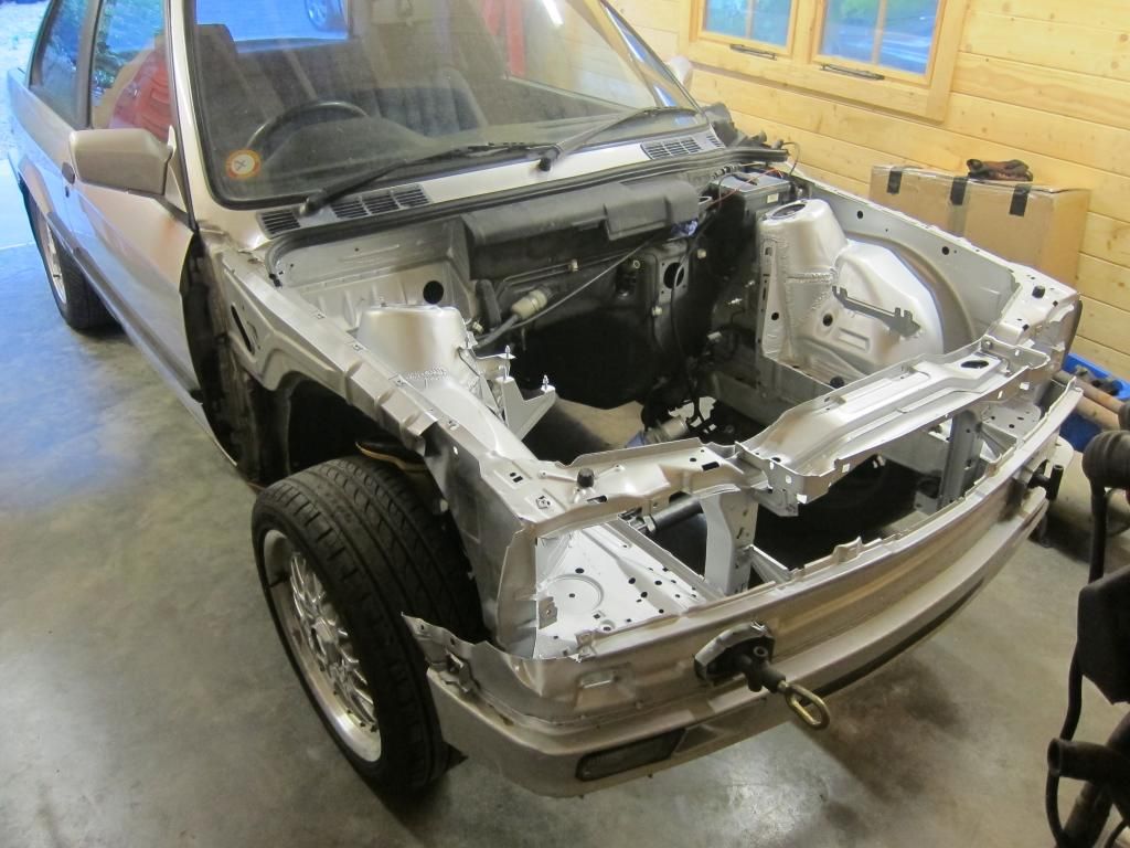

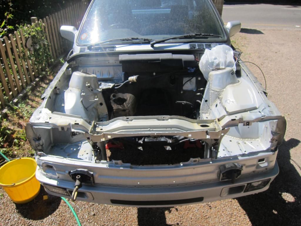

Front end panels and trim stripped:

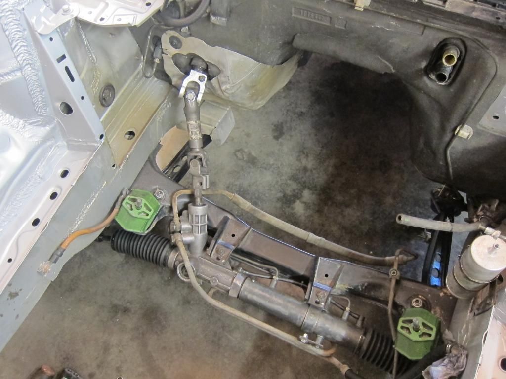

Goodbye dogging old E30 suspension, arms and steering rack:

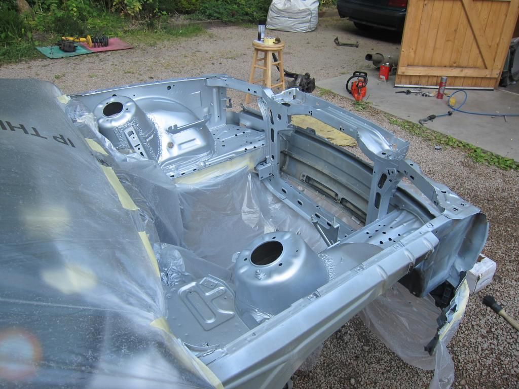

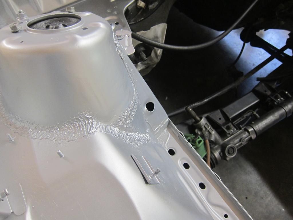

Cleaned and degreased the engine bay. Gunk is incredible, but even thinners couldn't remove some of the 23 year old yellowed lacquer that the local stealers decided, in their infinite wisdom, to soak brand new BMW engine bays in during the mid nineties:
So this happened:
Much better:
Hello new Lemforder arms, Powerflex eccentric bushes, E36 Billies (a temporary measure so that the car can roll in and out of the garage until the coilovers arrive), 328i brakes and calipers, brand new tie rods and track rod ends and the Z3 steering rack (still needs a spacer machining or a trillion washers and the Corsa linkage building up). I reckon the BBS RC041s are going to look better than expected when it's all finished too:

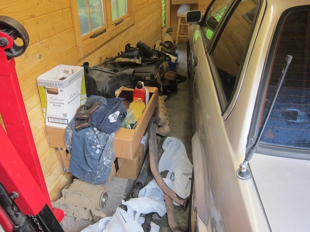

Shed tidied and E30 tucked back inside for the night:
Just a couple of jobs to tidy up now before this goes in, hopefully tomorrow:

Alas, the M52 is still sitting on the stand but I've swapped the sump and pickup, added a few dabs of silicon, positioned a new gasket and torqued up all of the bolts, losing only one of them to the cover on top of the inlet manifold (as the engine was upside down at the time).

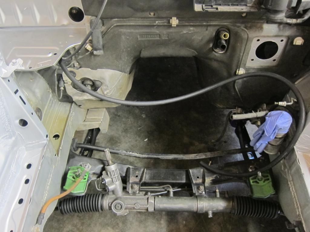

The steering rack is now also spaced perfectly thanks to a generous handful of M10 washers (completely didn't consider that we'll need to fit the new steering linkage first though, standard idiocy there) and the engine mounts in place to (hopefully) receive the M52 sometime soon.

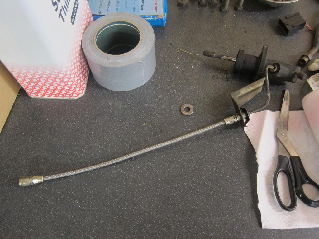

Tris also knocked me up a braided line for the clutch slave cylinder and removed the CDV from the line taken from the 328i. Cheers for that mate!

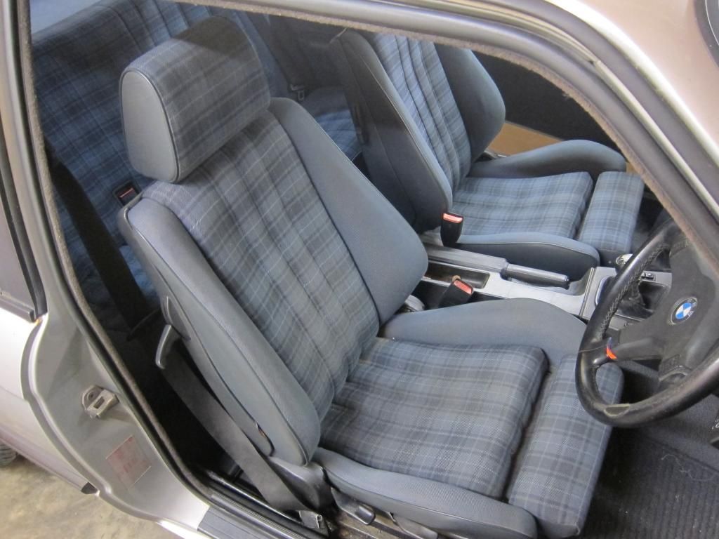

I'll try my best! Here's one of the interior which, along with the entire bodyshell not having been devoured by tinworm was another selling point when I went to see the car. The M-tech 1 wheel could do with a re-trim though, not sure if I'll keep that as much as I do like it.

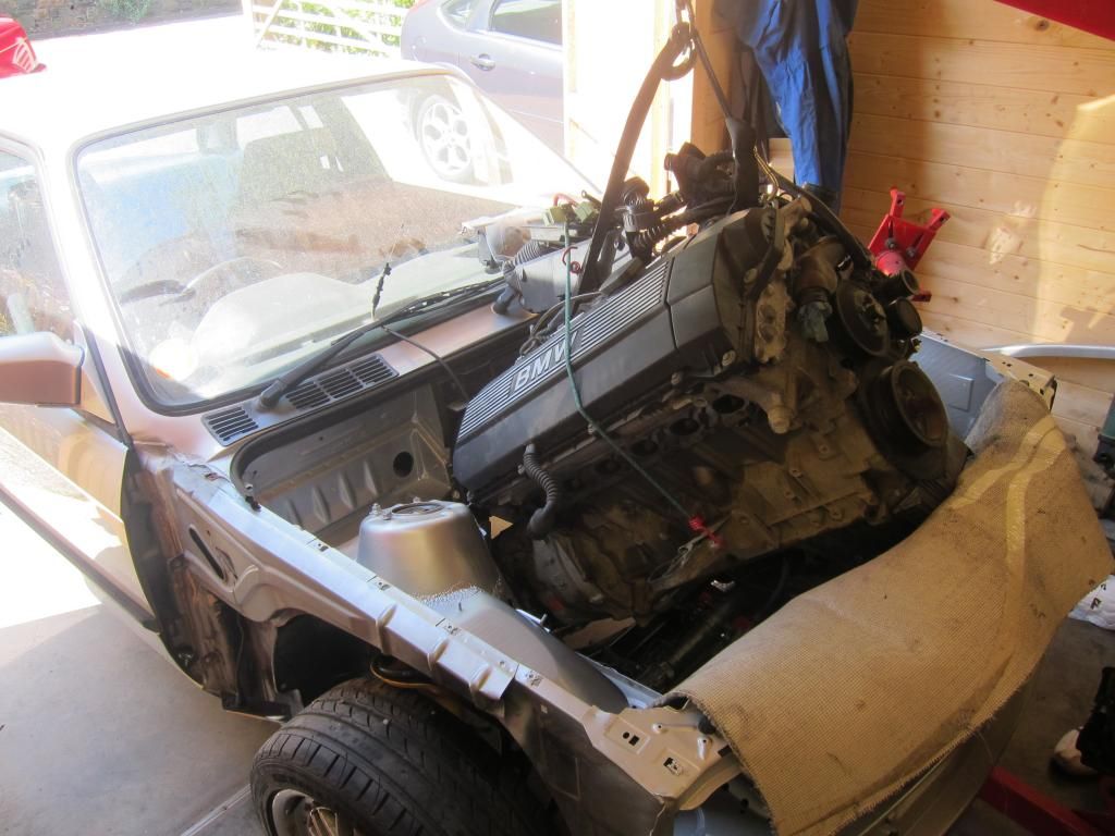

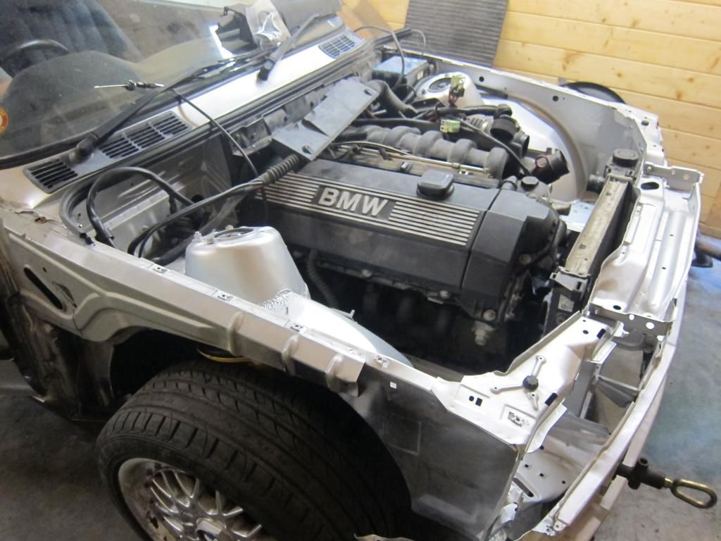

Monday off work + 3 pairs of hands = a much heavier E30.
PAS pipes from the E36 fitted to the Z3 rack including small bracket made to attach front side hoses to fixing point and after a lot of head scratching, tapping, vice squeezing, winding and pressing back and forth and one knackered set of roller bearings in the dismantled and reassembled UJ we nailed it (cheers Tris!) getting the Corsa linkage in. Oh, and some drilling too.

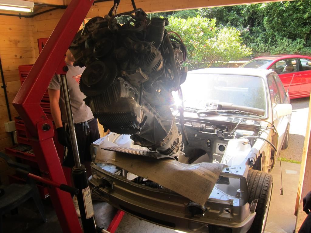

The main event (eventually, after a bit of fiddling with engine mount positioning...). It's a good job we had the use of a gigantic engine crane:
Simple as that.

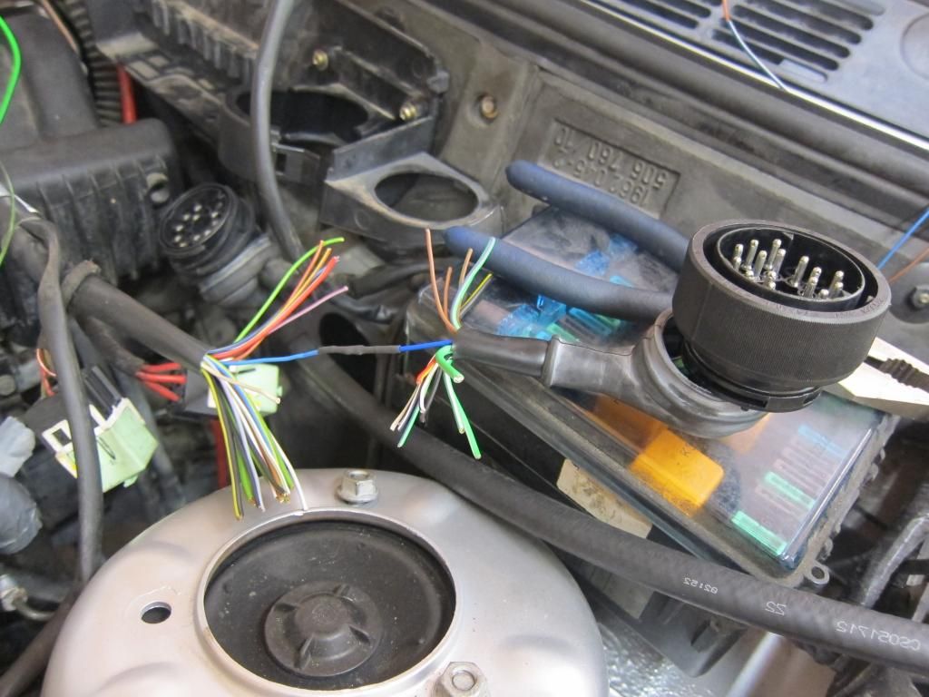

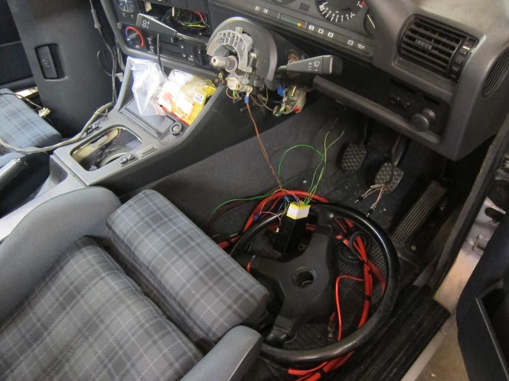

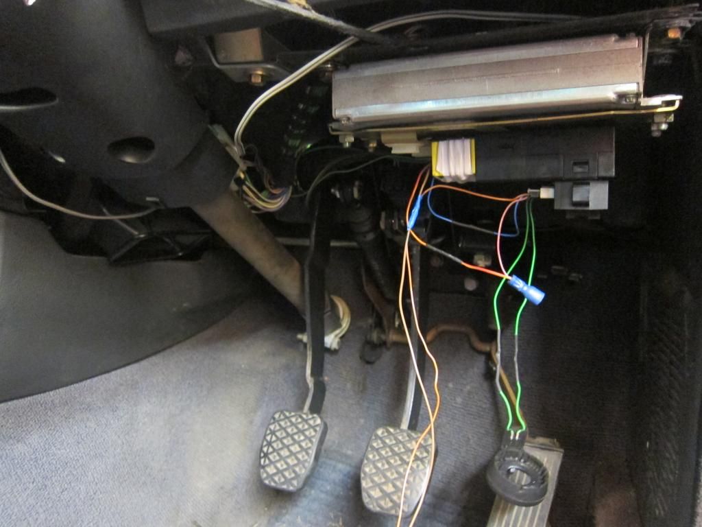

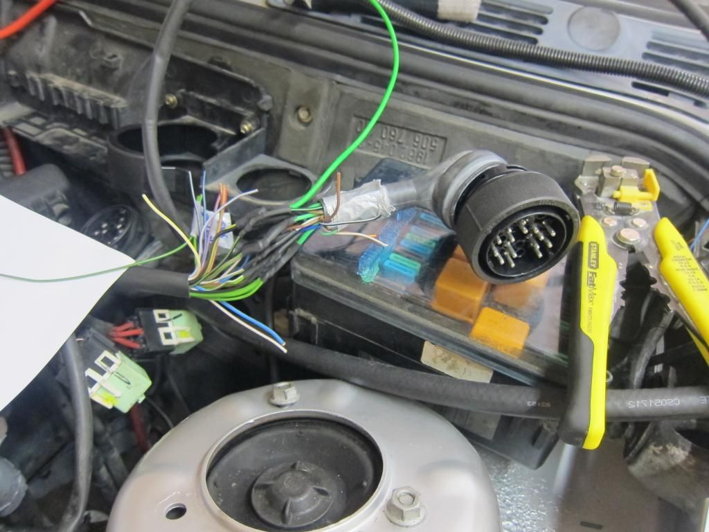

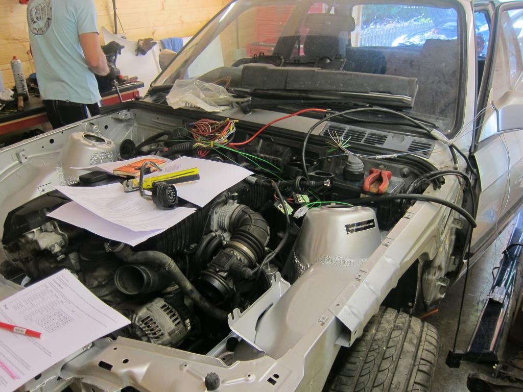

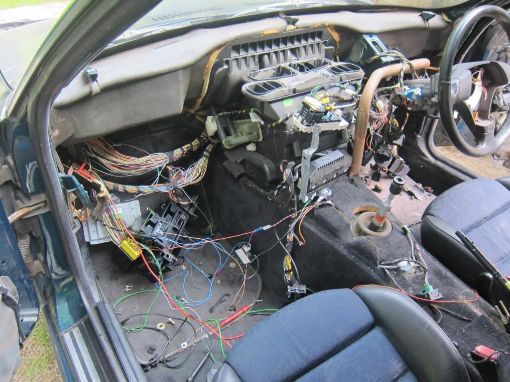

So, I started attacking the wiring this weekend after managing to tick off a few smaller jobs and start trying to get my head around it all on Thursday evening. Rather than try making an X20-C101 adapter harness after I saw how little space there is to play with behind the plastic cover at the back of the engine bay I cracked and decided that if it's good enough for 90% of E30 owners it'll be good enough for me. Yep, out came the side-cutters and off came the X20.

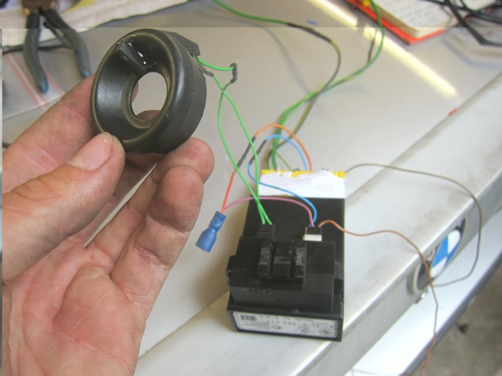

Before all of that happened though, I decided to shorten and tidy up the EWS wiring, break open a key to retrieve the chip and used a liberal amount of glue to attach it to the halo before using a bit of trusty double sided tape to attach it to the underside of the ECU cradle. Which lasted about 12 minutes.
Then came the science bit:
We were about to hook up the fuel lines, double check everything and temporarily wire in the ground, live and crank wires for the EWS module now tucked under the dash to check that it'll actually work but realised that we were starting to rush things and that it was probably better to enjoy a cold one before the sun disappeared and crack on again next week than set the garage alight / fry the ECU / something else fairly terrible.
In other news, at least one of my friends is an absolute clown and rigged me up this beauty as a surprise. Nice.

I'm not sure whether my ballsiness tackling the wiring will pay off but we'll soon see... I'm going to dig out a couple of fire extinguishers just in case!
I've seen examples of the halo fitted to an E30 ignition barrel and it did look nice but if I recall correctly there is a bit of cutting necessary to the column which isn't ideal given how much E30 parts set you back these days! I figured being able to get rid of the lot when I upgrade the engine in a year or so (that's the plan, anyway) could be an advantage. I'm just hoping I've managed to connect it all up correctly!
