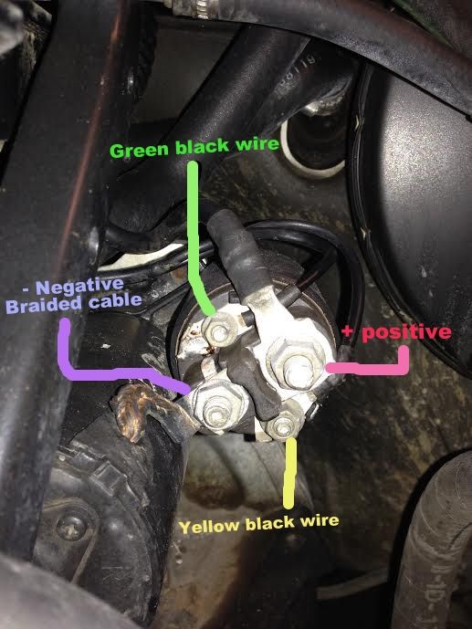

Picture of the wiring on the starter.....
When I bridge the -Neg to +Pos with a screw drive I get a single click.
When I bridge Yellow/black to +pos I get a single click.
Same as I bridge pic11 and 14 in the diagnostic plug.

The cable you marked as "negative braided cable" is actually the input to the starter motor itself; the other side of the starter motor goes to ground on the motor body itself.
This "braided" wire should be insulated from the starter motor body....your picture looks like the insulation is a bit ragged?
When you bridge that braided cable to the thick positive cable you should be applying +12 volts straight to the starter motor and you would expect it to run continously but without engaging the flywheel....this is what the large contact inside the solenoid normally does but at the same time the solenoid swings out the small pinion gear to engage the flywheel.
So either the starter motor is not grounded properly ie. the grounding cable going from engine to chassis is not working properly or the starter motor is not bolted cleanly to the bellhousing or the negative lead of the battery is not going to the chassis properly or your starter motor is burnt out.
Or the "braided" cable is shorting directly to the starter motor housing.
Try use the black portion of a jumper cable to connect the negative side of the battery onto a good clean bolt on the engine itself...preferably the mounting point of the engine grounding cable....you should find this on the drivers side of the engine under the exhaust pipes on the M40, or clamp this jumper lead direct onto the body of the starter motor. Then see what happens if you bridge the Black/Yellow wire to + 12 volts. :?

Ok so I put a jumper lead from the negative on the battery to the engine lify hook turned the key and the car started..... :D
So its a earthing problem then.... But where are they on the m40?
