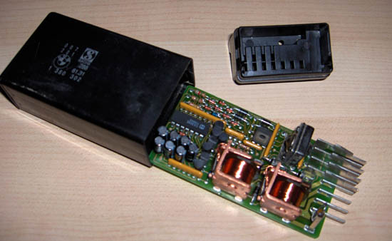

Is all this locking/unlocking totally unassisted by the central locking? I.e. The central locking is completely dead?
Assuming the answer to both the above is "yes", slide the circuit board out, as shown in the pic., look for signs of water damage, and check the component that is right at the bottom corner of the pic. Is the little metal blade up the side attached to the top of the component or sprung back from it?
