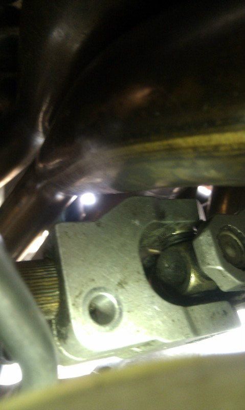

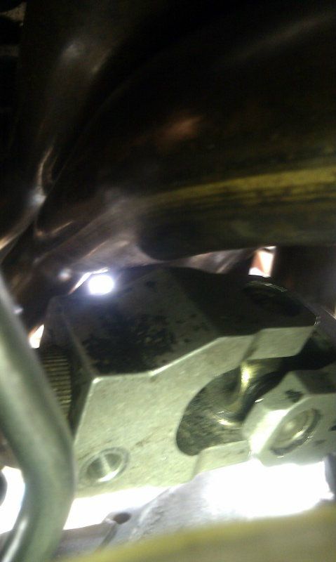

Finally getting my car back together and today was the day the engine went back in on the refurbished subframe with the E36 steering rack fitted.
As most of you already know there are clearance issues when using a BTB2 manifold and any non E30 steering rack. As my donor car came with the manifold and i was given an E36 rack i decided to try the following after reading Andy's Restoration Bible.
So what I've done is use one of Dan's custom steering linkages and then followed Andy's advice with regards two lefthand E28 M5 engine mounts to move the engine over slightly to the nearside and also lifting the engine up higher.
The clearance is still only a small amount and I'm not able to drive the car yet to make sure it's still OK under cornering. I'm also hoping that with the full exhaust system fitted the manifold will get pulled in towards the engine and away from the linkage a bit more as only the crosspipe is fitted in the below pics;
Only slight issue I've come across so far is that the engine mounts lift the engine quite a bit and the top of the throttle body catches the foam on the bonnet so i think that's going to wreck my chances of fitting a 325e bonnet liner and result in me having to cut a hole in the stick on insulation when i come to change that.

That looks to tight to me. I reckon that will touch under hard left hand cornering.

That looks pretty close. You could take a bit off of the corners of the coupling though if needs be...

Yea, I am half expecting it to do that to be honest. I was looking at the corners while I was under the car and thinking along the same lines as Jon's suggestion, taking the corners off.
Can you get poly E28 M5 mounts? Maybe they would be an option and hold the engine better in the corners.

Could get a couple of mm machined off the UJ to give you a bit more clearance ?

UJ slimming is definitely an option. I'm sure i can make this work properly somehow as a BTB3 isn't an option I've got any intention of taking.

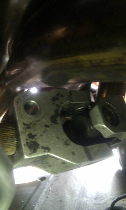

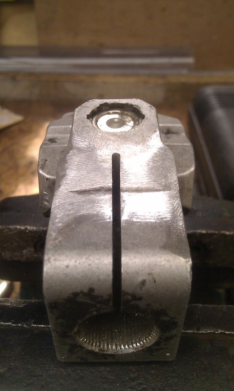

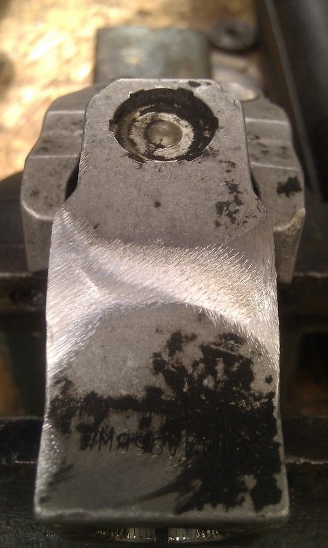

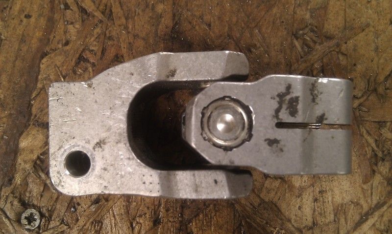

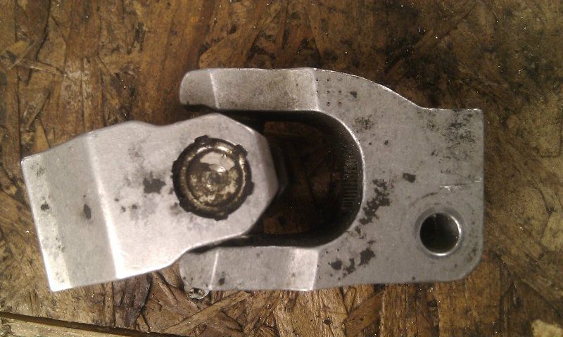

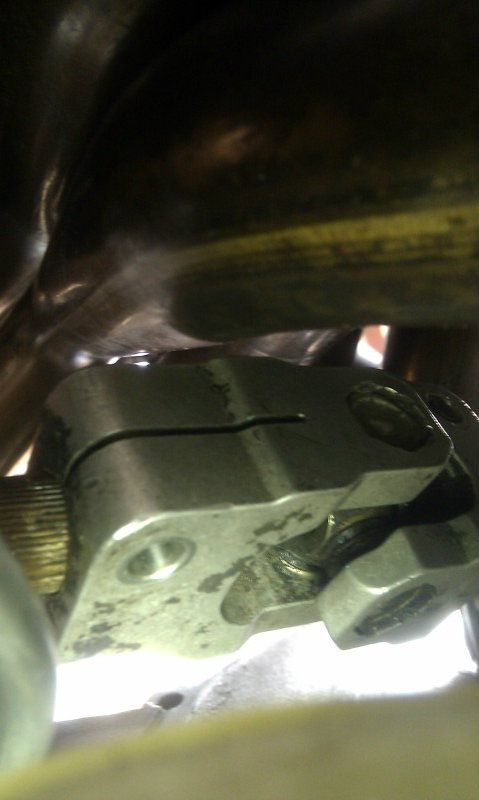

Shaved the edges off the bottom UJ, it's probably doubled the clearance. I did take some pics looking up at it in place but they don't really show any clear difference.

Was just researching on rack swaps and dug this up.. How much more clearance did you get in the end from filing the edges off o the UJ?

Sun Oct 14, 2012 7:08 pm
I'd say about 3-5mm. Not really enough to stop me still considering having the BTB2 modified to BTB3 spec.
