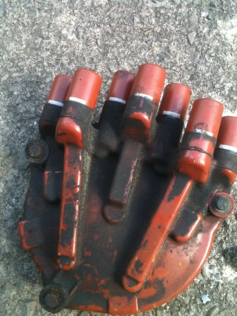

Got a M20 engine (325i) out of a 1989 car.
Whats the order on the leads?
Firing order is 1 - 5 - 3 - 6 - 2 - 4 .. is that correct?
With cylinder 1 being at the front of the car.
But what I dont know is where the leads go on the distributor cap, as I have 7 leads coming out the lead rail.
I can work out which lead goes to which cylinder ..
So what order does the leads go onto the distributor cap?
This is the cap I have ..
and yes I know I should have marked it before I removed it
Thanks in advance

My Haynes manual has it down as:
---------4-----coil------1
----2-------6--------3-------5

Perfect!! Thanks Alot :D
