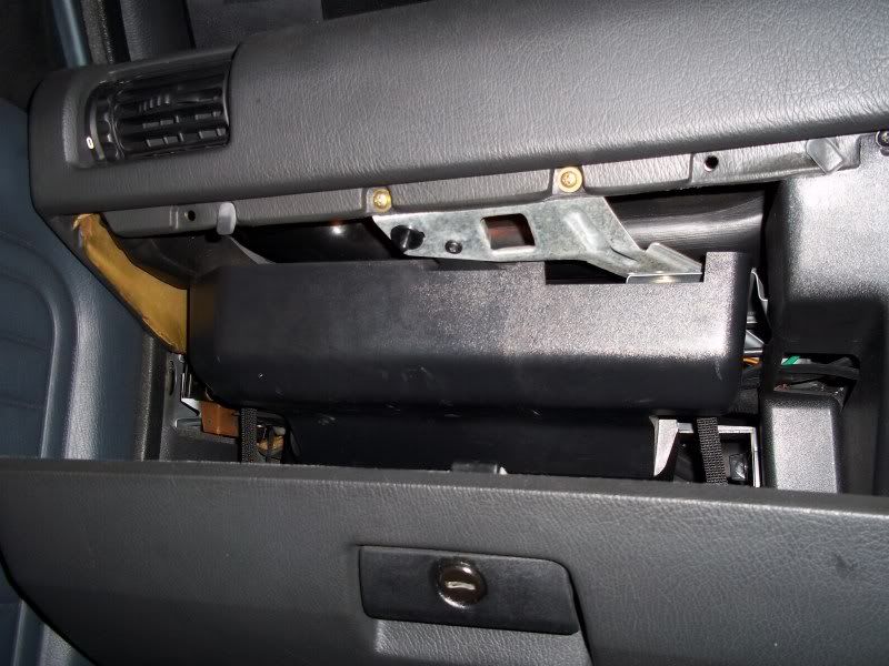

Can anyone show me a picture of the Glove box light and where it should be? Mine doesn't even seem to have a fitting for a light, let alone any wiring.

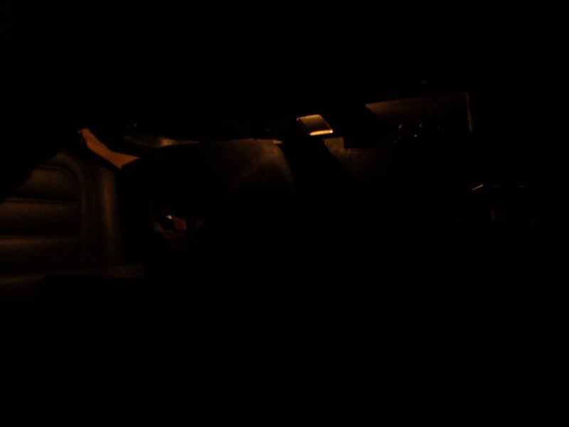

Just had a quick look at mine and the light seems to be above the plastic cover near where the latch goes - surprised it actually works as mentioned above 9 times out of 10 they're disconnected.
I took some pics but it would be better to remove the plastic cover first

number 3
slots into a round hole in a metal plate inside and above the glove box

I couldn't find that plate in the parts catalogue anywhere!

If that helps :?
