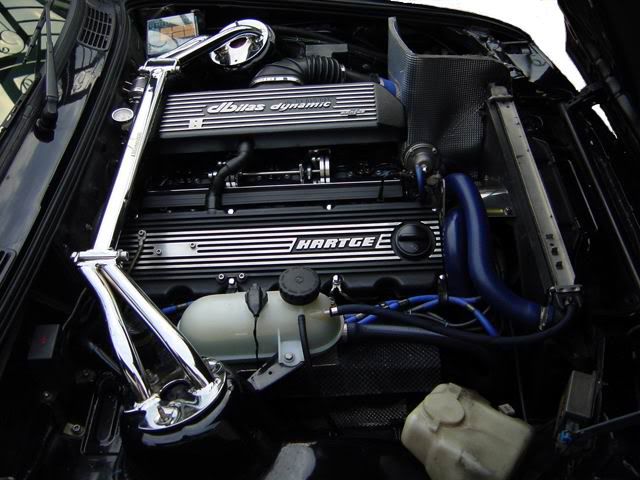

I almost did the Dbilas thing, they aren't cheap and anyone that has done this has never got any gains ?
looks awesome in the bay !
the cheaper and better option would be the M52

Aloha,
My apoligies for resurrecting old post, but...
- has anyone purchased dbilas chips for their itb setups ?
- or, ran a dbTronic 4500 ecu unit ?
I'm yet to read an itb built that was finished with dbilas chip, maybe that's why it feels flat at certain rpm's ?
their catalouge claims 250hp's from a stage 2 m20 2.7 (stroker I assume)
compared to their 220hp's from stage 4 m20b25 set-up.
I like my engine as n/a and debating on ms3 or dbTronic's ecu for alpha tuning.
current setup ... http://www.bimmerfest.com/forums/pictur ... reid=30662
- m20b25
- Miller MAF (3 inch housing) and WAR chip
- 45mm dbilas itb's
- 5.5kg's / 11lbs flywheel
- RD headers
- Cat replaced with resonators
- Supersprint muffler
I too like the idea of adjustable lenght runners and experimented with plastic PVC piping and made a koo-koo intake, car ran fine with it, nothing fancy and just to reasure me that plenum could be built around oem brake booster setup.
- clearance video...
- system running ...
Last week modified a csl type cf airbox for it to clear brake booster and it did, now I'll install a remote reservoir (750iL) for brake fluid., need it for clearance.
cheers and stay warm.
