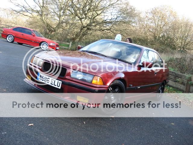

You've all seen my old black bmw with the BBS's in the newbie thread 21 with a 2,8 powerplant and how I got into owning this car:
