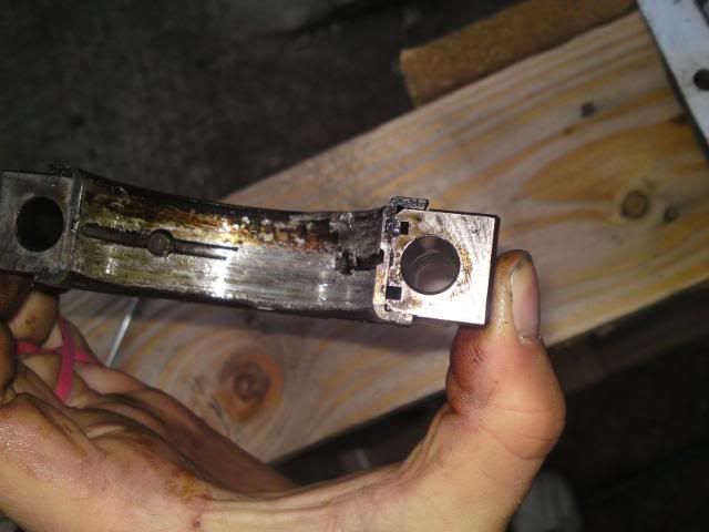

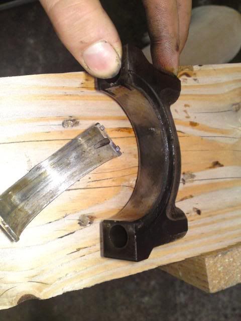

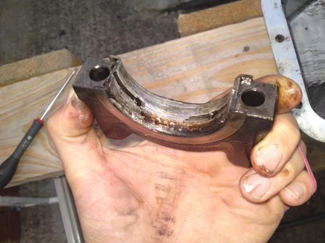

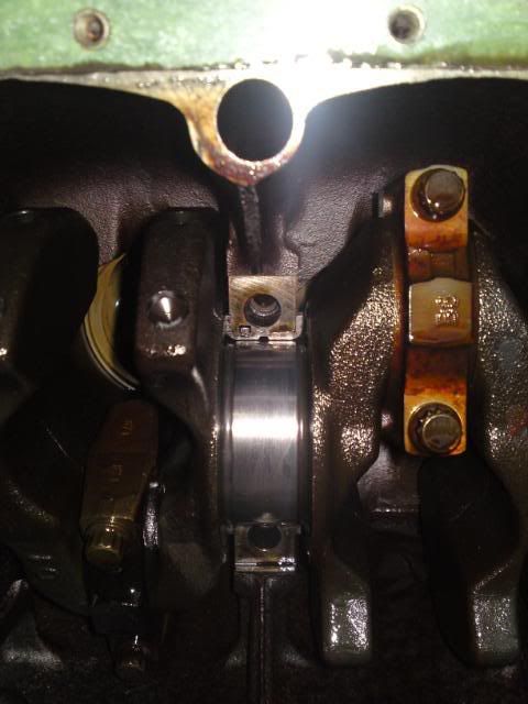

Small update, just bin outside and stripped a fubared M42 i had laying around to see what the set up was.
Result the groove/recess one the cap is on booth halfs so i just need to machine a new tang in it, few pics
Totaly shagged shell
oil was black with white metal in it

That is not shagged matt, you should see some I took out of a mates mi16 that had spun!

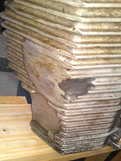

appletree
- Posts: 3479
- Joined: Fri Jan 20, 2006 11:00 pm
- Location: Retford

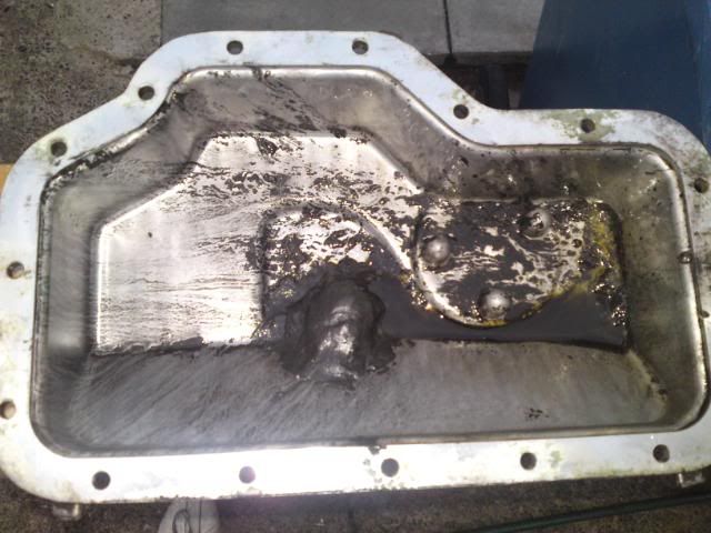

lol well these shells arnt exactly brilliant, looks as though the sump may have had an argument with a kurb and lost! so its probably ran with no oil in for a bit, until some ruff c**t filled the hole up with liquid metal!
not a pritty sight.
This area should be flat.
Good news is ive managed to get the other half of the shell out with the thrust surface on and it fits the cap half perfect minus the tang so it is just the tang slot in the cap that needs to be modded which i can do easy peasy
Not a happy shell
Not a happy shell
