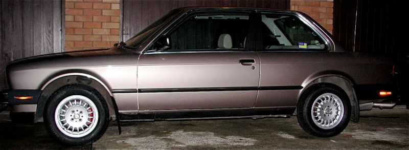

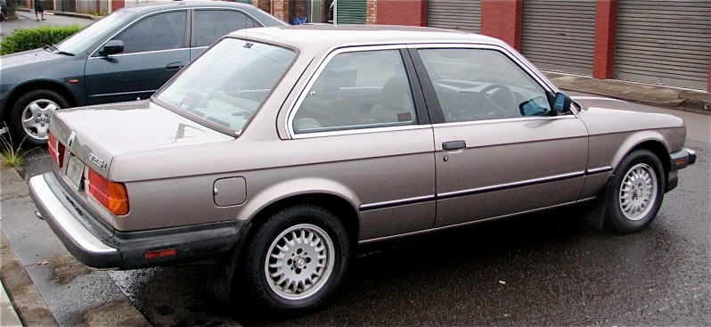

This is my first E30, its a 1987 325e despite what the badges say. it has 167000Mls or101000Kms, im the 3rd owner and it was originally a USA car. Wipers are still on the wrong side but thats about it... Need to fix the windows but thats all the faults on it. Car is in bloody good nick isnt it?

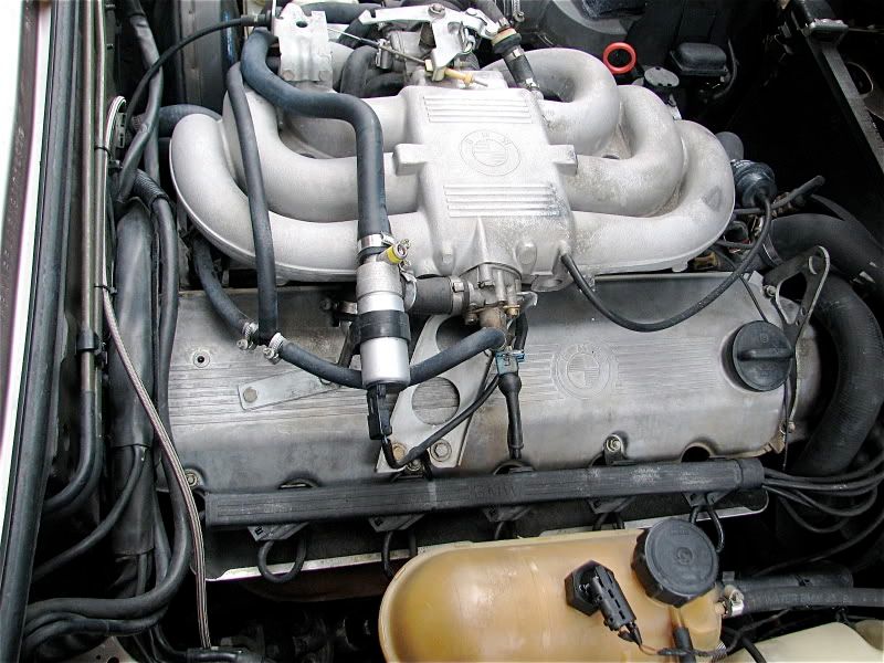

The first few pics are of the engine bay when I first got it. Now after about 10 de-greasings and a bit of a steam clean it looks like the following few pics. The car originaly had a pin stripe but it was cracked and broken so that was quickly removed, Then I had to give it a buff and a swirl remove. It will do for now until I have time to paint it. The bottle tops however are abit shabby and they need a good painting.

Very smart! That eta manifold is very different.Can you see if the wiring loom waas swapped for the LHD/RHD conversion? Wipers are tricky,LHD mounts on a single stud in the scuttle that is not quite in the correct place,so you need to create all three mounts,plus one for the linkage on the r/h side,it's a dash out job to do it neatly!Plus you need a different motor,support,linkage,wiper arms and scuttle vents.

Anyone know if the eta manifold is any good? Seems much bigger the 325I manifold... Will swap the top of the motor over to the 325I stuff later to get a 327I.

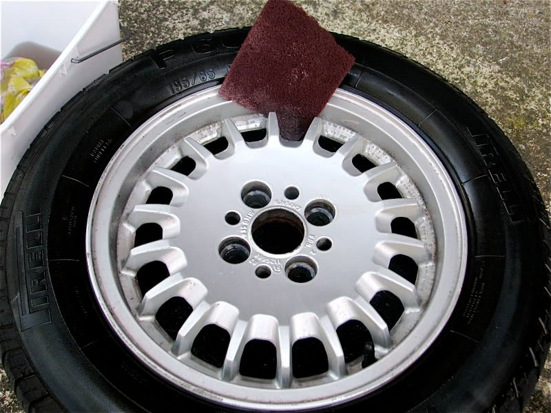

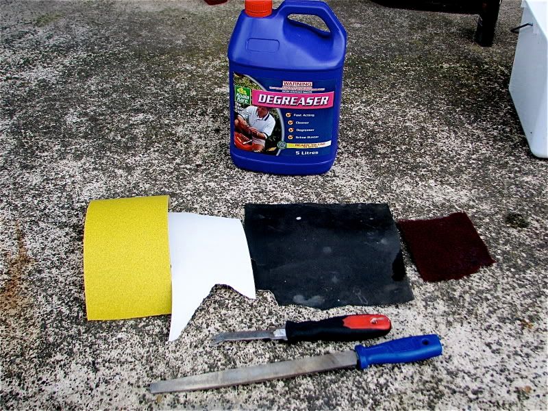

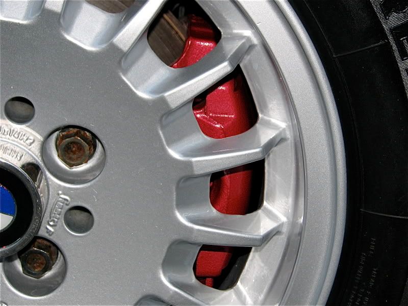

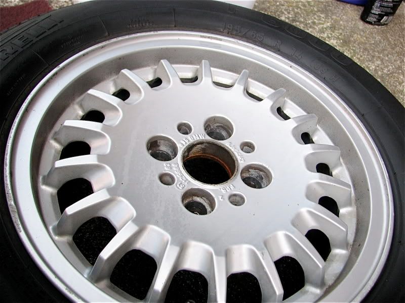

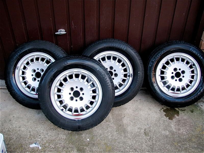

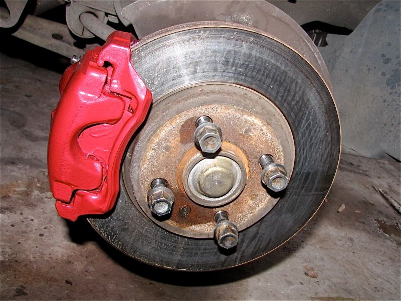

Repair gutter rash on bottle tops, and while I had the wheels off the car paint the calipers. (couldnt help myself)
Ugly torn old gaitor
New Ebay Item

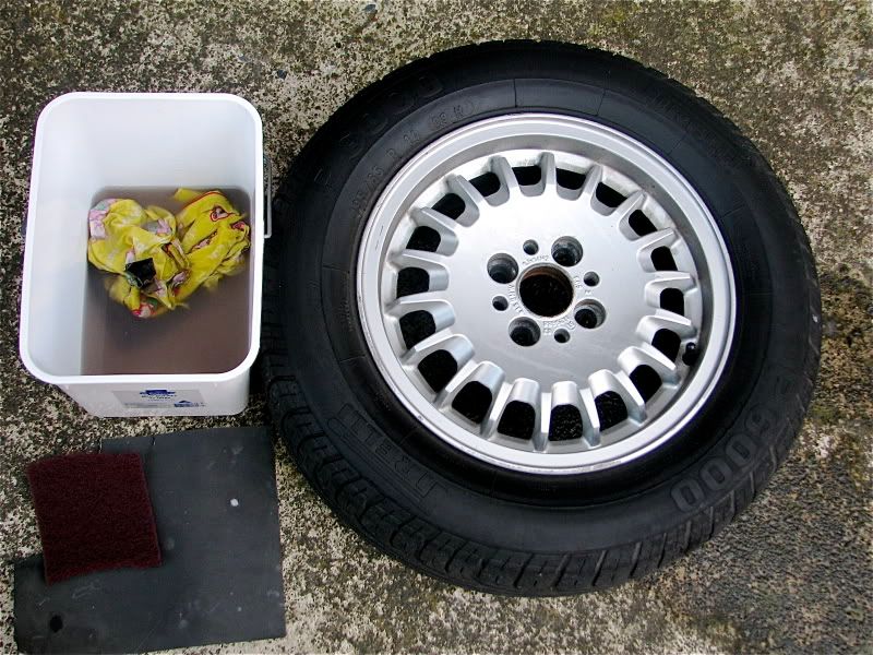

Things you need. Bucket of soapy water, 100,240,1000 grit sand paper, Scotch brite, file and a screw driver
Already for painting tomorrow
Old unpainted
Brilliant shiny red

Nice work :cool: Wheels look like new 8)

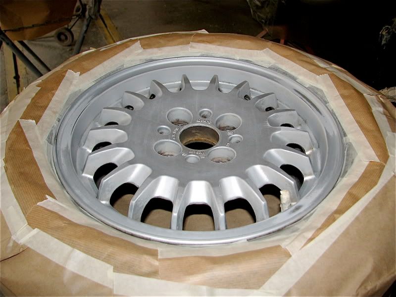

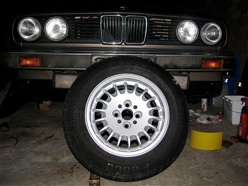

Ok so after getting them all repaired and cleaned yesterday today they got prepared, rubbed down and panted. Ive taken many shots along the way and if there is enough interest I will do a detailed how to for you guys, Never know you do the work and save yourself the money.... Anyway
All masked up
I have sealed them with a 1k primer
Once the primer has flashed off I apply the base coat
Now time for some clear
Back in the garage ready to go back on the car
And while they were drying I painted my jack
Now I have to wait for my wheel sticker to come via ebay. Then every thing is complete.

Post Sat Apr 11, 2009 2:25 pm
Great workmanship :cool:
Will look really nice when complete :)

wheels look great, jury is out on the calipers!!
And my god the cold start injector on those things looks realy ugly!!!

The calipers I know there not to everyones taste but owell. To be honest you probably cant see them behind the bottle tops..

I used to see this car all the time when i was living in Sydney. I knew it was US import because of the bumpers. Couldnt beleive that someone actually imported an E30 325e and converted it to RHD?!?!
I'd leave it as it is. As strange as they look, they certainly are different, especially in our part of the world

Good work man. Did the calapers come off. Canot emadgion doing them in situe but... Any how nice work and thanks.

LeonNewton I left the calipers on as I never intended to do it.. Had the wheels of and I spyed the caliper paint on the shelf and before you know it I was scrubbing the calipers with degreaser, thinners, carby cleaner, prepsol and carwash. Rest assured they are clean. However I did mask them up. When I do a pad change I will pull them of then and give them another go.

Huum. Canot be added taking calapers off as canot be added bleeding brakes. Just dun a fluid change. May look at this.

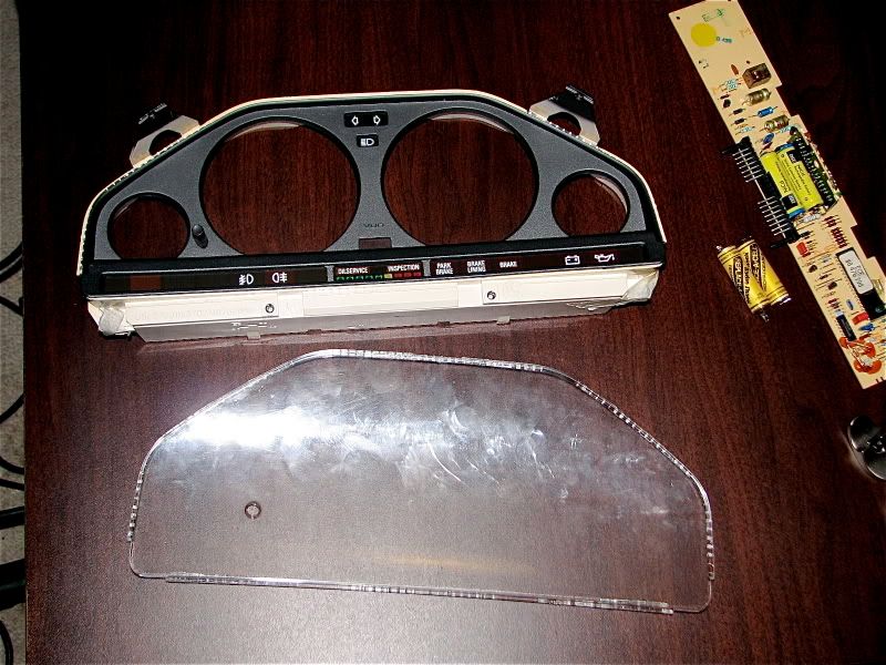

Anyway the car is in MPH and here in oz we use KPH so recently I bought a KPH speedo with broken odometer. My intentions are to fix the odometer gears and use the KPH speedo and swap out the ETA Rev counter for a 7000rpm unit out of a 323i.
After reading through this forum I have come to realize the rechargeable batteries in the cluster are about dead after 20 odd years.
While I had it all apart why not change the batteries.
Then I came across a thread from e30 tech http://www.e30tech.com/forum/showthread.php?t=51635 about doing a carbon fiber makeover for the cluster... Did a little reaserch and boy they want alot for those carbon fiber inserts....
I will make my own then. So I ordered the stuff I need and its on the way... Anyway I can still get started.
First step is to take the cover off the cluster... I used various flat screwdrivers and a heat gun.
Now its time to make a templet for the carbon fiber insert.
And thats it for today... Will update when my goodies arrive..

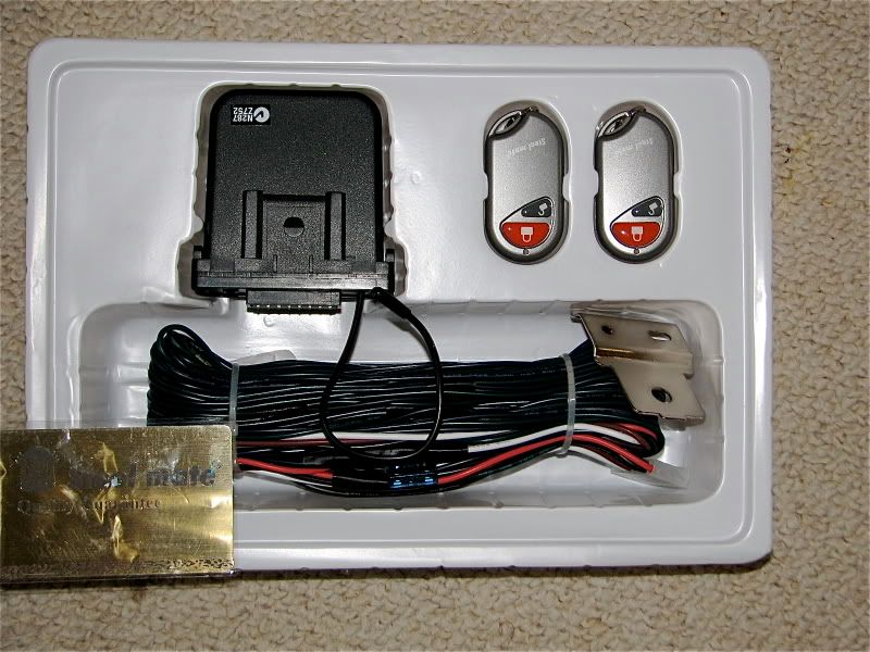

These beauties came today... Tech 2 steering wheel to replace the bus size steering wheel. And some chrome cluster bezels for the speedo and tacho.
Steering wheel need to be retrimmed so it will be awhile before its on.
And I whent and got keyless entry.
I can repair and paint a car but im no electrician... This is going to take me all day to figure out..
For those who have done this where is the best place to put the antenna?
Mike

Ok so now I can enter and exit my E30 without a key. Needless to say im am very pleased with my efforts.
I hate electrics, I understand them but when I have niggling problems it does my head in. Coupled with the fact I was working in off and on again showers of rain, it was a recipe for a temper tanrum.
All up it took me about 1.5 hours and I didnt even follow the wiring diagram because I dont understand them. The only problem I had was blowing of fuses. I wired it directly off the battery and on to the boot lock. Dead easy and I dont even know what im doing.
A super happy Mike

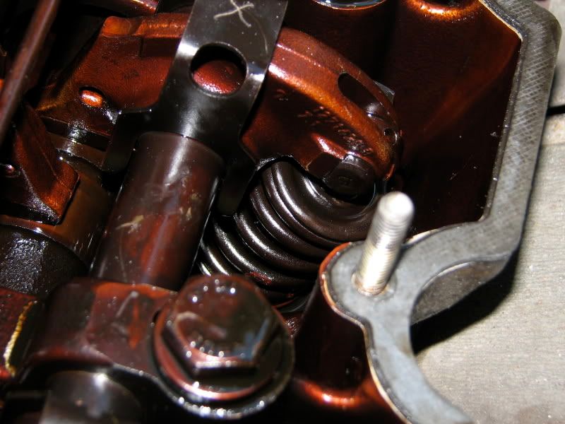

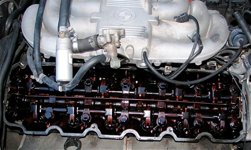

Today my father and I adjusted the tappets on the E30, Now they were not particularly noisy buT I wanted to do it anyway...
I also did it because I wanted to see beneath the cam cover..
This is what I found...
LOOK CLOSELY AT THE CAM JOURNALS I COUNT 7
IF THAT PIC IS TO DARK HOW MANY CAN YOU COUNT NOW? 4 or 7?
Single valve springs
Now I am surprised... All the reaserch I have done says the Eta head has 4 cam journals not 7... From my understanding the Super Eta head is the same as the 885 head with 7 cam journals.. However it still retains the shitty cam and single valve springs...
Should I be jumping with joy?

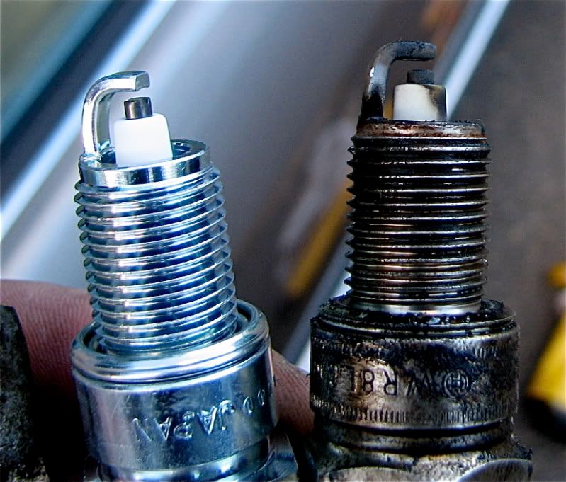

Anyway Here is the spark pugs I pulled out
Do these look alright to you guys?
