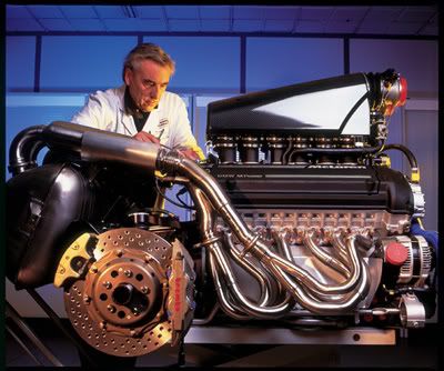

Thu Feb 19, 2009 9:43 pm
s70 = 48v 6.1 v12 on throttle bodies
Power (SAE net) 618 bhp @ 7400 rpm
Torque (SAE net) 479 ft-lb @ 4000 rpm
Redline 7500 rpm
will that go in an e30 winkeye

nickso
Posts: 4396
Fri Feb 20, 2009 12:29 am
Alex wrote:s70 = 48v 6.1 v12 on throttle bodies
Redline 7500 rpm
possibly but i doubt the diff hanger would survive long. :o

that v12 should fit, as the engine bay is designed for a straight 6 and people have fitted v8s so V engines fit. Just a small question of getting hold of one lol. winx may have a few at work :D .

mt1104 wrote:that v12 should fit, as the engine bay is designed for a straight 6 and people have fitted v8s so V engines fit.
Actually V12 is quite a lot easier to fit in E30 than V8 because the V-angle is 90deg in V8 and 60deg in V12 so the V12, even though longer (but not much actually) is quite a lot narrower than V8..
Anyways, everything is possible, it's usually only question of money and time..
