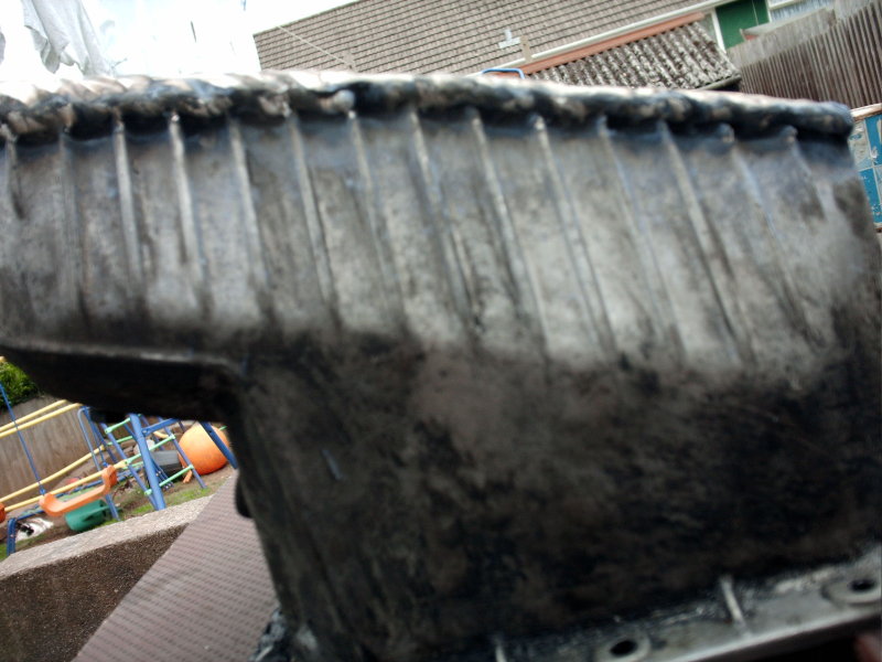

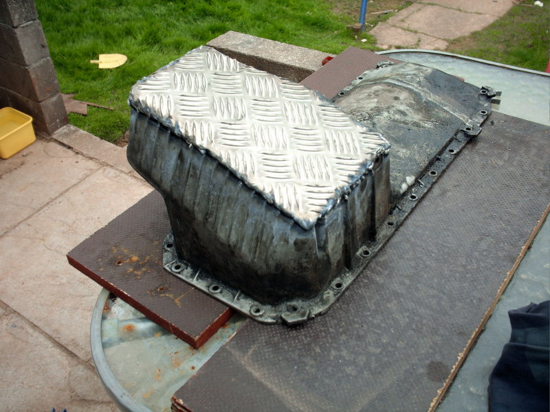

I first ran a bead over the cracks, making the sump oil-tight again, then cut and welded on a piece of 3mm treadplate :
The welds aren't particularly pretty (TIG is best for welding Al), but they are strong.
