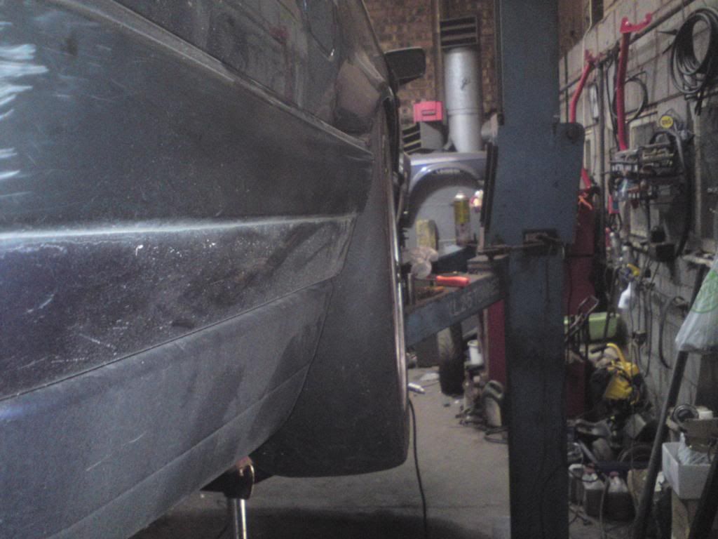

You might find you will need to chop that to work Rav, or unbolt the strut and drop it on a jack to get the roller low enough.
ET4 here :D
Fri Nov 23, 2012 10:05 pm
Did you use the same one Dan, as this can be dropped further down.
Is that ET4 on the Dirty track slaaaaaaag??

It looks to be the same one, with the roller fully in it was still to high in the arch, so I chopped a piece out of the box section and welded the nut back in. Same problem on E36's too.
It is indeed, hence no tyre tread :D

DanThe wrote:It looks to be the same one, with the roller fully in it was still to high in the arch, so I chopped a piece out of the box section and welded the nut back in. Same problem on E36's too.
Nuts!!!!
I'll have a gander, may just drop the rear suspension down, easier.
