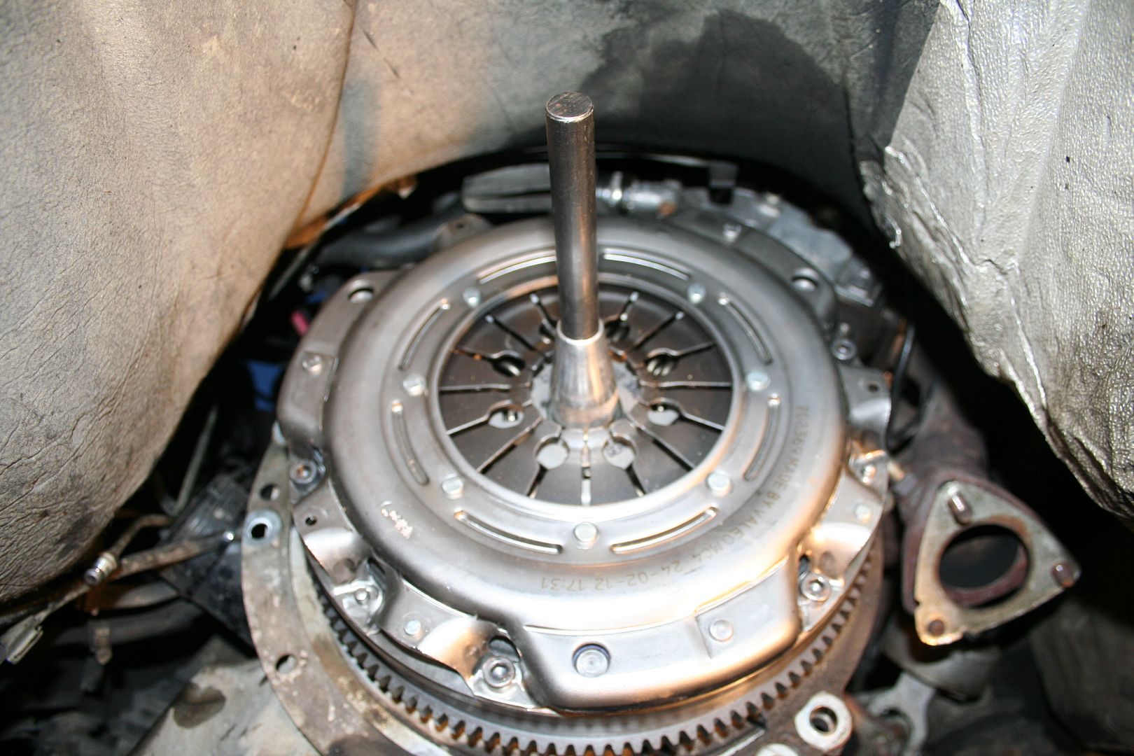

That'll be Danthe. The main pain is the clutch. The input shaft is different on new box's. Meaning you have to use a dual mass flywheel. This isn't straight forward either. Spigot bearing needs spacing to get any sort of pedal height. In an E30 it does anyway. Dan is a hero with these things and he's struggled to get it right. Still isn't ideal iirc.
It is a much stronger box than the S50B32 though.

Dezzy, ive found a company who say they can build me a sprung clutch :D
Solid flywheel FTW :cool:

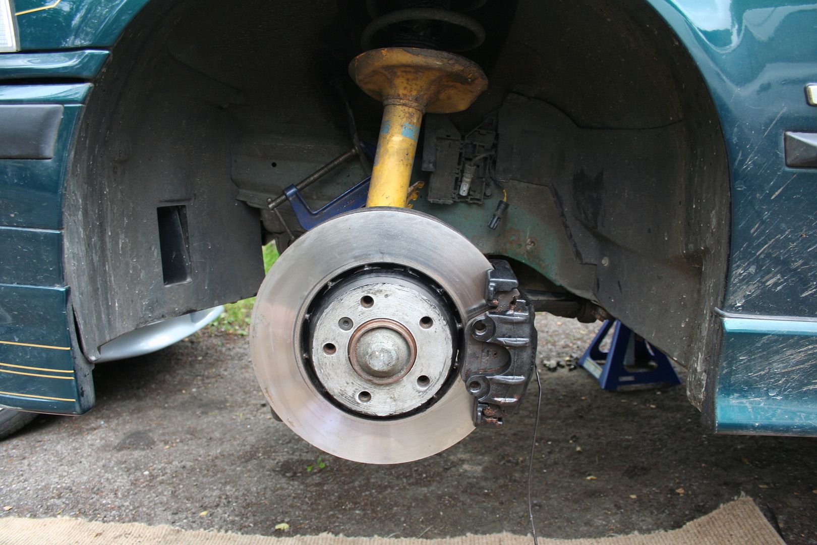

Big brakes, e36 m3 evo setup

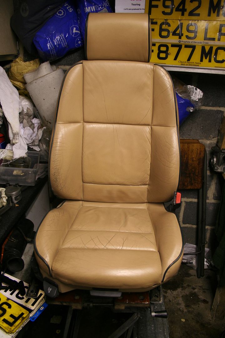

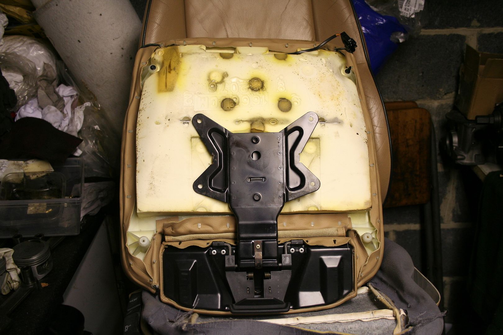

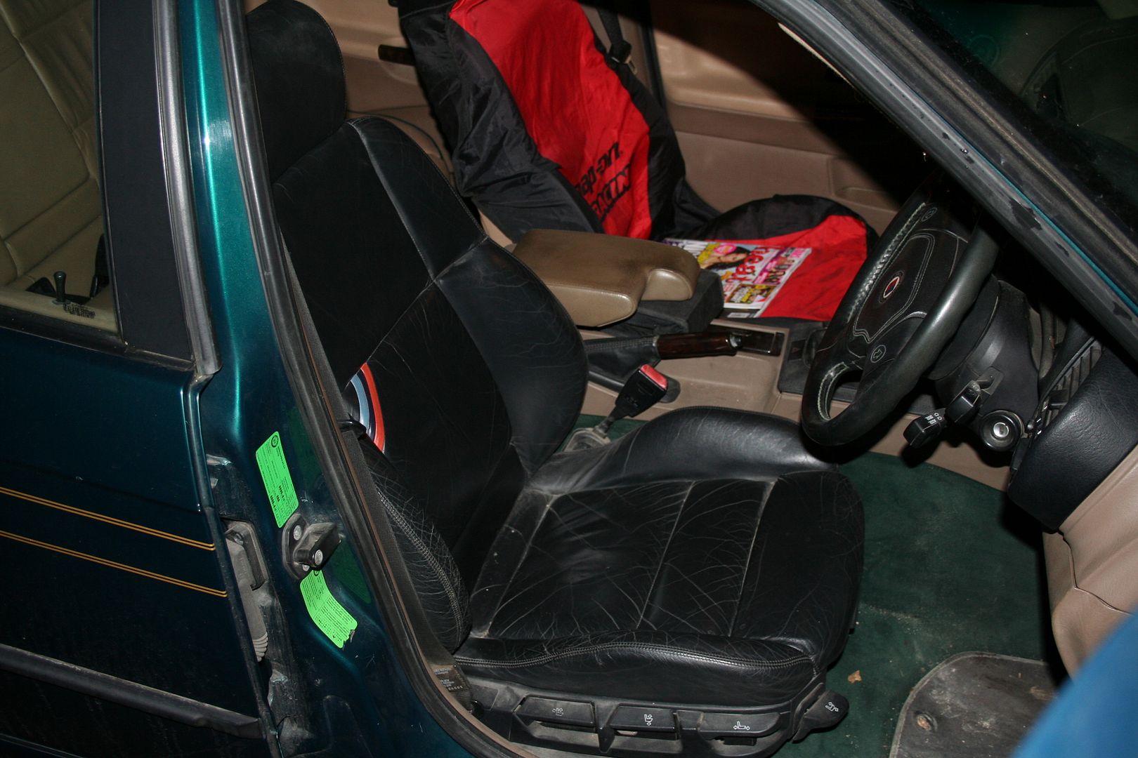

This is the drivers seat, doing remarkably well for the 203,000 miles the cars now covered. There been a problem with the heated seats only half working as the base element is in operative.
I think this a real credit to the previous owners of this car that it is in such good shape, or they where very small clean people! Opposite of me then
Spare black M3 cab drivers seat installed for now

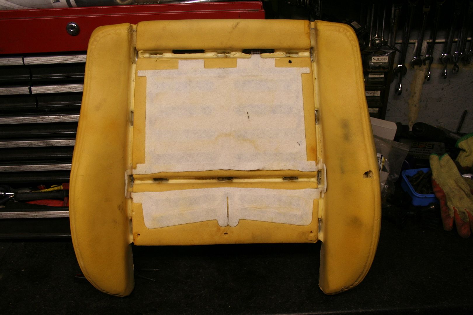

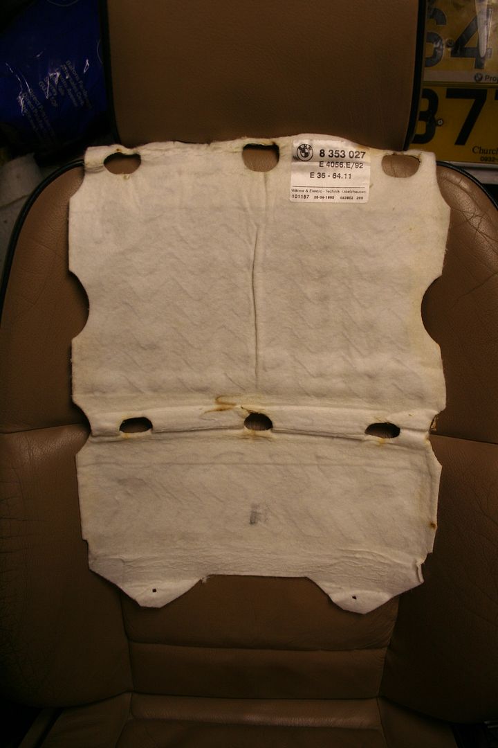

Heres a passenger seat base foam i got given from Barold. Its got a small hole on the side that won't get mullered. I'm sure i can sort this out. Its £80 for a new one of these
Barold also gave me 6 heated elements. I thought i'd check these by way of a continuity test on my leccy meter. 4 are bust! Some visibly, others not. So that left me with this base element beeping as ok, but it has a brown stain on it like it won't be long till it burns out also. Doesn't look great, so i've ordered a new one. Its got to come from Germany so will be after crimbo day now. £47 it cost me
Seat in bits

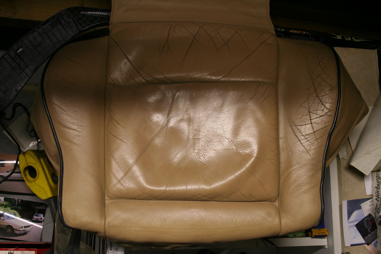

Base cover off, need to be careful as its an individual interior so no finding replacements if i'm a beast with it. Any tips while it can flattened out to tart it up? Maybe just get some more dirt out from the creases
So we can see the break or where the wire burnt out on the element and the foam has a hole in the same place as the passener replacement base. Surprise, no as this is common e36 stuff now. Most sport seats are out of their brains with rips and holes by this milege.

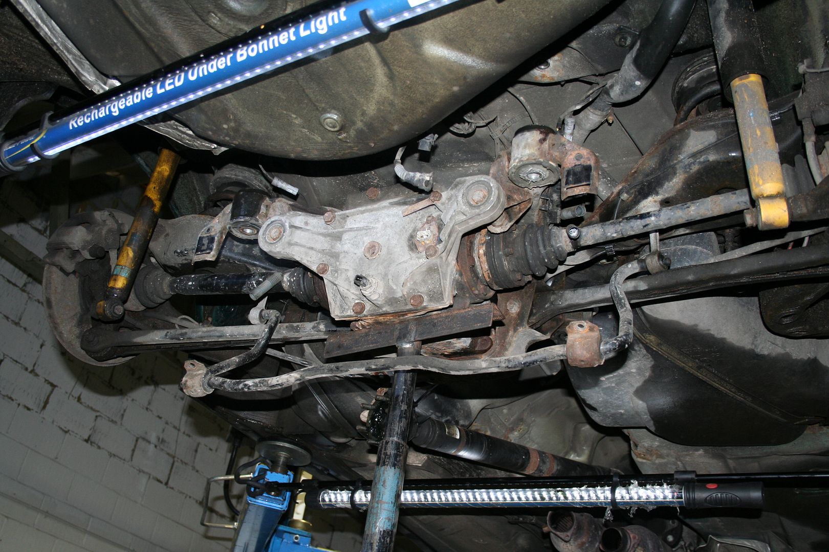

Mon Dec 31, 2012 10:56 am

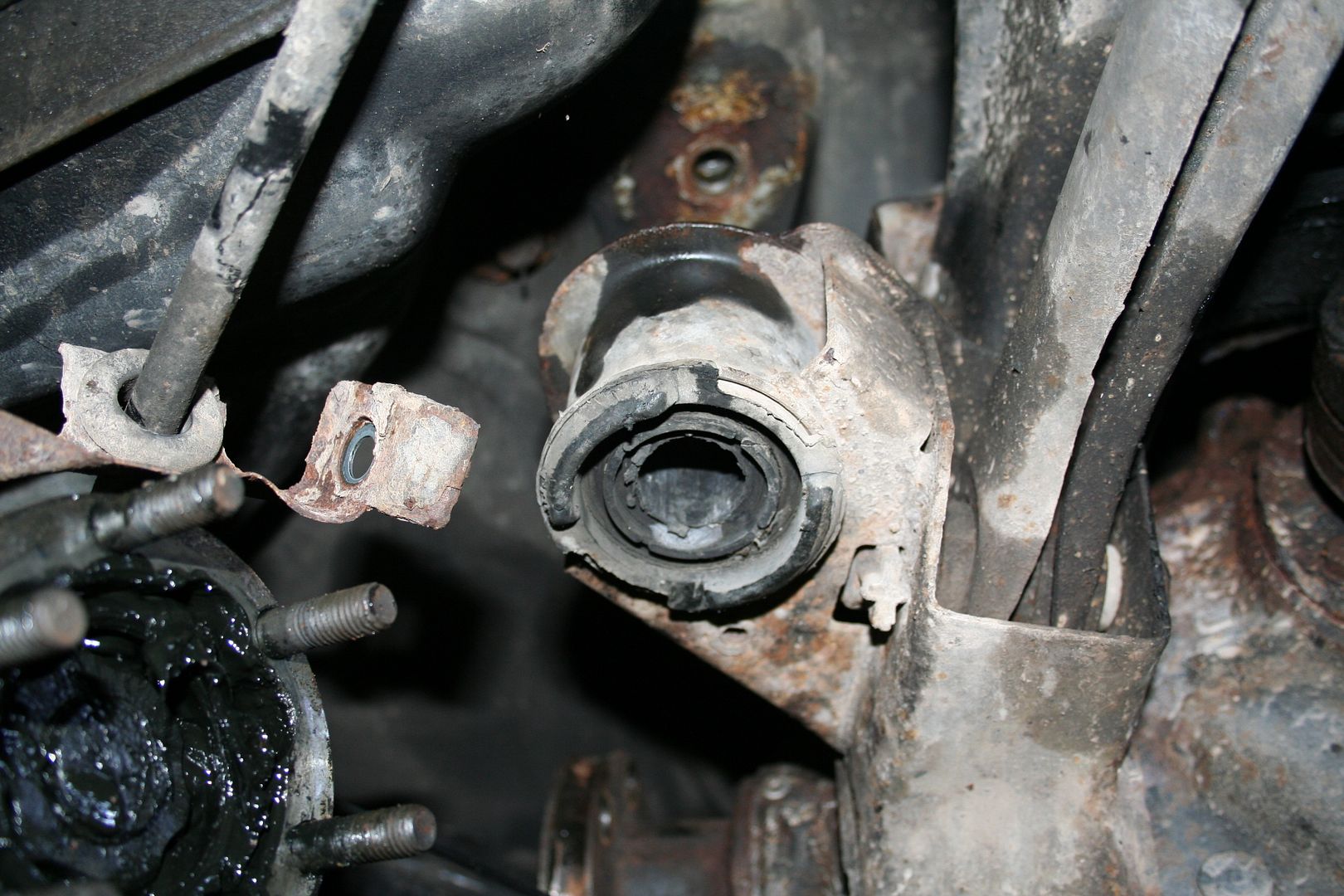

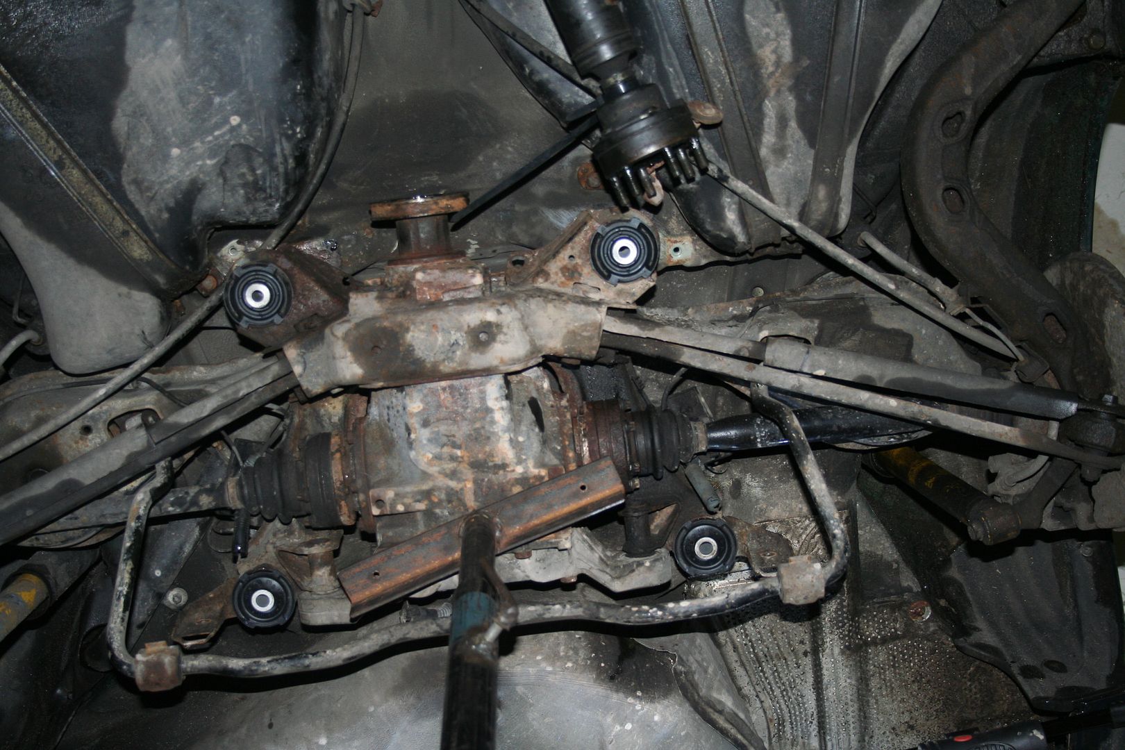

Watching that vid makes some sense now,

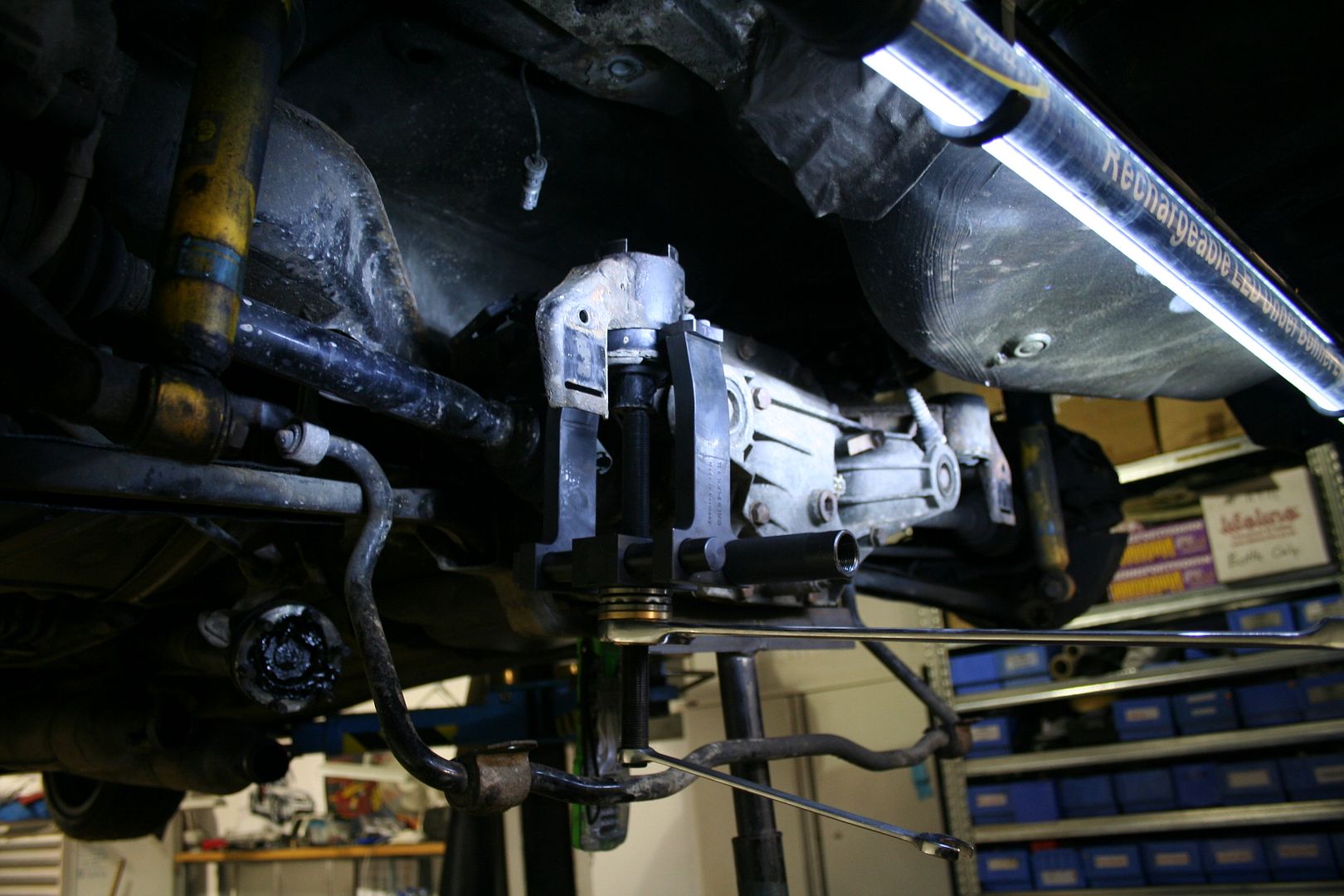

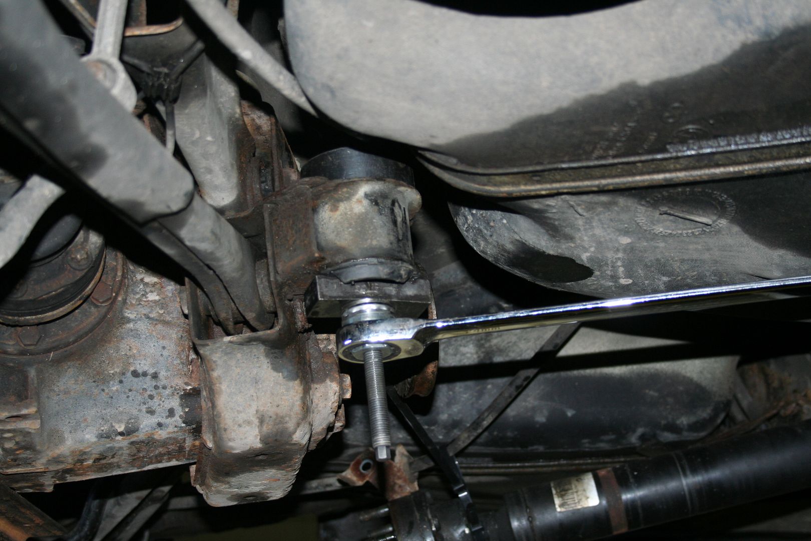

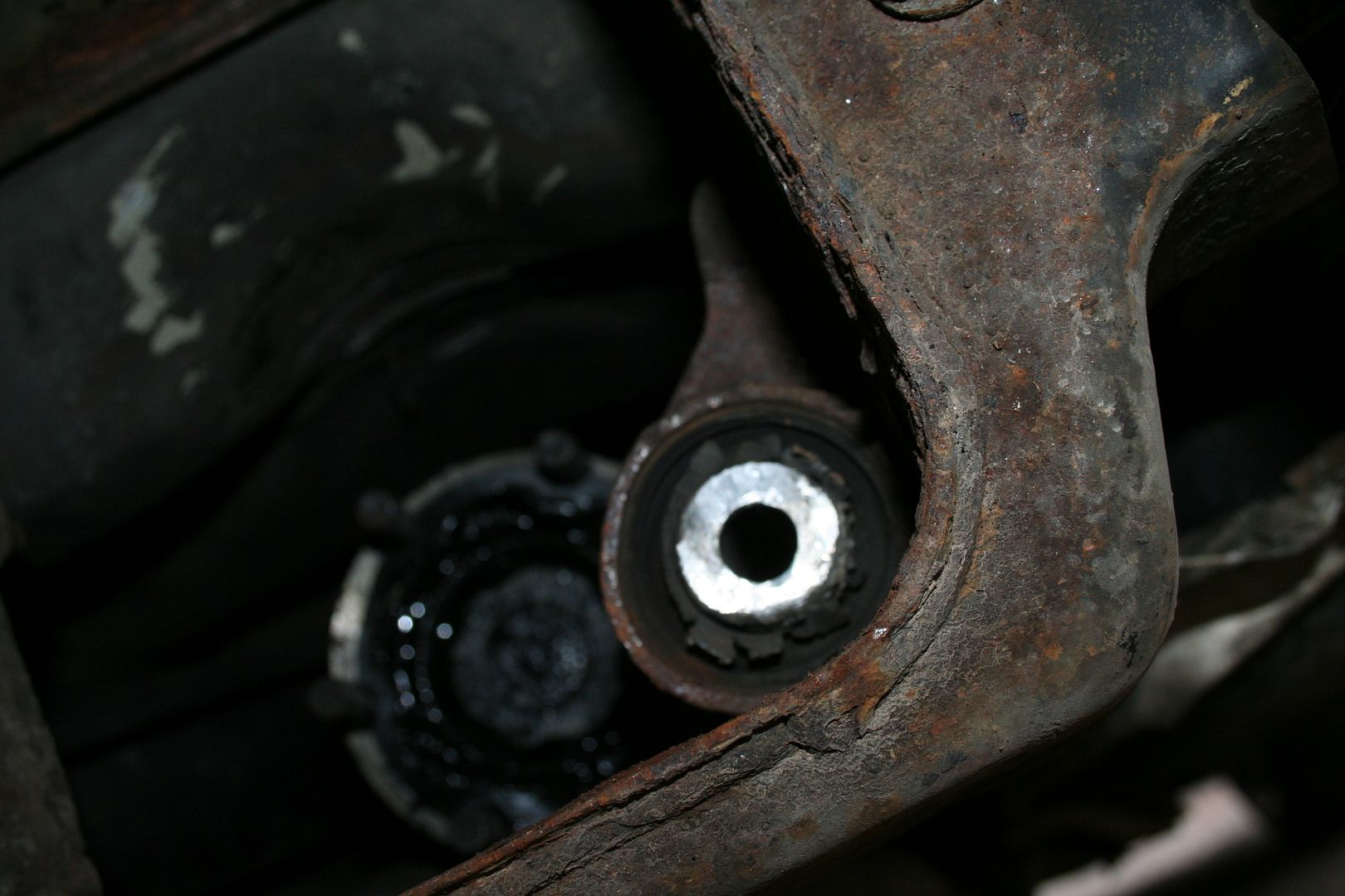

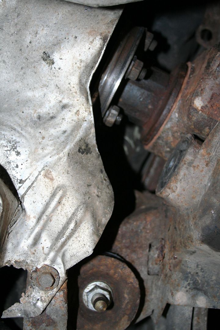

anyhow before christmas me and barry replaced all the axle bushes shown on that vid.

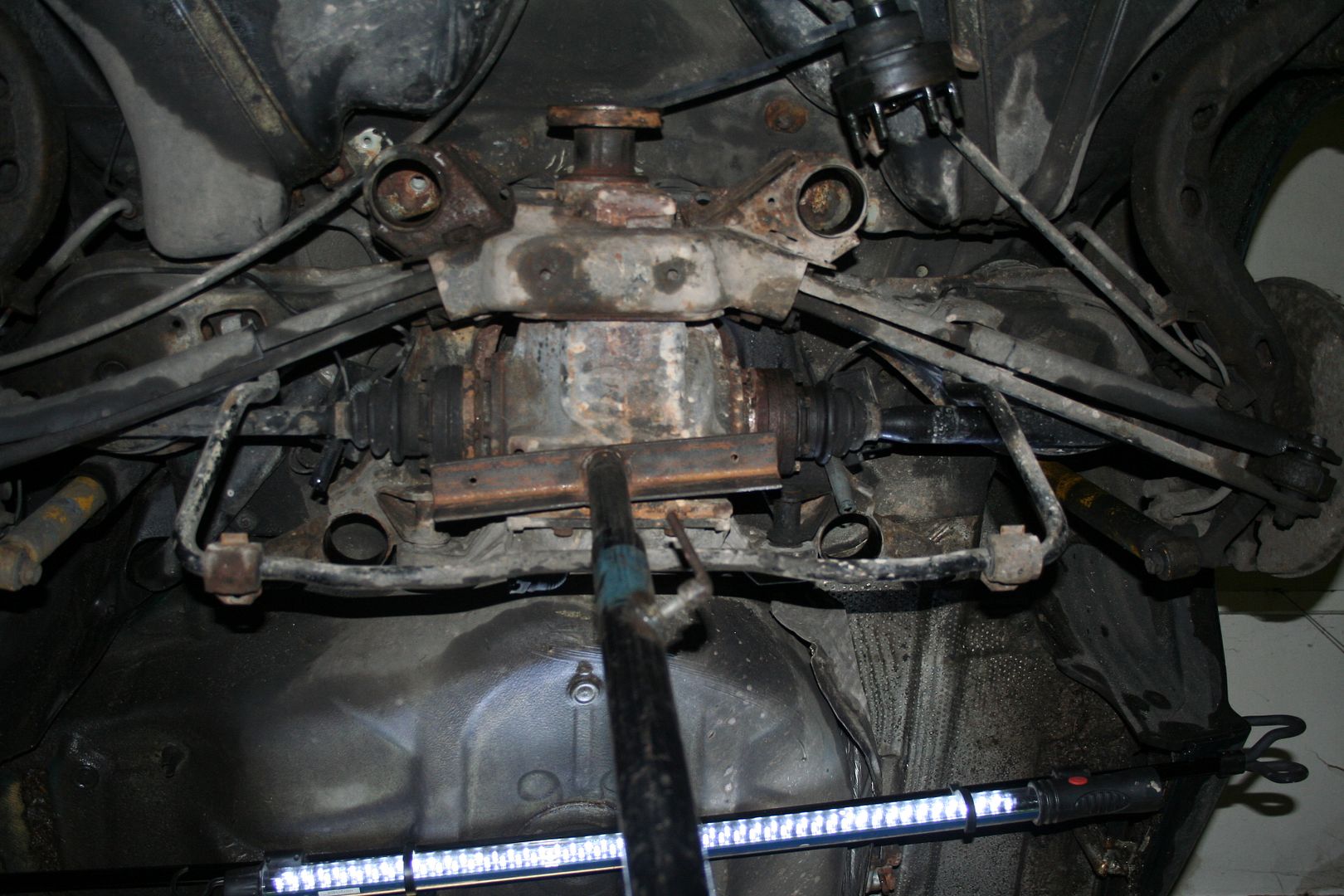

We wanted to do the lot in situ without removing the whole axle off the car. exhaust off with heat sheilds

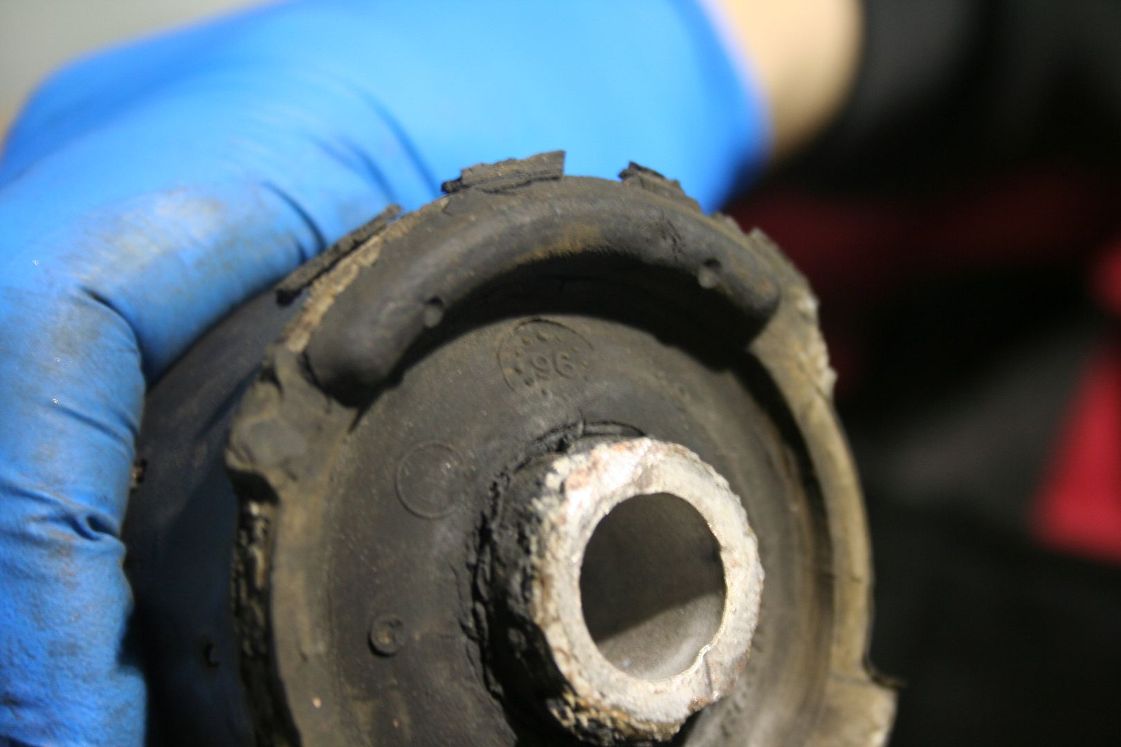

The whole centre of the bush is loose, bit like an e30 subframe one! All 4 were like this
We managed to undo everything and unplugged the senors and bits and the hole lot dropped down nicely on to the stand. We easily get access to all bushes to change them
i pulled the middle out by hand..............

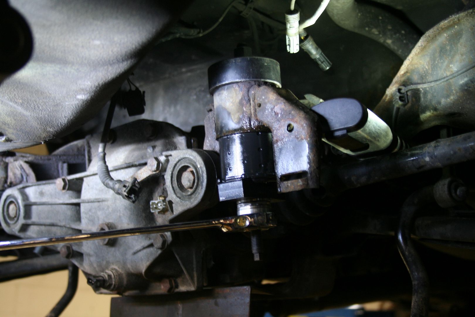

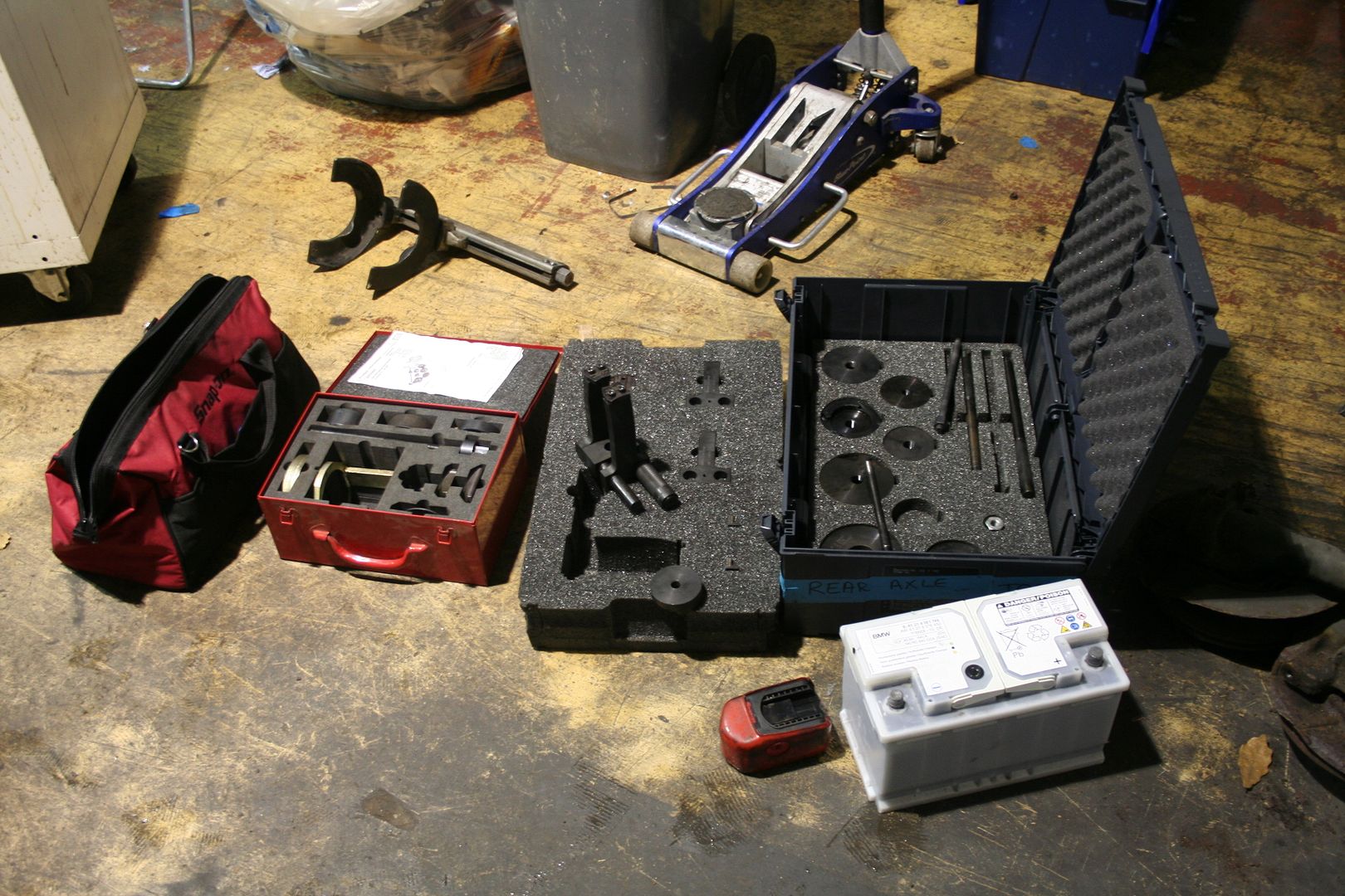

All tooled up from a very nice BMW dealer!

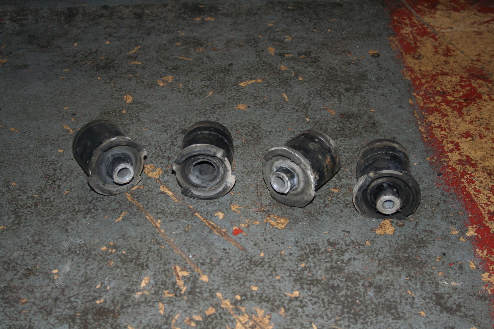

bush number one coming out, very easily might i add
All 4 out, considering the beam is covered in rust you'd expect it to have creeped in where the bushes located and make a pig of the job, but not so.
New bushes going in, went in with ease
new bits, not really needed bar the nuts. Nice to do though
All 4 in
All bolted up, no need for a rear end alignment either. As haynes says refit is the reverse of removal
They were originals with 96 stamped on them all!! 203,000 miles. Now i hoped the rear end clunk when go when changing gear, accelerating etc.
But it wasn't the case :?

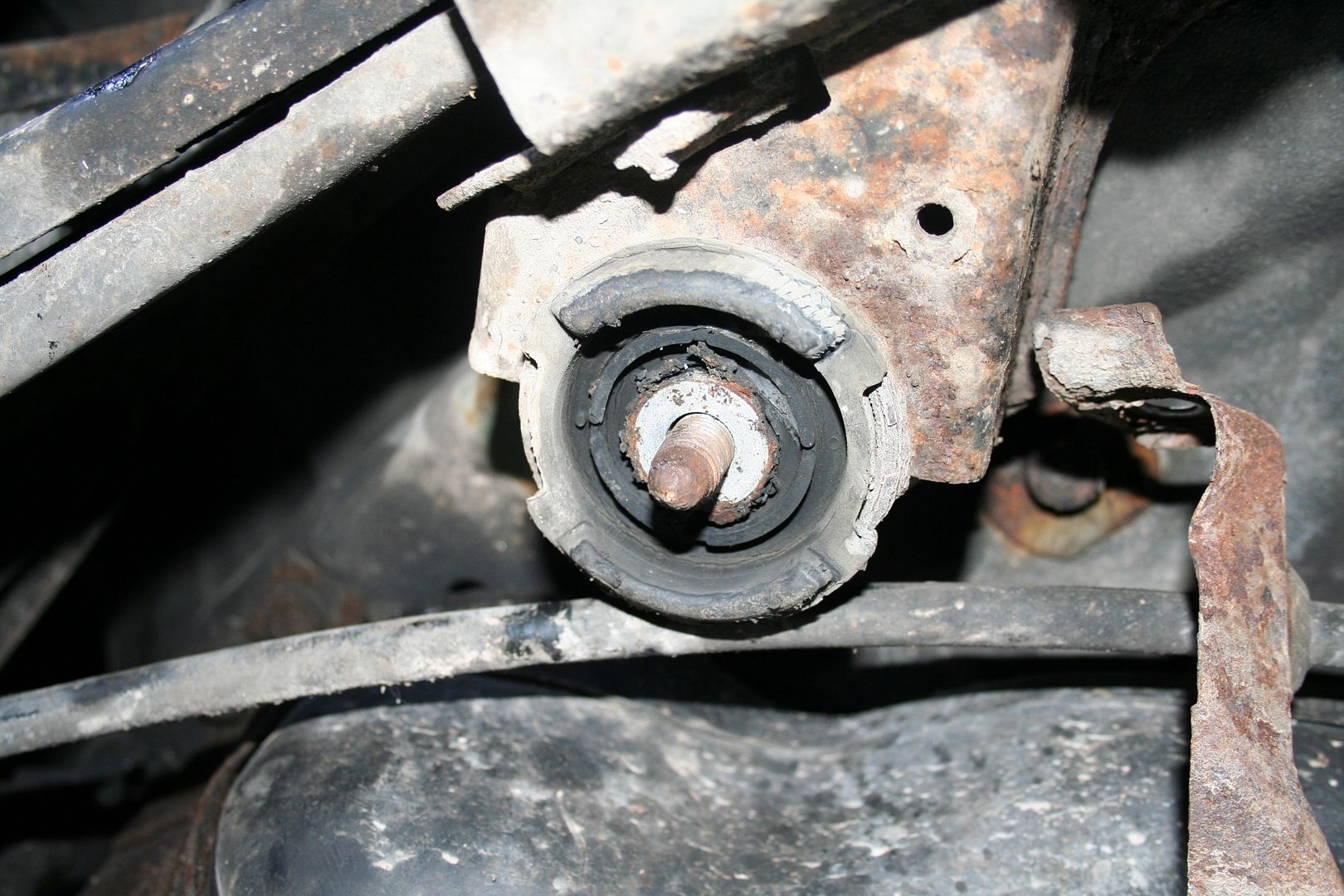

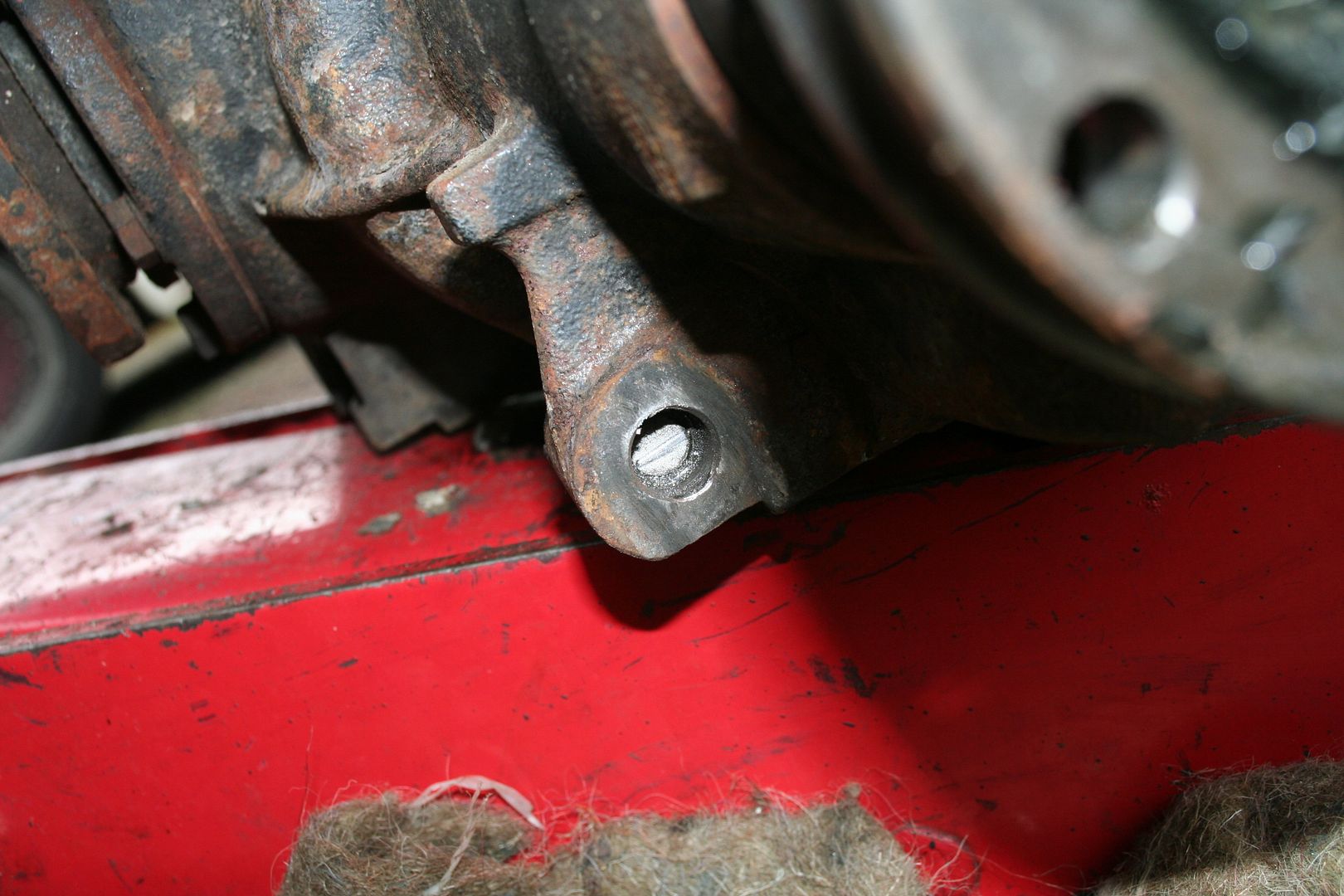

There was still a clunk, now on Friday i was picking up some brake bits for my 2dr from Keri WMS. I dropped it from 6th to 3rd to over take a dork and had a loud BANG!
Where the bush is next to the diff flange a 18mm bolt should be sprouting its head. Gone! snapped when floored it.
Now i swapped in a 3.15LSD the other week and this bolt didn't go up nicely. The threads were rusty so i squirted some double tt on first. Anyhow i either didn't tighten it fully or cross threaded it who knows.
So the diff was loose on the front and banging on the trans tunnel at the slightest touch of the pedal, changing gear and the prop grinding away also. Sounded horrendous and 90 miles from home. :?
Nursed it home as i don't have break down cover, it would cruise at 60-70 it was just painful getting to speed.

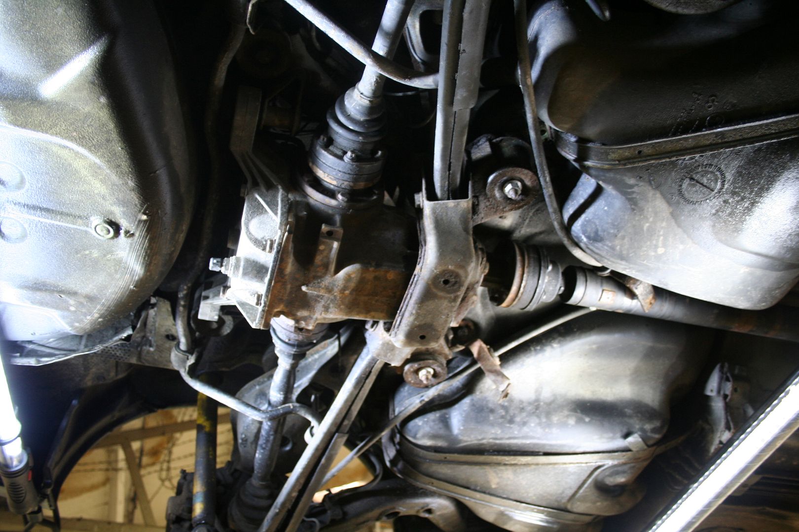

This is what greeted me after dropping the diff out, nice.
The culprit, so at a guess i need to get it drilled taped or something sort the thread out.
I think this bush needs changing also, looks shiney like something was moving!
So i've swapped in my spare 2.93 LSD. I didn't have the correct bolt spare, so this one will have to do. Its wound right up
The clunk has gone and it drives superb now :?

Hopefully the thread in the diff casing will be okay. If not, I'd retap it and put a nice high tensile stud in there to take a fat washer and a suitable nyloc nut.

Take it to someone that knows how to use a drill Si, if it went in rusty it certainly wont be coming out easily.

iirc That's a through hole is it not?
If so there is not much to stop you drilling totally through it and going for a nut and bolt. will do pretty much the same job as long as you use a shanked bolt.

Si those are notorious bolts for shearing off, it was one of the jobs I made sure to do on the M3 track turd while under the car swapping the suspension out.

my dads sorted it, thread is ok and wasn't cross threaded so he said.
