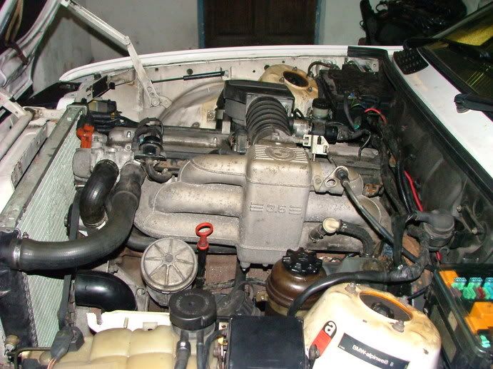

The mixer fits the four bolts that bolt the air filter box to the AFM. I removed the trumpet in the airbox and bolted the mixer to the AFM with longer bolts after first unscrewing the gas inlet stub pipe. I then drilled a hole in the side of the airbox that lined up with the threaded inlet port in the mixer and made up a stub pipe that screwer into the mixer, came out through the hole, then turned 90 degrees backwards.
This was all on a M20 installation, and the main reason for putting the mixer inside the airbox was to avoid moving the airbox any further forwards than the 30mm required to fit the blowback arrester.
gareth
- Posts: 11009
as above, the M30 AFM is on top of the rocker cover. there is a handy plain straight hose between the AFM and TB though.
does the mixer have to be upstream or downstream of the AFM? eg, is there a significant amount of gas that needs measuring or is it negligable?
- Brianmoooore
- Posts: 49358
Short answer is that the mixer needs to be upstream of the AFM, as the closed flap seriously affects the pressure between the AFM and the throttle butterfly.
Longer answer is that you can use a pneumatic ram operated by gas pressure to push and hold open the AFM flap while running on LPG, or you can use a vapouriser where the 'atmospheric' side of the diaphragm is connected by a pipe to just downstream of the AFM, so that the vapouriser sees the reduced pressure rather than true atmospheric.
What ever system you choose, make sure that the idle control valve gets fed gas mixture and not just fresh air.
I dont think it would matter where it went into. Just easier to fir it where the afm inlet is as the bolts are already there. Going to have a play sometime on the weekend to see what I can fit and where.
Do you think it would be possible to remove 30mm from the afm/inlet hose to fit the cat flap? Or am I going to have to trim the little ribs off the hose to fit?
