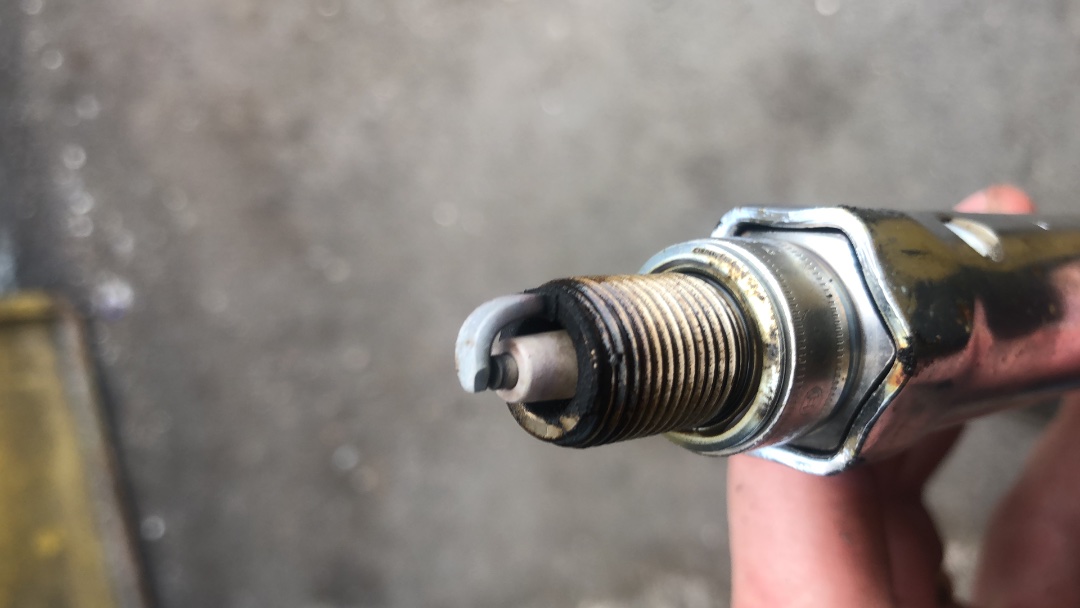

Also a photo of my spark plugs confirms lean symptoms

The plugs indicate a weak mixture, but we already knew that. What we don't know is why, but it looks like fuel pressure problems can be eliminated from the hunt.

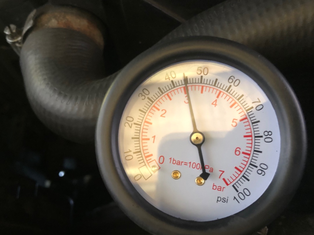

Vac line off fuel pressure rose to 3 bar.
No idea where to go from here

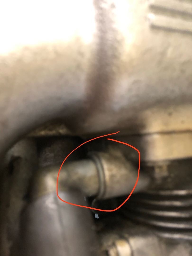

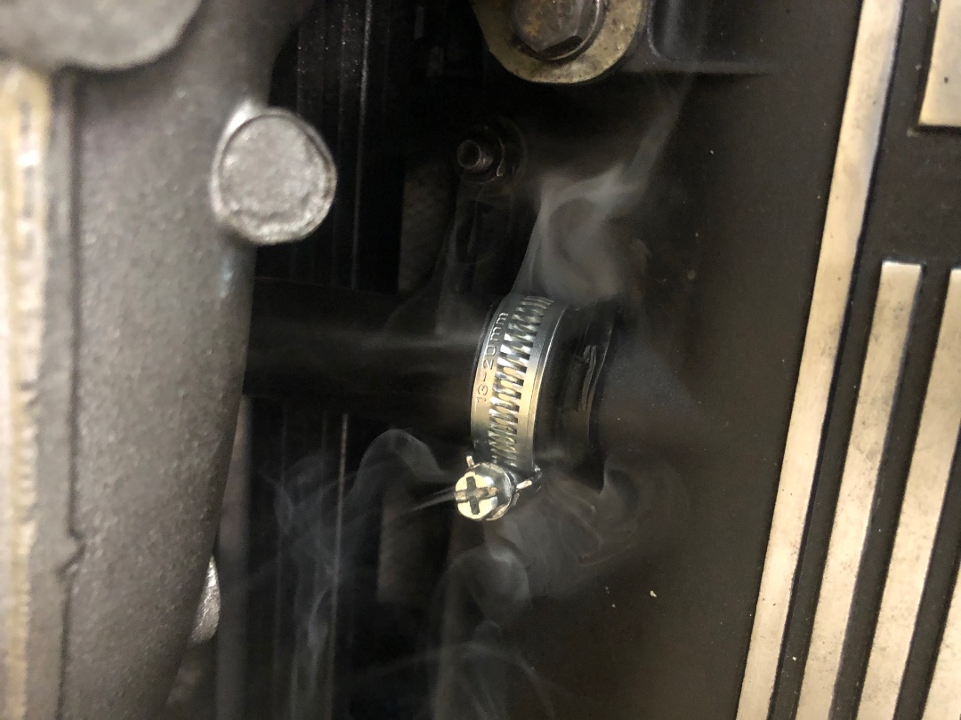

Okay so second smoke test was a little more successful. I think the first time I didn’t pump it enough or allow enough time.
First major leak was around the breather hose on rocker cover side. I think there probably was always a pin hole leak, but made significantly worse earlier this week when I took throttle body off as it cracked a little more. Probably the reason my idle jumped to 900rpm from 600rpm, and not actually the throttle stop screw I was adjusting, as mine is barley touching the butterfly anymore. Clears that up as that was confusing. Either way I’ve ordered a new hose and clamp.
Second leak was a smaller one on the throttle body, some sort of bearing I’m guessing? Anyone ever repaired this? This probably is the reason my idle is hunting

The part circled in red is the elbow that goes from ICV to TB (but you knew that!). It is a splined fit but the splines can wear away very quickly which leads to a dodgy fit & seal. I used a few drops of adhesive on mine and it's held up over the years.

Cloggy Saint wrote:
Sat Apr 25, 2020 6:12 pm
Okay yea I was thinking maybe some gasket sealer or something!
I’ve been searching to see if there are any parts for the ICV metal elbow but it doesn’t look like it. I’m guessing BM would just replace the whole throttle body back in day.
I did see one guy tap it out and put a plumbers elbow on it.... worth a thought

I found the best thing is white wood glue - cheap stuff in a squeezy bottle -

Your fuel pressure tests have shown you that there's minus 0.5 bar of pressure inside the manifold at idle. (3.0 bar - 2.5 bar).
At that sort of pressure difference, quite a bit of air is going to be sucked in through those leaks.
There's the ICV elbow on one side, and one or two elbows on the other side for the brake servo. These are steel elbows, pressed into the alloy, and if any show any sign of being loose, they need to be removed, cleaned, and glued back in with something like araldite.
There is also a small unused port underneath the throttle body, very close to the TPS, which should be blocked off with a rubber cap. This cap is made from a kind of rubber that deteriorates, and most will have fallen off by now.
