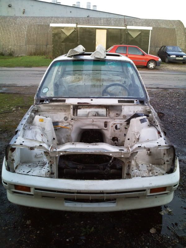

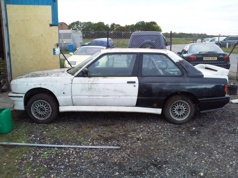

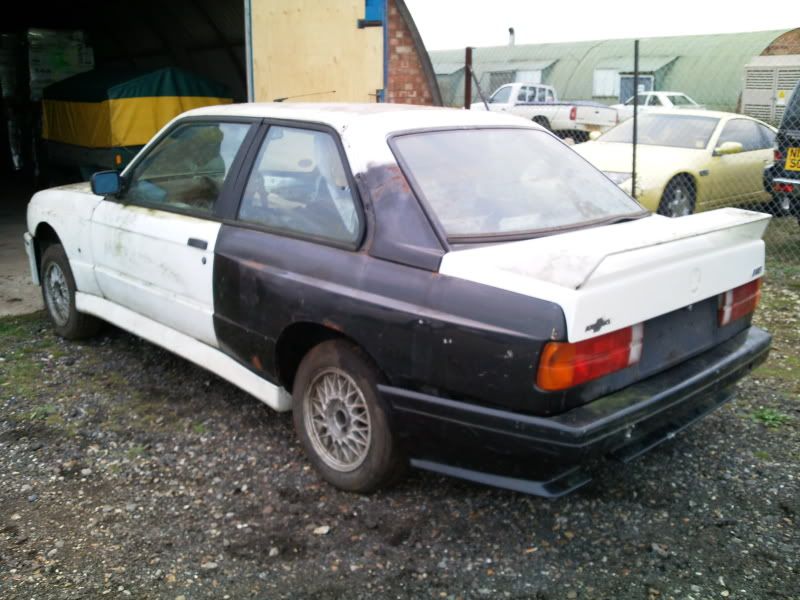

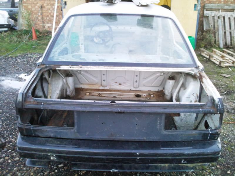

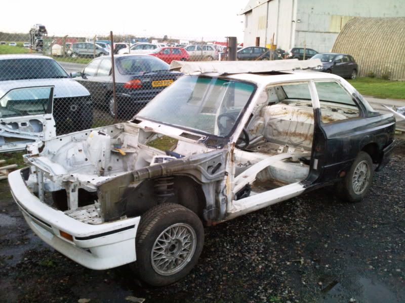

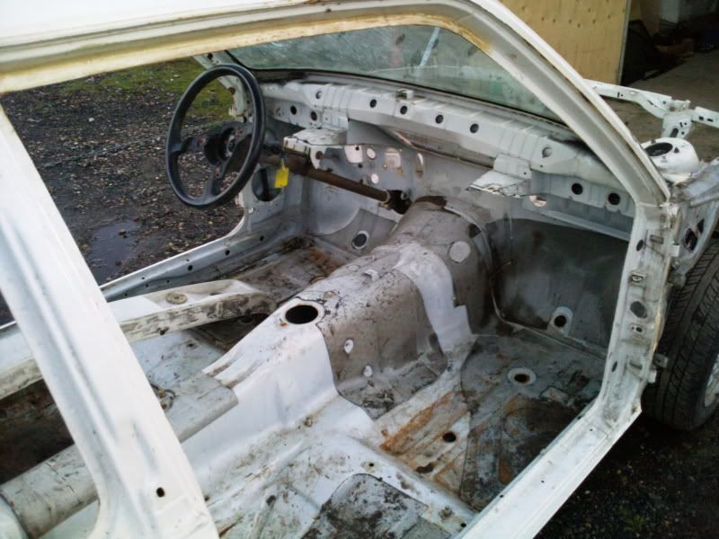

SO...
In the year or so since the first pictures went up i can confirm that i walked away from the shell.
A few weeks pass and BBB inform me that in fact the shell is solid, relatively rust free and invite me to look at it on the ramp/buy, so many thanks to them i purchased the shell, complete with kit, glass, and LHD bits as you would expect.
I promptly decided that LHD in the uk just wasnt for me so dash loom and a fair few other bits later i got down to this...
Ok the 1st pictures looked like a horror story but on stripping the car it turned out that the shell was both solid and very save-able...
So off to the media blasters and then to bodywork,
S50B30 sitting beside the car as we speak, Full M3 suspension/5 stud sourced, necessary interior parts sourced,
Many thanks to BBB for this invaluable support, supply of parts and generally nice guys...
RHD conversion completed (whats that? the sound of torches being lit?)
Yes it could have been left under that fu**ing thorn bush to rot to nothing,

If it's not too late regarding your swap to RHD,door looms are specific to DRIVER'S door and PASSENGER door,not LHD/RHD,so any driver's door loom will suit.
I would re-wire with a complete RHD loom,this will sort all the issues I had getting the door looms to work properly!
Other issue I found difficult was mounting the glove box,the bulkhead is differently shaped on LHD...

daimlerman wrote:If it's not too late regarding your swap to RHD,door looms are specific to DRIVER'S door and PASSENGER door,not LHD/RHD,so any driver's door loom will suit.
Both doors will be stripped and re-loomed,
Interesting regarding the glovebox problem, i'll take a good look before the interior is painted and hopefully anyhting thats going to foul it can be reshaped/adjusted
This is your problem....
My solution was to leave out the glovebox liner and cut the back of the 'box to fit,not ideal,but almost two years on I have still to find a better answer!
Glovebox hinge mount(RHD only,BMW's solution)is packed out from the toe board by a quarter inch to achieve this 'fit'...
I thought that the plastic mount for the dash loom plug and accessories socket was a different shape for RHD,but sadly it is'nt.
Good news is that you have to open the glovebox to see the problem.
I would love to learn how Bird's overcame this issue.
My other problem was the wiper motor mount,work from dimensions from a RHD car for all three mounting studs,the single LHD one is in the wrong place for any of the RHD items!
The steady bracket at the driver's side is simple fabrication.
Remember that E30 started as LHD,and the factory converted the design to RHD.
Steering column is almost marked by the plastic paint drain plug in the R/H footwell,but it's not the centre....
RHD pedal box includes the pivots for the throttle pedal and there should be two 'dimples' in the R/H corner of the battery tray to give you a guide to locate it.
If I were daft enough to take on another LHD/RHD conversion I would use a RHD loom instead of modifying the dash part/door socket part of a LHD loom.
Best of luck,please keep the photo's coming!
