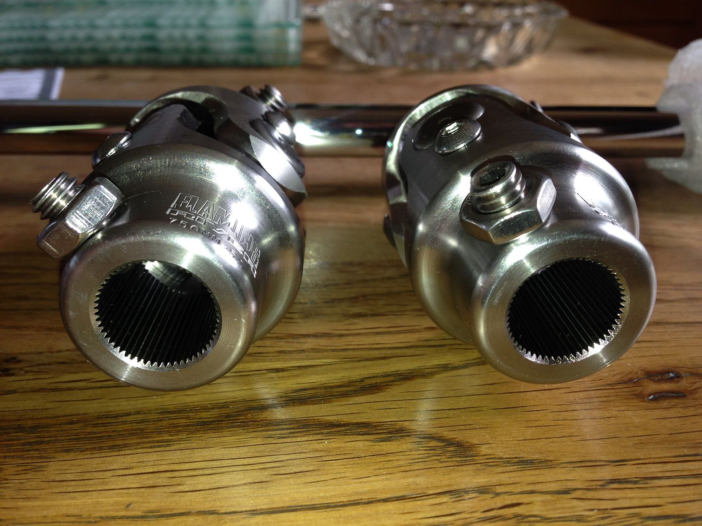

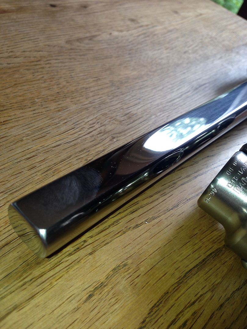

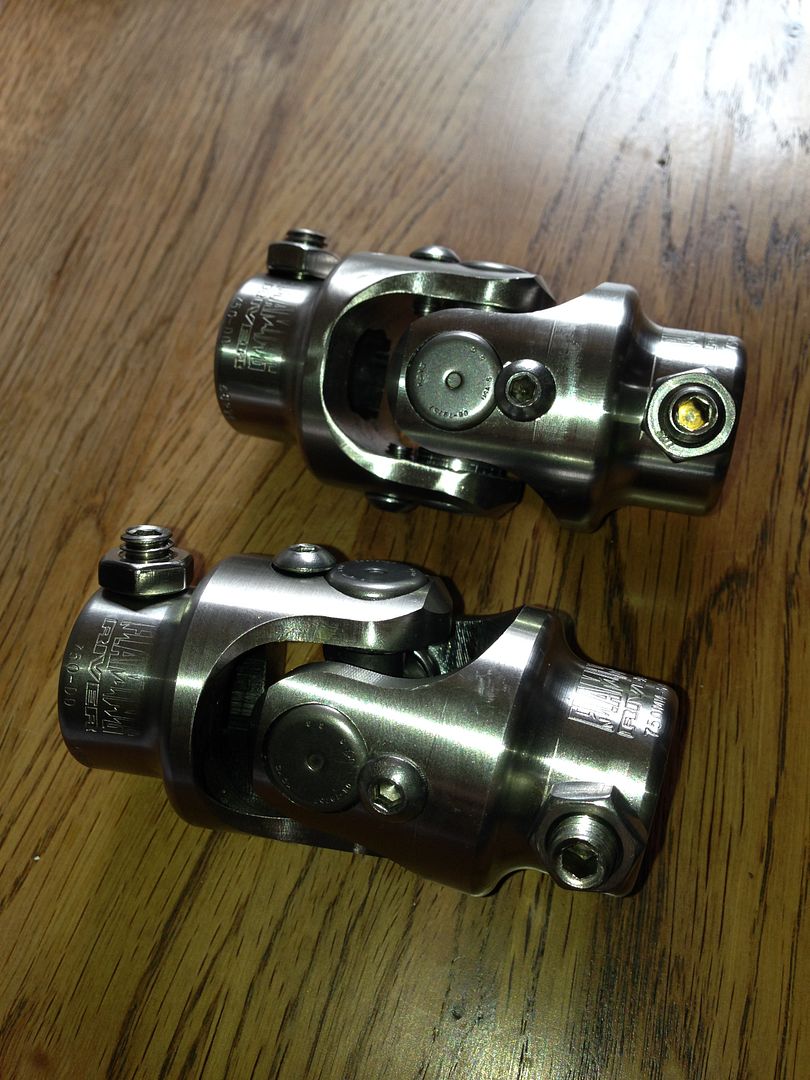

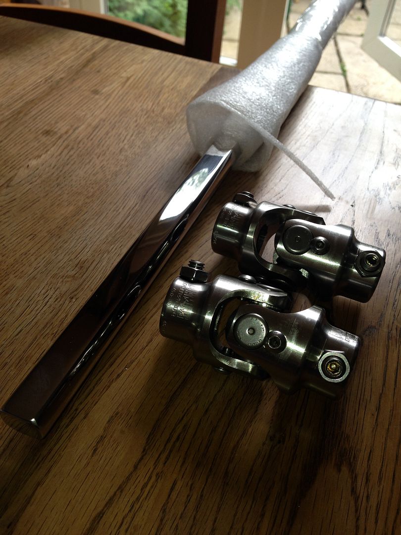

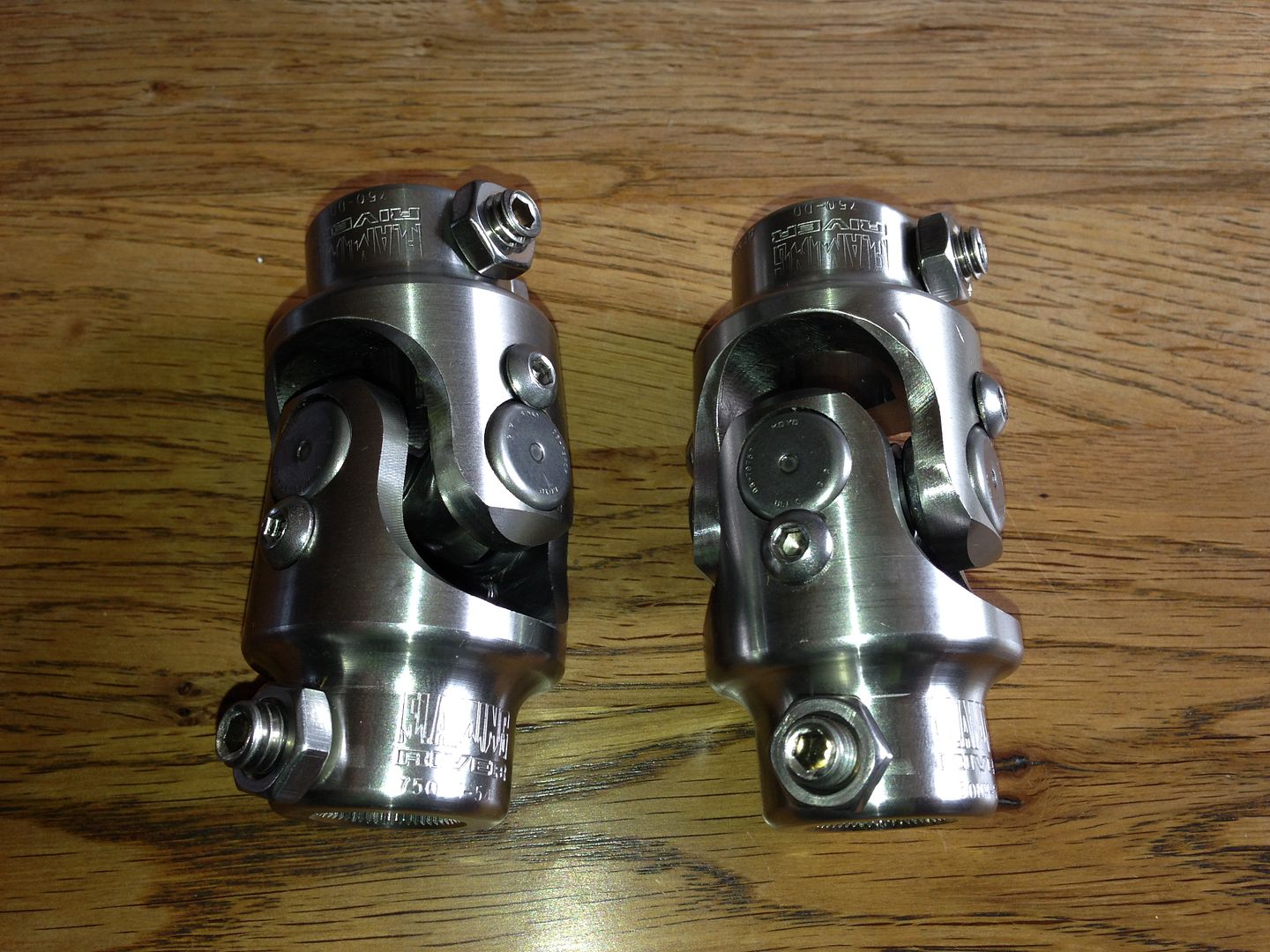

these sexy bits turned up today new steering linkages all stainless steel
Turbo M20
v8 project 6.0 twin turbo
Posts: 28649
Post Wed Apr 09, 2014 7:14 pm
Nice UJ's !! :D

Very sexy indeed 8)
What's the spline size needed for the E30? I've been looking at some of these, although not quite as shiny :)

lol cheers guys not that cheap either
there 17mm x 54 spline :)

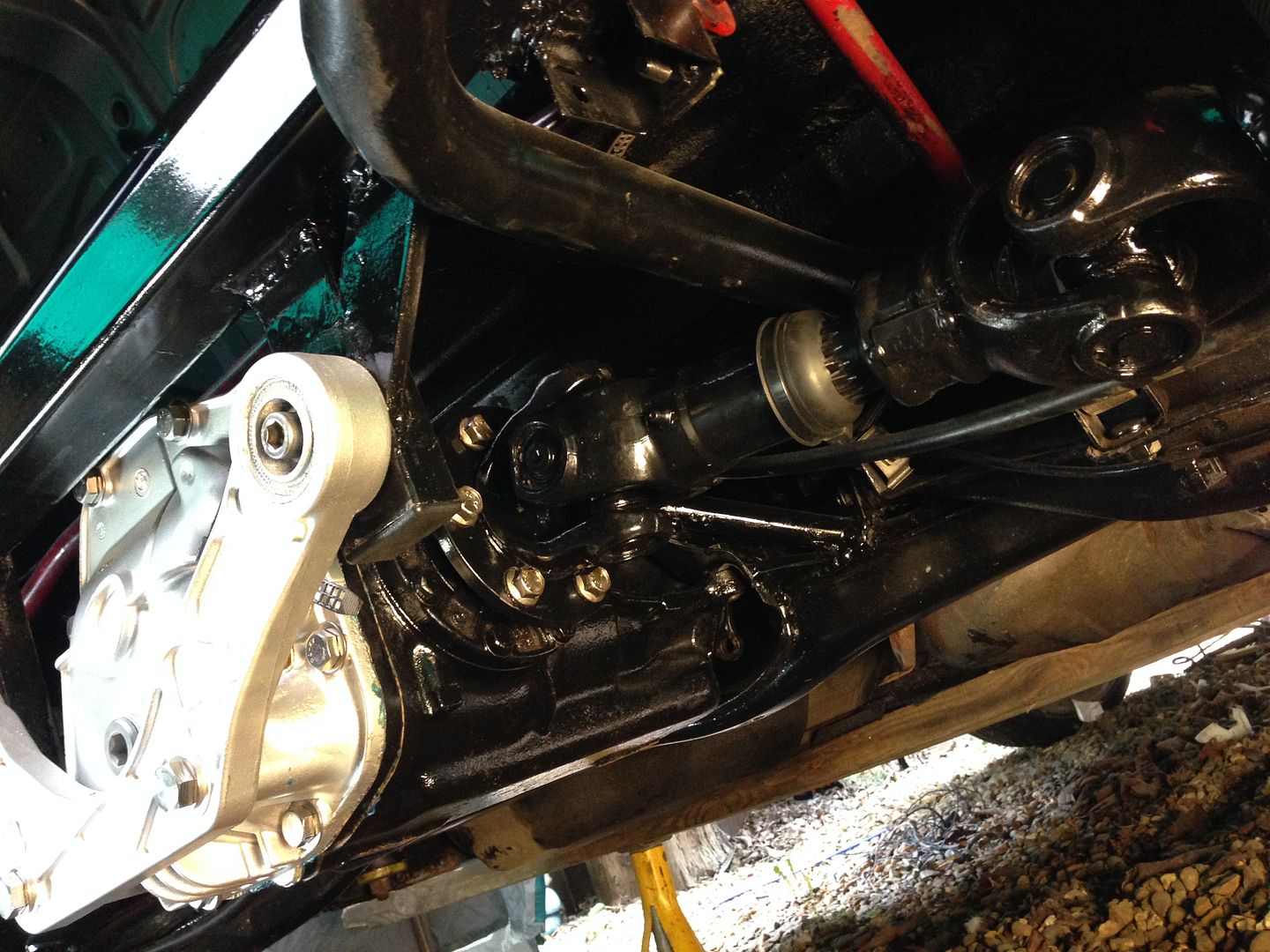

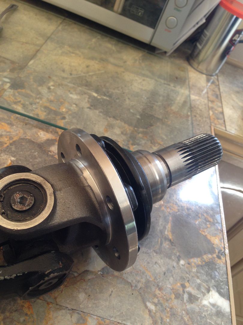

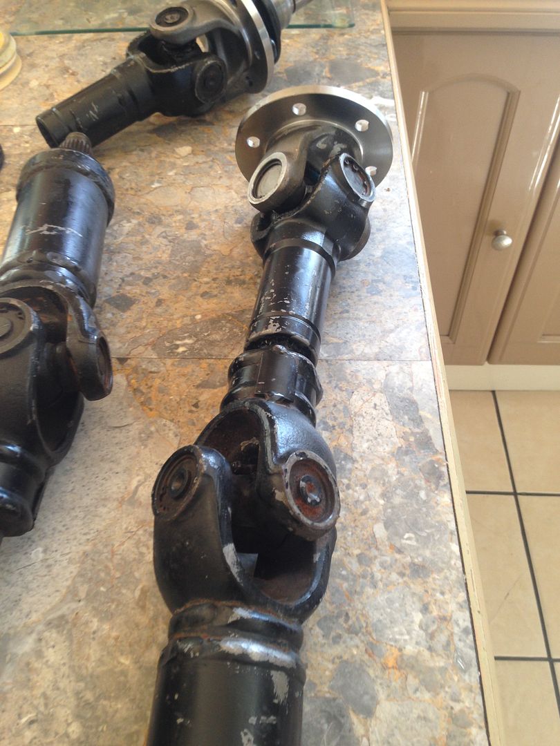

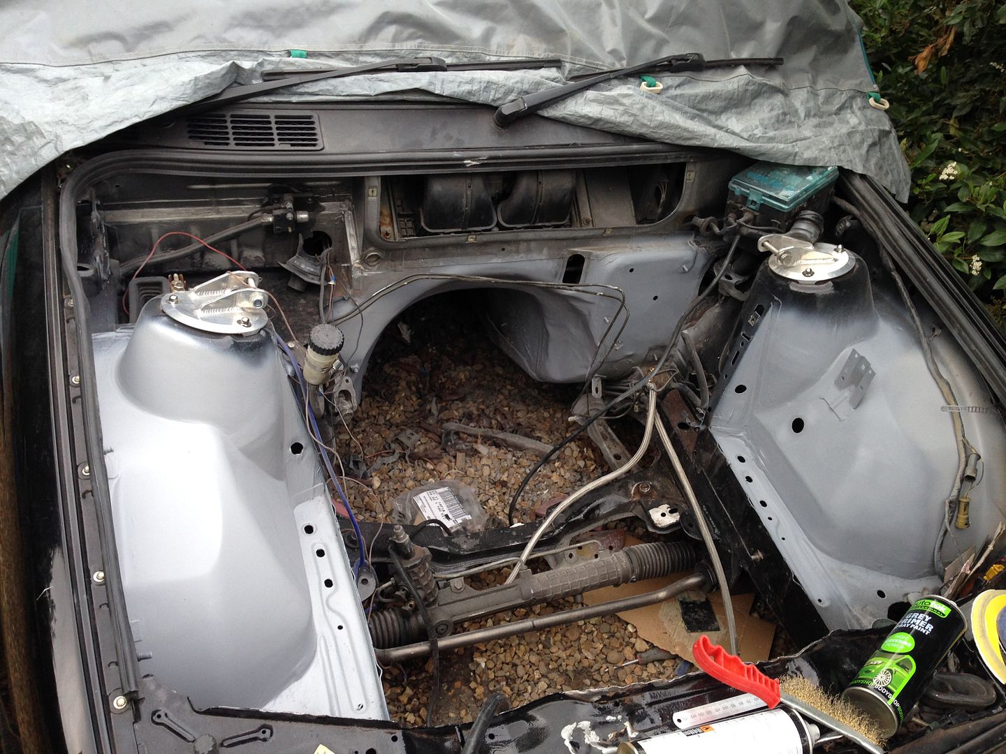

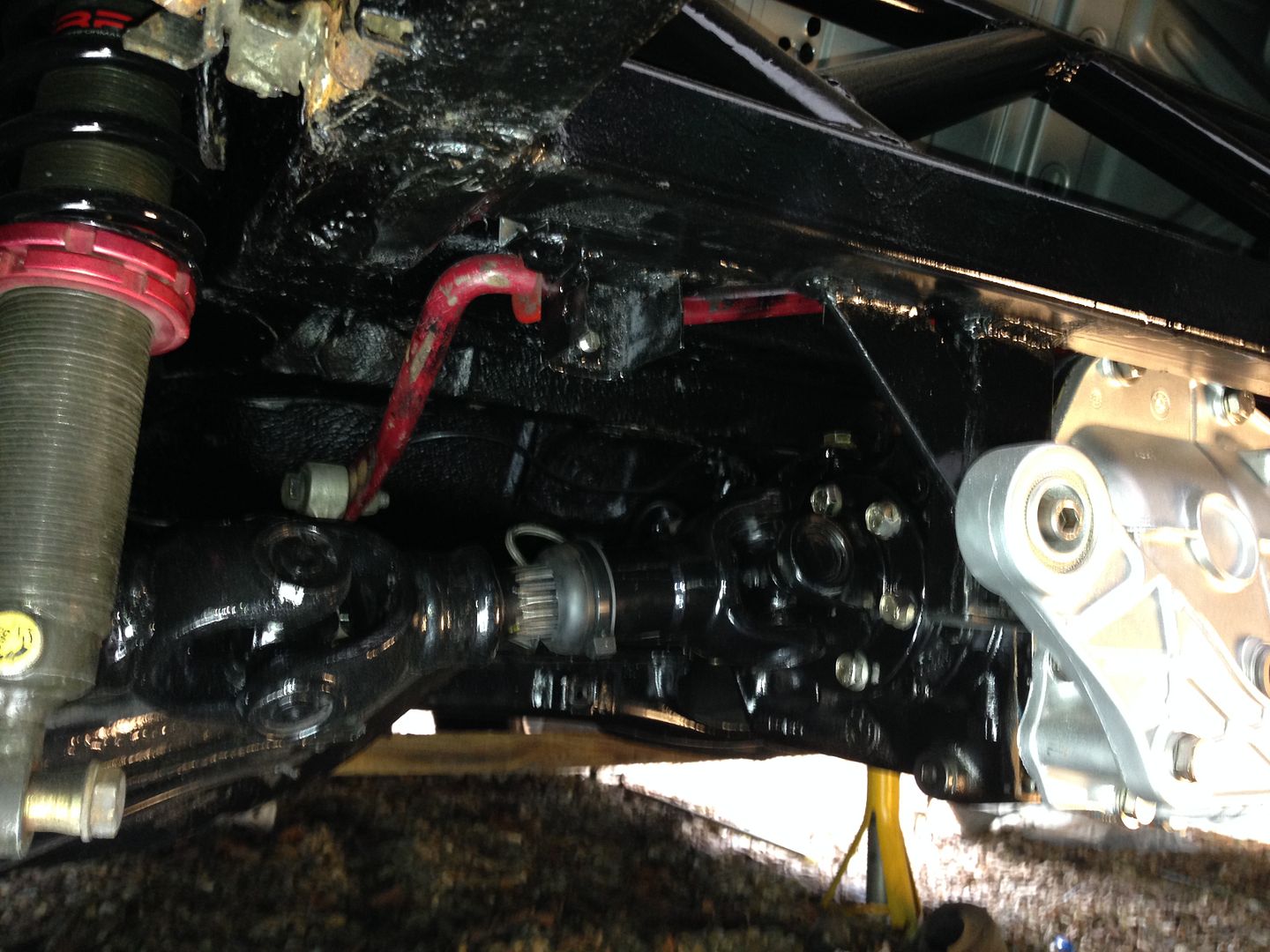

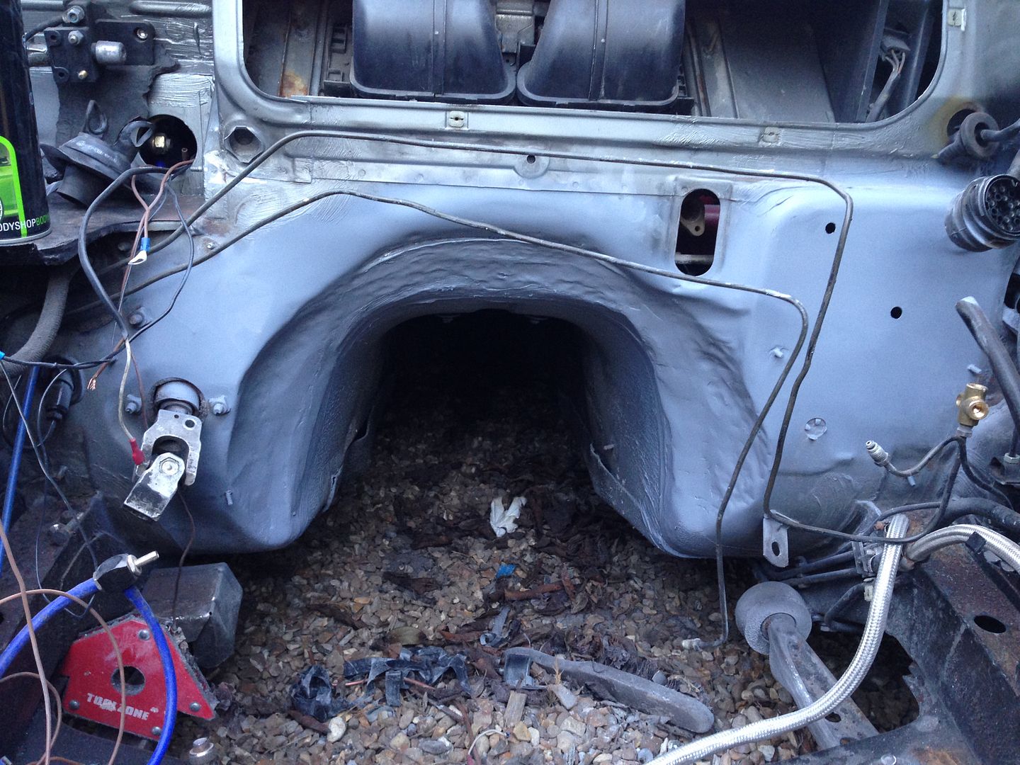

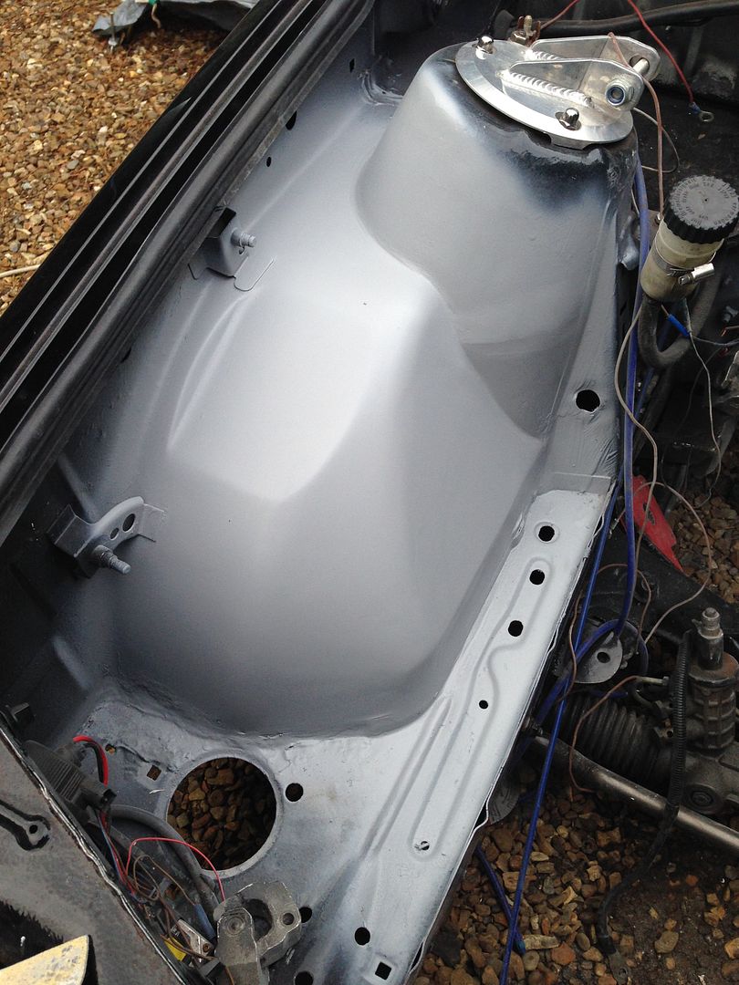

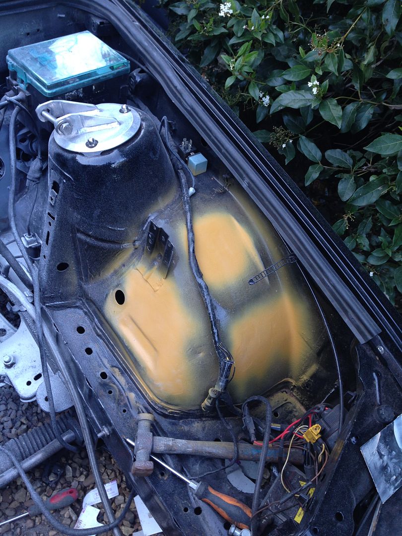

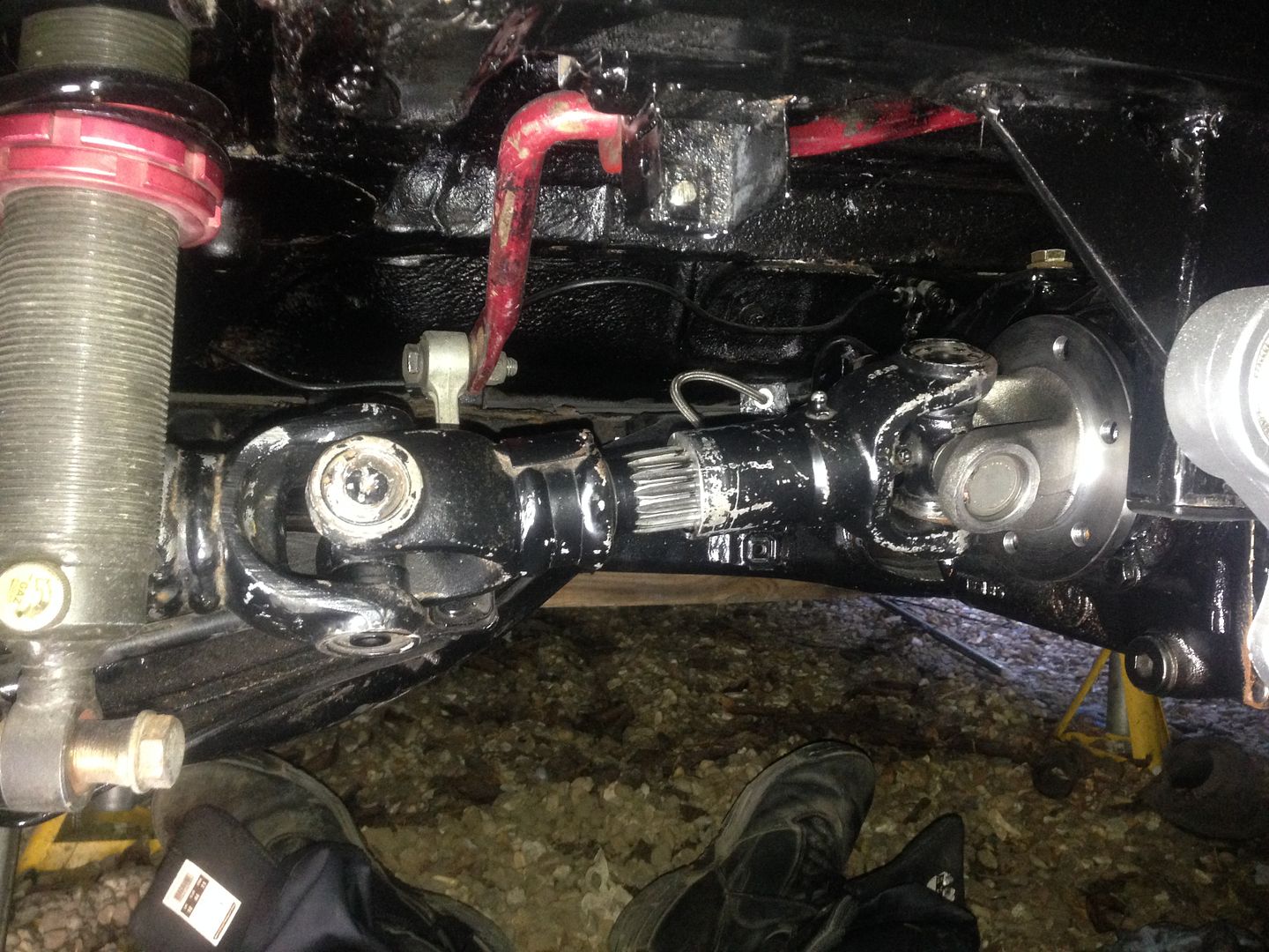

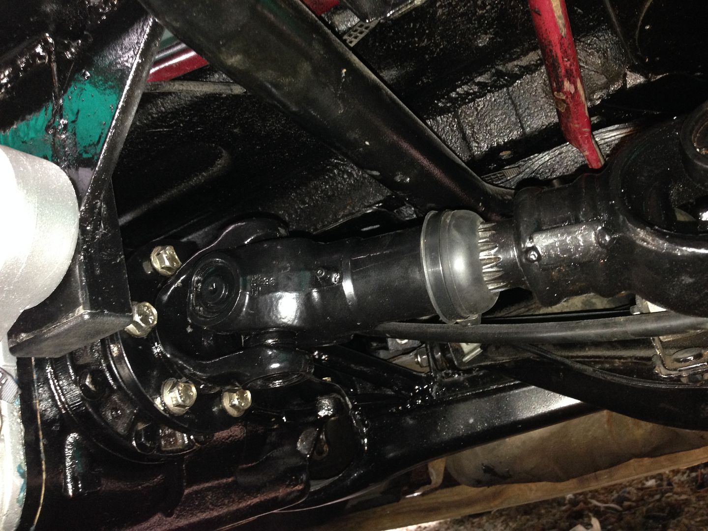

well I'm not getting very far anytime soon but I have been doing the odd couple of bits, I've started to prep the engine bay for paint and cut out all the old brackets and studs that are no longer needed

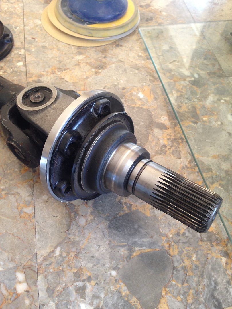

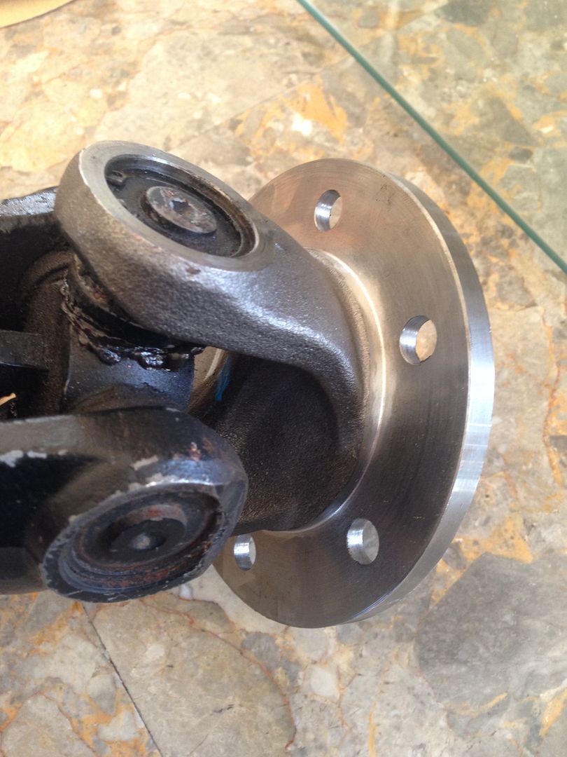

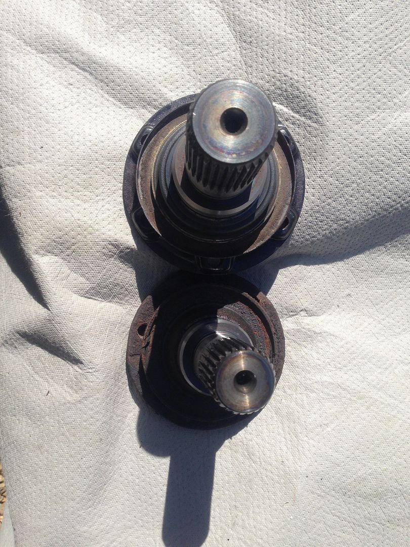

also picked up my modified drive shafts today they have a new machined flange on the end so they will now fit the bigger output flanges of the large case diff
really just have to clean them up give them a lick of paint and bolt them on then the whole rear end is now complete
phewwwwwwwww. :cool:

Looking good. Is that a half-inch socket drive on the inside of that UJ in the last pic? :?
Demlotcrew
Posts: 13329
Location: East Anglia
Post Mon Apr 14, 2014 3:32 pm
Can I ask what the reason is for the epic half shafts?
ross2009
Posts: 2762
Post Mon Apr 14, 2014 3:41 pm
Speedtouch wrote:Looking good. Is that a half-inch socket drive on the inside of that UJ in the last pic? :?
ha no but it does look like it doesn't it it's the housing of the grease nipple :)
Turbo M20
ross2009
Posts: 2762
Post Mon Apr 14, 2014 3:47 pm
Demlotcrew wrote:Can I ask what the reason is for the epic half shafts?
prob about 600ft lb of torque :)

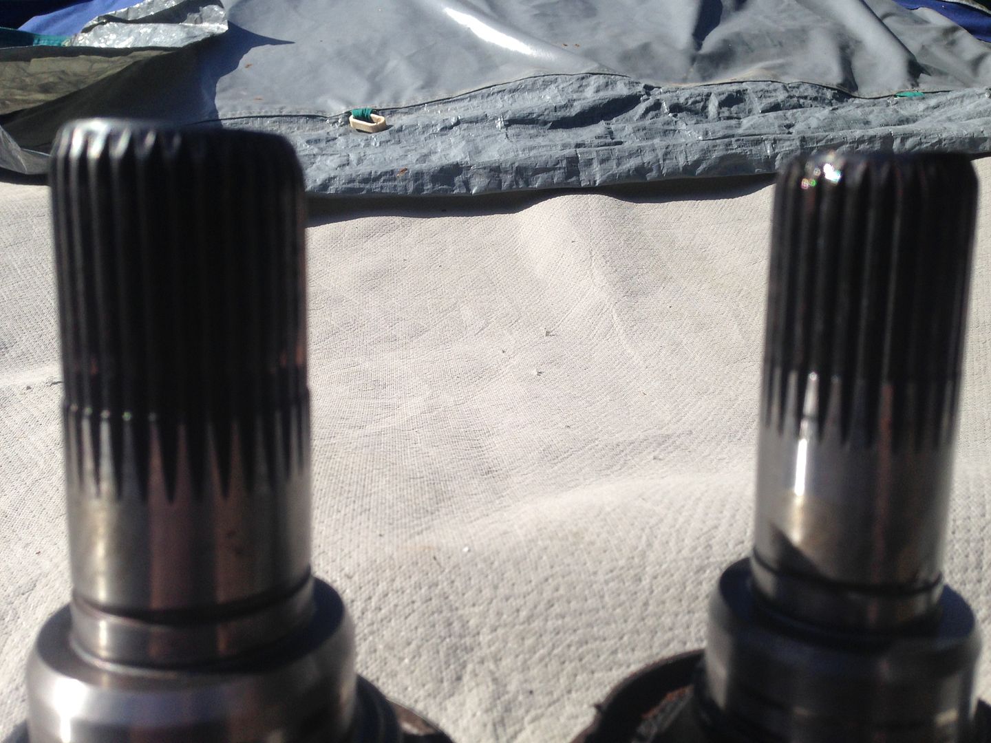

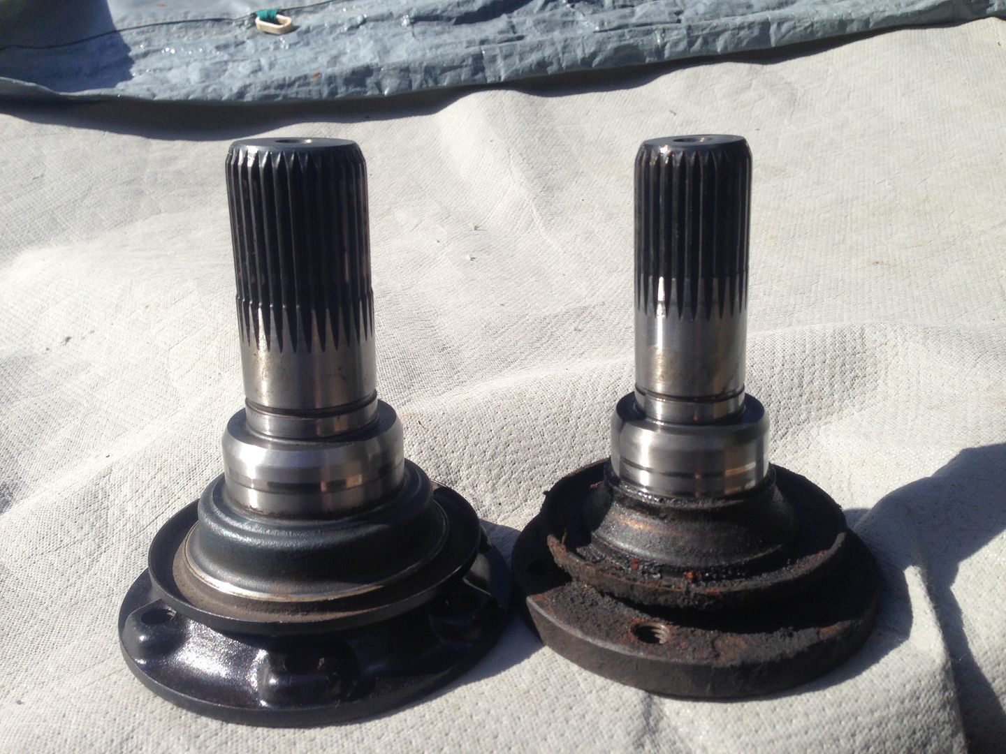

I hope the output flanges lasts.........as they are your next week point.

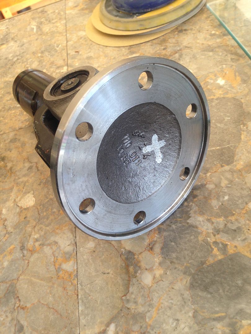

ross2009
Posts: 2762
Post Mon Apr 14, 2014 3:57 pm
what's that one from mate? medium case ?
these are mine compaired to a medium case output flanges my new ones are on the left

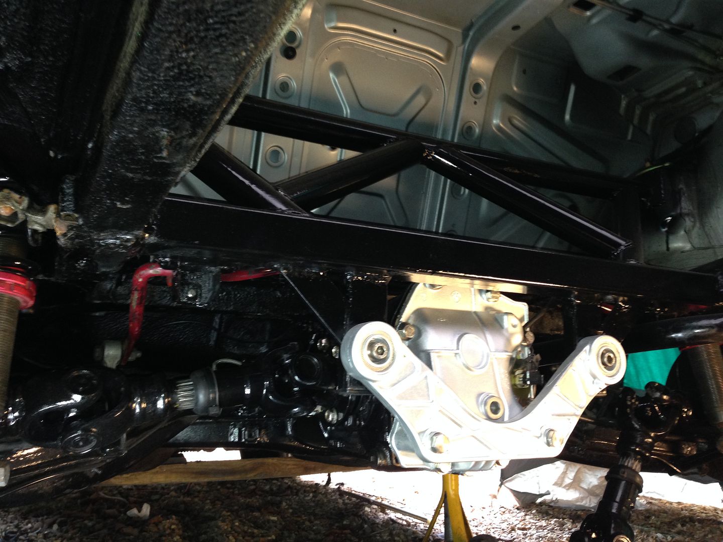

Post Mon Apr 14, 2014 8:41 pm

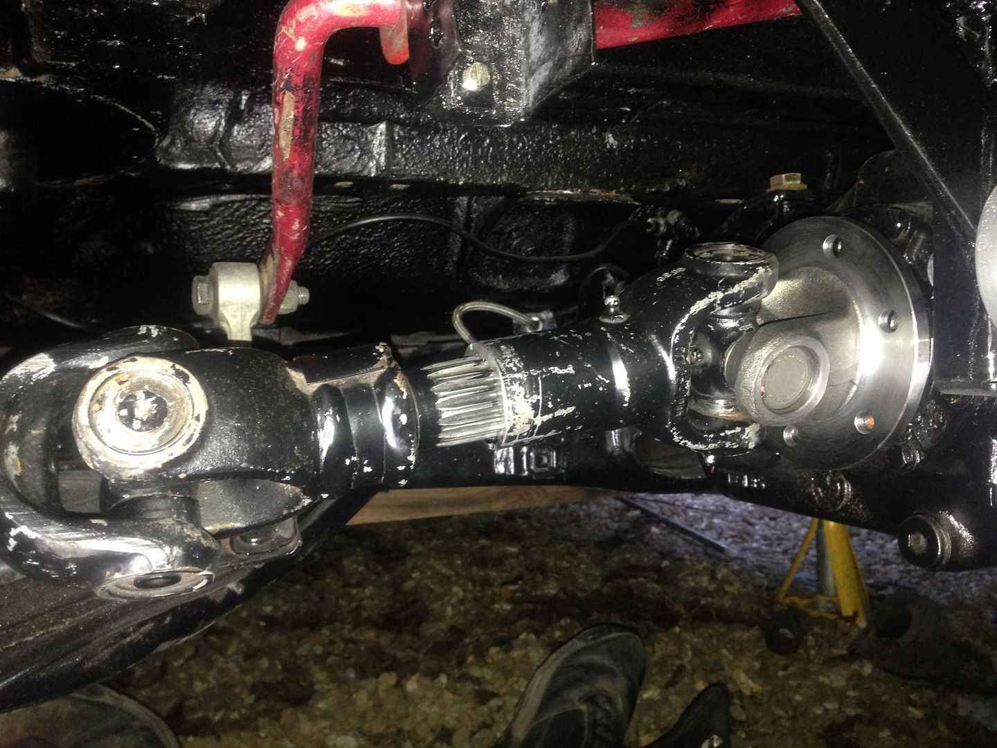

and a couple of them sort of offered up
just got to take them off and paint them now

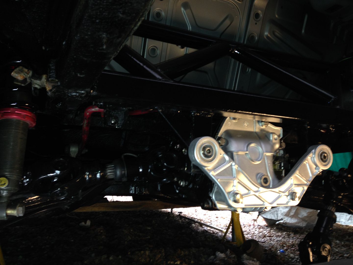

well finally got the shafts on and all
bolted up just gotta put the wheel on and it can finally get it's ass bk on the ground

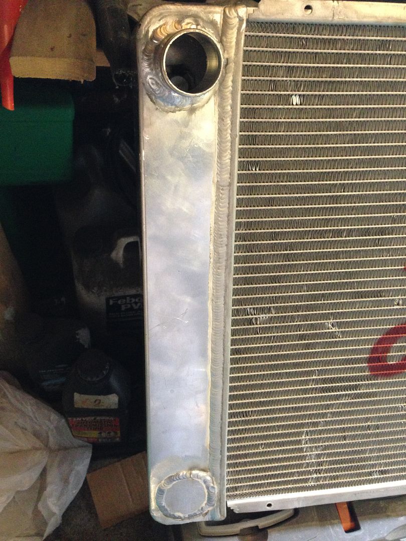

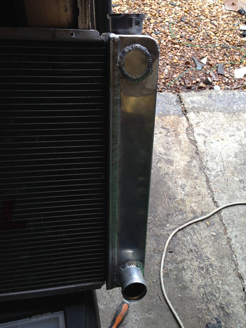

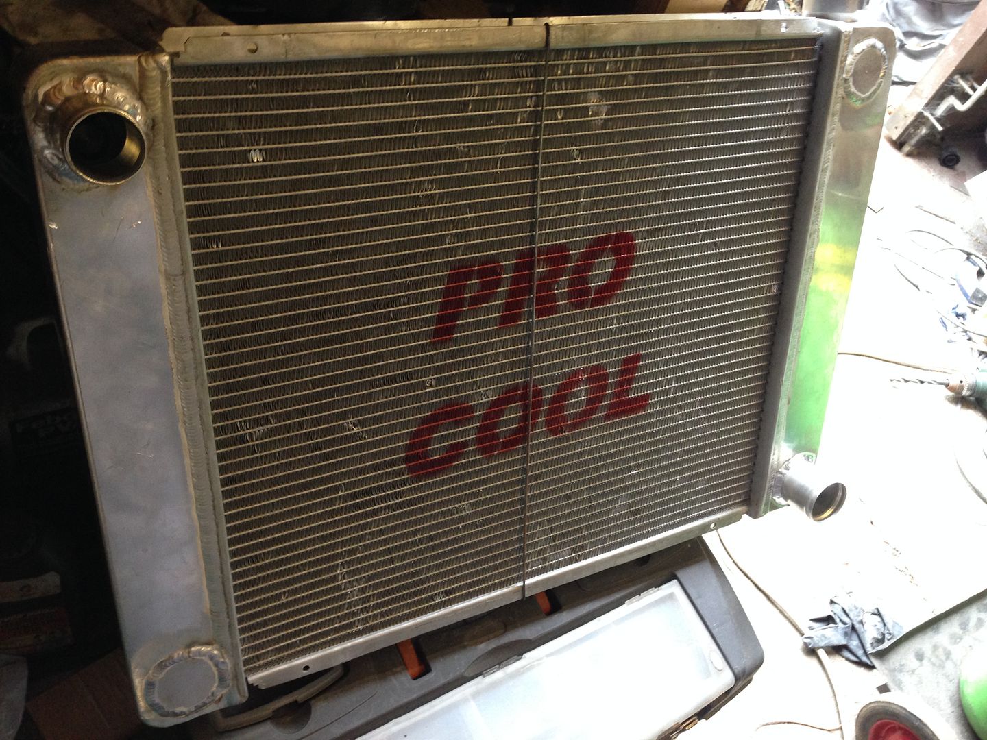

was also having a look at my radiator I got and when looking at the water pump I noticed the inlets and outlets where on the opposite side so I thought I might aswell modify that while I thought about it

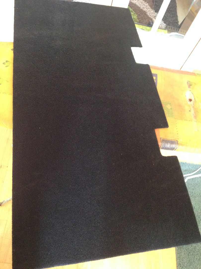

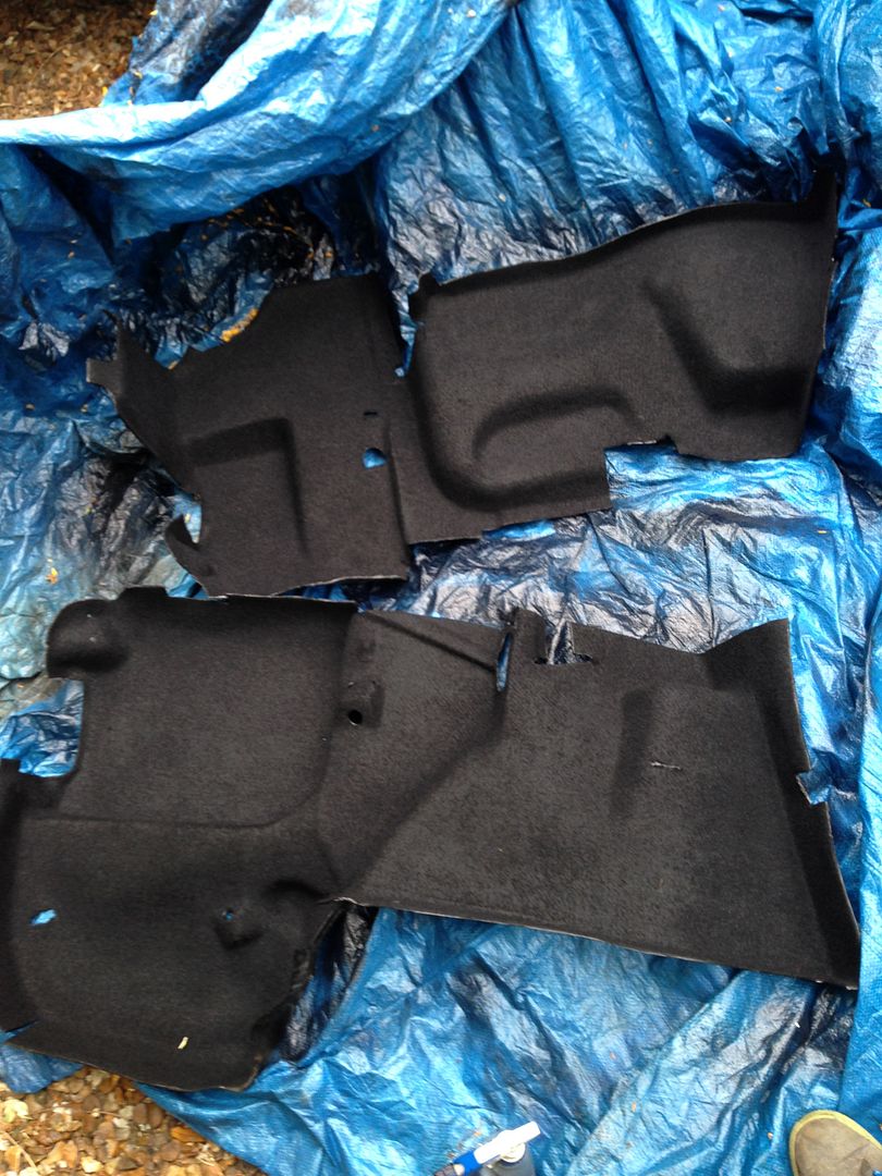

dyed my boots carpet insert things aswell

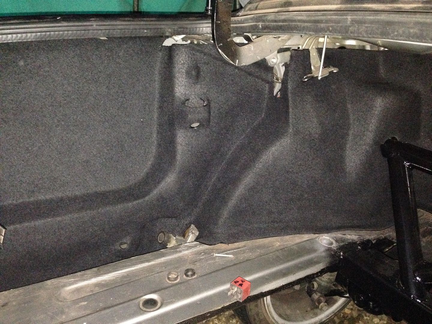

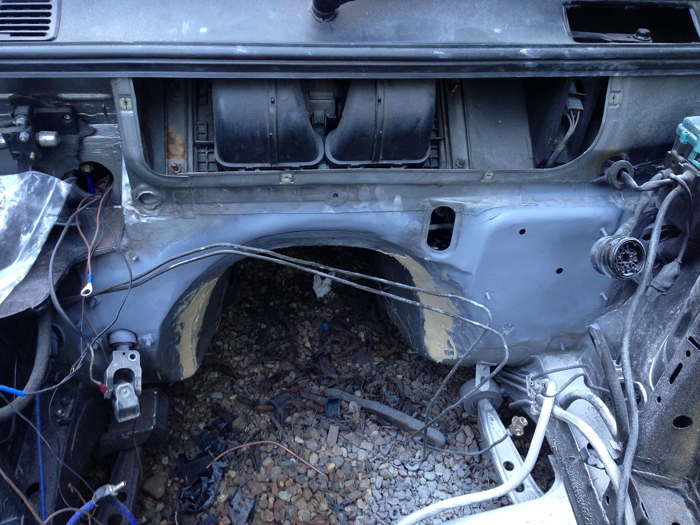

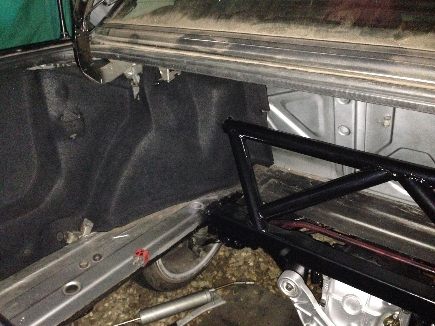

just doing finishing touches the boot area i made a new rear bk panel today and covered it

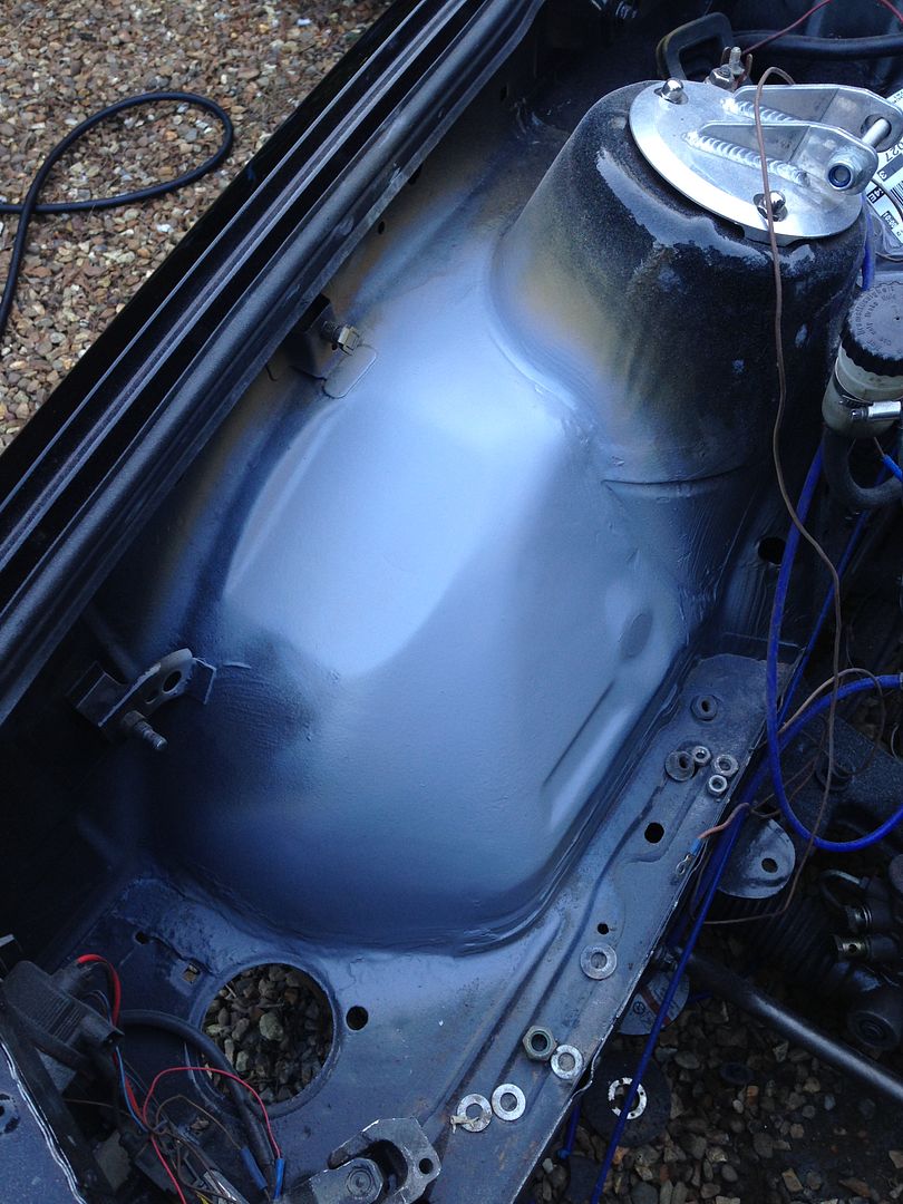

and done some more prep work on the engine bay
should all be in primer by the end of the week

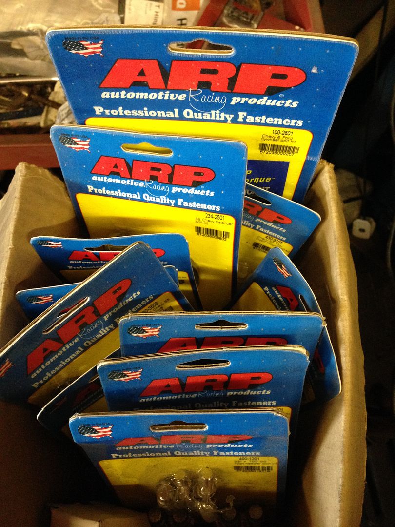

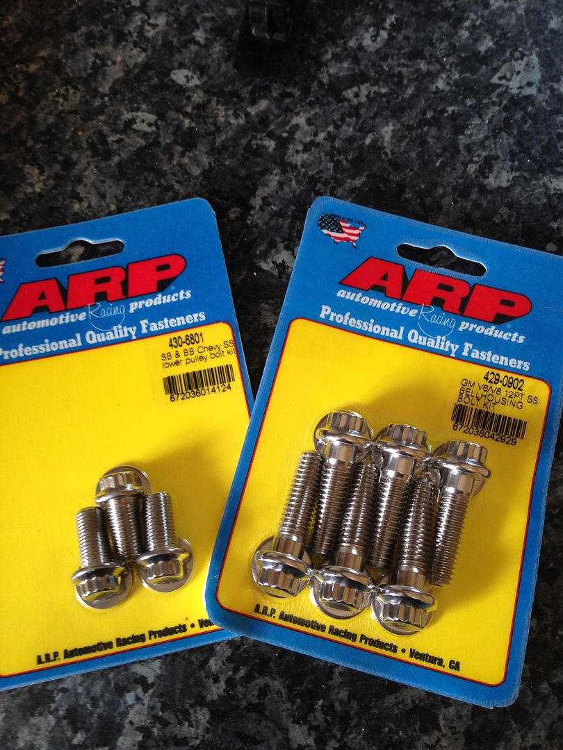

bits are still slowly coming in a couple more bolt sets
getting quite a collection now

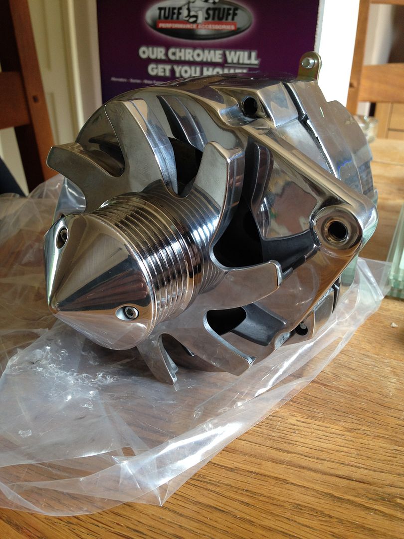

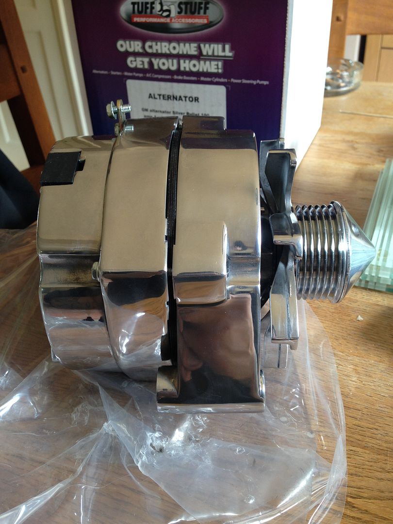

Post Mon Apr 28, 2014 3:02 pm

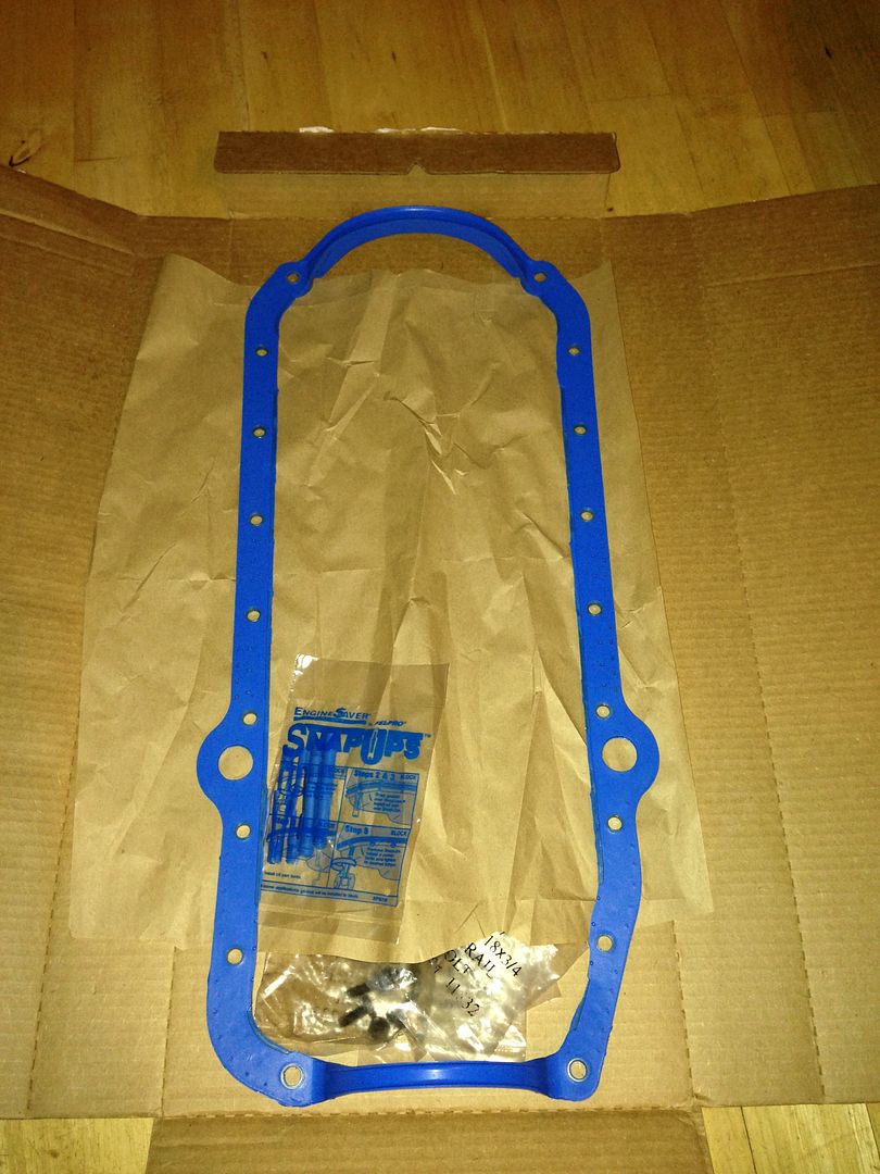

another couple of bits have turned up as my engine block is what they call a crate motor it's an engine that you can buy over the counter, they make them universal
so I had to order a special sump gasket, the engine I have has dipstick holes on the left and the right side so the gasket needs to seal both sides unlike a standard gasket as you can see in the pic
just this one gasket was £36 8O

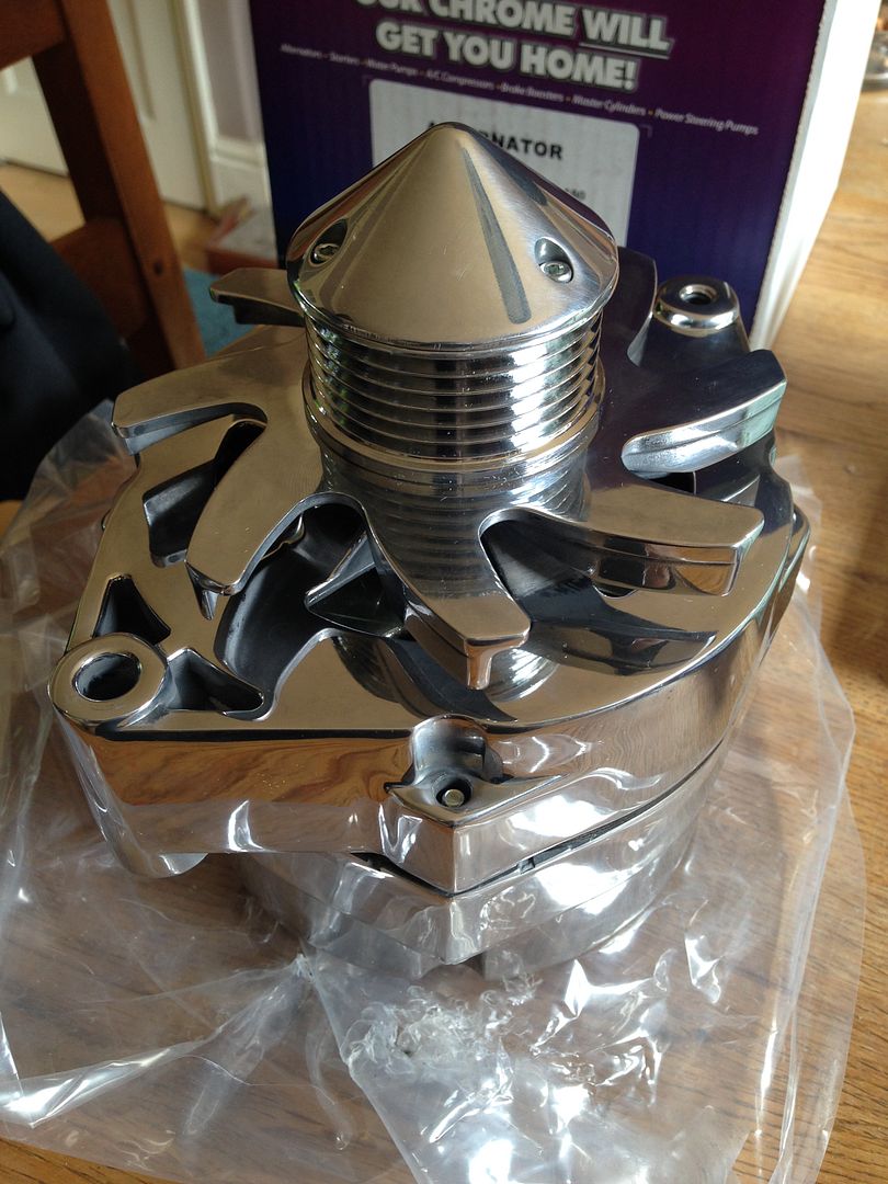

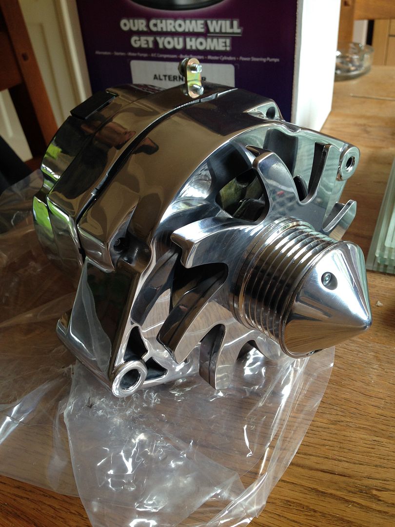

and also my new alternator has turned up today shiney shiney :)

Impressive, but are they bare alloy, or lacquer-protected to prevent corrosion?
ross2009
Posts: 2762
Post Mon Apr 28, 2014 4:08 pm
they're just polished ali the brackets are clear powder coated
so a lot of looking after :)
