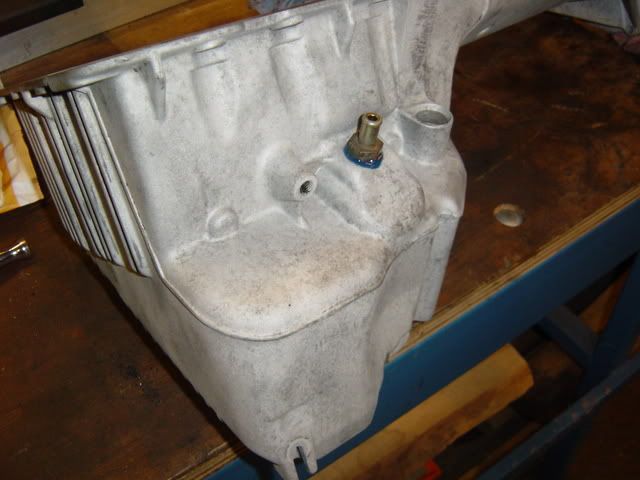

Now then,
Sorry about yesterday y'all. Had a busy day today and took lots of nice pictures for your perusal.

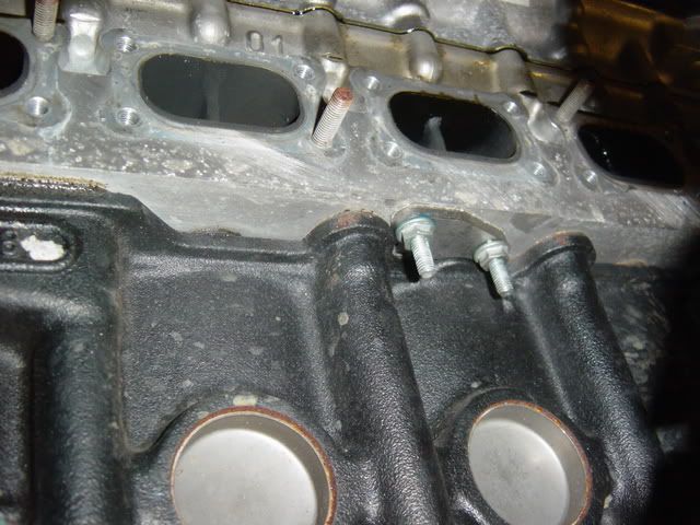

Firstly I had to finish the work to the underside of the engine to get the sump back on. I wasn't too pleased with the crusty appearance of the sump so I blast cleaned it first.
Before:
After:

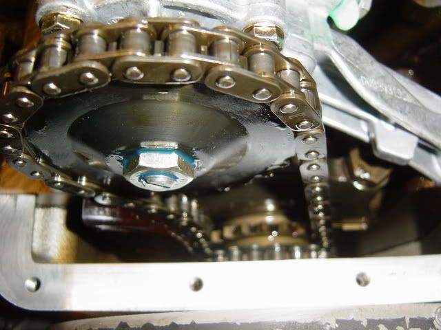

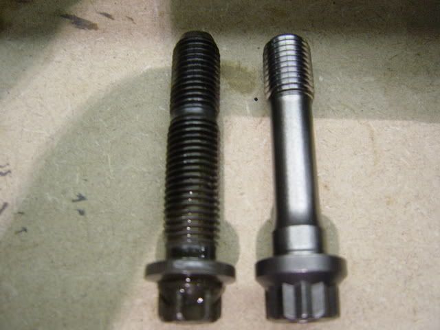

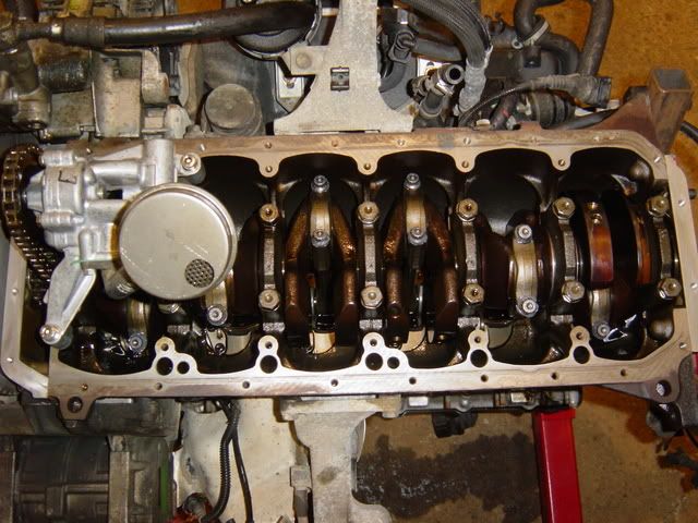

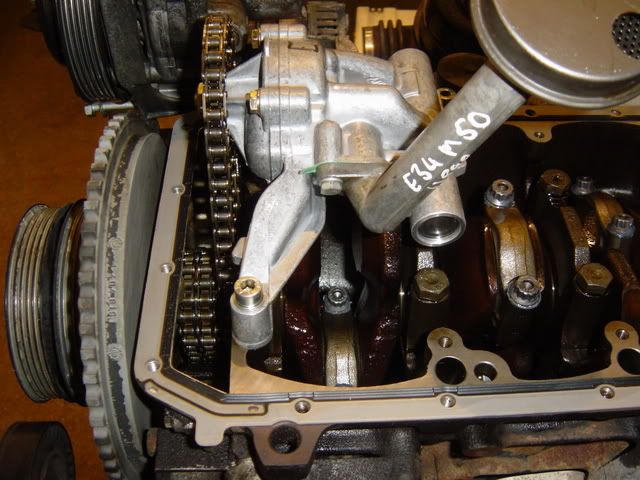

That's better! So before the sump could be fitted the ARP con rod bolts had to be put in. Here is an ARP next to an OEM rod bolt:
These are torqued to 70 lb/ft three times, on then off, using the molylube supplied. A 12 sided 11mm socket is required as they have different heads to the OEM torx style.

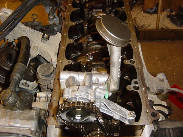

Now the oil pump was fitted into position finally with the E34 M50 pick up pipe. The oil pump locates onto two dowels and is secured by three M6 hex bolts. Note there is no gasket between the pump and the block. I used Loctite 243 on these bolts and also on the drive cog assembly.

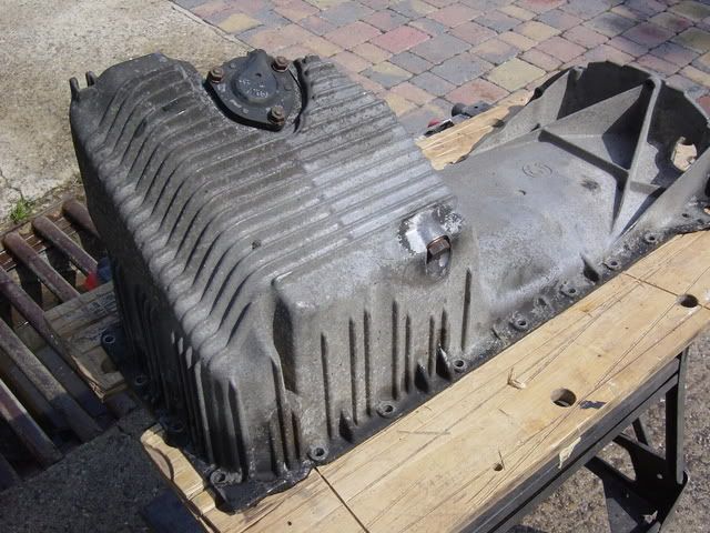

Next the sump was fitted with a new gasket and secured in place with a couple of bolts. Note that the S50 sump bolts are generally longer than the M50 type. As some of the holes are blind be careful that they are actually done up to the sump. Ideally you would use all the M50 sump bolts instead.

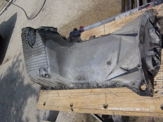

I had already removed the baffle from the sump and turned the engine over a few times to check for clearance to the sump.

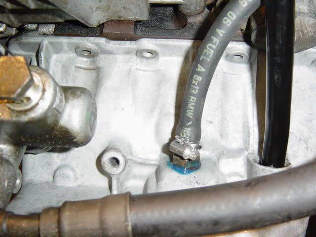

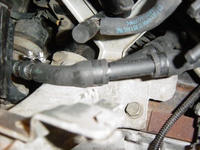

Next was the oil drain. The S50 has two oil drains from the plenum that tee into one. In the pic you can see that I am pointing to the original drain location. I now needed to get that pipe onto the new drain point on the sump whilst maintaining a fall in the pipework.
Pipe location:
This is the drain pipe arrangement as fitted: (removed for picture)
I removed all of the ear type clips from that tee piece and removed the pipes to study which way to best orientate everything to fit. In order for this drain to work properly there must be a fall continuously in the pipe.
This is what I came up with after some careful trimming and positioning:
Now to extend the pipe using a 10mm steel pipe/insert I had spare:
This was then fitted with a length of OEM 8x13 fuel hose to meet the new tapping in the sump. I used BMW hose clips because I am sad, of course:
Centre of pic:
Job done.

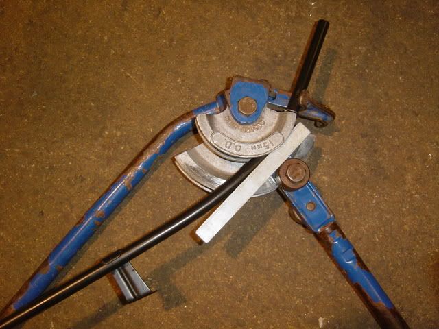

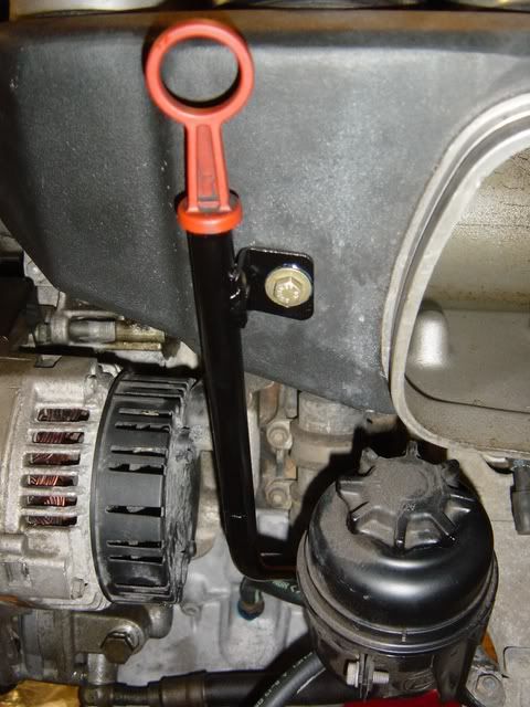

Now for the dipstick. The S50 tube wont fit as it is, and apparently won't read right so I decided to modify an M50 item that I had. I put a pair of calipers on the dipstick tube and amazingly BMW in their wisdom had made it from 15mm o.d. tube. This was good news as it is the same size as 15mm domestic copper plumbing pipe.
So I called a plumber in
With some careful positioning and a few sneaky printouts from busters S50 thread I figured where the dipstick tube needed to go. The M50 tang/bracket had to be cut off and rewelded but after some careful bending, welding and painting I ended up with this. I drilled the plenum and threaded it to M6x1 then used a BMW bolt (sad again) to secure it.
Having spoken to buster (at great length - cheers mate) today, he has done his a bit fifferently but to the same end.

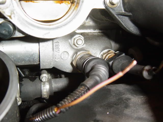

So now for blanking off all that air emissions smog pump nonsense. Here it is, new blanking plate and gasket fitted:

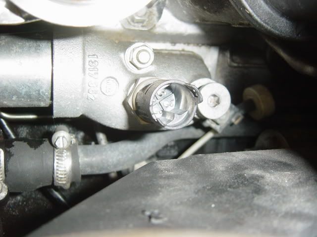

Next for the coolant sensor. I had no idea this had to be done, thanks again buster for the heads up. I didn't know this but for the E30tem,p gauge to work the S50 has to be fitted with the M20 coolant sensor. Again, BMW have been kind enough to leave a spare port for it to go in:
Blank hex plug to right of S50 coolant sensor:

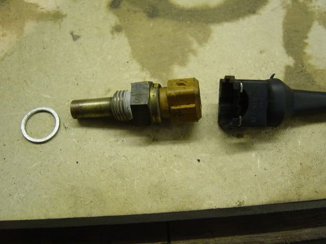

M20 brown coolant sensor and spare plug:
The Brown/violet wire on pin 1 of the S50 sensor needs to be pulled out and connected to the M20 sensor:
Sensor fitted:

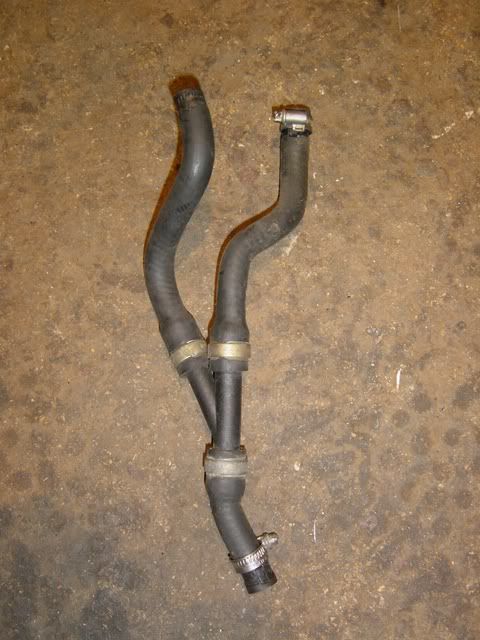

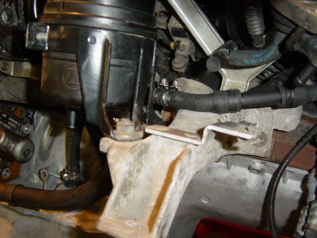

Pipe location:

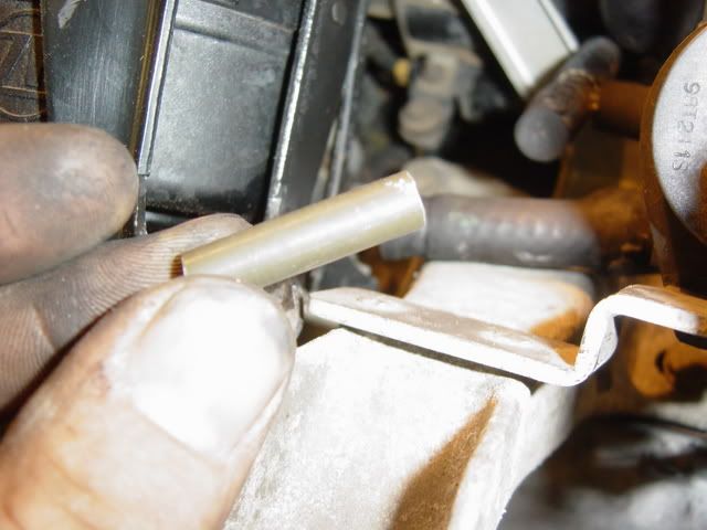

Centre of pic:
Job done.

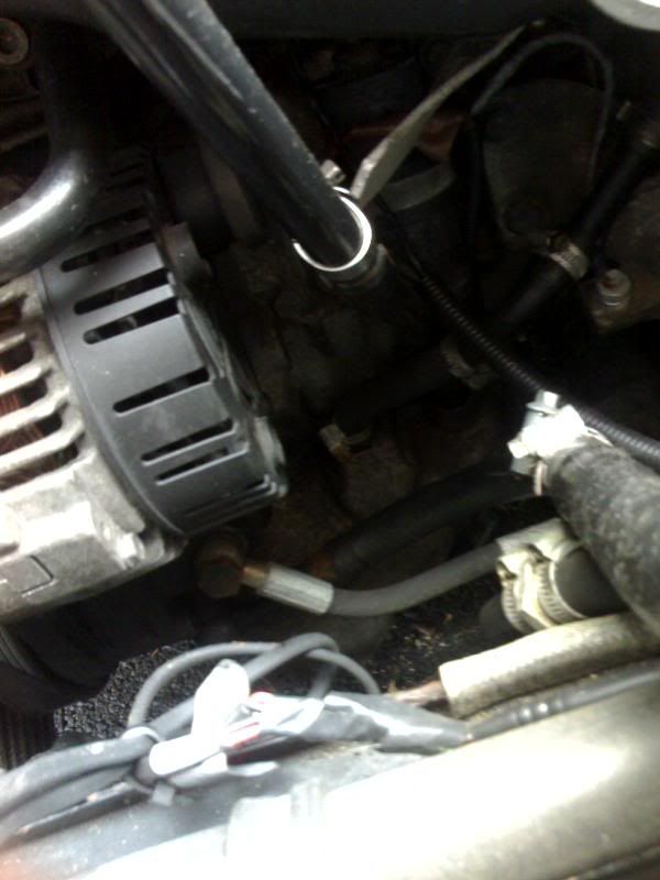

Sensor fitted:

Don't forget - left hand thread on the 17mm oil pump sprocket nut!
Toby_Unna
- Boost Junkie
- Posts: 2183
- Location: Sheffield
i certainly would, my m30 one undid itself and the first thing i knew was the oil lightold_skool_2002 wrote:I also plan to tack weld the pump drive cog nut in place. Belt and braces!
no doubt due to some monkey installing it finger-tight
