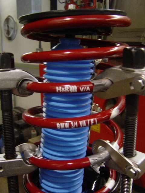

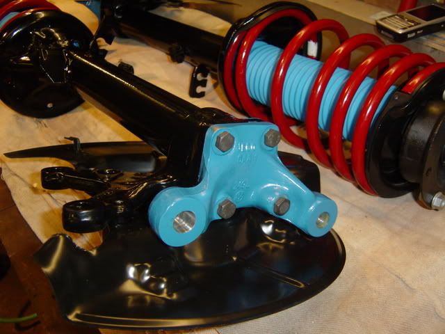

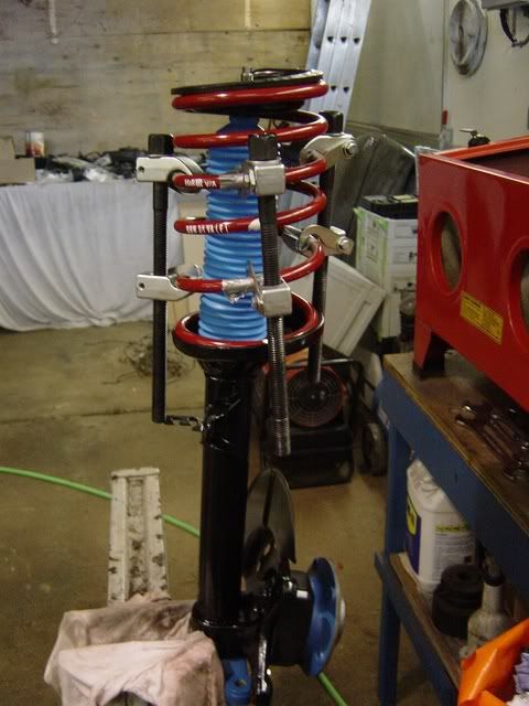

Hi all,

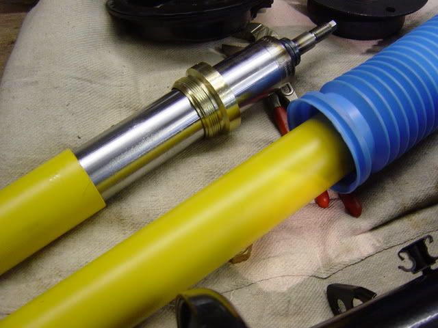

Managed to get the shocks and spings picked up and fitted today.
I got the HD Inverted Bilsteins front and rear, and H&R -30mm spings. Although these are for a six pot they should make mine sit a little lower with the S50 at the front giving a nice look.
Pics speak a thousand words so I'll shut up.

Great setup to drive with! Just a little firm at the front with the M20. Should be spot on!
... And I don't know what you're doing with the ARB's, but with the standard ones, the touring will remain slightly understeery, (if you don't do silly things
) which might be a good idea with the couple of poneys you'll soon have, to not end up in the ditch stright away.
And the balljoint brackets just show your usual attention to detail. Great car!

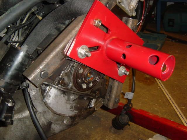

Oh yes, the engine.

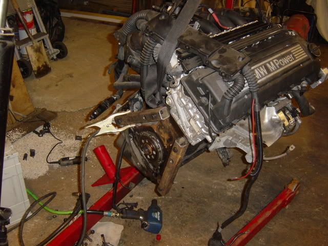

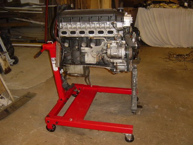

Well I got it back today. It was still on a pallet so I needed to lift it up with a crane and put it on a stand. Easy? No!

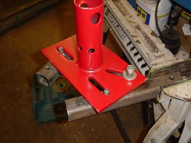

I bought a reasonable engine stand that was on offer at machine mart. They do two different kinds, this is the larger. Only £40, bargain. Only real problem was the fittings that they provide didn't really match well enough to the S50 block. The only solution was to fabricate a mounting jig for it.
So I removed the clutch pressure plate, driven plate and flywheel and got started
I used some 40x40 steel box cut to length and welded in some M12 cage nuts to take the load. These were then mounted to the cast parts of the block, again with M12 bolts. Then I welded a brace across the whole lot and drilled and tapped it to take the standard engine stand mounting.
Then I fitted it all up:
Next was a very nervous lowering of the crane to see if all was well
I'm not sure what the S50 weighs, especially with all these ancillaries still fitted like it is, howver the stand took the load without any signs of distress. Now I can rotate it around and do all the jobs I need to do.
Tomorrow I'm going to remove the sump, fit the ARP rod bolts, swap to the new S50B30 oil pump, S50B32 drive cog and new chain, new oil pick up from the E34 M50 then fit the new E34 M50 sump. I have all the parts now including the sump gasket etc. so hopefully tomorrow night I can post some serious photos/progress.
I need some torque settings for various parts so I'll be pestering Mr. Haynes tomorrow...

It should be up to the job.Ive had an m20 hanging off the cheaper machine mart stand and it didnt snap.A bit scary moving it though as it only has 1 leg as apposed to your 2.

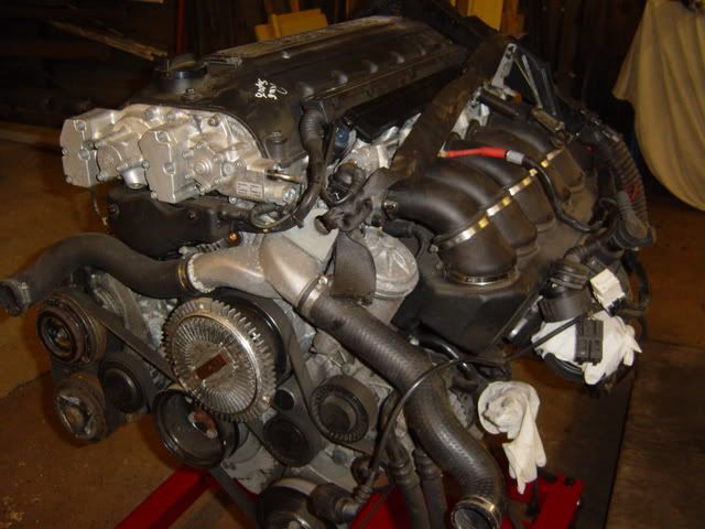

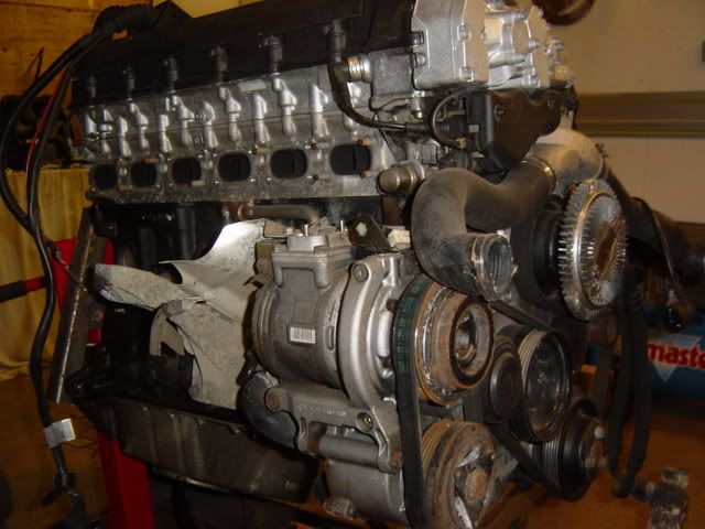

Today has been a very busy day in S50 land. I have done a kind of mini "how to prep your S50 for an E30" tech article. I have taken over 80 pictures, here is a selection and a brief description of what I have done.
I started with the engine mounted firmly in the stand, like so.
Then the oil was drained/vacuumed, with my PELA oil extractor via the dipstick tube:

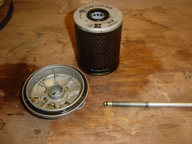

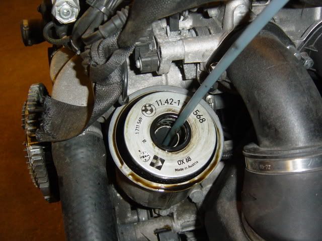

Then the oil filter was removed and the volute was sucked out to avoid as much mess as possible:

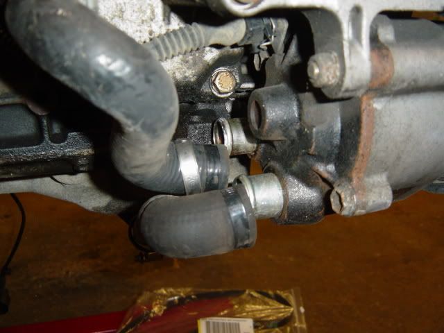

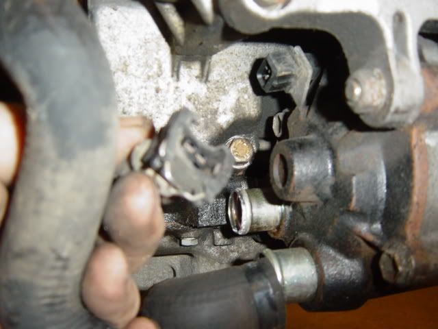

Then I removed the oil cooler, viscous fan coupling and air emissions pump. This is pretty easy.
Oil cooler connection:
Viscous coupling

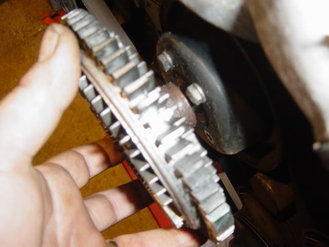

This is the S50 belt layout, note two belts:

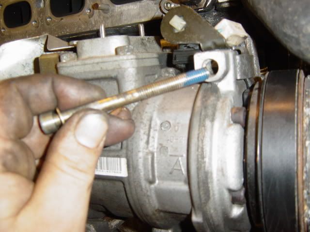

This is the emissions pump, not required for E30 use. It lives under the A/C compressor. I'm going to be retrofitting factory A/C so I need to keep the compressor. Ordinarily the belt and tensioner could be done away with altogether. I'm using the 880mm BMW genuine belt. this will just run the compressor, pulley and tensioner, minus the emissions pump. The tensioner is manually adjusted on this belt. The belt that runs the water pump, alternator and PAS pump has a hydraulic tensioner.
This is the rear of the emssions pump with the hoses removed:
Then remove the electrical connection to the pump:

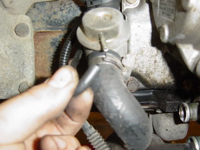

And the venturi tube from the inline purge valve:

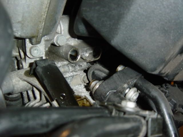

Then I removed the connection where the pipe meets the underside of the cylinder head. This will then be blanked off with the SA spec, (non emissions equipped) blanking plate and gasket.

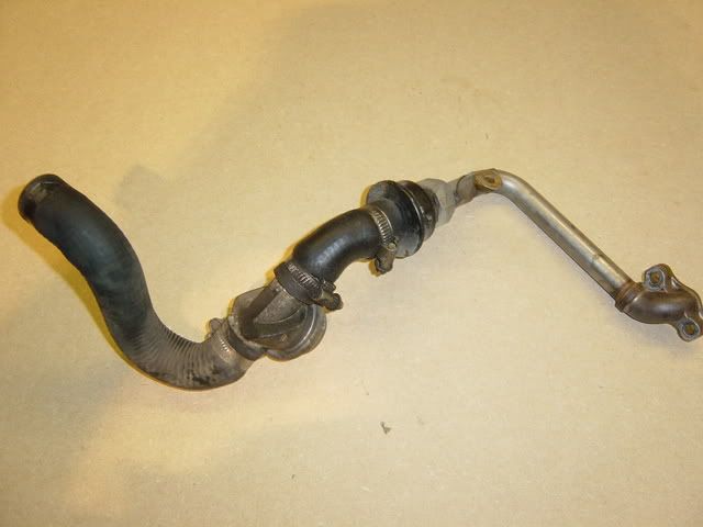

This is the whole pipework assembly for the emissions system. This can be "set aside"

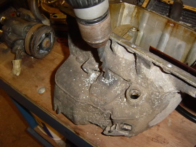

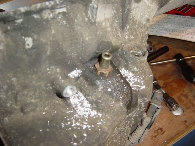

Now it's time for the sump. This is pretty easy too. Just remember to loosen the PAS pump out of the way otherwise it will foul the sump. Remove all the sump bolts, oil level electrical connection:
and oil drain.
Then the sump will come off like so: (here's one I prepared earlier)
Viscous coupling

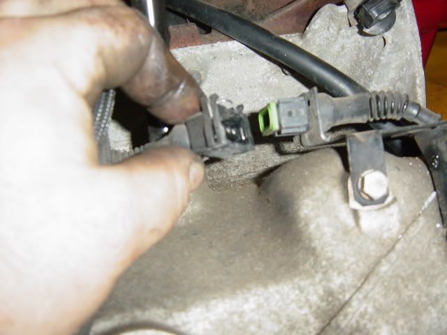

and oil drain.

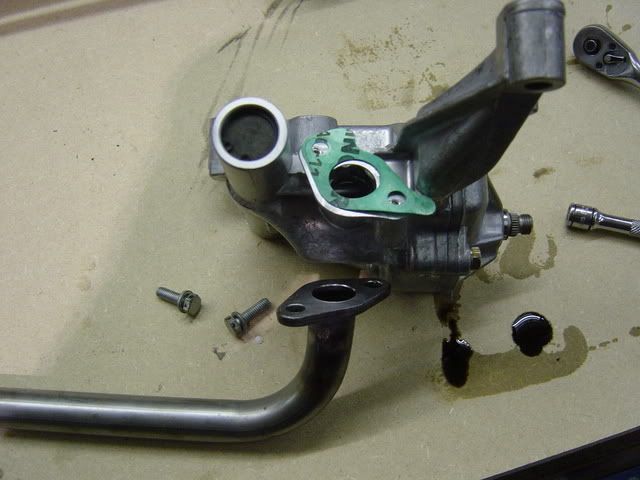

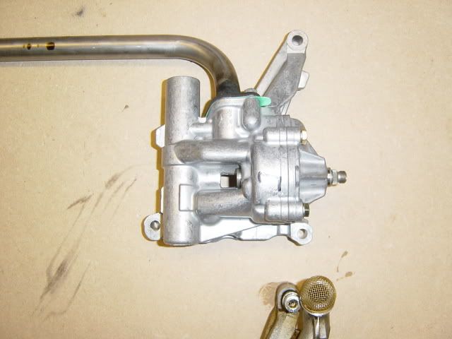

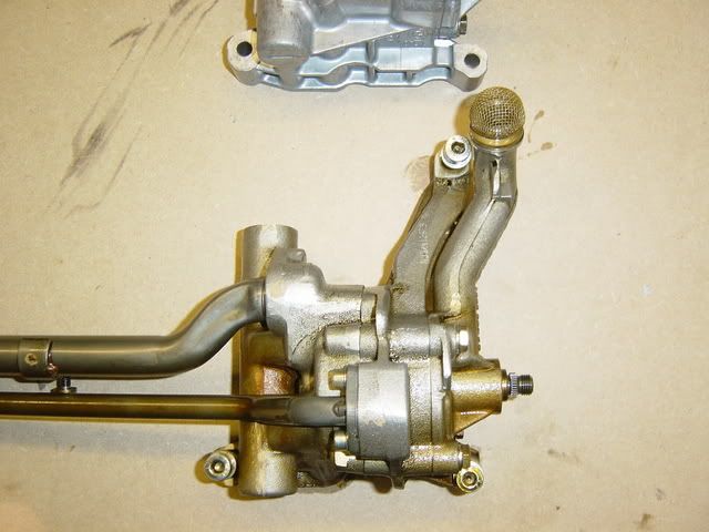

Ok,
So now the sump is off, it's time to do the work on the oil pump and sump modifications.
This is the S50B32 (as fitted) oil pump.
It has oil pickups in all the wrong places to suit our new E34 M50 Sump. So now I have to remove it to fit the S50B30 oil pump from the pre-evo model. The drive cog needs to be dropped off with a 17mm reverse head nut, followed by three 5mm hex head bolts and it's off. The drive chain justs stays on the cog and the whole lot is moved aside.
This is the S50B32 oil pump (as removed):
And the S50B30 oil pump (replacement):
Here are the two pumps side by side:
Now I need to remove the oil pickup from the new pump and fit the E34 M50 oil pick up pipe. This is quite simply two M8 bolts and job done.
Now the pump can be refitted complete with E34 pickup pipe:
Different angle:
Because the original pump uses rearward pipework there are two brackets to be removed from the main bearing caps. These are on no. 3 and no. 5 main caps.
Next job is to drill the E34 M50 sump to fit the plenum drain from the S50:
This requires an 'odd' M12x1.5mm tap. Thankfully I had one lurking around and with telephone support from Buster it was a straightforward job. I will refit the drain with a suitable copper washer and loctite it in place later. I also plan to tack weld the pump drive cog nut in place. Belt and braces!
Tomorrow I plan to finish the above, fit the ARP rod bolts, refit the sump and clean up some more components.
Different angle:
