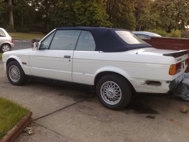

+ a yard full of scrap turds
- Posts: 22666

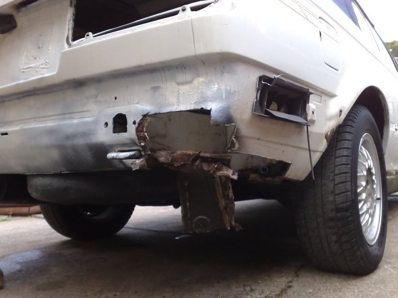

the turds home ready for some welding action, got a grinder and welder sat in the garage and plenty of zinc primer, seam sealer and sheet metal
had to remove front valance to get onto car transporter
excuse rear valance, work in progress
Just need some side bump strips and a rear bumper and i think thats everything.
Think i'am sorted with a rear bumper from Dezzy
ps its not rust behind that lower bump strip its waxoil, cannot use enough of that stuff
should be good to smoke about in for a year at least when done

Nearly decided to scrap it today and gave in but something made me carry one and i'am pleased i did as two bits of welding are now complete. uploading pics soon. welding looks pretty shit and it alot harder than two nice bits of clean metal on the floor but ive made sure plenty of rust proofing is done and its solid. if it last a year or two i will be happy

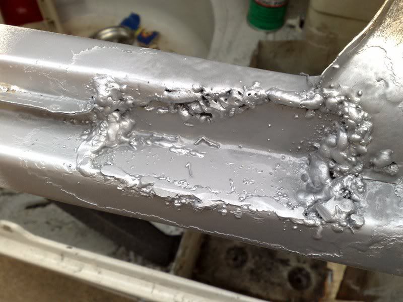

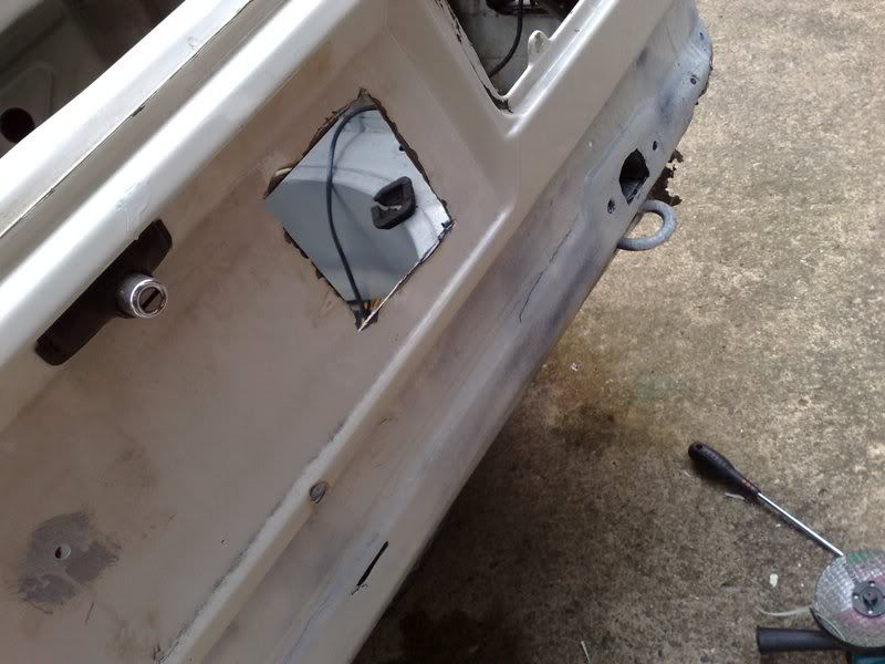

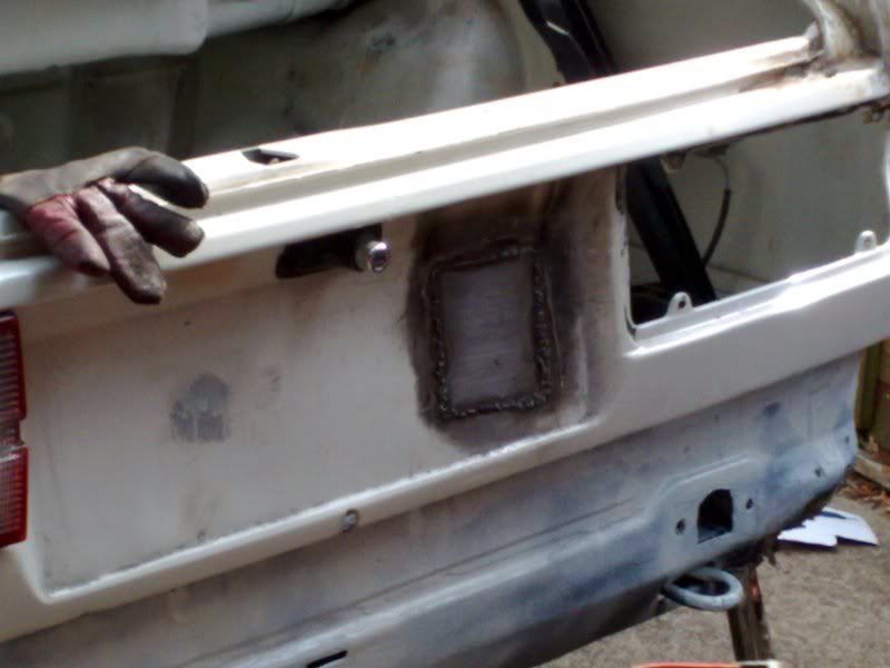

Started some welding today, first i attempted an easy ish bit the rotten area behind the rear number plate.
I cut out the rot and made it as square as i could

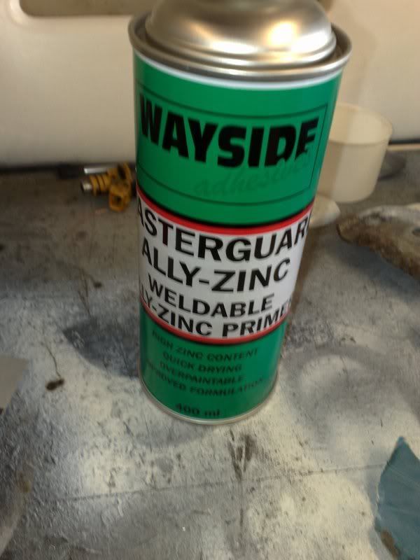

i then removed some paint with the grinder round the hole for the welding. i used some weld through zinc primer on the bare metal before welding so if there is any metal hidden thats not been welded it wont start rusting.
Weld through zinc primer
Not the best pic as i was in the garage when i took it. there were a few gaps here and there so again i made sure plenty of zinc primer was sprayed in the holes and all over the welded area after i had cleaned it with a drill and wire end thingy.
it kept setting on fire hence the black
Going to use a prefacelif numberplate surround to hide it as its probably longer than a numberplate.
after i had sprayed both sides with zinc primer i painted plenty of seam sealer on top. did the same to both sides.

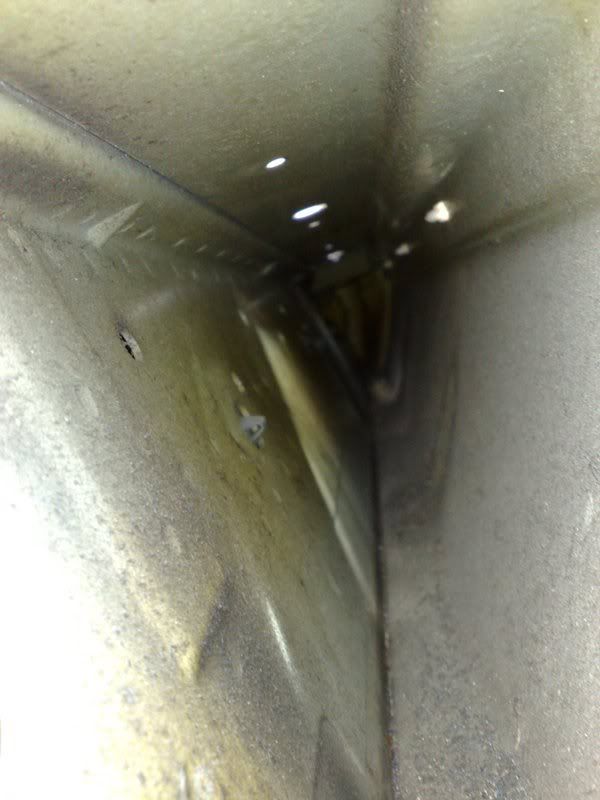

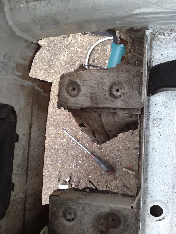

started to cut some of the boot tidy out

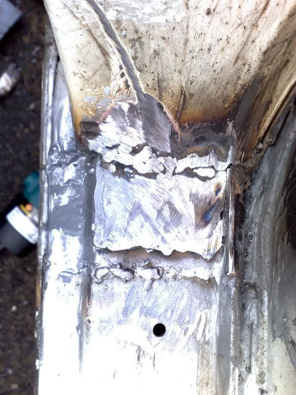

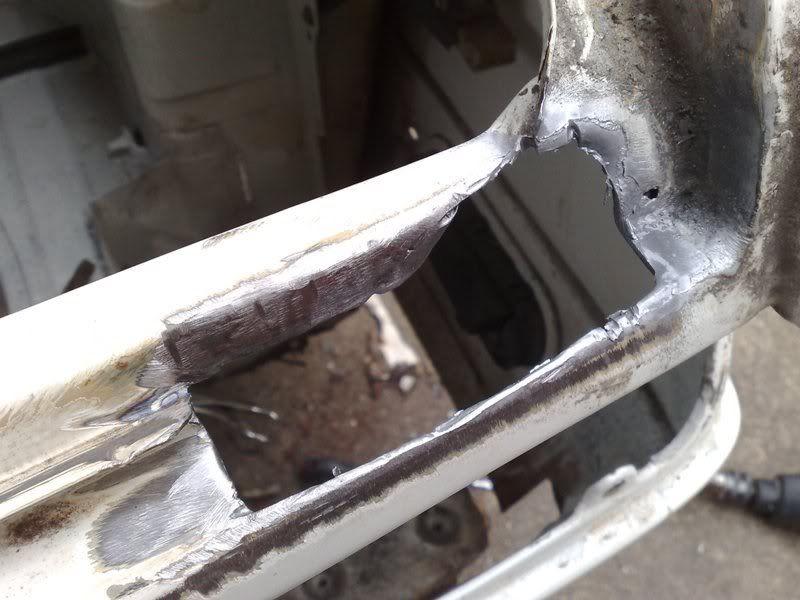

next i tackled a corner of the boot
did the same sort of process to the first patch using plenty of weld through zinc primer.
Not brilliant i know
i kept aiming wrong
decided to call it a day so cleaned it all and sprayed some zinc primer onto it. will grind it down and use a light skim of filler on it.
any critasism or advice welcome

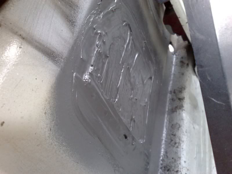

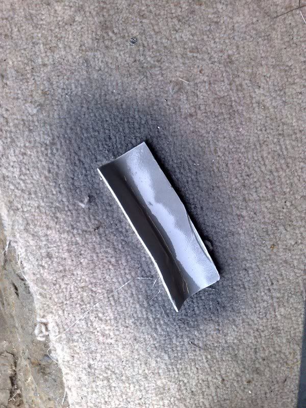

You're doing well fella, good work.
I'm planning to do a welding course over the winter at nightschool. I'm keen to learn good habits early to avoid setting any of my E30s on fire.....

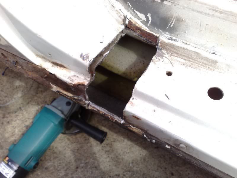

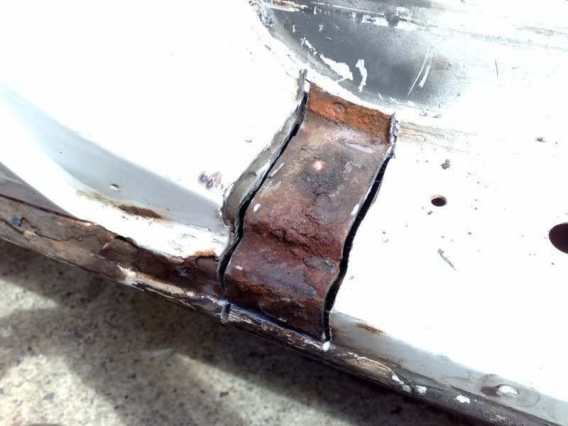

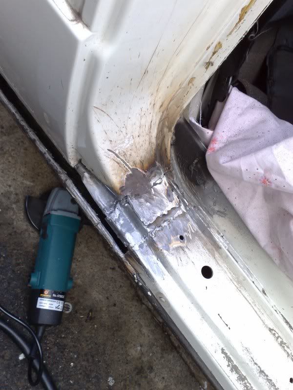

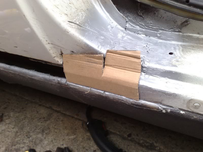

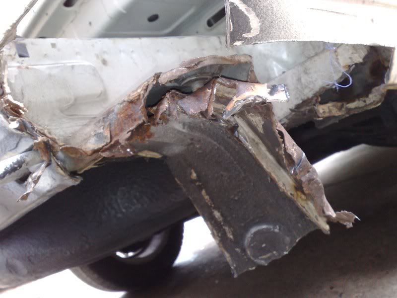

Started doing the door shut and above sill. again not the neatest thing but i'am really pleased as i think it may be an almost invisible repair when done. Maby
need to have a think about the side strip as there are two panels at the top of the hole that need welding
started by cutting rot out
sills look good

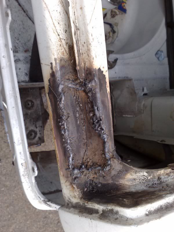

apart from the inner arch

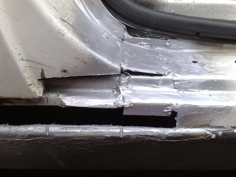

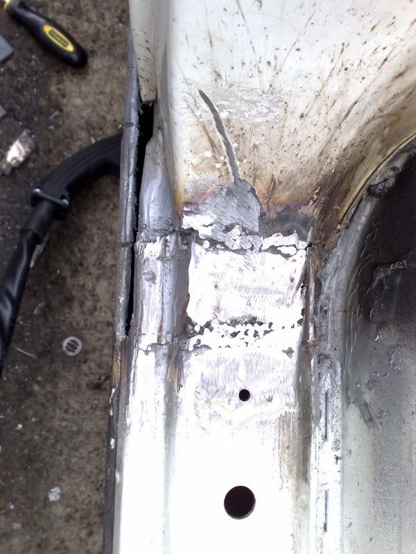

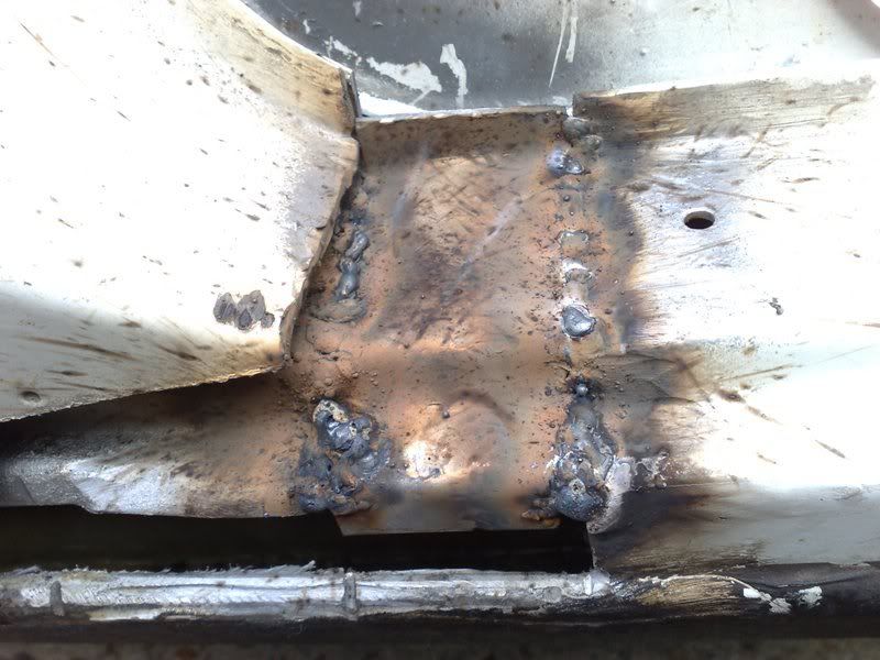

made a plate and welded it in
bit more welding and a load of grinding later

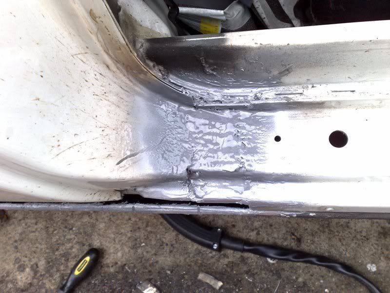

More welding ad grinding
tonns of zinc primer making sure it all seeps through the gaps
ready for next template, looks a mess but with a light skim of filler i hope it will be more or less invisable. the "extra bit" on my patch at the bottom needs grinding off

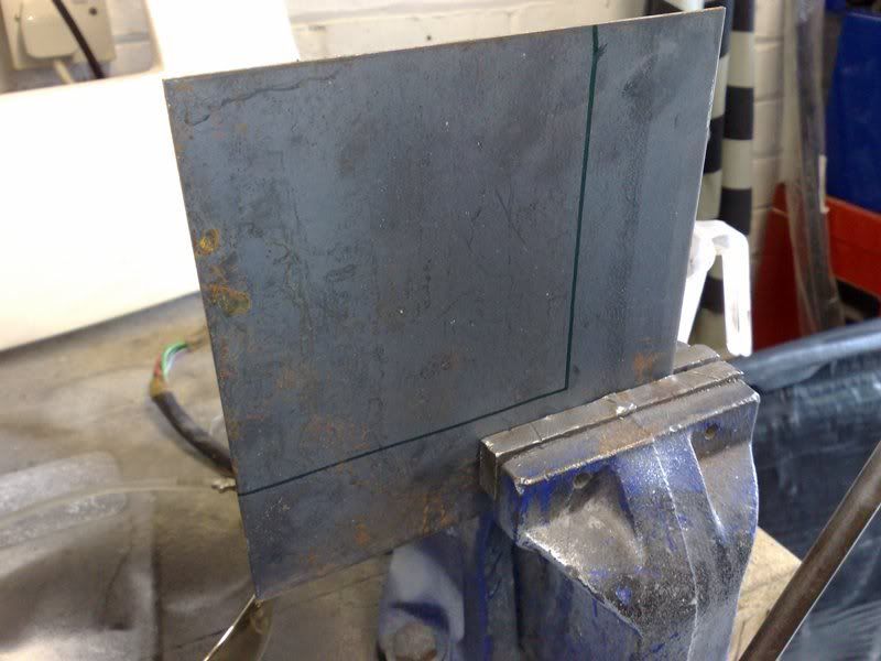

outer bit will look something like this

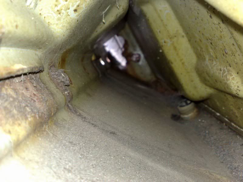

PS: never fill your sills with waxoil before welding
sills look good
