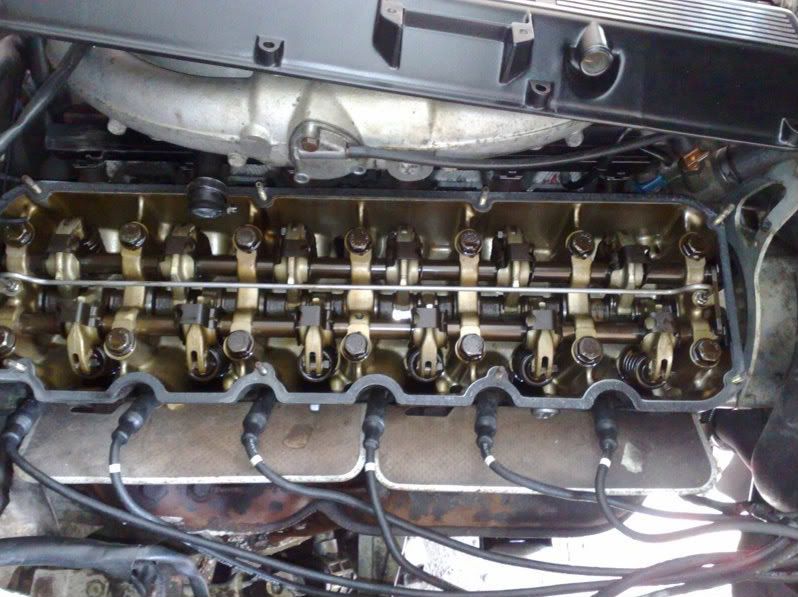

alex, get those hex head bolts out , they need to be replaced with the newer torx style ones
I have these bolt heads as well but I thought taking them out (one out - one in) could unsettle the head gasket - which currently is not leaking! Am I wrong??
whats wrong with them? Which bolts? the ones on the top that there is 14 of
if it aint broke...... etc winkeye

The early Hex bolts can shear the heads off in use and the result is a bolt head rattling around the valve gear.
Remove one, the replace and torque down a new torx bolt one at a time untill all are replaced.
I think that it was somehthing BMW dealers did back in the day.
Posts: 13595
Post Sun May 02, 2010 10:37 pm
Alex the Hex bolts are prone to snapping
have never had that happen to me but better to be safe than sorry !
not sure but it may be possible to replace them one by one without disturbing the gasket ?

8) Thanks guys, may aswell do them when i do the valve adjustments :)

Post Mon May 03, 2010 12:01 am
people lets not over hype the hex bolt saga.
If they were going to go, they would of by now. i bought a 325i touring with over 200k on it on hex bolts no problems. A rocker snapped first hitting the redline in 3rd on the M25 chasing Oz a few years ago with 216k on the clocks. the bit of rocker fell by the valve spring no damage done. This engine had had a headgasket done on 190kish and the gargae re used the hex bolts!
Its no worse than a snapped rocker. Imo you've more chance of snapping a rocker as most M20 top ends are knackered old sh!t now
Many years ago Dave no Touring bought a Diamond black sport which was "overheating!" off a Vdubber for £300 with T&T. The car did overheat on the journey home. The rocker cover came off and it had snapped a hex bolt. BUT it had again fallen out the way. I've also had my old 4dr 325i which had hex bolts..... that was written off before they snapped lol
Alex its not the doom people can say so i wouldn't feel pressured to sort this out yesterday kind of scenario

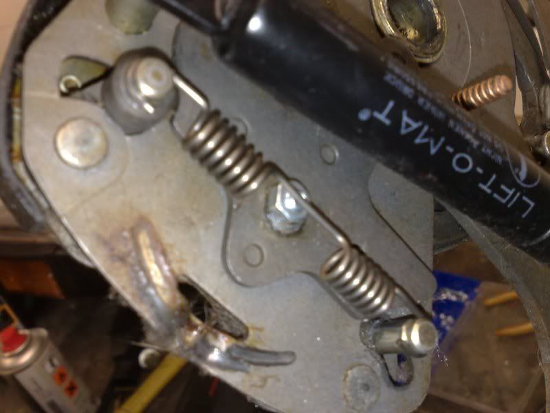

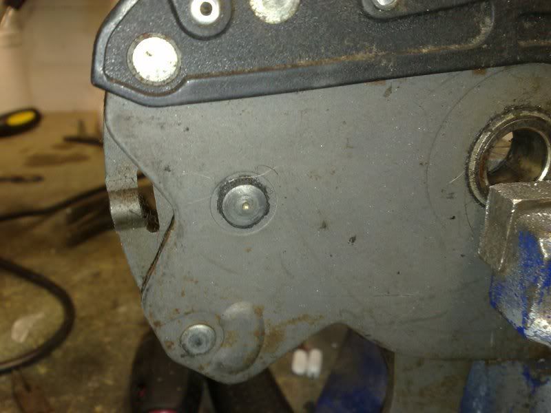

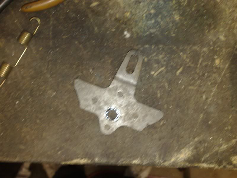

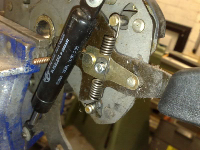

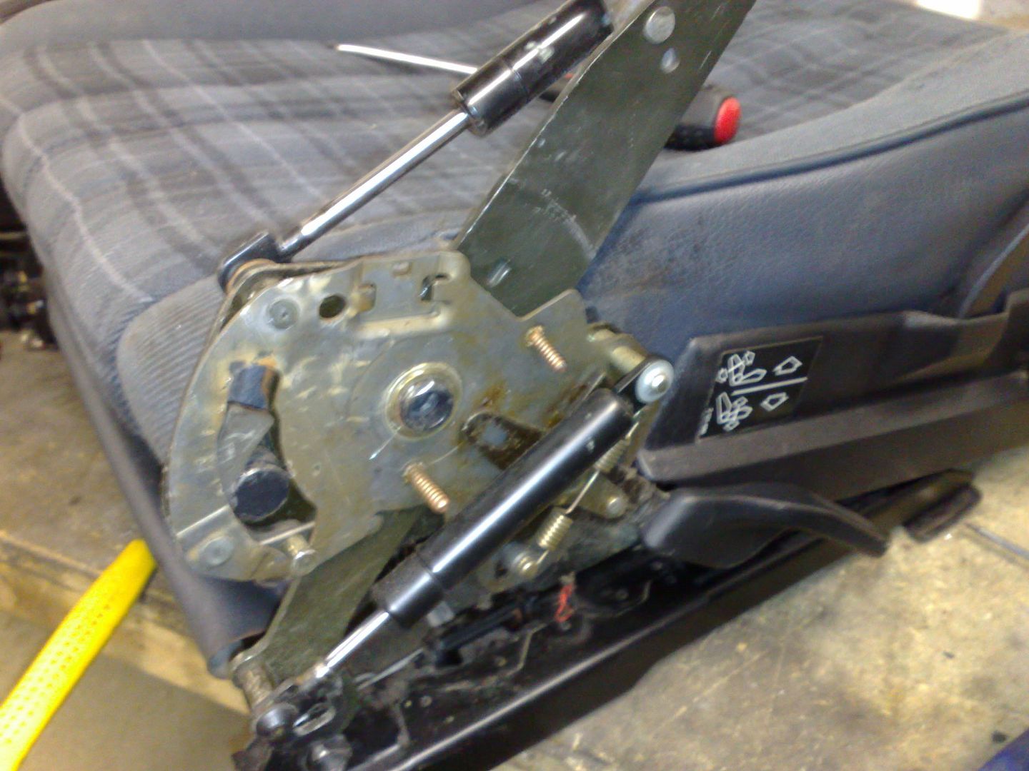

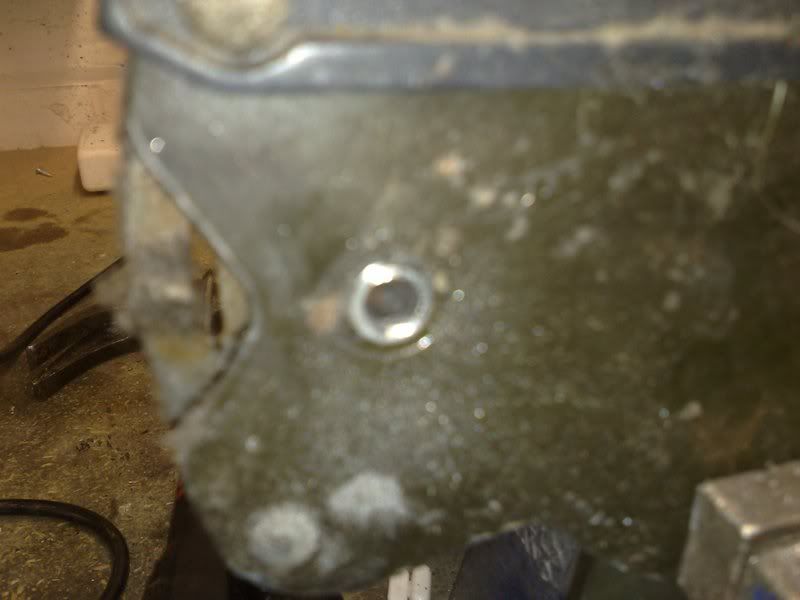

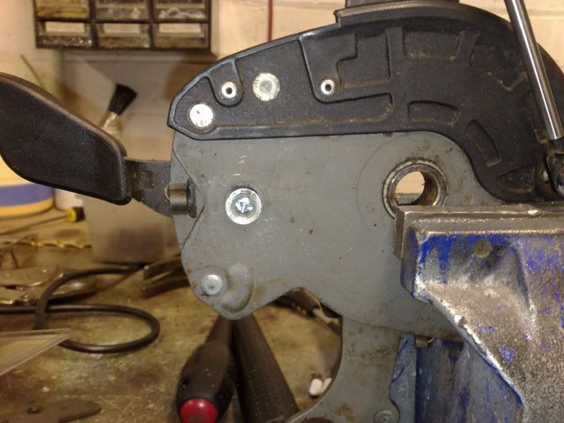

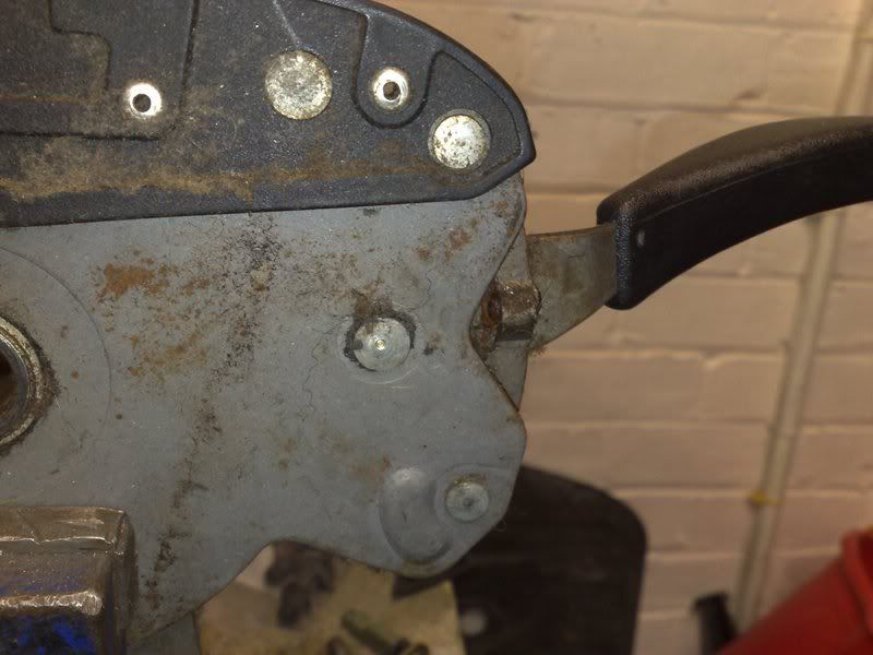

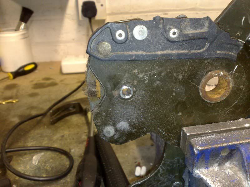

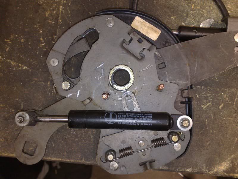

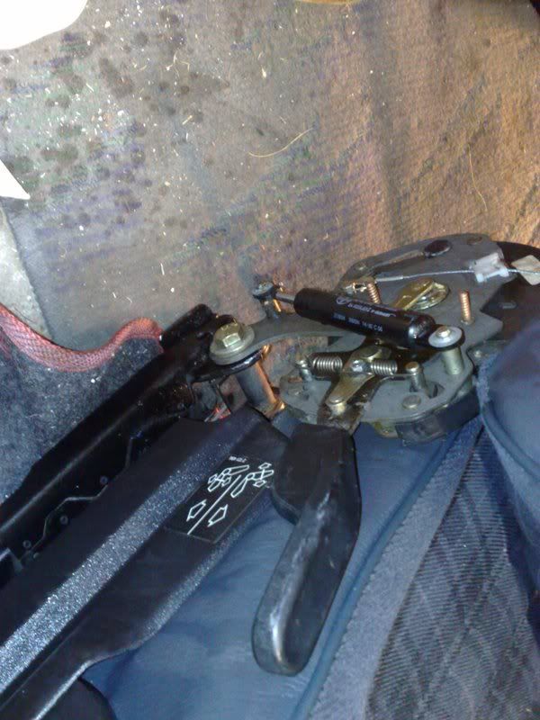

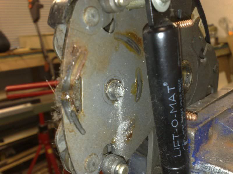

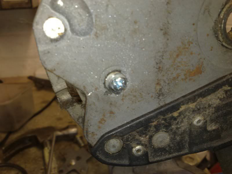

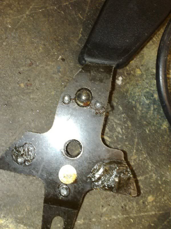

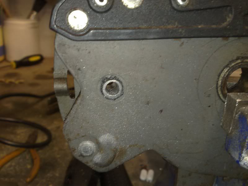

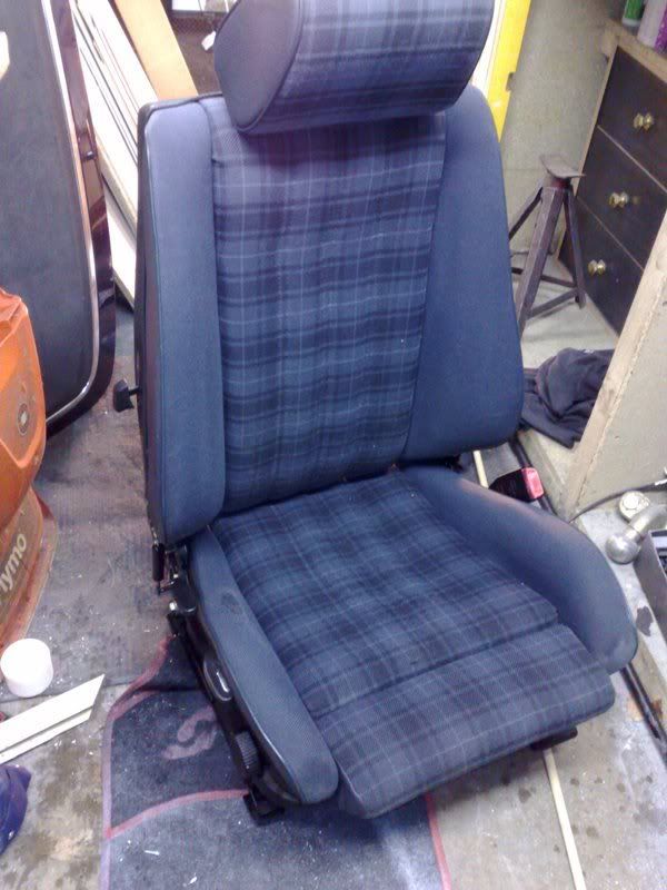

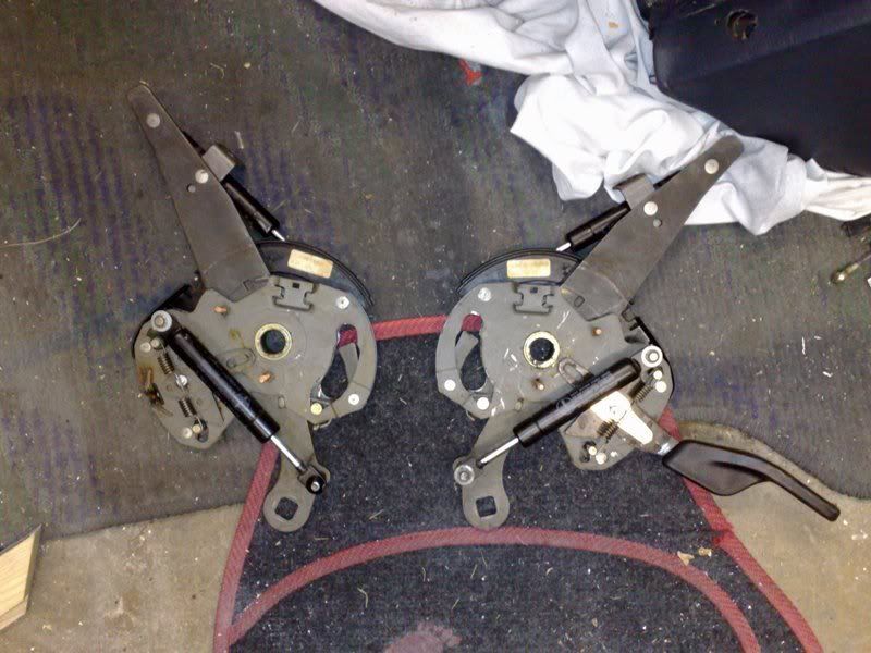

Had some agro with this drivers seat
The mechanisms didnt click into place when you tried adjusting the seat back rest so i decided to fit new mechanisms.
The first side came off nice and easy however the side closest to the door was rusted solid and ended up looking like this when i had finished with 30mins non stop with a hammer (was fun) :chuckle:
after i had removed these i never thought wether the mechanisms i had bought were for passanger or drivers seats., never even crossed my mind they would be different.
Anyway they were for the passanger seat, non cabby so i had to drill the handle out of the old cabby one
i then drilled the "passanger side" clip out to fit the handle for the drivers side
Fitted Cabby handle with nut and bolt
Next i had to drill the handle out and fit a non handle clip
The finished product.
I deffintly want black leather eventually though :D

Alex, really good work, and if it wasn't for both of us having a blonde moment would have realised the mechs were seat specific.
Still you have done some great fabrication to get them too fit. Fantastic. 8)
Posts: 22665
Post Sat May 08, 2010 10:48 pm
i knew that cabbys differ from normal sport seats, as the handle is a different shape and the recline further (hardly an issue really)
Just need to find the covers for the seat mechanisms now :cry:
Ollie_bwoii
Posts: 8695
Location: Northampton
Post Sat May 08, 2010 10:52 pm
Now they are different for either side. :wink:

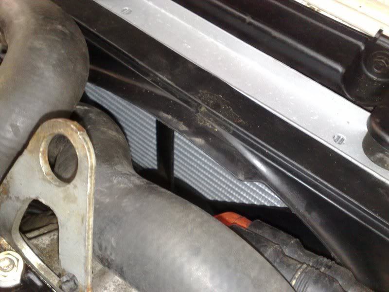

Small update, got a new rad for it, bought it off dips, i think its an aircon rad, hence the extra bit on the bottom
This is how it looked when i bought it
Cleaned it up masked it off and gave it a few coats of high temp silver paint.
Looks like a new rad :cool:

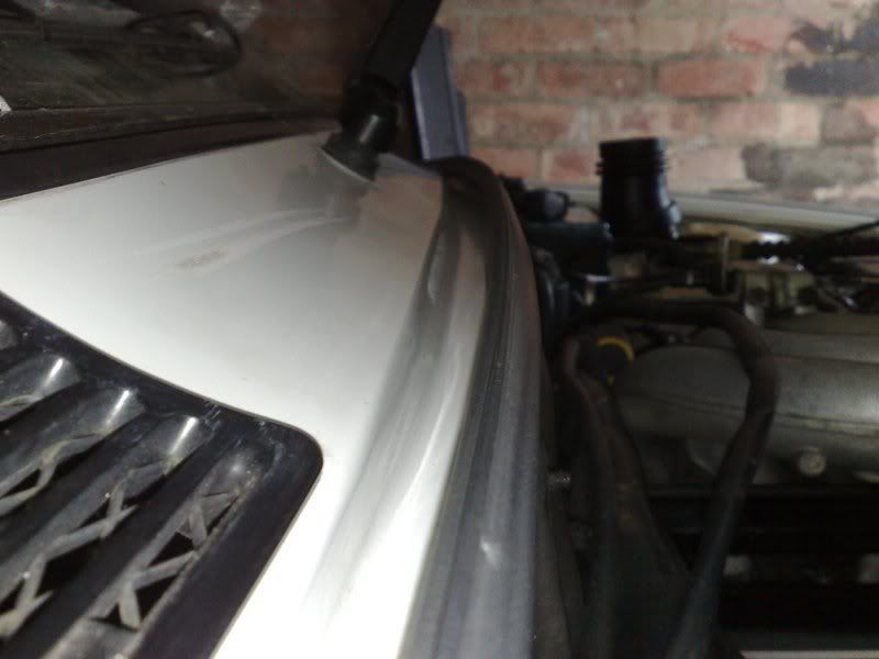

ive also been fannying about with the polish, as you do

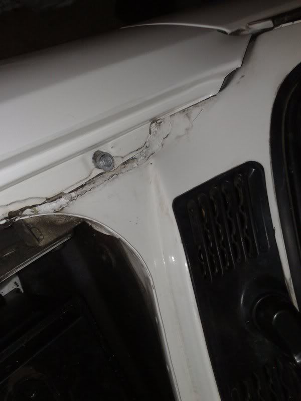

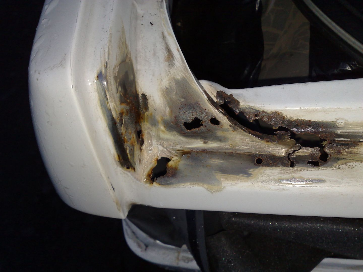

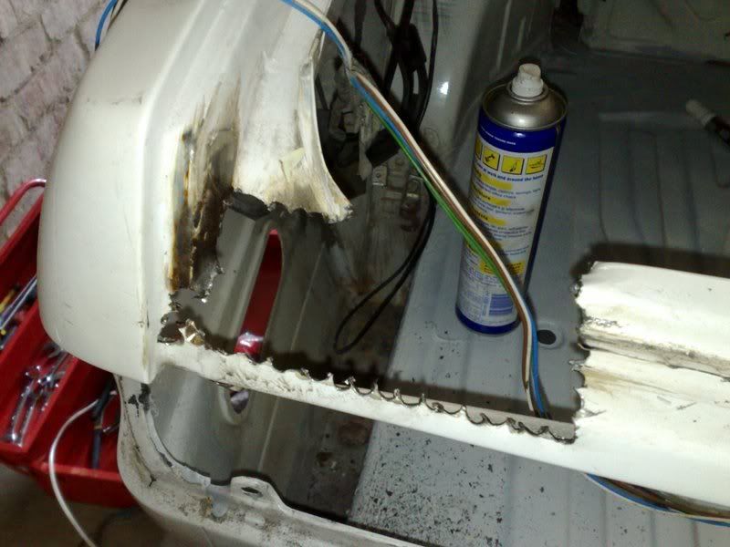

Need to get some seam sealer for this bit
i deided to cut some of the rot out, however i dont have an angle grinder at the moment, so i made do :eek: :eek: 8O Dont laugh :o:
vvvv Its not quite finished yet
before
I will getmyself a cordless angle grinder to finish it off :chuckle:
Might get myself a cheap used welder of ebay, and get practicing
some of the welding i might leave to a pro such as hole in inner arch and patch where the Door opens
got a fair bit of sheet metal in the garage so i need to somehow replicate the corner bit
Would a small ish generator power a welder ???

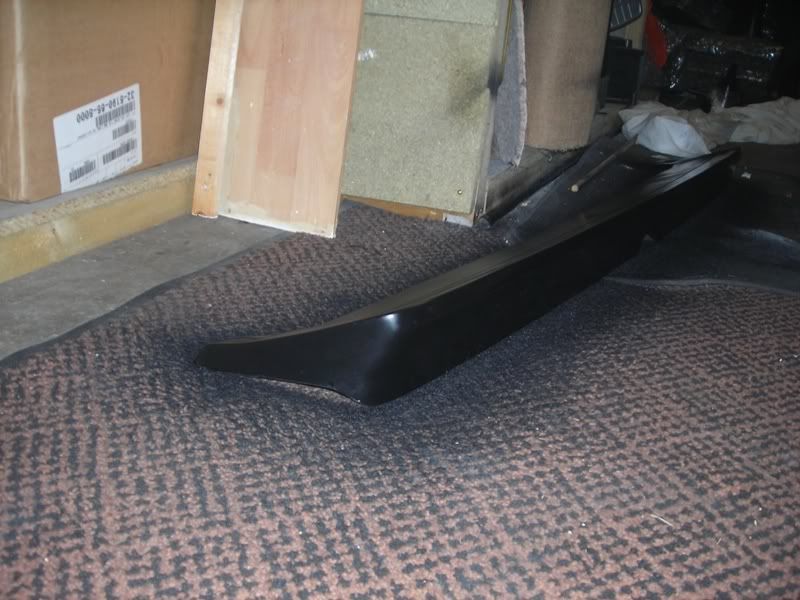

Ive also got a genuine front spoiler which needed some TLC as you can see it has bits of filler on that still need sanding down
(PS the runny bits are where ive tried to spray inside surface cracks to try and make them less noticable. ive allready spent around 4 hours filling and sanding the spoiler, then when i painted it in plastic primer it showed up loads more :( )
