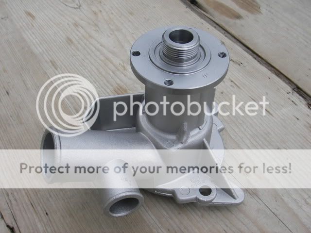

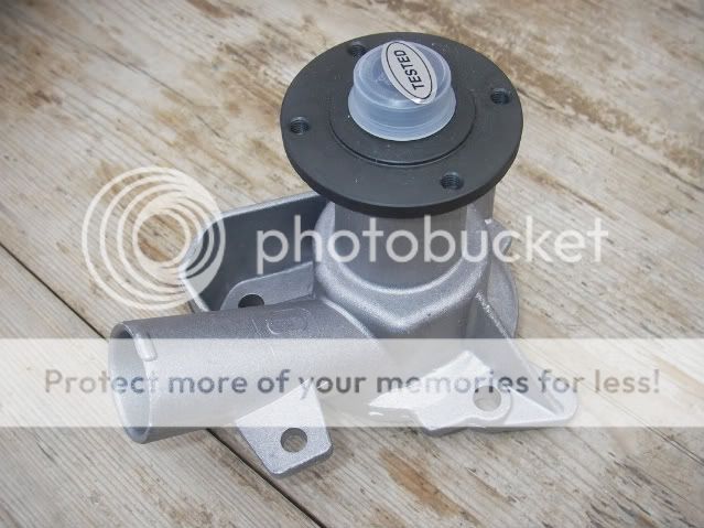

For anyone wondering the what the difference between the pre and post-facelift pumps is here are a couple of photos (yes I did get the wrong one the first time! but it was due to ECP's dubious website giving incorrect information):
Pre-Facelift:
Facelift:
I've also put this info on the Wiki: http://www.e30zone.net/e30zonewiki/inde ... ater_Pumps
