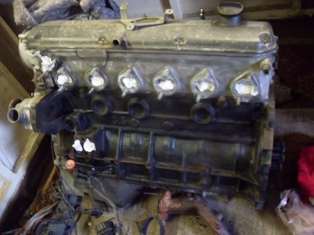

Post Sun Mar 02, 2014 12:46 pm
Hi,
I took the head off the original engine yesterday, the one which was giving out loads of white steam.
Do you think this damaged head gasket could have been the fault ?
looks like it's broken down to me
You can see some of it stuck between the water channels
and here is where it came from
Also, the gasket is an awful fit - look here where the oil ways are at the top and at the bottom the water ways are just a tiny hole - at the top they are large channels
is this right?
thanks
HairyScreech
Posts: 6265
Post Sun Mar 02, 2014 4:40 pm
Nahh that's just where the gasket has stuck to the block and split when you peeled it off.
The small holes in the gasket are to control the water flow around the head, a lot of gaskets get progressively larger to one end or the other.
