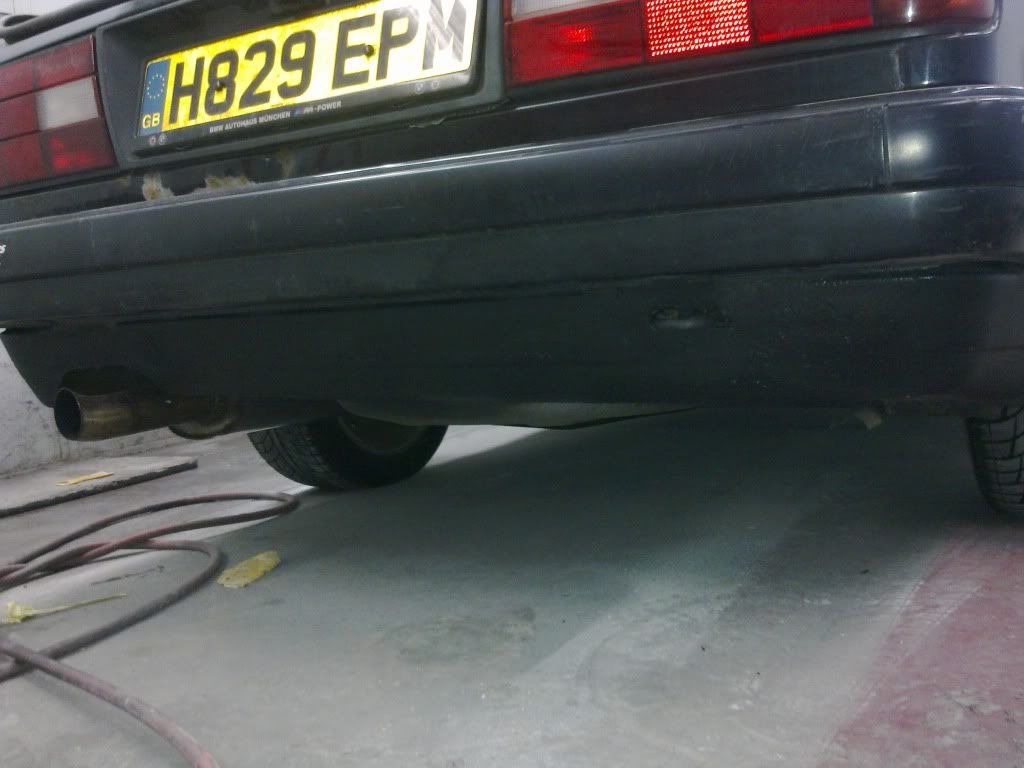

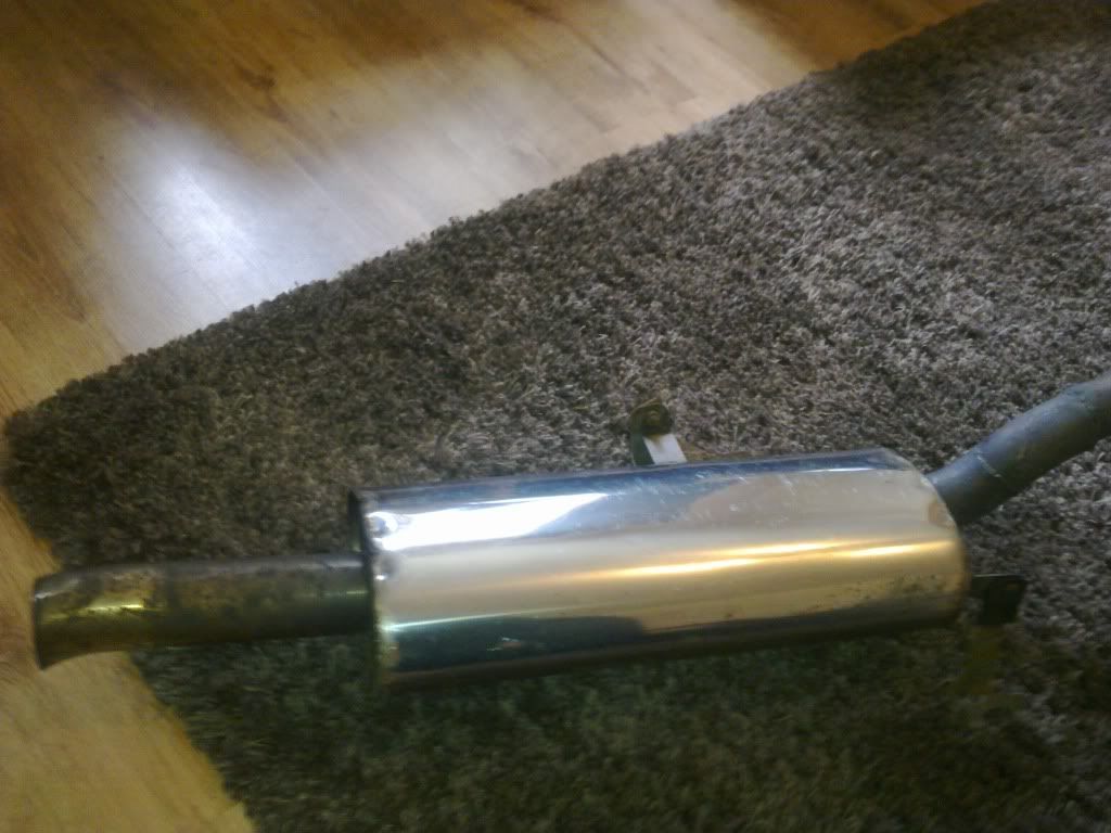

new exhaust on its way will be here to morrow and got some nice bucket seats cheap as chip still not sure if im going to put them in or not but if i dont they can allways go on a drift car.
will get a video up when i get the exhaust done either tomorow or friday

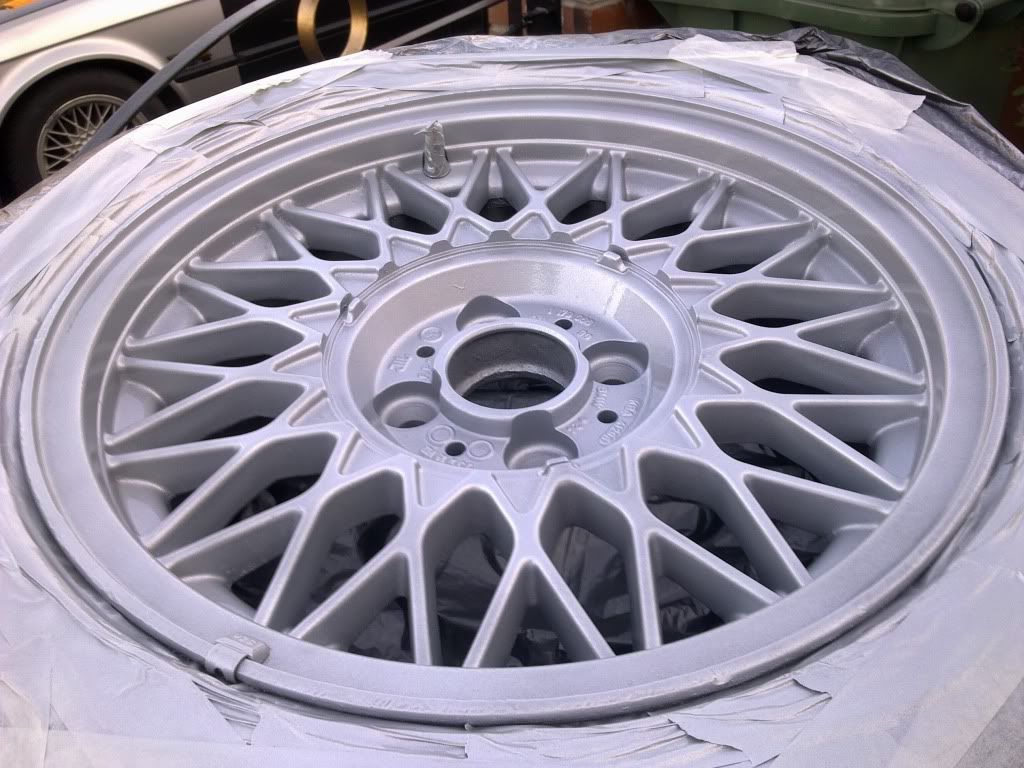

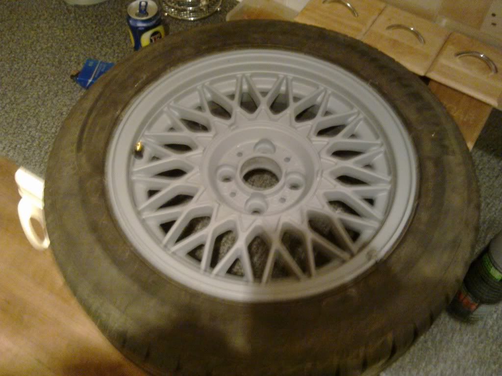

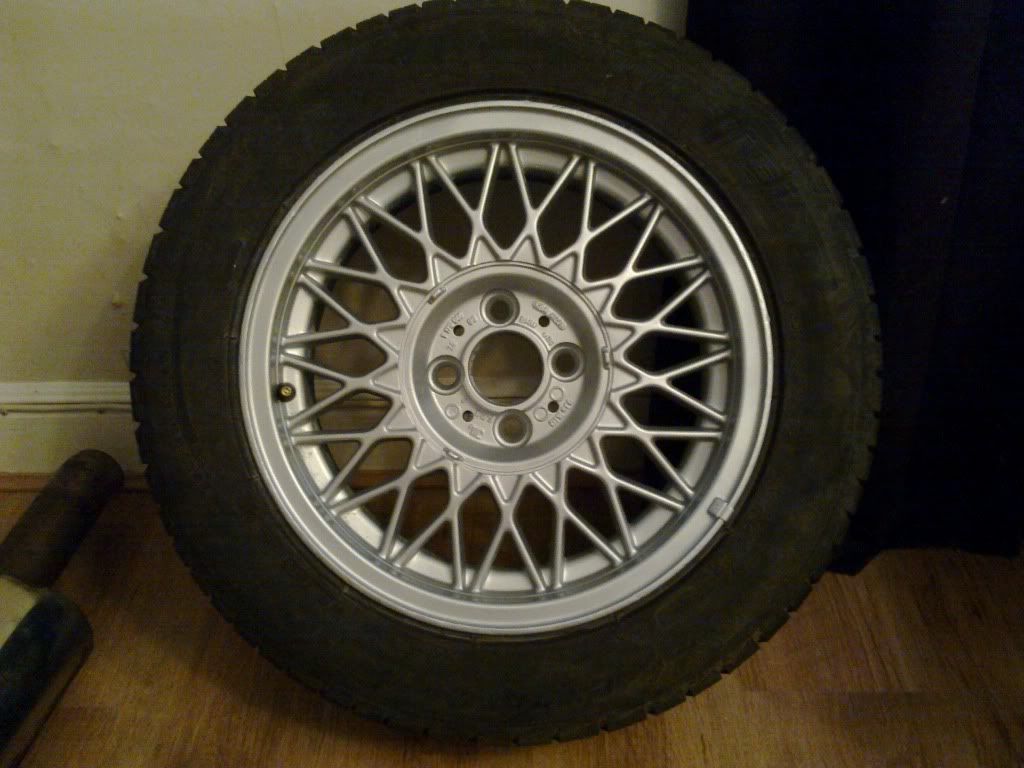

allright everyone, so i got bored about half an hour ago and decided to repaire my spare wheel will eventually do all them but this is done at home, if i was in work i could do them better.
still need to paint them but iv got them primed at least

Post Thu Jul 19, 2012 11:47 pm

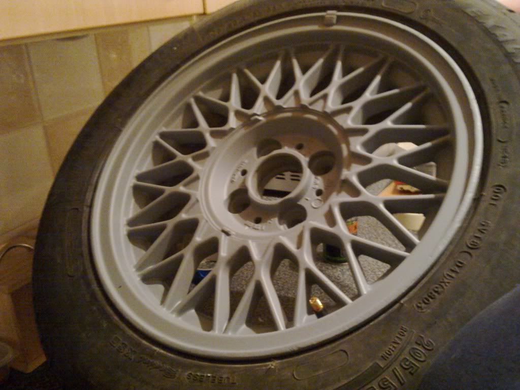

think ill just keep thm silve if i get them all into primer tomorrow

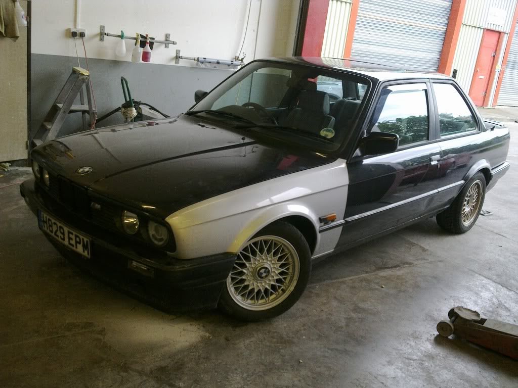

right so got an other wheel done and all four centre caps only got three more wheels to do, reason for doing one wheel a day is because when one has fully dried i can replace it with the one im doing next.

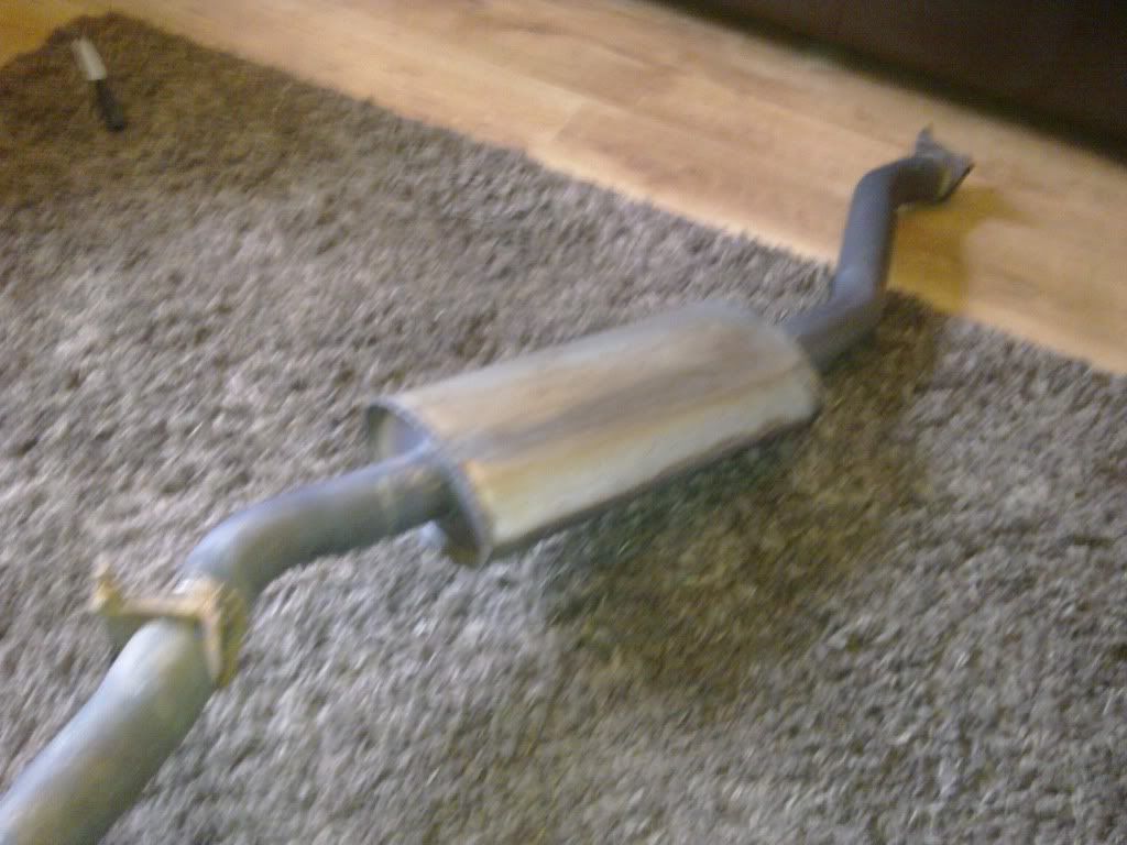

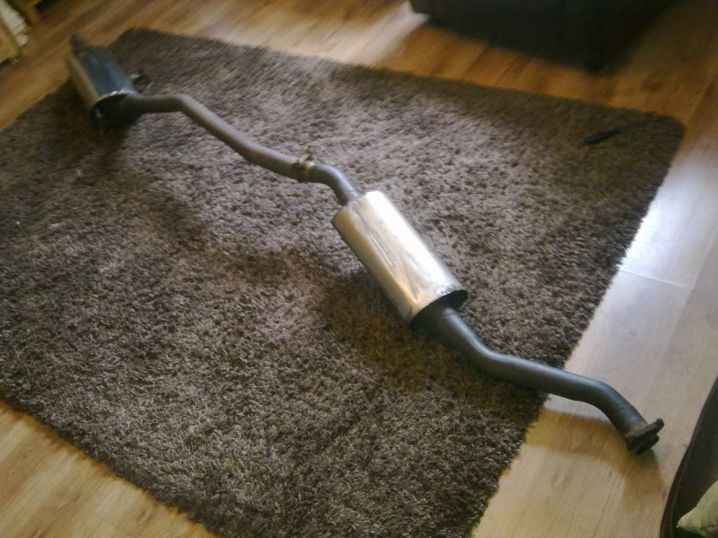

the exhaust has bee dis mantled and put in the e30 for tomorrow will get a video of it with it on and happy im getting to havea drive in the car since buying it think ill take the scenic route to work ;)

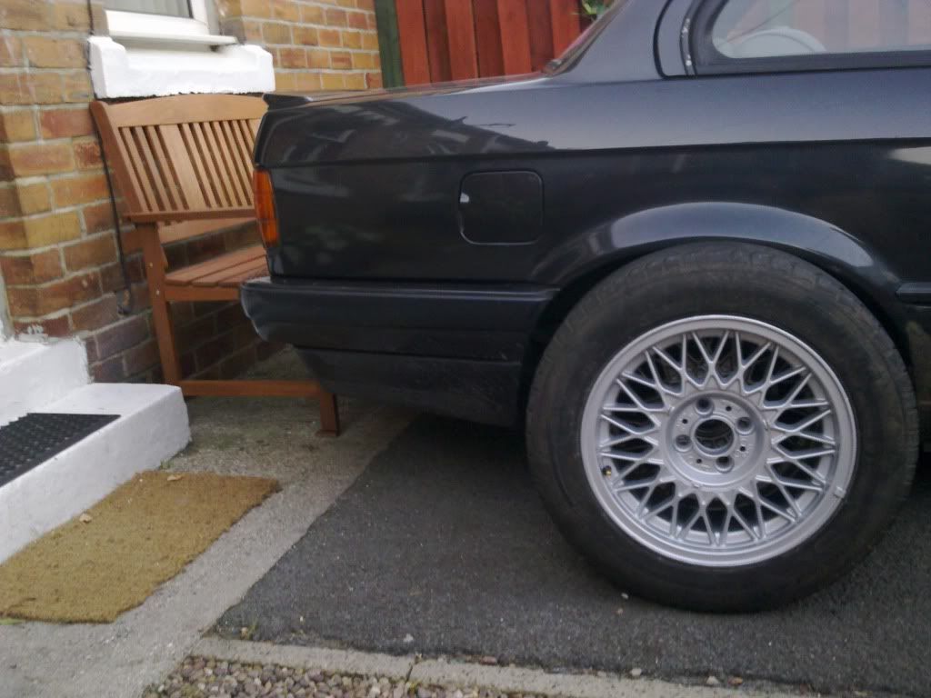

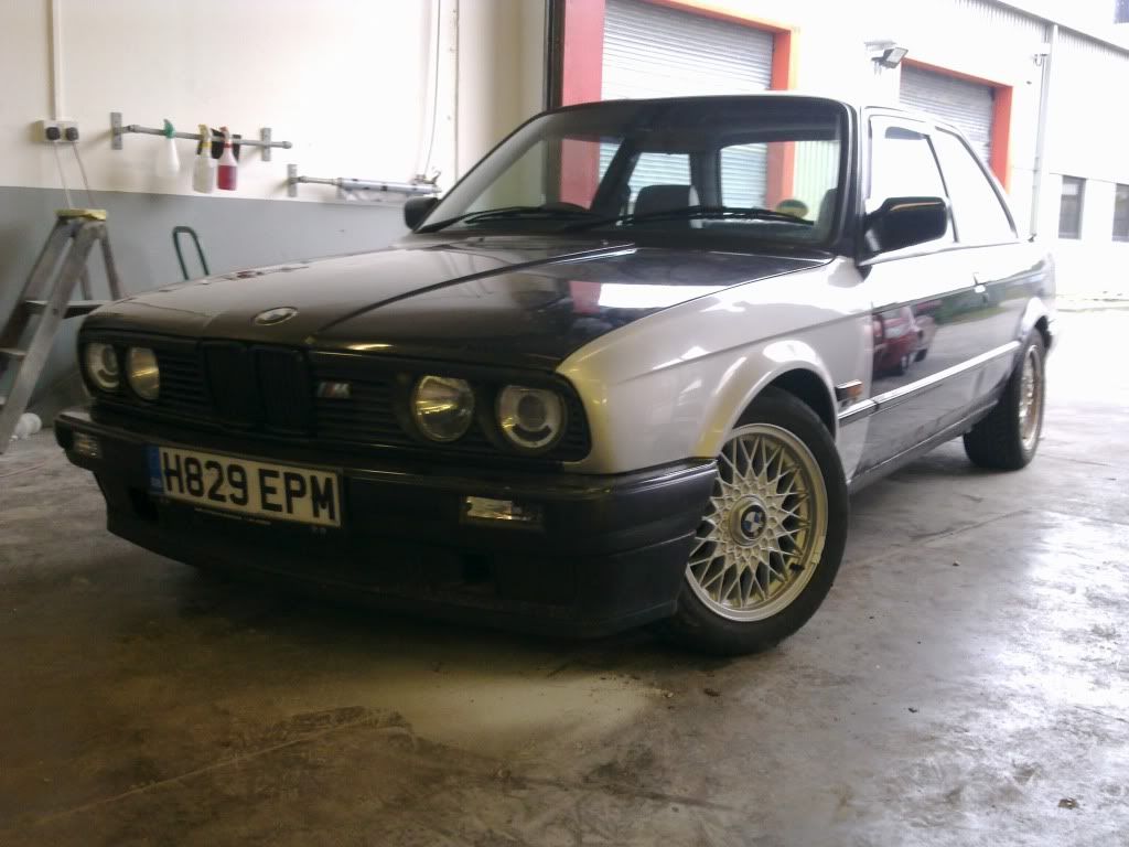

anyway iv got three wheels done and this is how one looks on the car

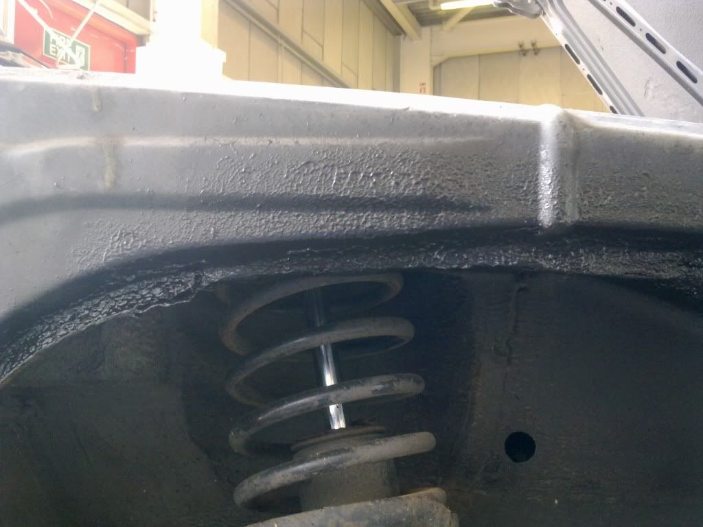

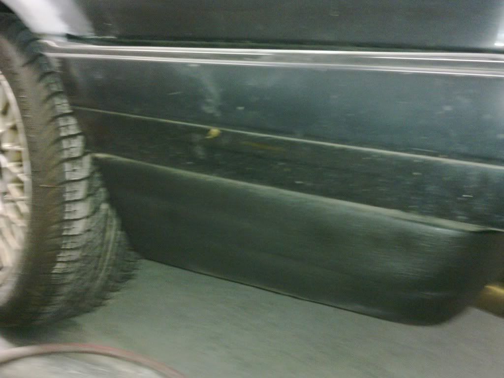

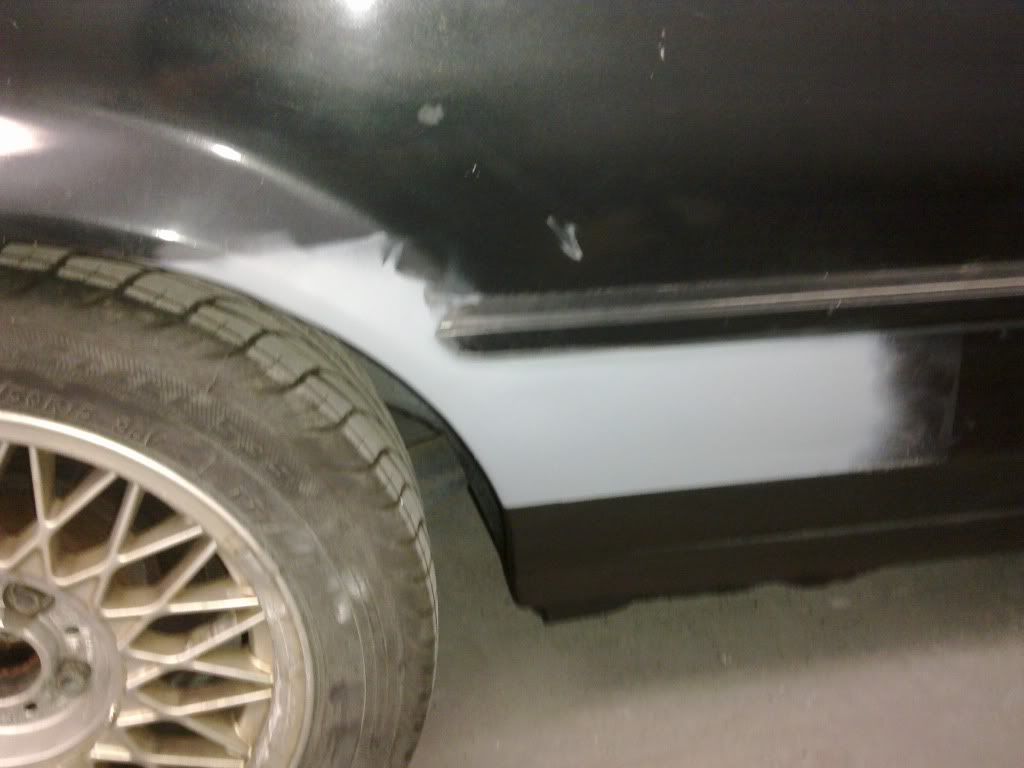

so basically i had spare time at work so i thought id start the main bits o wanted done aka rust so this was shitty as it had rusted lower part but not gone up to where the lights are so ( for anyone who is going to criticise this work dont as im in a very high standard garage ) this is a quick fixk and i dont recomend it if people like there cars spot on. for me it works fine i sont see that part and its repaired im happy no rust all the metal around that area was removed and acid treated. to give the shape bake iv fibre glased a quick 5 minunte flat and stone chiped it. if i was going to get this better id have body fillered it and stopperd it.
if you look at previous pics you will see what iv done
and some nice pics of it now

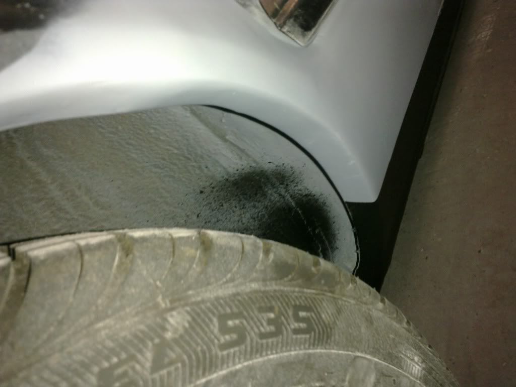

haha yh a gave up on thoughs wheels bloody too much rust going to get them blasted or just get some nw ones also done the other side today going into work tomorrow for full day hopefully get the arches/ boot seem/ coner of the window done. heres some pics of the other side was bloody fucked i hit it agian with a hammer just rust fell everywhere
as again nothing special just a tidy up all rust cut out re shaped with fibre glass and acid etch then stone chiped.

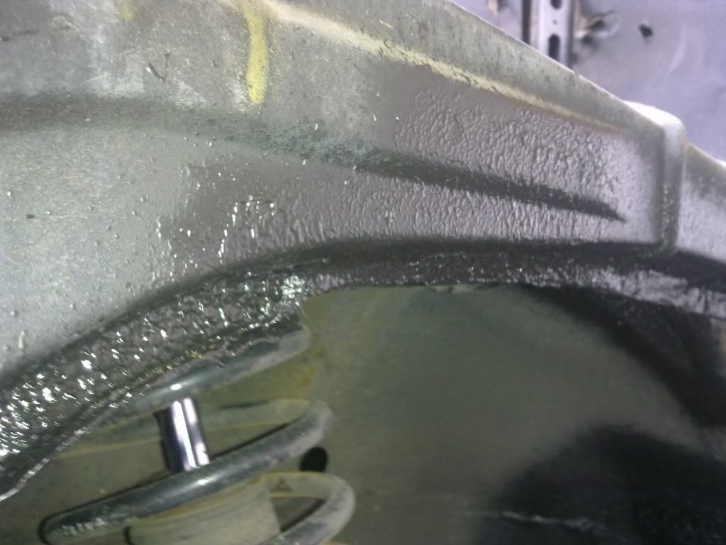

so got the chunk missing out of the arch repaired today and the inner boot lid (the arch were it bends out of shape is where some cowboy has bodged it so when it comes to paint ill remove it but the general shape is back and stone chiped.
all sides have been re stone chiped to tidy it up a little more.
