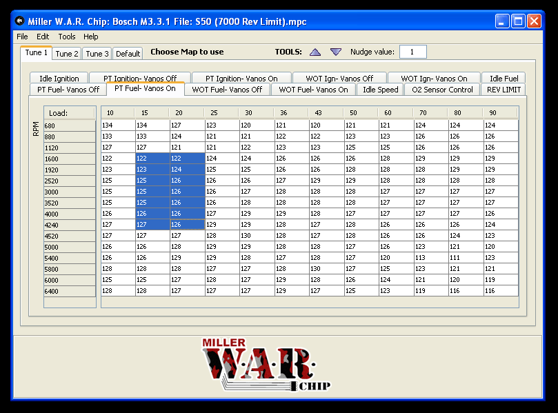

Right! Back on topic....
The W.A.R chip is installed in a spare ECU and the base maps are loaded. I've booked-in at Motoscope and a week after that I'm away on a 800-odd mile jaunt so I'll report back after.

Right! The engine is now running on the W.A.R chip, but the car hasn't been on the rollers yet. I've downloaded a base map from Miller's website and tweeked the ignition maps a bit. OK, so it's all guess-work until the car gets on the rollers, but on the road it feels like I've found a fair bit more bottom-end. :woohoo:
There's definitely a fuelling issue with the base map on petrol because it's hunting badly, but I'm not too bothered about that at the moment.

Yep, it was pretty straightforward. The hardest bit was working-out my favoured position for the map changeover switch. Obviously I need the dyno figures to back-up my gut feeling Alex, but I think this is going to be a must-have for anyone running LPG. :D
Now, I wish I'd done it a couple of years ago instead of frakking around thinking that getting the Motronic remapped was the only answer because it's OEM+. :roll:
And the beauty of it is that not only can I have an LPG-specific ignition map, but I can have another map for 99 octane (my petrol of choice), and a third one for 95 octane for when I'm touring 'round the far north of Scotland, for example, where they have neither LPG or 99.
....... And you can share maps with others who have similar engine spec's. The base map I'm using is one from a dude in North America somewhere with an eta/885 spec. I had it e-mailed to me from Miller's.

StuBeeDoo wrote: I've downloaded a base map from Miller's website and tweeked the ignition maps a bit. OK, so it's all guess-work until the car gets on the rollers, but on the road it feels like I've found a fair bit more bottom-end. :woohoo:
That sounds very promising, and similar to the feeling I get of lost torque between 1-2K RPM, if you could spare the time , I'd be interested to see a print screen of the ignition table/software.

e301988325i wrote:That sounds very promising, and similar to the feeling I get of lost torque between 1-2K RPM, if you could spare the time , I'd be interested to see a print screen of the ignition table/software.
For some reason I can't get a screen shot Alex. :?
If you just want to see what the software looks like, there's a shot on Miller's website.

That's really interesting, can you adjust the idle timing as well to be optimised for LPG then?
With your AFM stuck open on LPG, I take it you only have two ignition points to map for each RPM point, part throttle and WOT?
Do you know if the software output the AFM/MAP voltage when live mapping?
