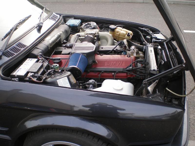

If your engine is in the furthest back posistion 3 then any of the rads you've listed should fit. Did you have to "massage" the bulkhead at all?
Front pulley looks like it's already been removed in that photo so yes chu there would be one more belt to the PAS pump.
Mine still has the aircon pulley on and is no were near the radiator but then mine is properly back in P3... pleased I didn't remove it as it'll soon be powering my air con compressor again

Baz, I'm saying that this radiator isn't fitting correctly in MY car. I'm not saying that you've gave me the wrong radiator, just that for some reason it's not working in my car. If I really thought that it was your fault, wouldn't I be saying something along the lines of "Baz has gave me the wrong radiator, what can I do?". I know it was working in your car that is why i'm trying to figure out why it isn't in my car.
The other day when the engine wasn't sparking, I had just had a go at firing it up after working on it all day and it wasn't sparking. The next time I looked at the car, I unplugged most of the electrical connections, plugged them back in and it ran fine. Not sure what the problem was, but thought I'd ask you incase I'd done something wrong. I'm sorry I didn't get back to you to let you know this but I've been really busy lately because I've moved house and haven't had a proper internet connection, just my mobile phone to log on here.
Hi Charlie, The engine when in position fine and no massaging was needed. The pulley is not a problem, it's just dizzy is touching the rad.

there it is as it was in my car
Sun Oct 10, 2010 5:07 pm
Mine is touching the rad too with the dizzy cap, no major issue apart from then you need to change the rotor arm or t-stat.
It woun't damage the rad on hard braking.

Looks like it's in position 2? is it bolted to the rubber mounts through the front or rear holes on the engine mounts?
chu346
Posts: 2403
Location: Leicester
Sun Oct 10, 2010 5:53 pm
It's in the front holes, P3

This is the clearance id got with an M20 rad
Who's mounts are they? or has you E30 ever had a bang on the front?
