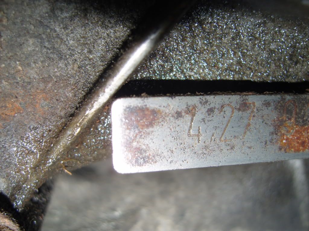

Sat Apr 24, 2010 6:09 pm
Barx325i wrote:the S painted on the casing can be pretty small, but I think all I've seen have one..
S meaning schnell
You have seen one now
Uploaded with ImageShack.us

and it should start with an S
...and it doesn't.
...which causes another problem potential since the mech. who did the diff flanges for me filled it with oil designed for an LSD (since that's what the VIN indicated). Is it ok to drive or should I drain this stuff asap and replace it with something else?

Sun Apr 25, 2010 7:47 pm
Leaving number 11's isn't conclusive. It can be done with open diffs.
Also, I think repaired or warrenty slippers will not come with the 'S' on the tag.
Billgates test is the best way.

Brianmoooore
Posts: 49358
Sun Apr 25, 2010 8:24 pm
Oil will be fine. A slipper diff is an ordinary diff + extra parts.

If it's Castrol Hypoy LS will be fine but some of the miller oils or B17B are for motorosport use and will break down a lot lore quickly etc, etc.....so, if you are sure it's not an LSD, change the oil. If you are not sure it's not an LSD, leave the oil, until you are sure it's an LSD or not?..there is a man on here selling a 3.91 from a sport which is very good value//there is anonther guy selling one with worn paltes that migh be kicked by friction modifier. An LSD is a nice thing to have though.
