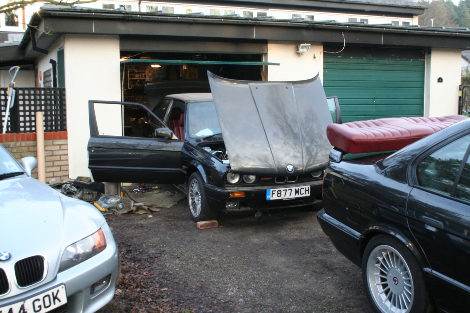

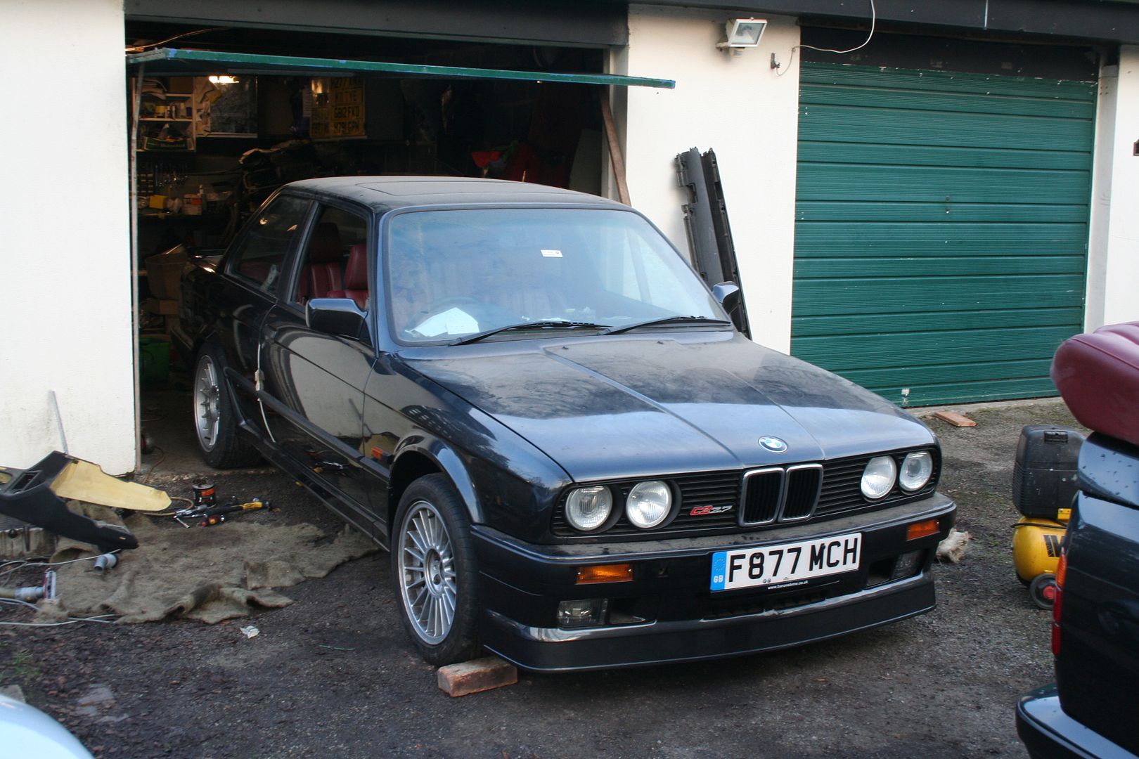

Well its too cold to work so its time to get on with the final push.....
First time its been out probably for a year i reckon. Not all the way as its too heavy for me to push back in on my own
i am bolting the interior all in bascially get it in a decent state
Bolted the battery back on and everything that was working before still is
alarm, windows, lights etc
So it looks like a car without an engine which is what it is basically.
Time is now officially against me as my wife is due with our first sprog June 28th or there abouts. If shes like our school friend then it could be 4-5 weeks early and i only have 4 months.
Which is to get it running, MOT'd and balls to the rest of it. I can sort everything else once the baby arrives and i have some time spare once things settle down. I know i've always taken the approach of trying to do things the way to this but I've got no hope otherwise i feel?
These two will be a right good pair

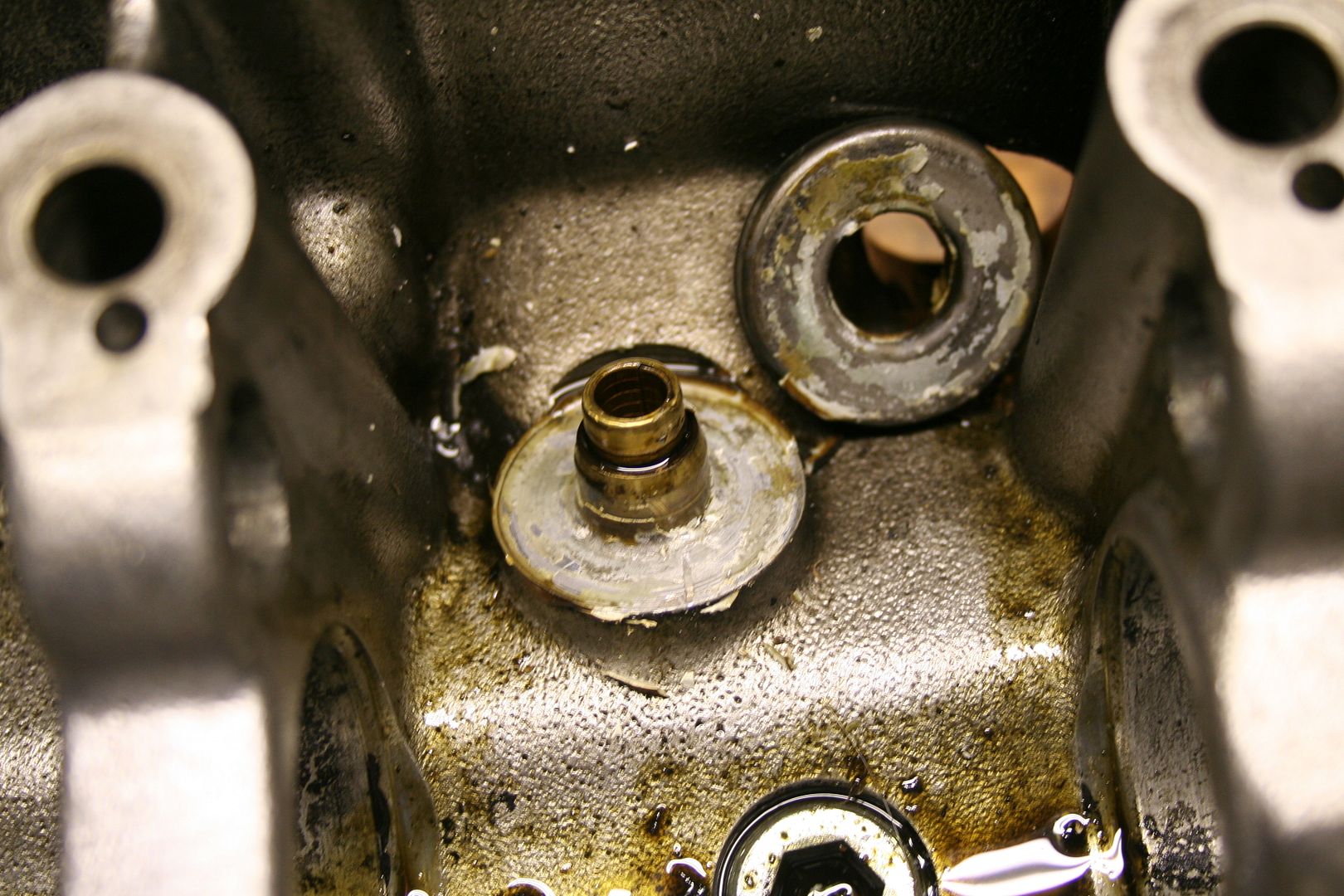

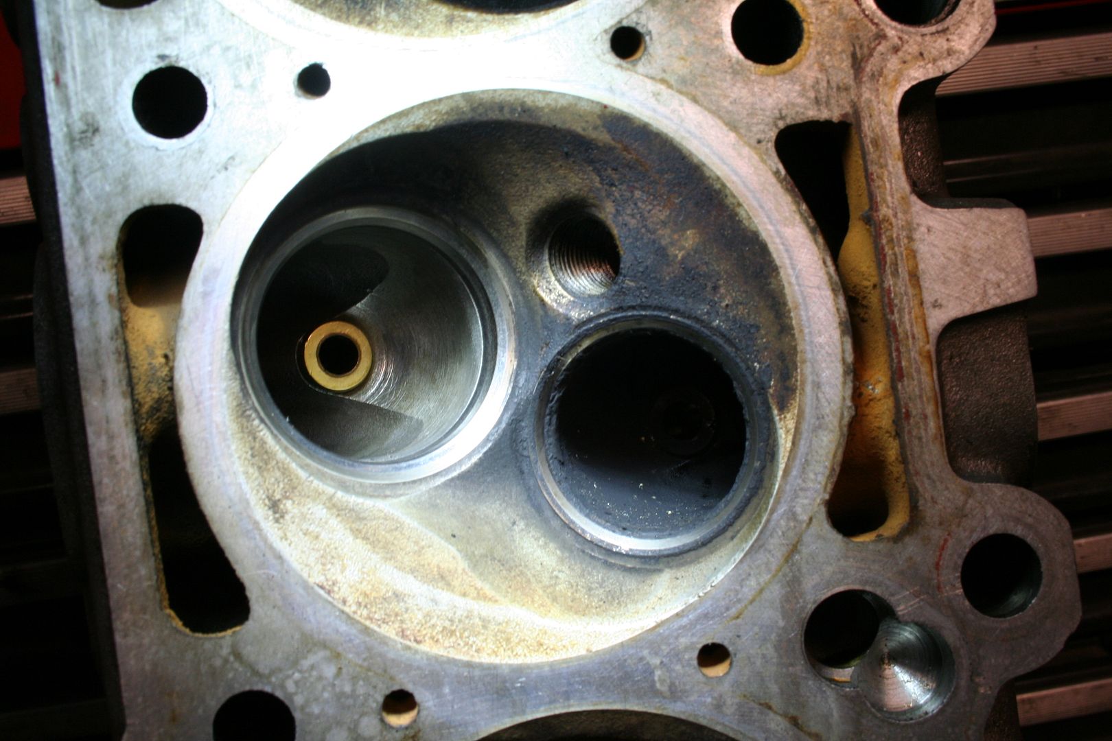

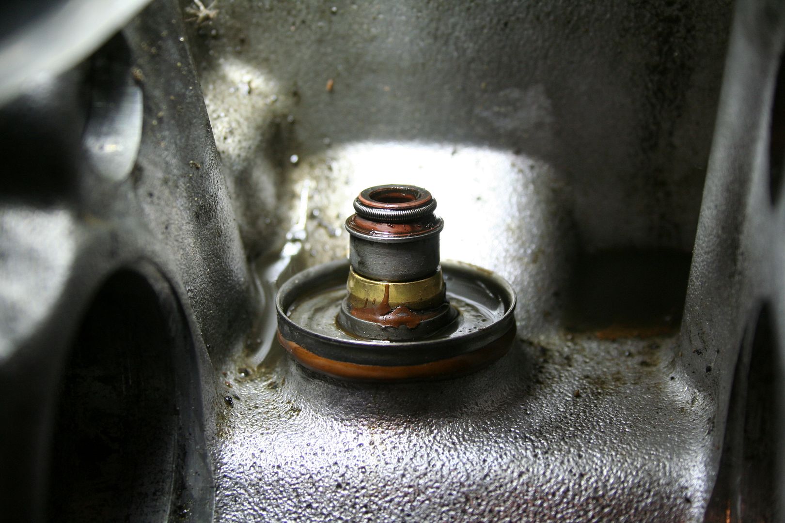

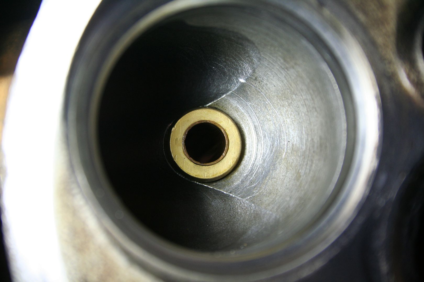

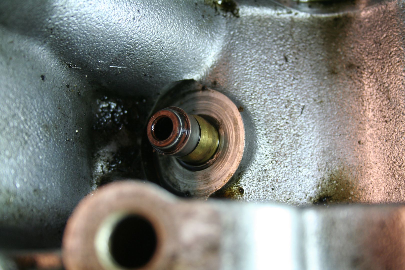

Anyhow i pinched some time to help keep the ball rolling with the 2nd head for the 2nd rebuild!
This is a standard 88 casting BMW head. One of my two spares. This head was fitted to the car when i bought it and had supposedly been overhauled in the past.
Valves out, i'd say it has been overhauled. The valve seats look fresh recently re cut imo.
Reem and sleeving action. Nothing new here but its very strange for the inlet side to need this sort of work. Its always the exhaust valve guides that take a battering. Now they feel tight like they might of been changed. Nothing like the guides where in the old PYF head which where replaced
Now this is wierd, some retard stuck the valve seat down to the head?!?! looks like aroldite or something. I can't for the love of me work out why someone would do this? its only on the inlet side also
came off easy enough though
Thats what it normally looks like
I'm going to take it to the old mans machine shop let the old hands cast their eyes over it and go from there. Then probably get the inlet guides changed and the exhuast ones checked. Then it will be off for the headwork.........

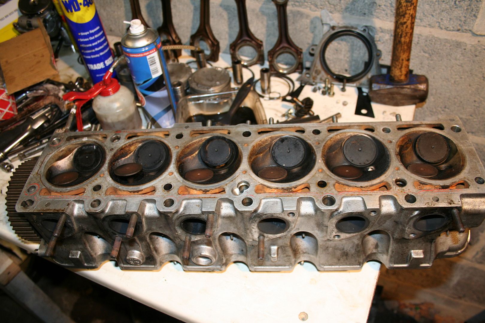

no still got the faulty schrick, sitting on the desk next to me. Its all over with regarding auto mac and schrick, moved on now. I'm going to get a vernier pulley and take it to Roland Allsop to "dial" it in. Which i'm sure will yeild a running engine then.
I'll build the bottom end again but if they end up building the head, setting the cam up and torquing the head down valve clearances etc so be it. Saves me some work! I can crane the bare engine in then and go for it

For what it's worth si, and I know its little consolation, I was chatting to someone the other day about your issues with the shrick and both of us agree there is something odd with it, even if it was fitted in the "correct" hole then your piston to valve minimum clearances seem a little odd, it's like the "correct" hole is still 5-10 degrees out.
Personal/professional opinion - if I had been building that I would have questioned the timing when I checked the piston to valve clearances.
- Posts: 22697
/\ your right it ran just......but had inlet valve to piston contact. My thoughts would be to time it up in this position and use the vernier to get or dial it up right. My guess is i hope the vernier has enough adjustment in it to make it run/turn over right and theres no contact?
If not i'll be getting the alpina cam quicker off you!

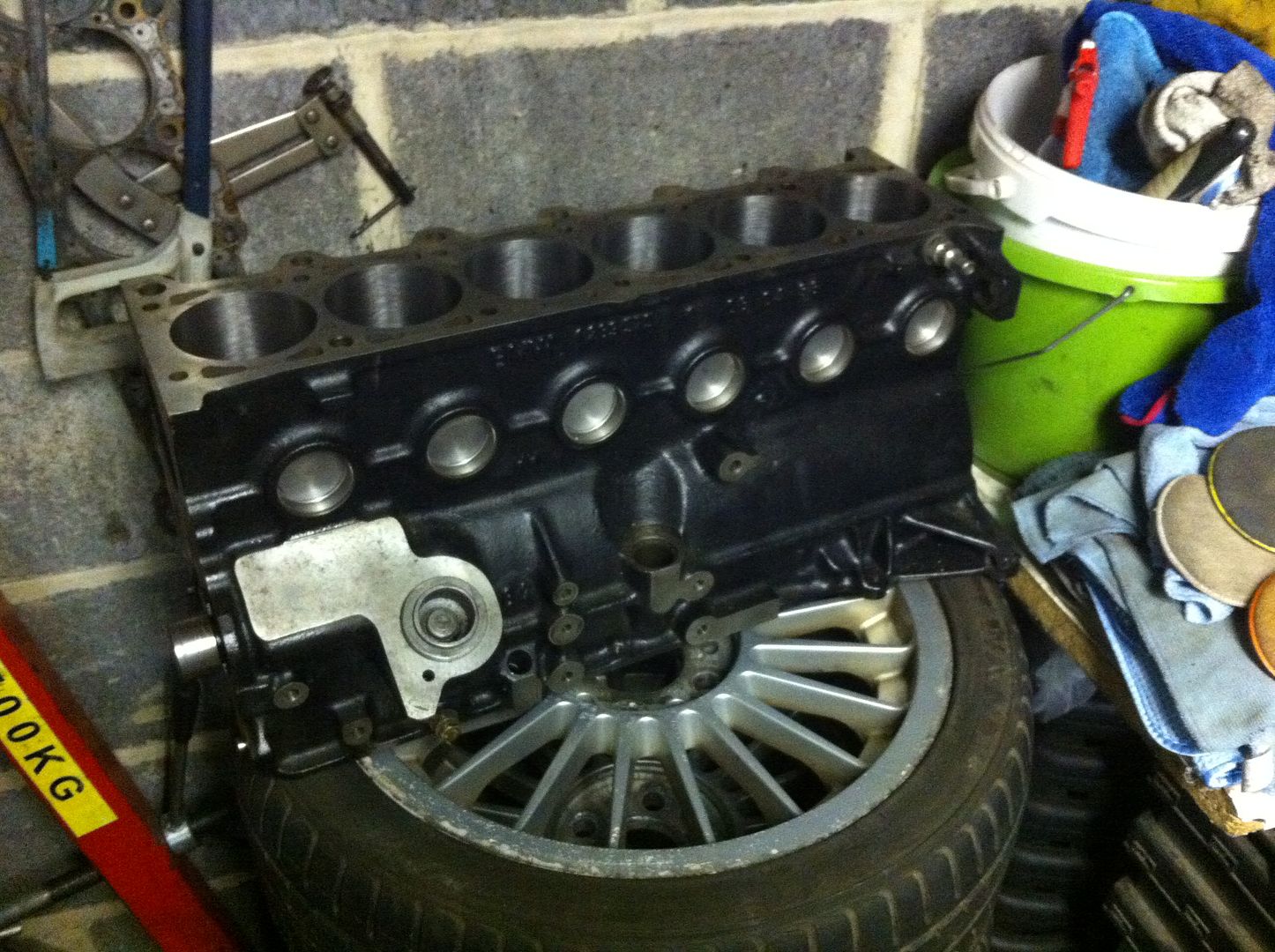

Baby arrived, this wasn't done, and an e46 B3s has arrived rebuilt the engine on that, the e34 B10 killed a turbo and its clutch also since the last update.
So a busy year still but not for this C2. Alas the god of work has given me some funds and with no itch to buy a motor i shall give this a crack for engine build number 2, this might be the cars 4th rebuild
The block like the head has been sat at the machine shop since Jan this year. Its been rehoned so now the bottom end is ready for assembly again.
Head is nearly done and ready for porting work. Then the fun can begin, its not far off really is it
