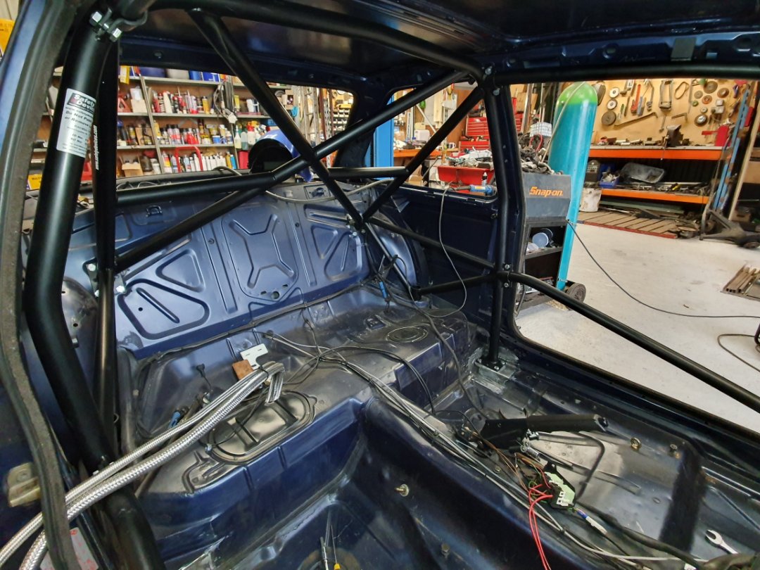

Long overdue update, got plenty to type!

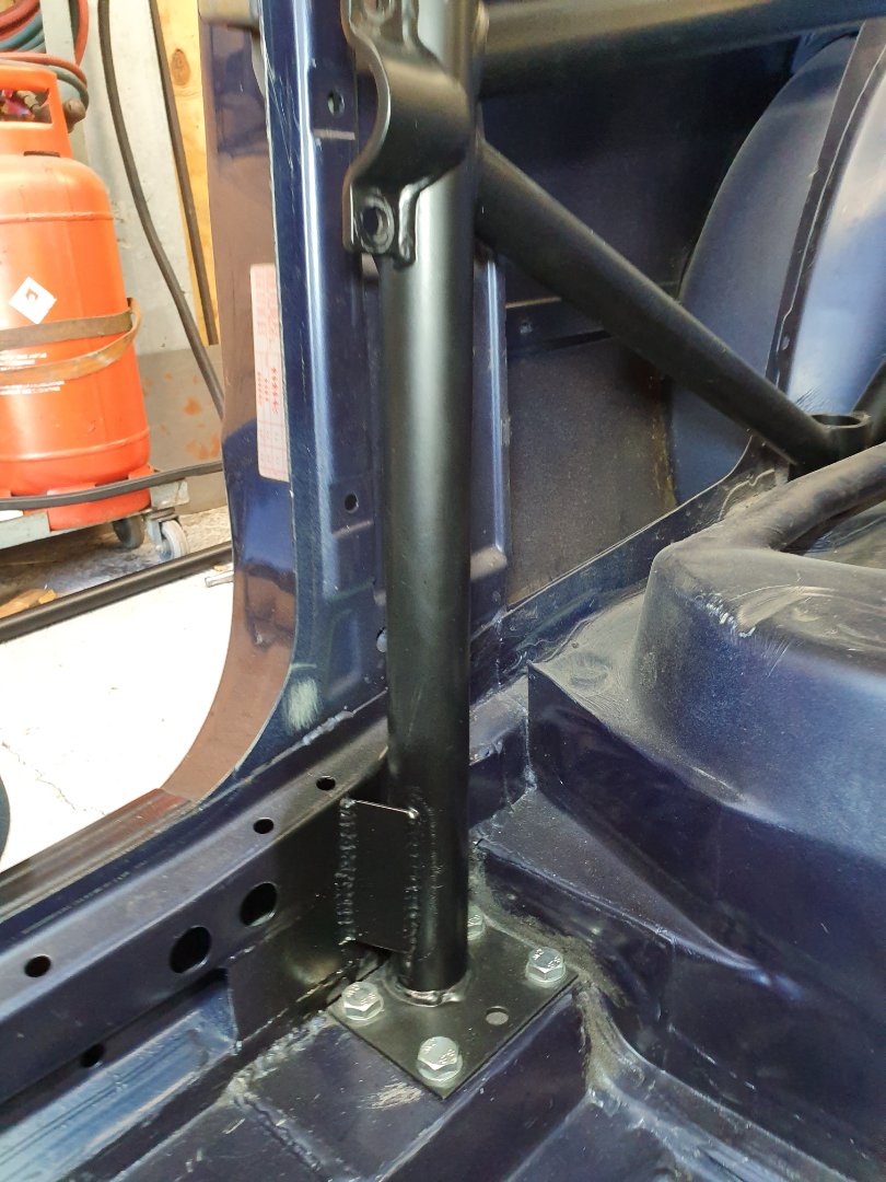

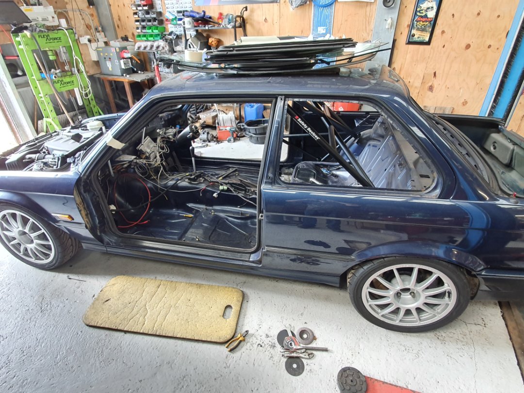

So as I wanted to enter the BMWCCR racing series I had a few problems, firstly the cage was not up to regs so in August 2018 I ordered a Safety Devices bolt in, it eventually turned up in May the following year...
The other problem was the S54 powerplant, one of the rules for the series is as an amateur racer you cannot use M power engines, so back to M52 power I had to go.
Eventually got the cage fitted during the summer of 2019
Some photos
Some photos

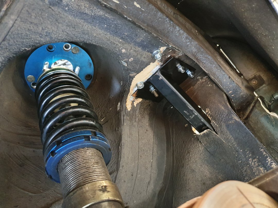

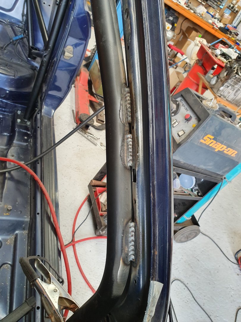

Regs state A and B posts have to be welded to the cage, so ive added plates where needed and also a few at the base of the tubes incase the bolts pull through in a big impact

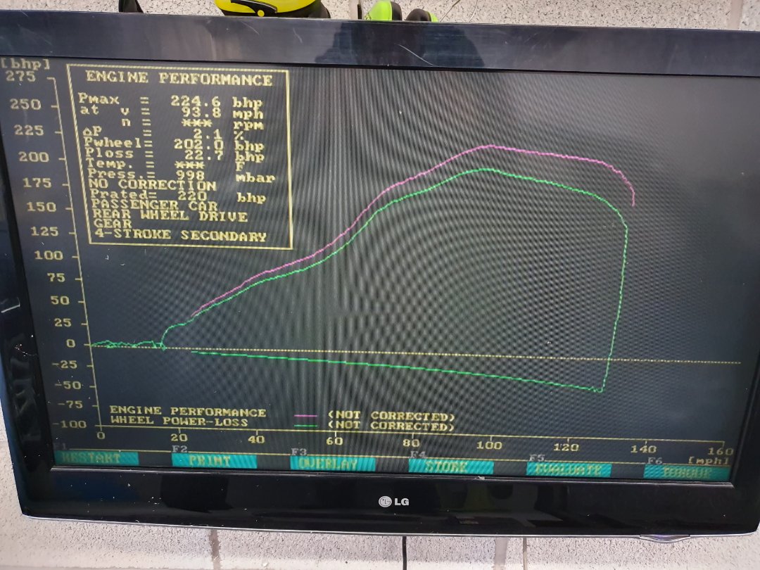

Once the engine had done a few road miles without problems I got booked into chipwizards for some mapping, all competitors must present power maps to prove power figures and be eligible to race.
The engine initially pulled 231hp, the peak can be seen on the graph
But with some expert adjustment the peak was reduced which gave a maximum output of 224.6hp which was perfect!

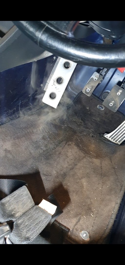

I couldnt manage more than about 4 or 5 laps without the screen steaming up to the point I couldnt see where I was going, no heater and I sit so far back I cant reach the screen to wipe it meant I had to keep coming back into the pits to mop the footwells out in an attempt to dry the inside of the car out.
This turned out to be leaks from where the new cage had triangulated through to the front strut towers.
Video here from once the clouds had moved along, track still water logged but the car felt good and I was driving past pretty much everything else on track
Soaked footwell and steaming water

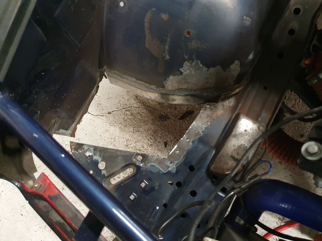

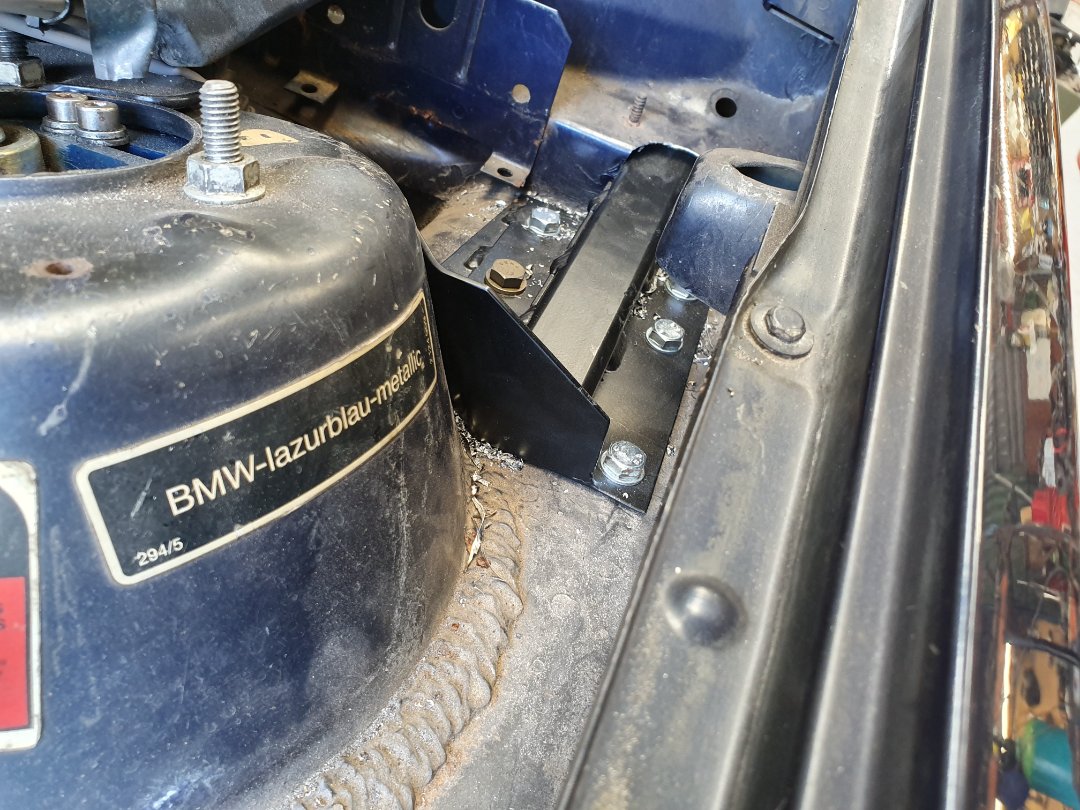

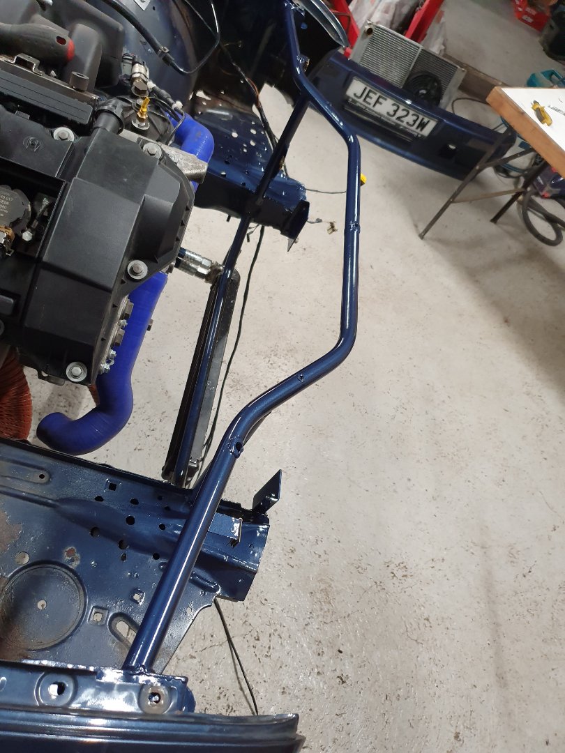

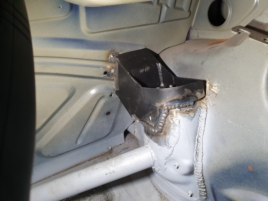

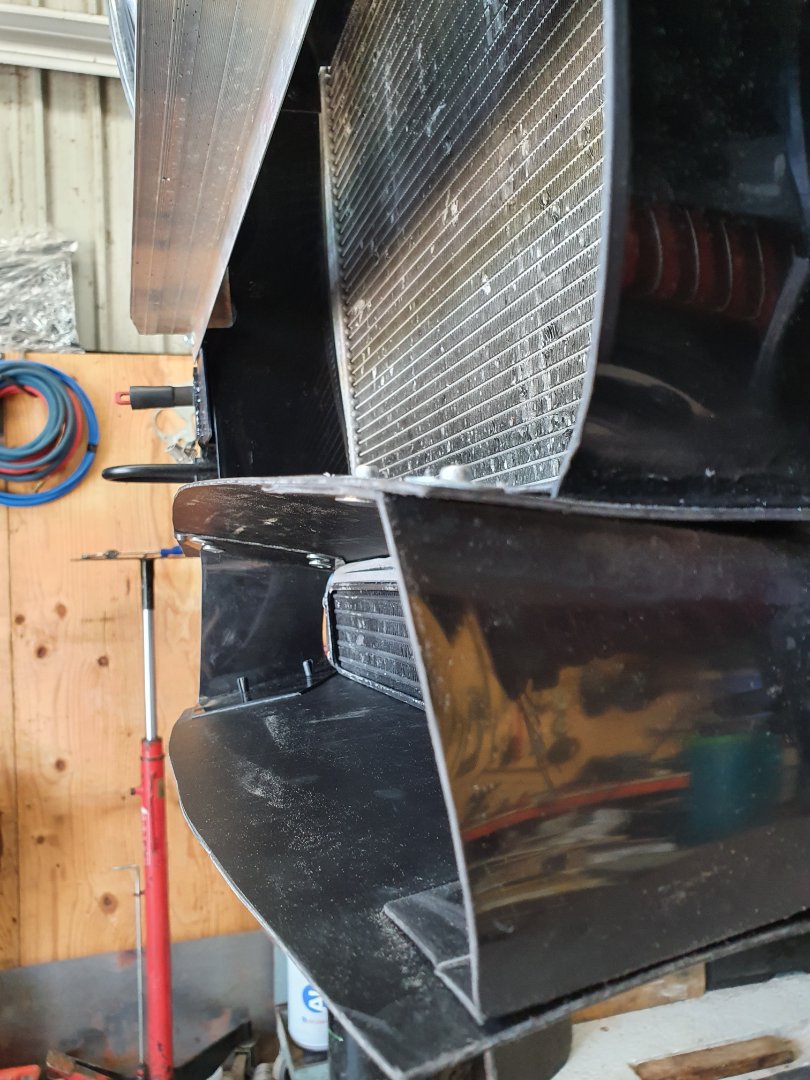

Moving into winter and feeling happy with how the car is working I turned my attention to a few other areas, main one was the front end of the car,due to how id attached the grp bumper years ago it was a PITA to remove so I decided to get it mounted on quick release mounts, id also had thoughts of getting the radiator further forward in the engine bay so over Christmas I decided to cut the front panel off and make a new one out of tube
Even though its only 1.5mm wall tube the front end is now massively stronger than the original, oil cooler is bolted to welded on mountings.
I also took the opportunity to cut out some rust

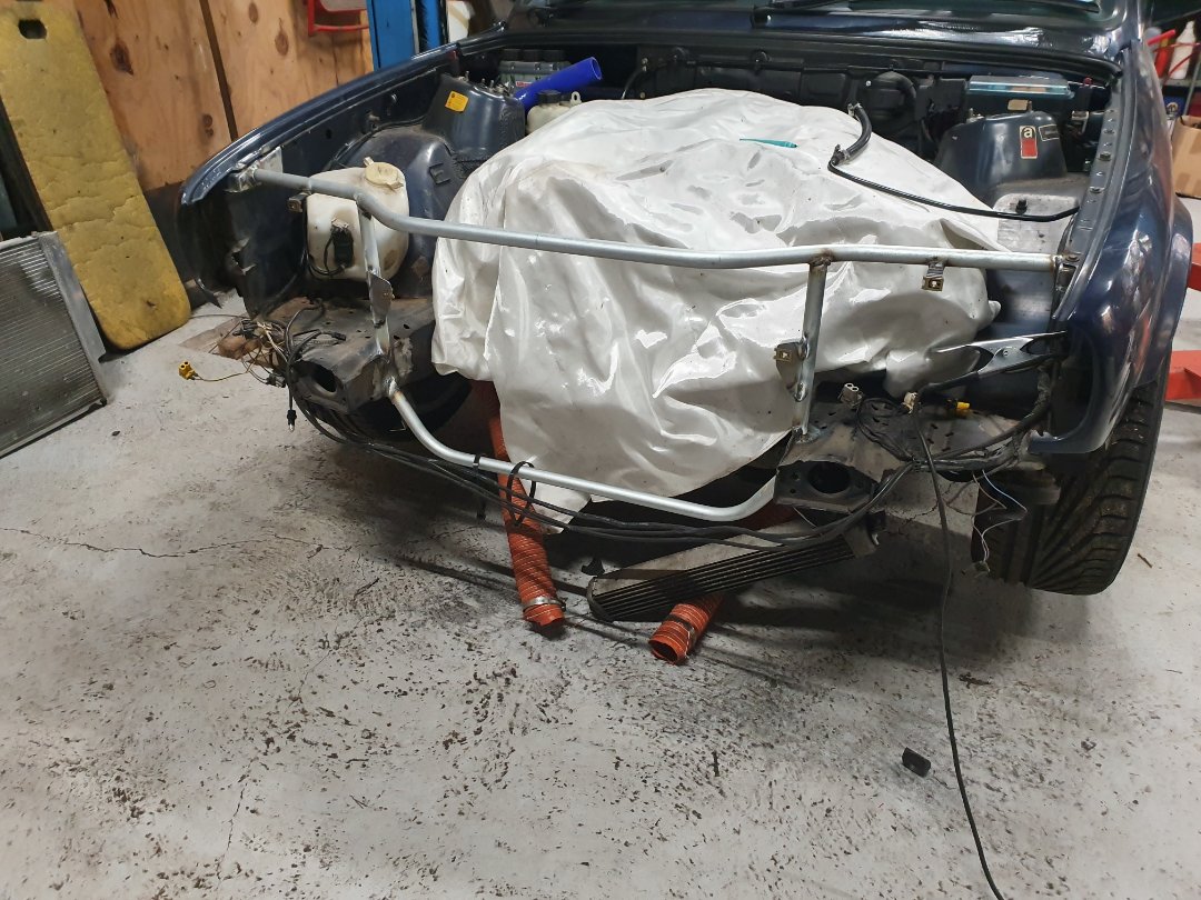

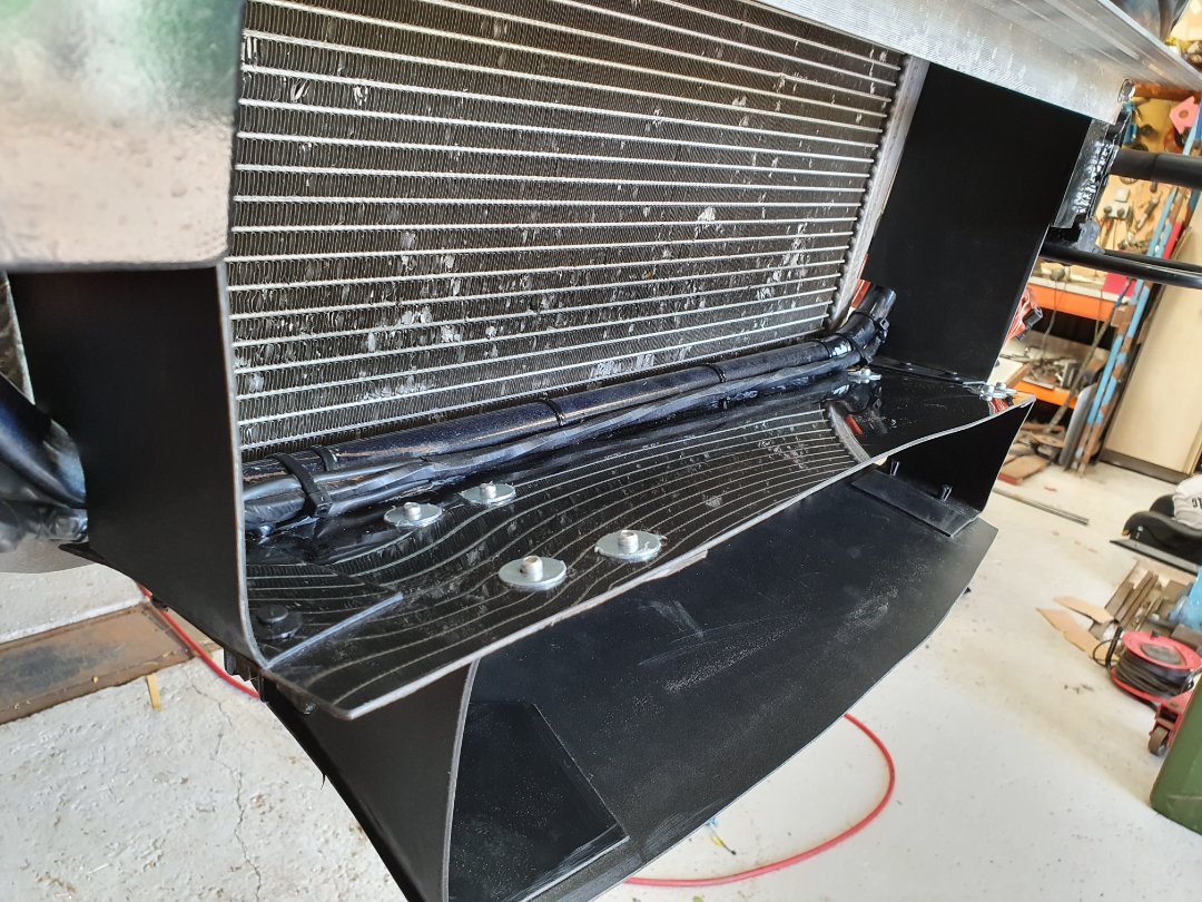

I dont seem to have any photos of the bumper mods but it is now fitted with aero catch quick release mountings.

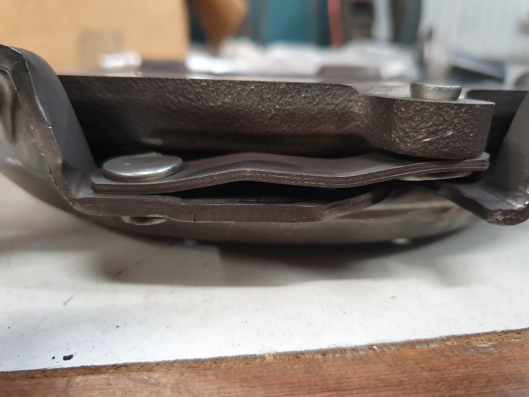

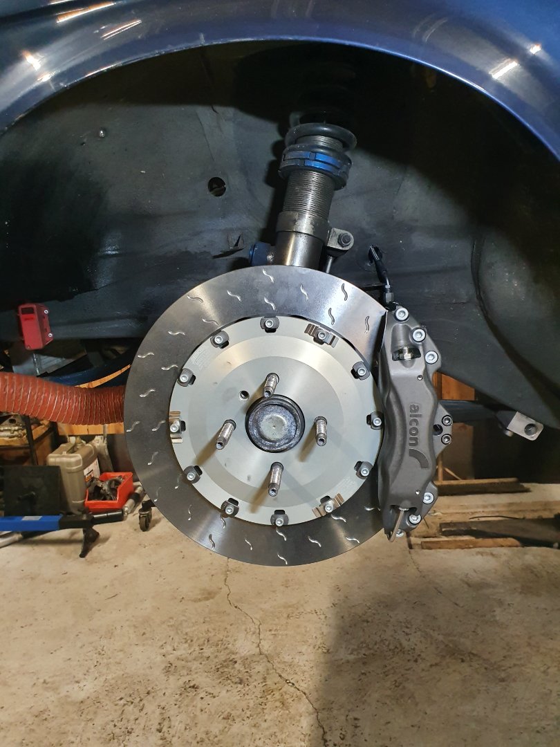

Next mods were brakes, id had the Porsche 6 pot front and 4 pot rear on for probably 4 years now and was starting to get the better of them.
Looking at the rear pads that id never changed it seemed the rear brakes were doing 3/5 of bugger all so I decided to go back to standard 325i rears, this saved 10kg on the rear axle.
For the fronts ive used Alcon 4 pots with fully floating racing rotors and custom made ally bells, this has saved another 10kg on the front axle!
In other areas ive fitted a Cobra racing seat

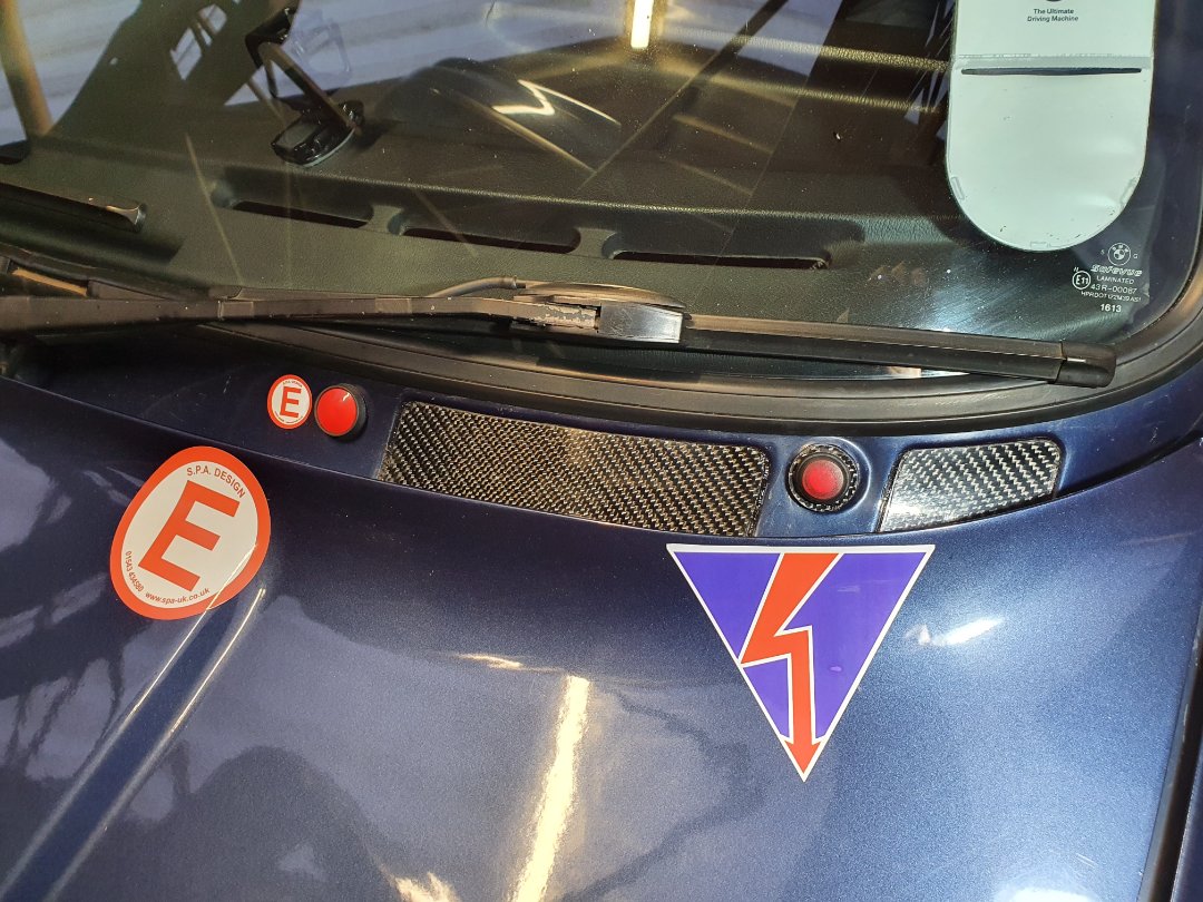

Electronic fire extinguisher system
Lithium battery
And an electronic battery cut off/engine kill system

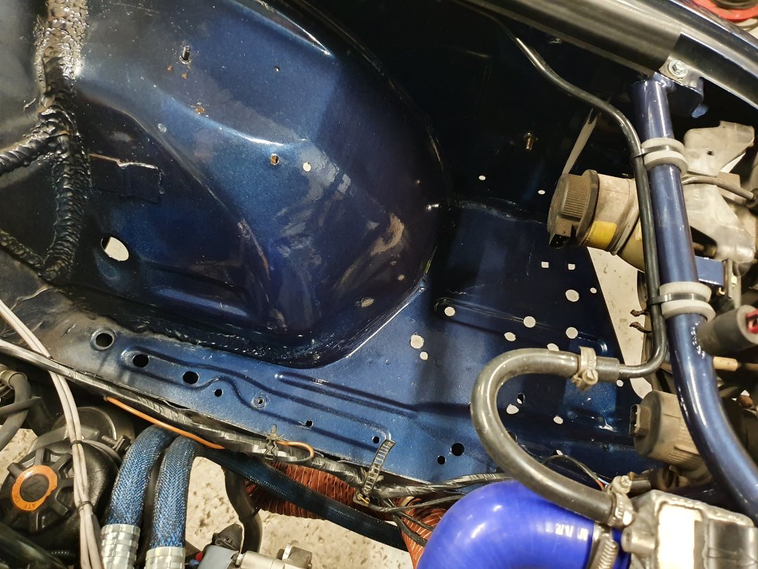

The scuttle grills have also been removed as there is no heater to supply air to and also in an attempt to keep water out of the car/mount some nice carbon panels/switches
Lithium battery

i'd be interested to know where you got the front brake bells from as i'm looking for some but really struggling to find any.

Thanks Steve, the bells were made by BG Developments, not cheap but they are fantastic to deal with and always turn out the best quality parts

Great write up Dan, I actually understood most of it lol.
The welding looks really good mate !!

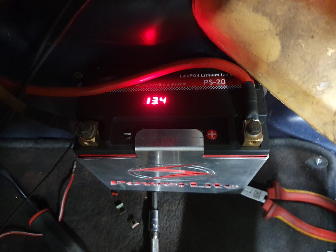

Been a busy chap! I like the simplified rad brackets! What electronic isolator have you fitted? How do you find the Powerlite battery, they're very well priced aren't they.
- Posts: 28646
- Location: Staffs
Its a TE 300a sealed relay Rich, I wasn't clued up enough on them and the preferred switches to use so paid someone to come and do the setup for me as time was running out and I had other jobs to do.
Battery is great, its approx 1.5kg and stays above 13v for at least a month when not in use, the car hasn't sat still long at all this year so couldn't comment anymore! Im sure it has a safety cutout that is activated when it drops below a certain voltage

Ah cool, that's the same one I have. Very good bit of kit! My Braille battery has always been great, I haven't experience of leaving it with the TE isolator but with the old mechanical one, it never lost any charge. While I was doing the wiring it did run down a couple of times and I crapped myself. thankfully the Optimate optimser saved it.DanThe wrote: ↑Sun Oct 04, 2020 9:30 pmIts a TE 300a sealed relay Rich, I wasn't clued up enough on them and the preferred switches to use so paid someone to come and do the setup for me as time was running out and I had other jobs to do.

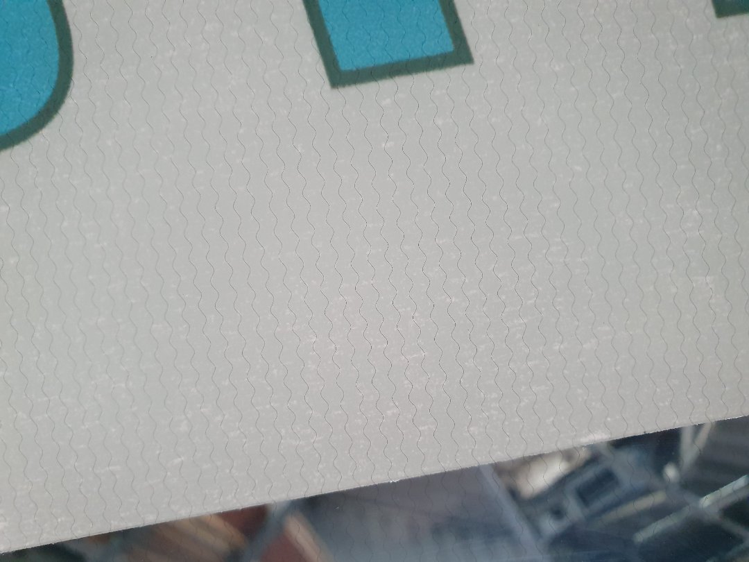

Also fitted a heated screen, after driving blind at Oulton in November I decided it would be money well spent to be able to see where im going!
You can see the zigzag elements in the glass
This was the start of March and by now id had my 2020 race licence turn up in the post so swiftly got online paid up my annual memberships and booked and paid for the first race at Donington in April, a week later Covid struck and everything was cancelled
Another great track day with the car performing brilliantly, short video below, you can see im catching even clearly faster cars on the brakes and through corners
The one thing I did notice had changed was the coolant and oil temps were slightly higher than I would normally see, considering the time of year and being on the coast with plenty of cold air it shouldn't have been this hot but was obviously a result of the front panel delete so I decided to get constructive with some plastic sheet and build some shrouds around the radiator and oil cooler
This helped massively, I did a bit of road testing and saw a huge reduction in temperature when I could get the speed up.

Good Stuff! Goes to show BMW knew what they were doing with the design a bit more than we give them credit for sometimes I guess
Is that windscreen M3 fitment or did you find one to fit as per a standard car? Been looking for std fitment but cannot find one.

Its a standard fit windscreen, I bought this in Jan/Feb but I do know that since covid they have been in short supply as they all come from China!
