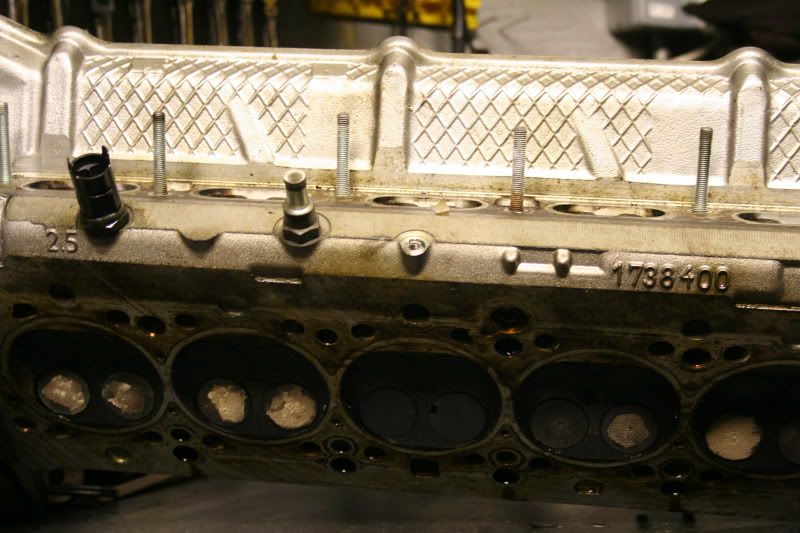

iv been keeping an eye on this for a while, firstly, nice turd, when im back on the English side of the bridge i might have to pop over and take a look.
my take on the head is thus, alpina will have done a very good job, although they do know what they are doing there is no free lunch, so some thought has to be taken as to what they were aiming for when porting the heads.
the 3.2 alpina is not some all out power motor, thats the job of the s50, so i can only assume that the goal of the engine was to give a healthy hike in power while still being happy lower in the range and not treading on the toes of the m3 engine'd cars too much.
which at 260hp ish i would say is objective done.
now in order to do that the head would have to be a mix of the practical for broad power bands and the realistic for cost.
by the look of it the valves are standard size with a 30 degree back cut on the inlet and have a multi angle seat on both inlet and exhaust. (obviously a 46mm bore here would allow/require for larger valves for highest output).
the ports also look to have had the surface finish massaged, the center divider has been knife edged and had some relief around the roof, guides have been smoothed in as best as possible with some area increase either side of the guide to maintain csa.
it would also appear that some kind of 70/60/65/75/80/who knows cut has been made from the seat into the throat.
its all good but its not the last word in power, which is clear from there intentions, so i dont see why it cannot be improved upon provided a sacrifice of some kind is made, most likely a small amount of power low down.
so 40hp? well thats another 15%, its quite a bit but i dont think its impossible, although as said it would come with a price.
(disclaimer - this is all based from the photos and is all as best as i can see without measuring anything, its also all imo so take it as you will.)
i would suggest sticking the standard head on it with just the multi angles done on the seats to suit the alpina valves and a bit of split rod with 400 grit in it to run over the ports, this you could do yourself with out real fear of buggering up the port dimensions, just use the split rod to smooth the casting surface.
go with that for a cheep £240 head rebuild and see how she is.
get it on the roller when its done and see what it makes, i would bet £10 its down on power by no more than 15hp. (around 245-250)
when thats done consider if its really worth the cost to go the whole hog on this car or if your willing to make some of that power back else where thats cheaper.
if the answer is yes i want the works done, then you can sell that worked head for a nice return, probably the full £240 it cost you to have it done.
on another note, is the exhaust valve in the middle of the picture of the 2.5 head missing a lump? :eek:

just to be clear as that was a terrible explanation before, i meant the rh middle one here.
the dark chamber makes me think its had a misfire/loss of compression on that one?

HairyScreech wrote:Image
Looks like a chipped valve to me.

right lots to say here, the valve wasn't chipped. The head or valves on the dirty head pictured cam from a nikasil failed engine. It was hammered the best i've seen, a huge thick blue smoke stream it used to leave up the road from cold!!!

Has the Pina head been pressure tested ect ?

e30topless wrote:Has the Pina head been pressure tested ect ?
i thinks its cracked again
repair that head or build/rework another to the right spec is the way forward

Kos wrote:OK barry
you're right
I know.
Kos wrote:but a question
how much is the head gasket and associated parts ? it is still an extra cost later down the line
Well a genuine BMW head gasket is £125 so a victor reinz one will be less than £100.
The head bolts are £11 for the set and the exhaust manifold and inlet manifold gaskets will go again.
So we are looking at about the £100 mark for the parts, not much different from the auto trans oil.
Kos wrote:while it may be agrro to change the engine, so is pulling apart an engine that is working fine to do a job that can be done now. the car is off the road and its costing you more money and time
Yes but its much more time and aggro to change an engine than to do a head gasket and will cost more time and money and the car will be off the road longer.
Kos wrote:he bought the car because he likes it and based on the fact the rest of the condition is good and it can be a nice car. which is why you bought he B10.
did your B10 really need all the top end work ? some money has been spent on it, and i'm sure the cost of what you have done so far is mounting up. will you get it back? no but it feels good doing it right doesnt it
Yes it did need some top end work because the retard who worked on it before, didn't put it back together properly. All i did was take it apart and put it back together right, no expensive head repairs.
Again, you do not know what the B10 has cost me so how can you say that? I know it owes me less than what it realistically is worth at the moment thanks to some schrewd buying and selling.
This is all irrelevant though because my B10 was a known entity where as Simon's is more of the unknown.
Kos wrote:there are 2 or 3 options he has, i say do it once and do it the right way. the mileage on all the cars he has is high and will he ever recoup the cash spent ? no, but there's a sense of satisfaction in doing things the right way. why take the easy way out and save 800 now ?
if that was the case, you car, simons cars and few others here would just mingle into the crowd with the rest.
the car performing as it should will make it sell later down the line. if it does not feel as good as another then it wont sell, mileage or not. while mileage affects the value, these cars are as much about performance as well as the overall condition
I dont think you quite understand what i have been saying, yes by all means get the B3 back to how it should be but be smart an make sure its ok in other areas before dropping £800 on some head work.
What if Si dropped that £800 on the head got it up and running then found out the box was f*cked? Should have sorted that first so he could at least use the car.
Kos wrote:if it was you, i'm sure you'd do the head work and have it as it should be. i dont know any one as particular about the details on any car as you ;)
I may be particular about the details but im also realistic and wise to what may be a potential problem. That headwork would not be getting done till i knew the rest of the car was ok.
Kos wrote:PS, ews is not that complex, and certainly does not require changing barrels and keys.
simply swopping the chip from one key to another does the job
Come on Kos, i dont need lessons in EWS from you or anyone.
Its quicker to change a barrel (and its reversible) than to hack up two keys for the chips to be swapped over.
There is only one sensible route to take and Simon has already realised that's the one to take.
