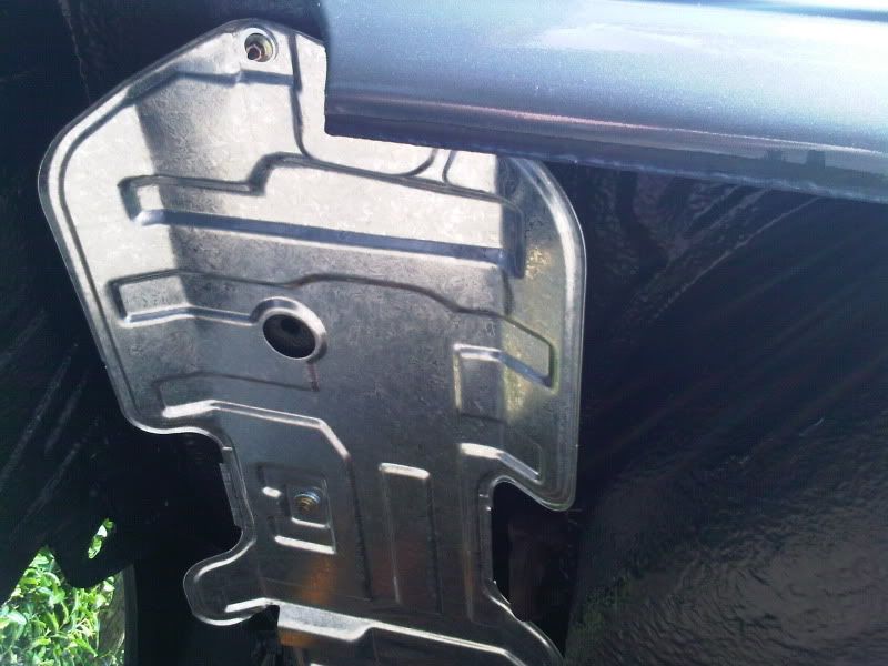

Just a little update.

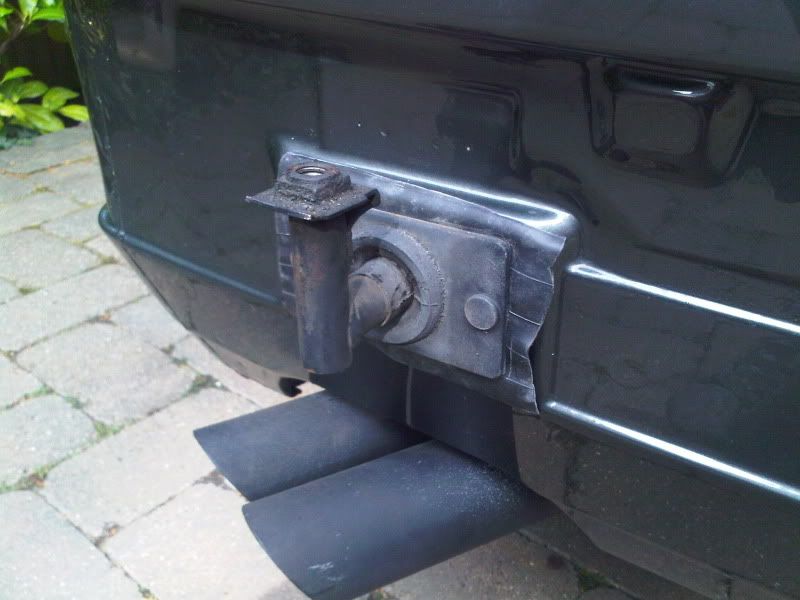

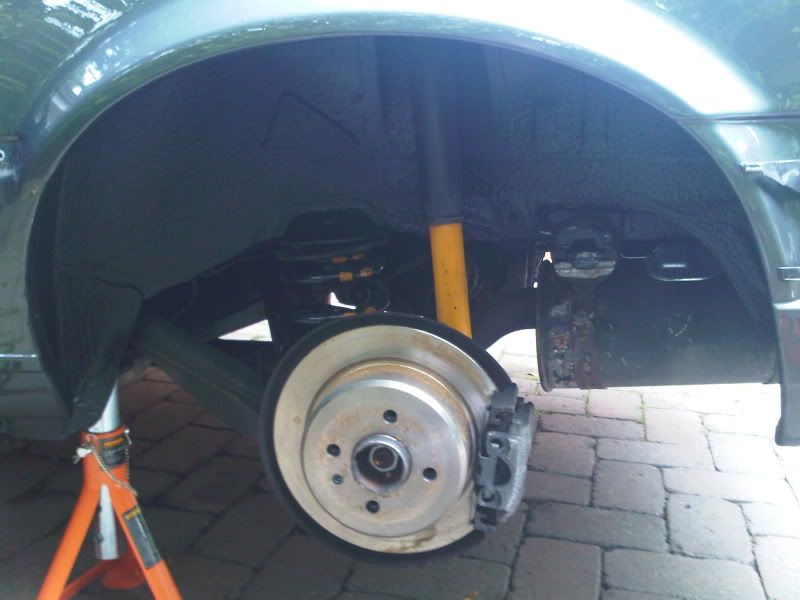

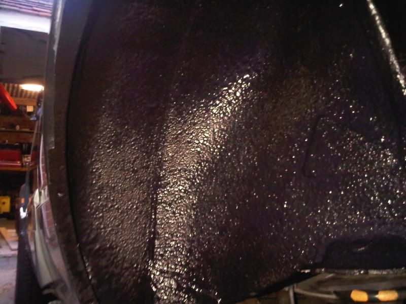

I decided to seal up the back half of the car properly before winter (and with it, salt) sets in.
First I removed the exhaust, shocks, fuel filler pipe, body kit, and anything else under there.
Then used a high pressure washer to remove any muck, and then spirits to remove any grease, then another pressure wash.
This revealed a couple of tiny areas of surface rust, which I took back to grey metal using a wire wheel, and then ground back to shiny metal using sanding equipment. I then etch primed the bare metal with several coats. Overall however I was very very pleased to find basically no rust whatsoever :) . Not a spec now.
I then bought an oil free air compressor, schutz gun, and 4 litres of BMW underseal. After masking up the car carefully, this is the result!
Just after I sprayed it on, quite a thick coating, drying. I sprayed it over the arch lips also, not factory, but prevents stone chipping.

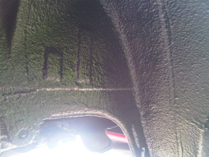

Exhaust area
Anything forward of the diff beam still dirty as hell! Although there appears to be no body rust at all despite all the rusty components. Didnt take the rust off the bottom of the diff mount stupidly, so didnt cover it.
This stuff splats everywhere!
Shiny new exhaust heat shield
Once dry it looks factory, and is very tough
With the wheels off was an opportunity to adjust the handbrake properly to suit the new disks

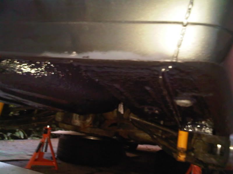

I used a paintbrush to get the under seal right into the arch lips, especially where they are rolled
New plates. I masked down the sides of the car about an inch up from the sill, and the same on the rear valance to ”˜seal in’ the perimeter of the car. Not very factory, but better in my opinion.
Offside arch got a thicker coat so the finish isn’t as nice, but it’s very tough to the elements at least. Flash went off hence looks odd.

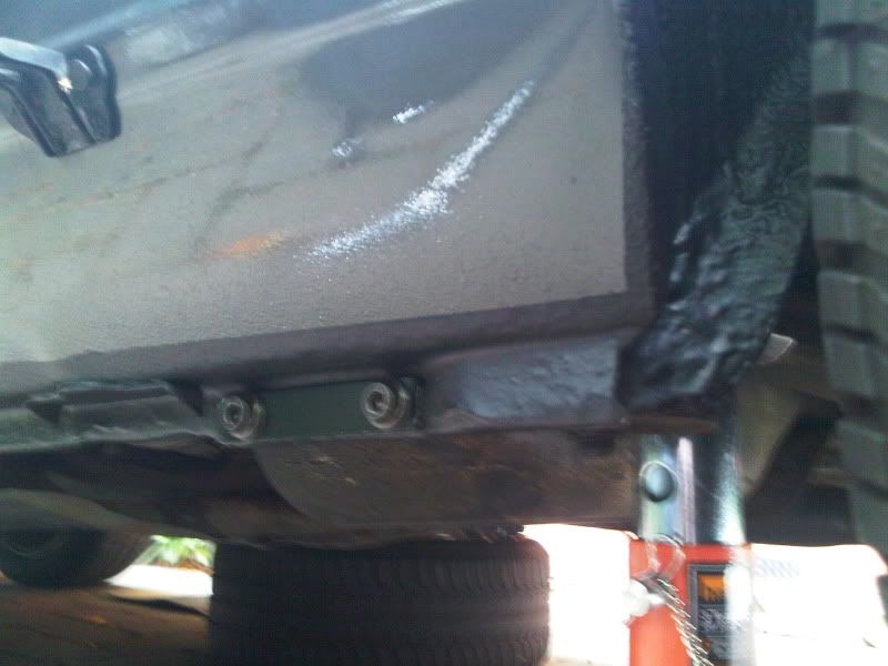

All bits re-fitted with new bolts
I used some bike inner tube to protect the paint from the bumper shock absorbers
Job jobbed.
The pictures don't really do any of it justice, but it looks news.

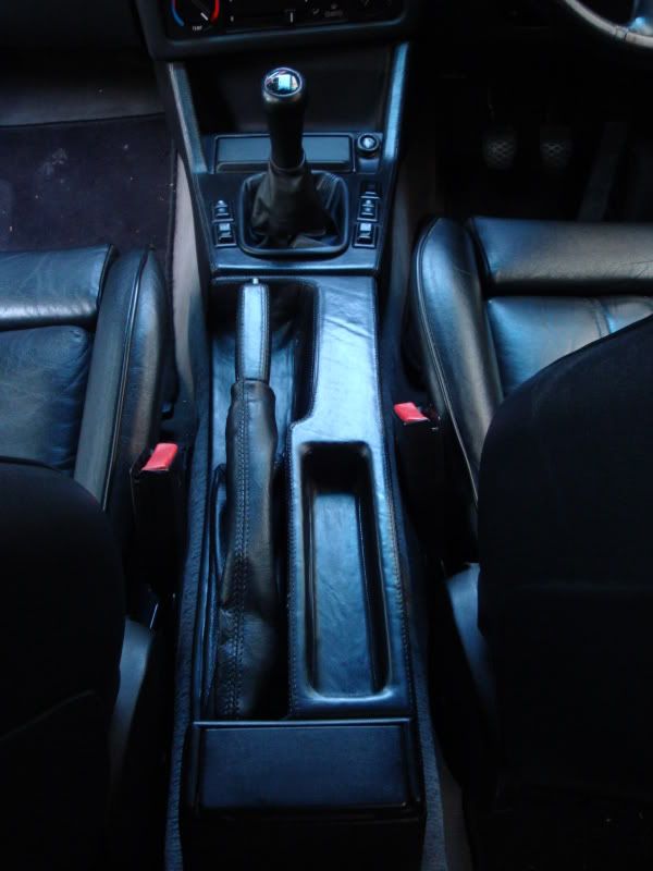

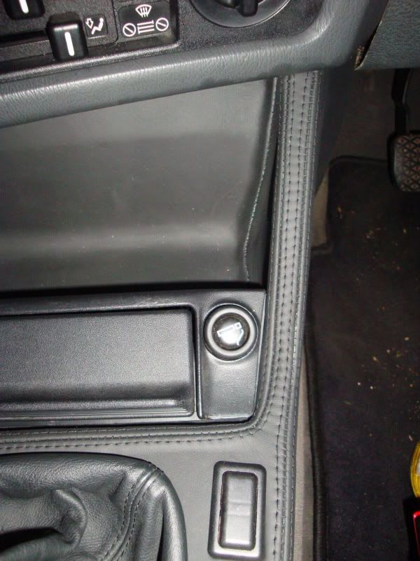

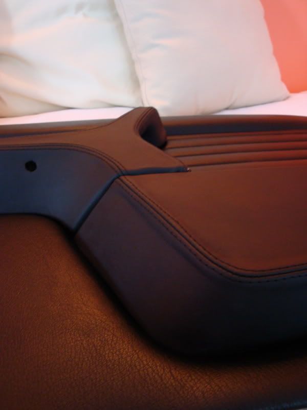

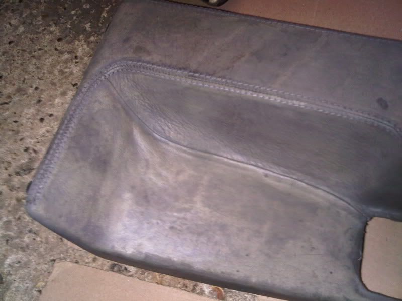

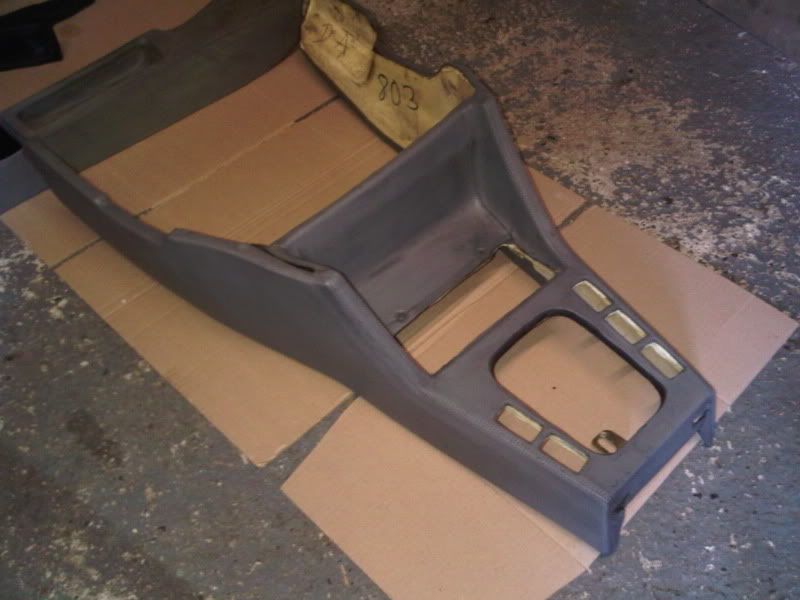

A quick update. I bought a leather centre console from a motorsport cab, and changed its colour from grey to black using the kit from furniture clinic. I would highly recommend the kit, as it involves dyeing the leather the same way as in the factory.
First, a leather console:
Then you prep the leather by stripping off the sealant surface applied in the factory and removing the dye, using leather prep. You then clean using alcohol. You can see the natural leather showing through.
Other bits I was doing:
I then applied three coats of black with a sponge. I then applied three further coats using a compressor (oil free) and a small spray gun. You then need to apply a seal to the leather, again spraying on three coats (the same as the seal applied by BMW when its new), and finally spraying on a single top coat of leather finish.
I hung them from the garage roof for spraying:
I left them several days to dry properly, and then worked in a leather cream sold by Gliptone. The leather now feels soft and smells great. The pictures don’t really do it justice, and make it look a little more shiny than in reality. The ashtray surround is leather also, but I opted for the original ashtrays.
Moved the heated seat switched forward to fills the holes. A better place for them really.
And a few of the car back on M-tech suspension:
Thanks for looking

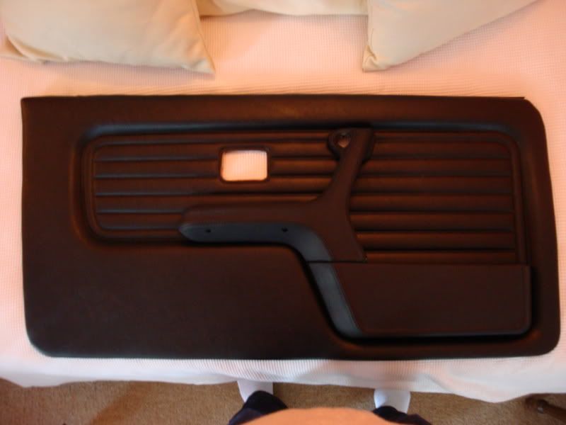

The car is looking amazing Paul, great work. Would be nice to get a set of leather doorcards to compliment the other leather bits.

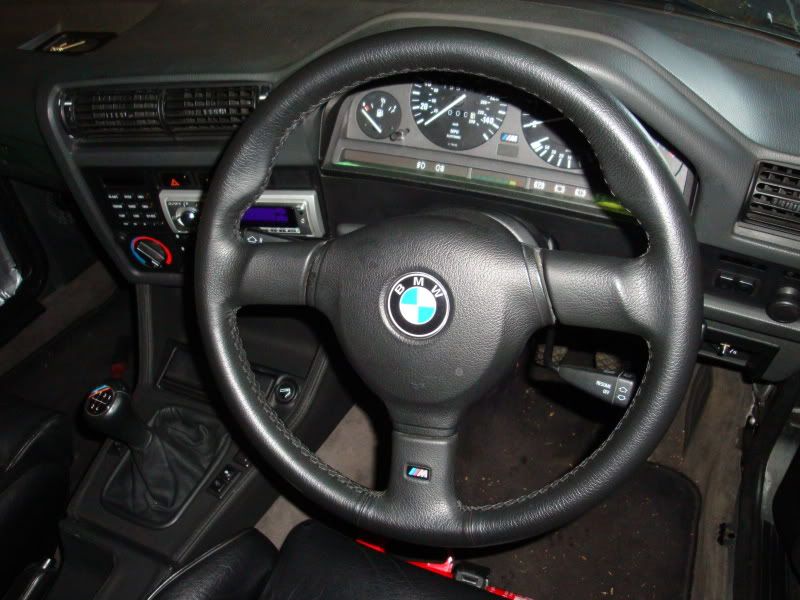

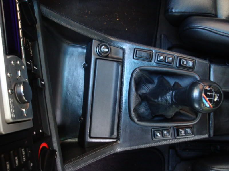

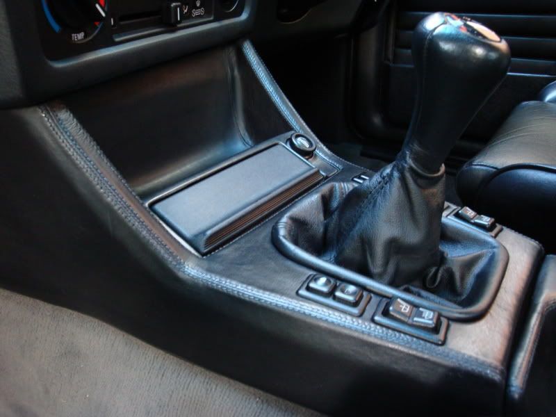

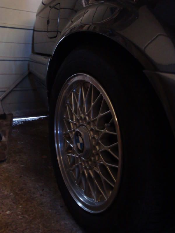

Just a couple of fun things I did recently. Rubbish pictures taken in the garage, the flash makes it all look a bit odd.

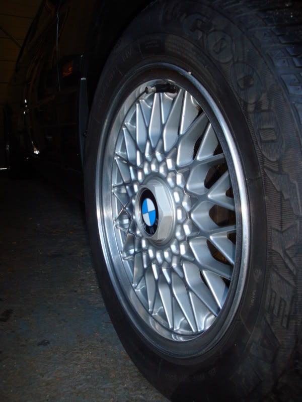

Re-furbished BBS with polished lip. Thanks for these Kami, they polished up great.
Standard clocks in an M3 housing.

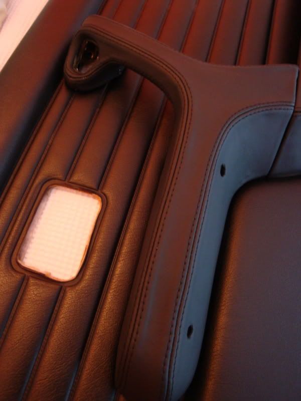

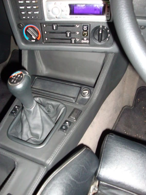

I changed my console for this new one I had made up by a company in Germany (yeah pretty sad). It’s an exact copy of the motorsport one, but trimmed in black nappa leather. Also had the door card pockets and handles done in nappa leather, again exact copy of the BMW stitching.

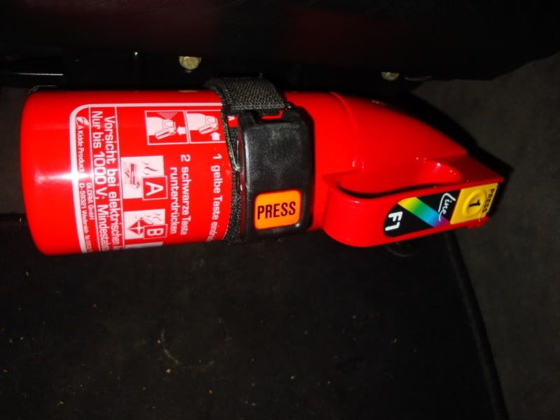

Fitted a new BMW extinguisher, which I realised was a good idea after an E30 I was driving recently caught fire. To do this use an original E30 seat bracket and strap, and bolt the new extinguisher and holder to it using the original bolt holes. It’s designed to fit, and will work in an emergency unlike the old ones.
And a nice new BMW tech 2 wheel
Also fitted a heated kit from a 325iSE - drivers mirror, washer jets and door lock. Never thought I would be that sad/boring, but the mirror is useful in this weather.
Cro320 ”“ Yes I have actually put chrome exhaust trims on it, pulled them off a breaker the other day!
It’s not a garage queen though, have had some great fun lately in the heavy rain on some roundabouts near me, had forgotten how easy these are to control sideways. Haven’t been out in the snow yet though, wouldn’t get up my drive if I tried anyway!
