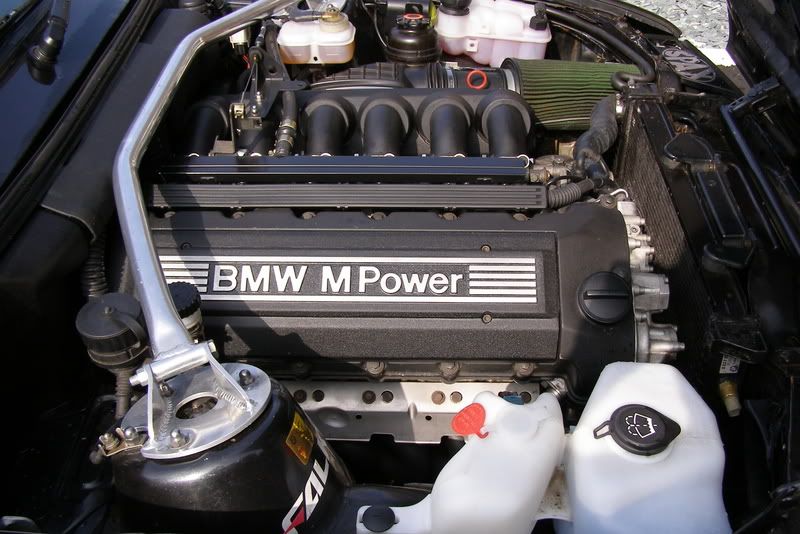

old_skool_2002 wrote:Having seen Buster's, I would be happy to achieve that factory look. Having not seen another one installed, I.e. Ians or James's etc. I can't comment. Any chance of some S50 engine bay pics guys?
Here's mine 8)
Ian.

Thanks Ian, I want to do it just like that. No point trying to reinvent the wheel. It looks factory which is just what I want. You should be very proud :D

ian332isport wrote: Here's mine 8)
Ian.
thats a neat install,looks like it grew there :cool:

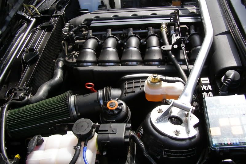

here's mine :D
I used the m3 bulkhead covers for ultra factory look winkeye
carbon airbox pic.Not using it but may do later as it needs more modding to fit it.
Im not a fan of the aftermarket airfilter but it came with the engine.Id like a proper airbox.I wonder if an m30 one would fit :mad:
That does look good, did you have to mod them to fit Buster?

[quote="old_skool_2002
With my ABS removed would I get the E36 airbox in do you think? :?
That does look good, did you have to mod them to fit Buster?[/quote]
Quite possibly,its the abs pump that gets in the way.
The bulkhead cover just needed a small trim where the number 6 inlet pipe goes.

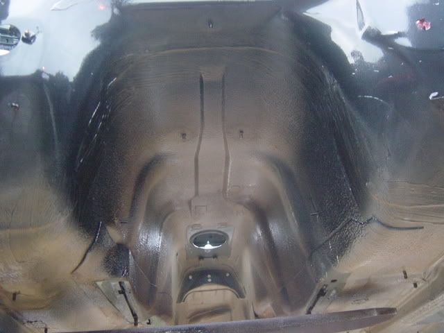

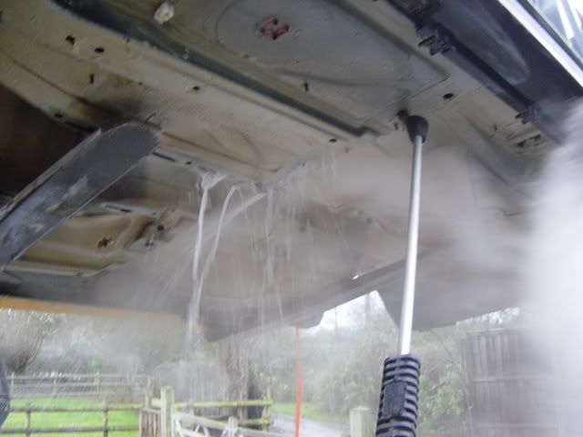

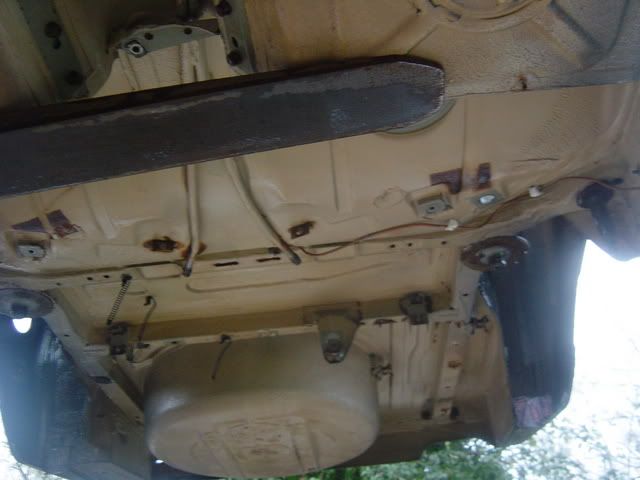

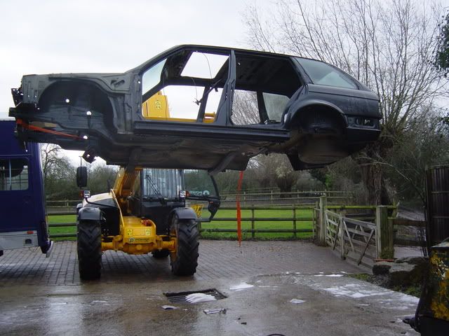

Due to being grounded with Deli Belly all week I haven't done much apart from rip out more odds and ends from the shell and get it cleaned up. Unfortunately it was raining here today and didn't fancy sandblasting in the unit. The last time I did any inside the place took a week to clean up.
So I made use of the inclement weather and decided to steam clean the underside of the shell. I just know you're gonna love these pics. I got bloody soaked through :D
Handy having toys around to play with :D
I used 25 litres of traffic film remover but it was worth it. I now have clean fingernails too. Note the conrete block to stop the shell tipping backwards 8O
Hmmmm Beige. I'm well chuffed with the way it's cleaned up. Next job for the underside will be to die grind and blast away the rust spots, overcoat with brush on sealer and paint the whole underside of the car (in beige). finally enough waxoyl to kill an elephant should finish it off nicely prior to reassembly.
