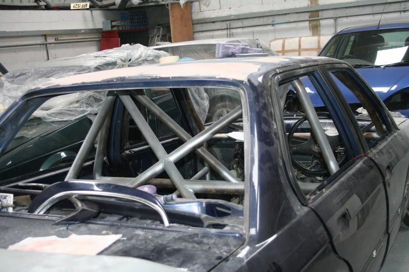

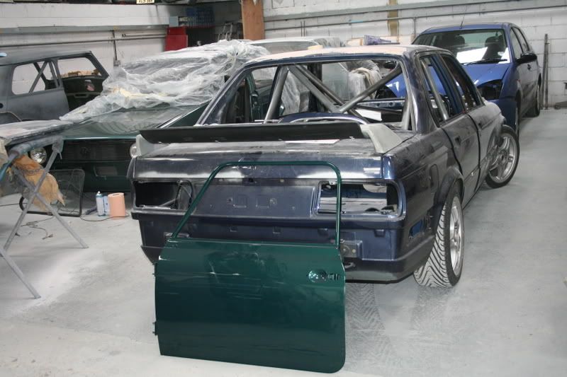

Mon Sep 03, 2007 8:50 pm

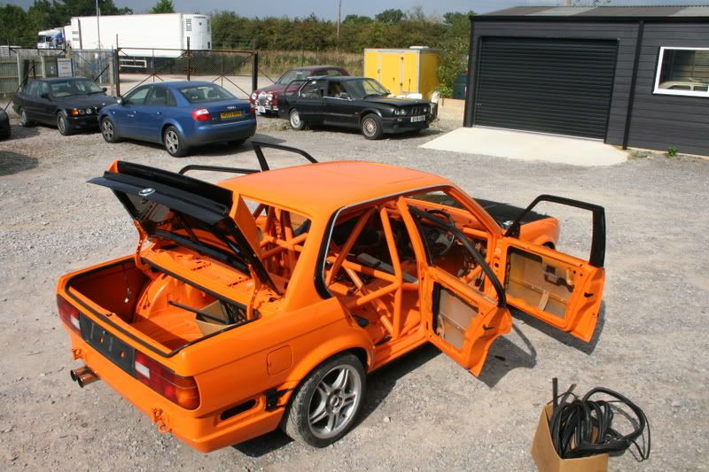

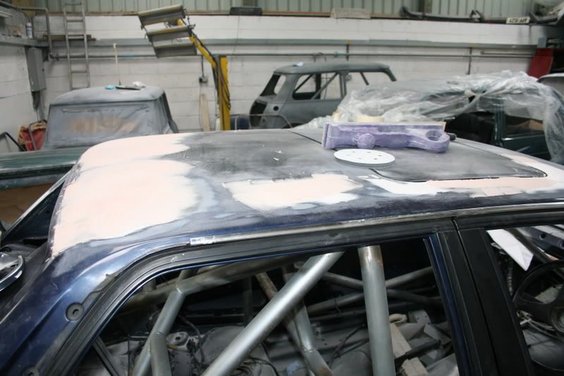

Went to visit the old girl on Saturday. It's at the painters and will stay there till my mate returns from holiday in 3 weeks. In the meantime the colour will be on and baked :wink:
At the moment not much has changed. The roof is full of filler to try and sort out the mess I made of removing the sun roof :wink:

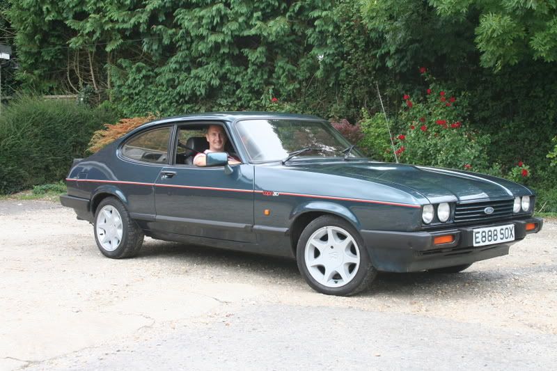

While I was there I had the chance to drive a friend Capri 280 brooklands. It brough back good memories from years gone by. The car is for sale if anyone is interested.
Andy335Touring
Posts: 7144
Mon Sep 03, 2007 11:07 pm
Nice old beast those 2.8s, mine was my 1st RWD car

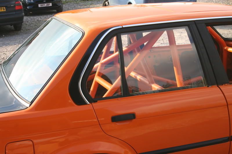

Sat Sep 29, 2007 9:35 pm

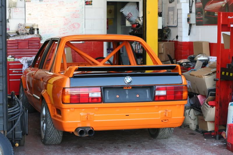

I havent seen the old girl in the flesh yet, but other than a couple of minor issues that the painter will put right once we have finished rebuilding, all is good.
I am very pleased with the result.
The paint is 997 GT3RS orange and apparently takes loads of coats and is a pain to apply :mad: The interior is the same colour but in matt. Once the black seat, black flocked dash, black wheels, black anti slip floor, black trim is on it will look fine and dandy..... Well I think so anyway :wink:
Oh and the chrome bits will be black too

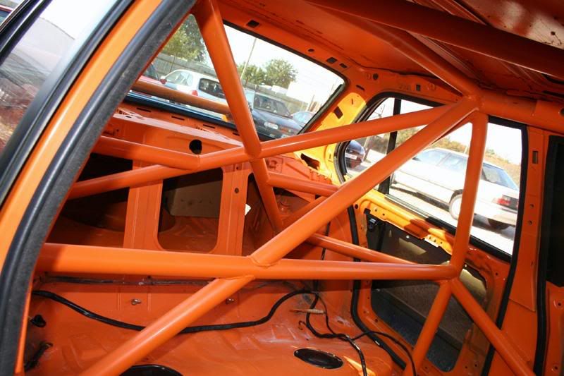

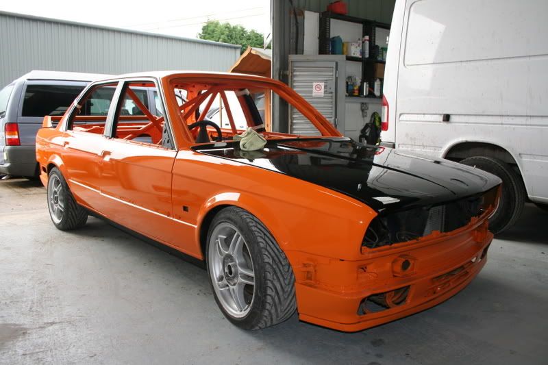

Spent another day working on the old girl yesterday. It was my first chance to see it after the paint job and I have to say I was really happy with the results. There are a couple of minor issues but the painter has agreed to sort those plus any other marks we put on the car during the rebuild.
First up I had the chance to chat to my friends who were on their way to the ring. It was Jasons first chance to drive the supercharged Exige on track and he was looking forward to it.
My initial impression on the colour was that it looked good, even when in a not greatly lite garage.
Another friend Nick arrived to say hello and scowl at his Mk2 golf. Alot of money has been thrown at it in the last year or so and he has had nothing but bad luck. The latest engine has been found to have a crack on the sump so it may have to come back out again. Probably the 10th time in the last year that an engine has been put in or taken out. This one is running a safe boost and producing around 250bhp. Not bad for a 900kg Mk2 Golf.
A couple of random pictures of the old girl prior to us starting on the trim re-fit
Side trim cleaned and fitted
Gareth putting the door pins, locks and handle back in place
Nick turned back up without the kids this time and took the Mk2 for a spin up the road. Spin being the main word....... Nail it at 50mph in top and it spins the wheels :mad: Sooner him than me
Next up we fitted the rear window. A pig of a job but it went in eventually
The heated front window was another git of a job, but we got there in the end
Next up it was time to fit the plastic windows made by a local glazing company. We had pre-fitted then several months back so knew they all fitted. Always worth doing.
Finally we started thinking about spraying and fitting the under window trim. Chrome just doesn't cut it so we are going for black as shown here.
Next visit should see the rest of the window bits finished, other than we have to come up with a cunning slider for the drivers window for access to the ticket machine at the ring. With a bit of luck the bumpers will be cleaned up and fitted too. Once that's done and the other chrome blacked out we can move inside and start with the dash etc.
Loads to do still .....

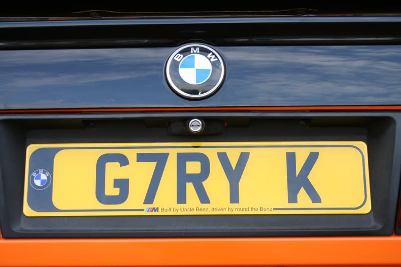

I thought I should do the most important job first and fitted the rear number plate

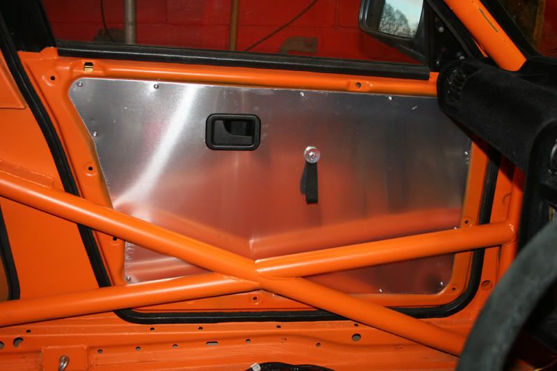

That done I got on with doing the front door panels. No more broken drills, thankfully
We decided that we would keep the std intrument panel and make a few mods for our switchgear. Hopefully that will keep things neater. Heater controls etc need to come out and new stuff going in. A little homework for me.
Finally Gareth made up a couple of door handles that we fitted.
