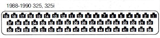

For the coolant temp sensor, you did the check on the sensor itself. What about the wires? The issue I currently have is that the sensor is correct, but the wiring faulty, so the ECU reads a constantly changing resistor value. Therefore the ECU constantly adjusts the injection even when trying to drive at a stable speed, causing erratic behaviour of the engine. I hope I'll get the connector and other furniture I need tomorrow to get it fixed.
To check if the wiring is faulty, you need to unplug the ECU and measure the resistance value directly from the ECU plug. I'd recommend to slightly move the cables while measuring to check for any variation in the measurement, simulating driving conditions.
See the table below (pin 45 and ground):
- Pin table:
- Tests table:
As for the AFM, I'd say it would be surprising since after your reconnect the battery it runs fine. Yet, that could be another lead. On my side, I could not find a new carbon track, so I had my AFM refurbished by ATP Electronics (https://www.atpelectronics.co.uk/). Good for you: they are located in the UK! Very professional service, super fast. Rather expensive - still less than a new AFM - but refurbishment guaranteed for life. I am fully satisfied with their service.
But recomment you test the coolant sensor wiring first. :)
