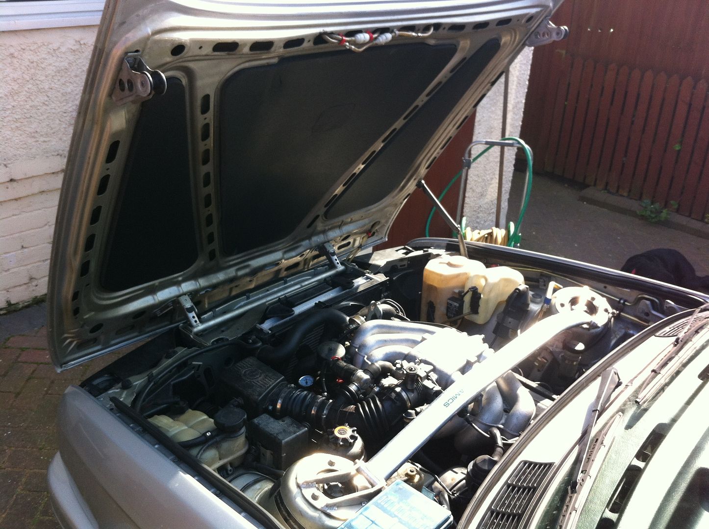

Little update been a bit busy with over stuff had a spare couple of hours today so give the rear speaker frames a spray over with plastic coat was getting sick of looking at the silver shine.
Give the car a service change all the filters except the air filter and plugs will change that after the 25 inlet manifold arrives also going to do the tappets the pipe came thats needed to get rid of that bodge work.
Fitted the new foam under the bonnet looks great new wipers and the fuel rubber filler thing
Now just waiting on the inlet and door pockets get rid of them crazy door speakers and do the tappets
