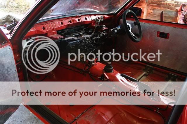

The cage arrived the other day and I got the car over to the chap who's fitting it for me. I had to take a couple of steps back and spend a bit of time taking the fuel tank back out again (along with the prop and exhaust) to give him piece of mind when welding the main hoop on. I also removed the rear quarter windows to make it a bit easier and to make way for my polycarbonate ones which arrived the other day too. I didn't have time to remove the rear one but it's scrap any way. I won't be fitting the new windows until the cage is in so they don't get trashed by rogue sparks.
Also got a bit over excited ordering shiney bits for when the cage is in. Got a 14inch mirror, OTTO lap timer with beacon, Carbon door cards (which I'm still waiting to arrive), tow strap for the front and some aluminium bolts to replace all the steel ones holding my P-clips etc.
Hopefully next time I'm back home the cage will be in and I can be on my way with painting it and getting all the bothers bits bolted on

It's been a long time...... but something has finally happened and I received this long awaited photo of some actual progress with my roll cage:
Not close to finished though
The rear section still needs to be done along with the extra gussets to tie it all together but the light it beginning to shine on this chapter. I'm looking forward to getting it back and painted so I can fit the pile of bits I've been hoarding

Cheers mate, feels like I'm pretty much starting again with everything that I now have planned lol!
I had a few days off work this week after a mammoth stint and I was able to get over to the chap who was fitting my cage and give him a hand for that big push to get it finished. I got the car home today and I'm really happy with it. The cage hugs the car so tightly it was a bit of a mission to have room to fit the gussets to the A pillars. As a result they've turned into more of a token gesture but every little helps
I managed to get a full coat of primer on it as it was getting dark this evening. I'll be going away again after this weekend so won't likely get to put another coat on until I get back.
Now that is sorted I'm now organising for the engine to go away and be inspected and rebuilt with a local chap. While it's away the plan is to get everything else up together so I can drop it back in and have a car that's ready to go
we shall see how well that works out lol!

The heater box arrived and I set to work removing the standard heater box and fitting the new one. I've mounted it on rubber anti vibration mounts which are attached to the tunnel with M6 rivnuts; then the heater is held onto the rivnuts with K nuts:
I've had a quick nose at what pipes I'm going to need so will get those ordered up in the week.
I also gave the tunnel a dusting over with the rattle can before I got into spraying the rear half of the cage and the rear parcel shelf:
I quickly ran out of paint though and the local Helfrauds didn't have any more cans of BMW bright red so I called it a day. Last thing I did was mount my Anderson plug bracket:
Next up is get a spare dash to trim to fit around the cage, plumb the heater in, finish painting, fit windows, so on and so on...

October is here! Time flies. First order of business for me was to get the dash trimmed to fit around the cage so I can get the rest of the cage painted. The primer took a battering so I'm glad I waited. Weapons for this job were a sharp knife and a set of snips.
I was going to get the dash flocked but I might not bother and save myself the money to be honest.
So that was done and out came the rattle cans to finish painting the cage:
I then fitted the carbon door cards. I mounted them with aluminium button head bolts and floating anchor nuts. I was going to cut out holes for the door handles but I decided I will leave them and go with a pull cable.
Lastly for today I plumbed in the heater box with the fittings I got from SFS Performance:
If the weather isn't too crap tomorrow I'll look to get a few more bits done on the interior to get that on its way to being finished

I decided to go ahead and fit the dash today, get that done and dusted. Also went over the loom and replaced cable ties and generally gave it a bit of a tidy.
Had a go a fitting the rear quarter windows this eve but the light was fading along with my patients so that's a job for another weekend I think.
