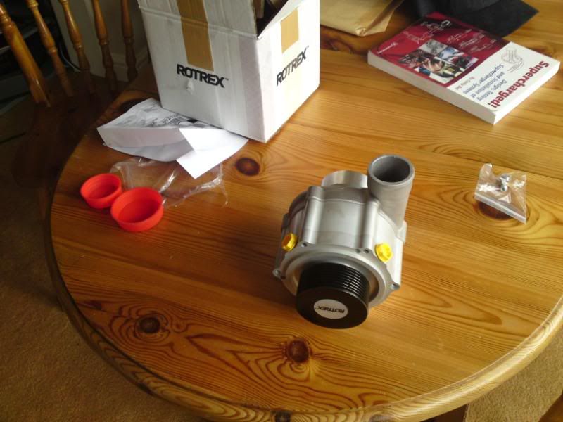

Result the new charger is here and fitted started the running in process and should finish it tomorrow. Then its time to give dave walker a quick ring and see if he can fit it in one evening for a remap to make sure its all ok :D
C30-84
C30-94
The new charger is obviously different, the impellor looks smaller with more blades and the the shaft is also different.
The inlet size is also reduced although only at the end nearest the impellor so all the pipe work still fits perfect. :D
cant wait to get it running again, only thing i need to wait for before a propper run is abit more charger oil as its towards the min level although still more than ok for running in, at £70 a ltr its dear stuff to! :eek:

Fantastic stuff Matt, way faster than I expected. Takes me ages to get nice new performance parts shipped down south. Sometimes they take so long that when they arrive I've forgotten which project they are for :D
Is that an 80mm pulley on the Rotrex?
I see you have Corky Bell's Supercharger book on your table. Great reference that!
In theory (at least) you shouldn't need to have a remap since all the supercharger is doing is controlling the amount of boost as a function of RPM. Choose your pulleys as we discussed before and you should be producing roughly the same boost with RPM (with the exception that this time you won't be close to the surge area of the compressor flow map).
In practice, however, if you do happen to cross over areas of the fuel or ignition map (because of a different amount of boost than anticipated) that were previously unmapped (because the last compressor never went there) then you will run into problems.
I assume that you'll have her mapped to above 10psi boost only once you get the lower compression engine in?
Good Luck! I really do hope you get the results you are looking for. I can't wait to hear how she performs.

Ya, your right well spotted Geoff its been a brilliant book and is somthing i keep coming back to for info on both builds :D
