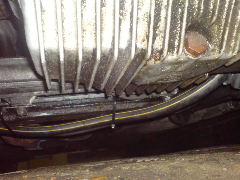

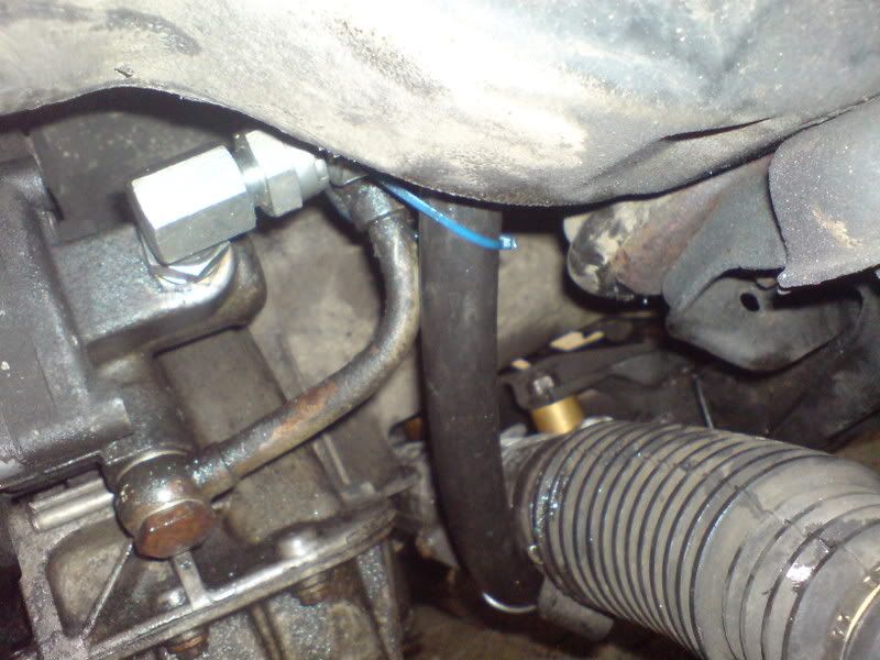

Sat Aug 09, 2008 8:09 pm
Mine is fitted, thanks Dave.
I trial fitted to find the angle the banjos needed to be, then took hoses off and did the hose fittings up tight before fitting them again.
This meant that I could run the hoses, more or less along their original path. This pic is a little decieving but they are above the height of the bottom of the sump, so shouldn't get bashed by any road crud.
Just missed halfrauds closing tonight, but tomorrow I will be getting some fluid and testing. Wheels look pretty damn straight too, but I've booked in to get the tracking done.
How many turns lock to lock is the e36 rack compared to E30?

That last picture sure does look deceiving! I ran my hoses around the front, under the radiator.
It's a terrific mod. :cool:

Good to see they are all working out and thanks for putting up a few pics too. I have some but aren't great so must do a better write up with the next one I'm fitting.
Routing the pipes around the back is handy alright, Return pipe should be nicely cooled too 8)
but just wondering in pic have you the washers at both sides of the banjos since it looks like you put the both of them on the inside between the banjo and the rack...
