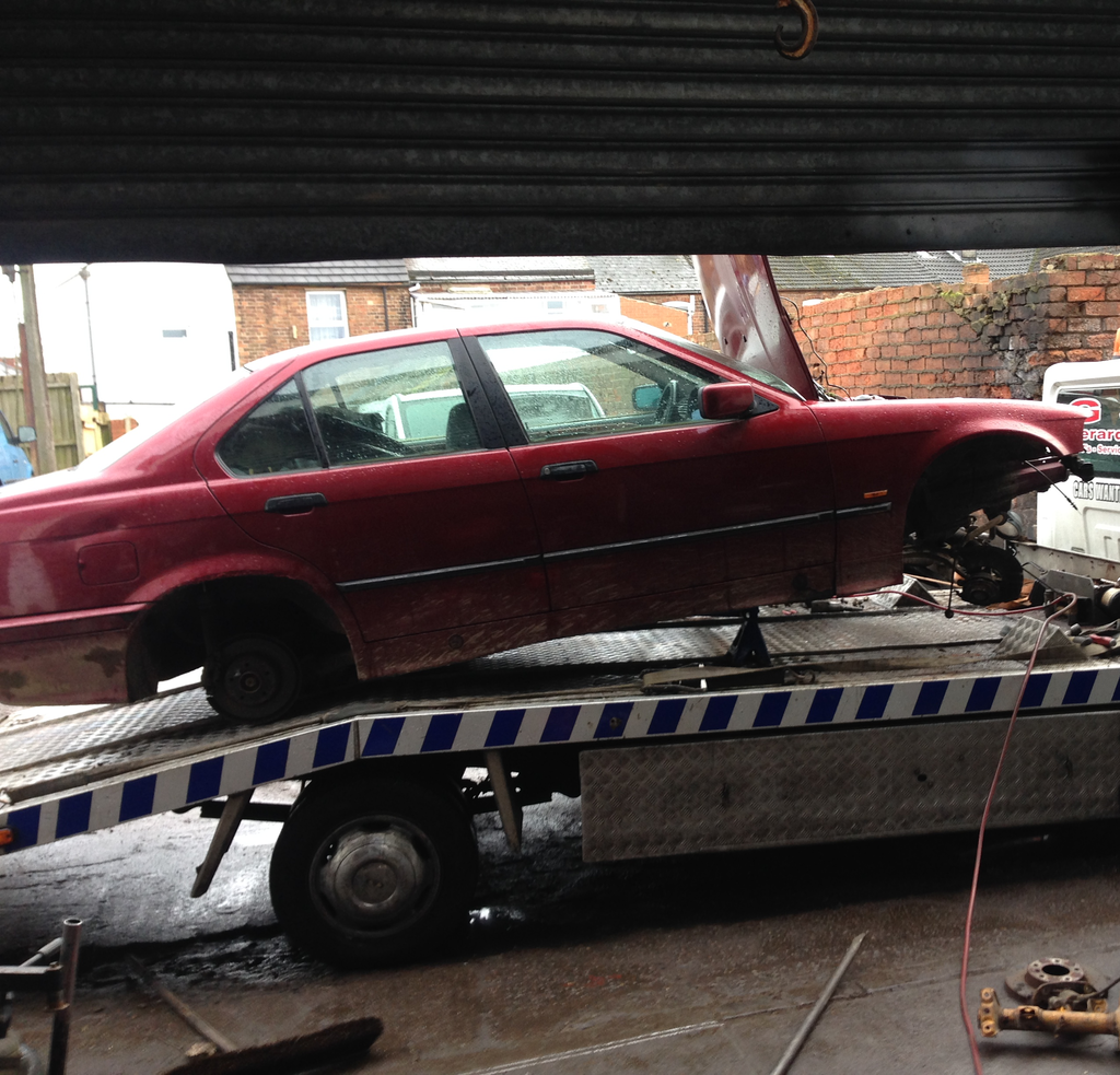

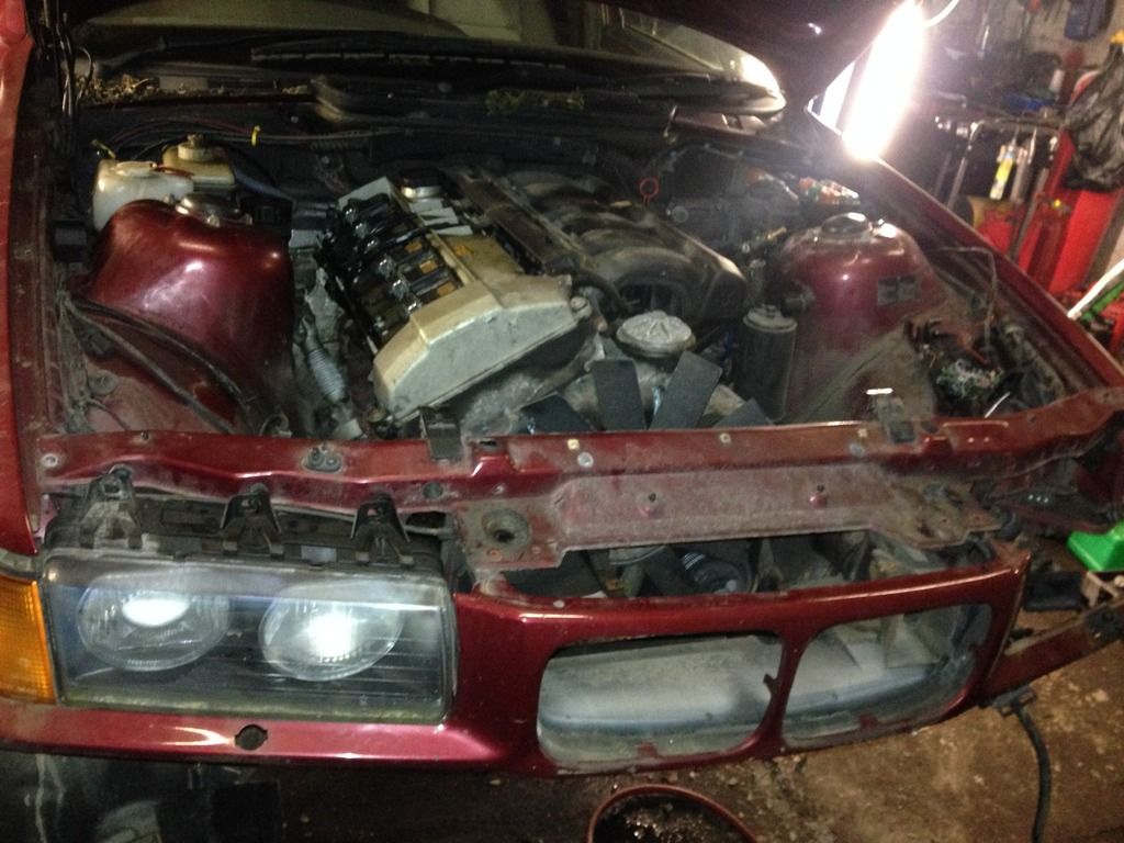

So last year at around 140mph the bottom end went on my M20 and some lovely rod knock started. I limped home and pulled the oil drain plug and found lots of sparkly bits in the oil, Yay!

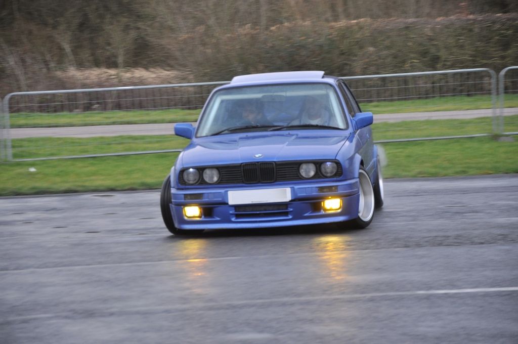

Here's a pic of the car before i blew it up:

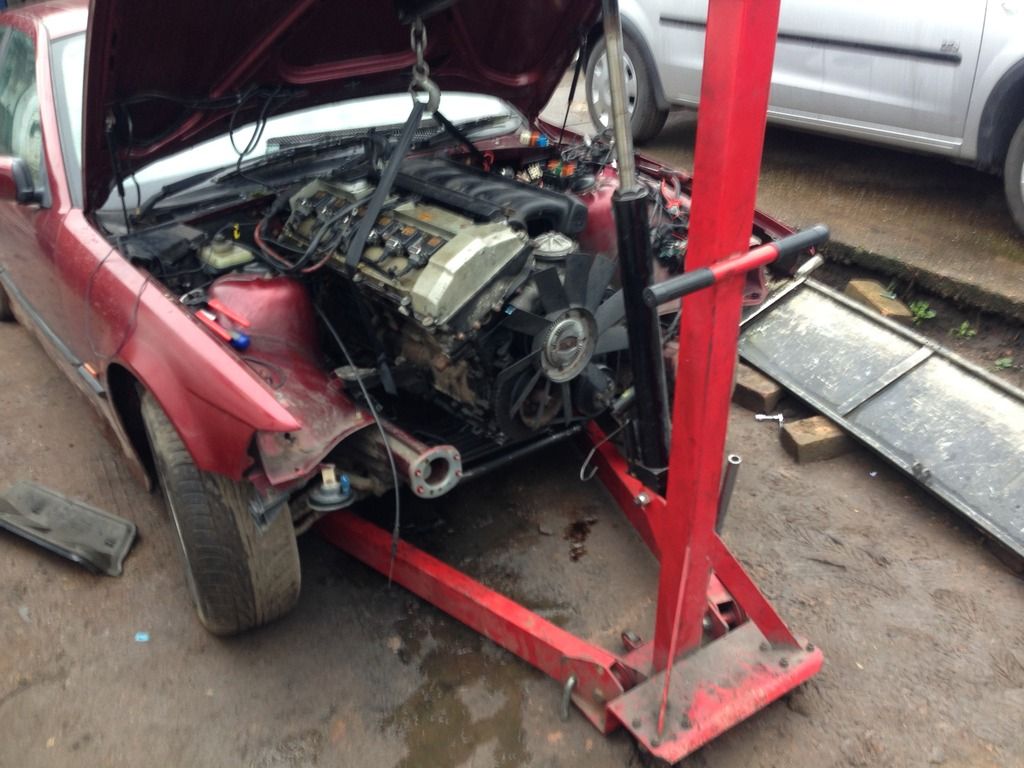

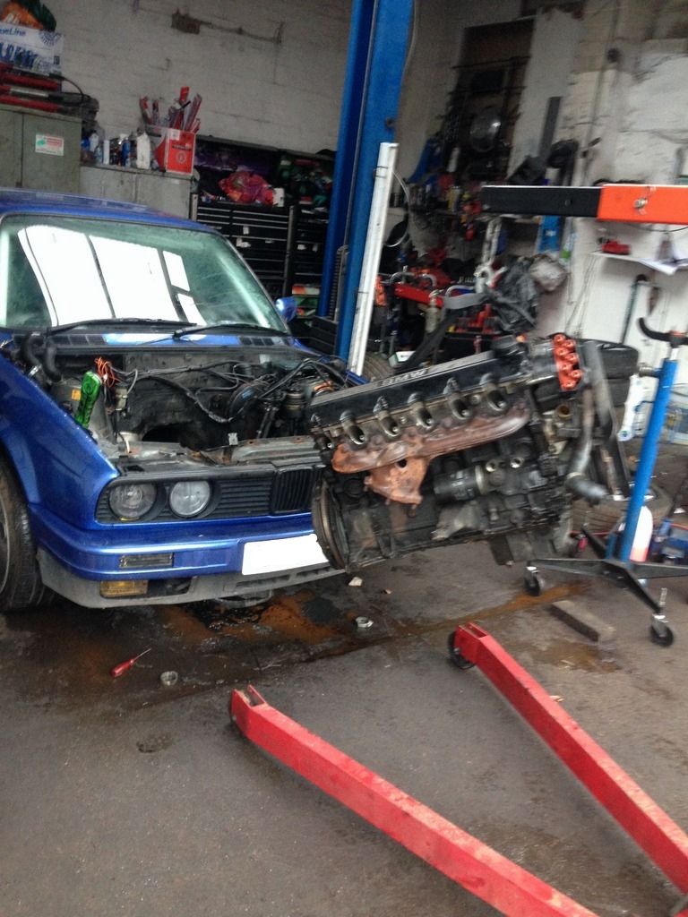

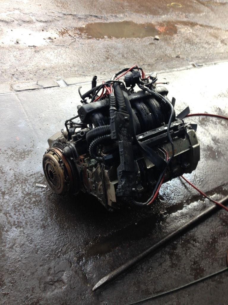

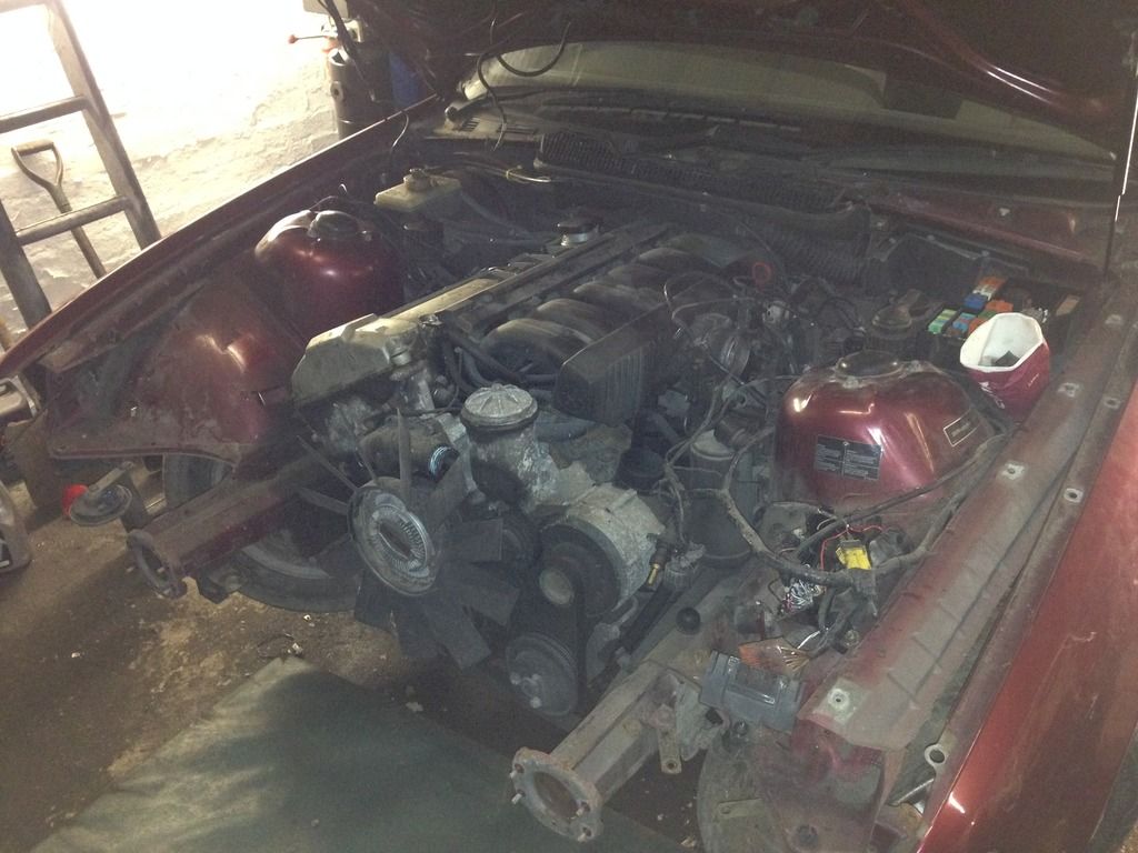

So i pulled the lump and started searching for a donor, i wasn't too upset because it was the perfect excuse for an m50 swap.
Donor found!

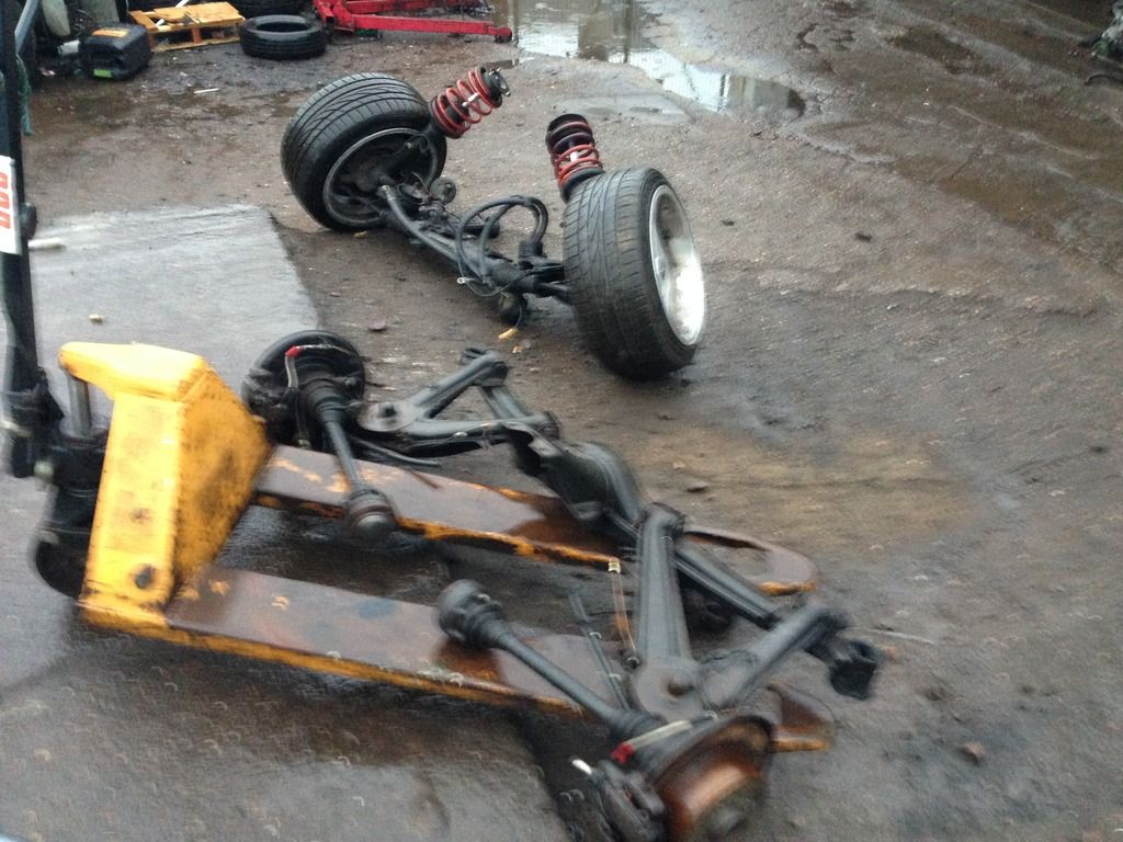

Time to start tearing it to bits, sorry E36 fans :o
So after swearing and snaping lots of rusty bolts:
Thew this bit in the bin lol. What a shed, anyway the engine ran nice so...

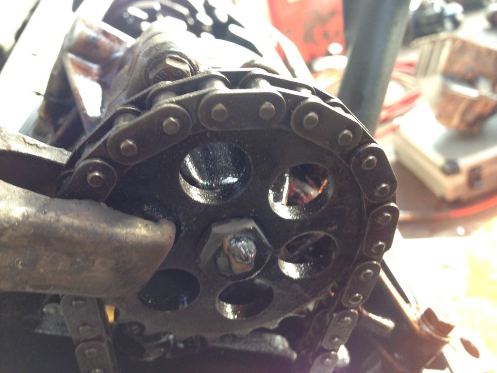

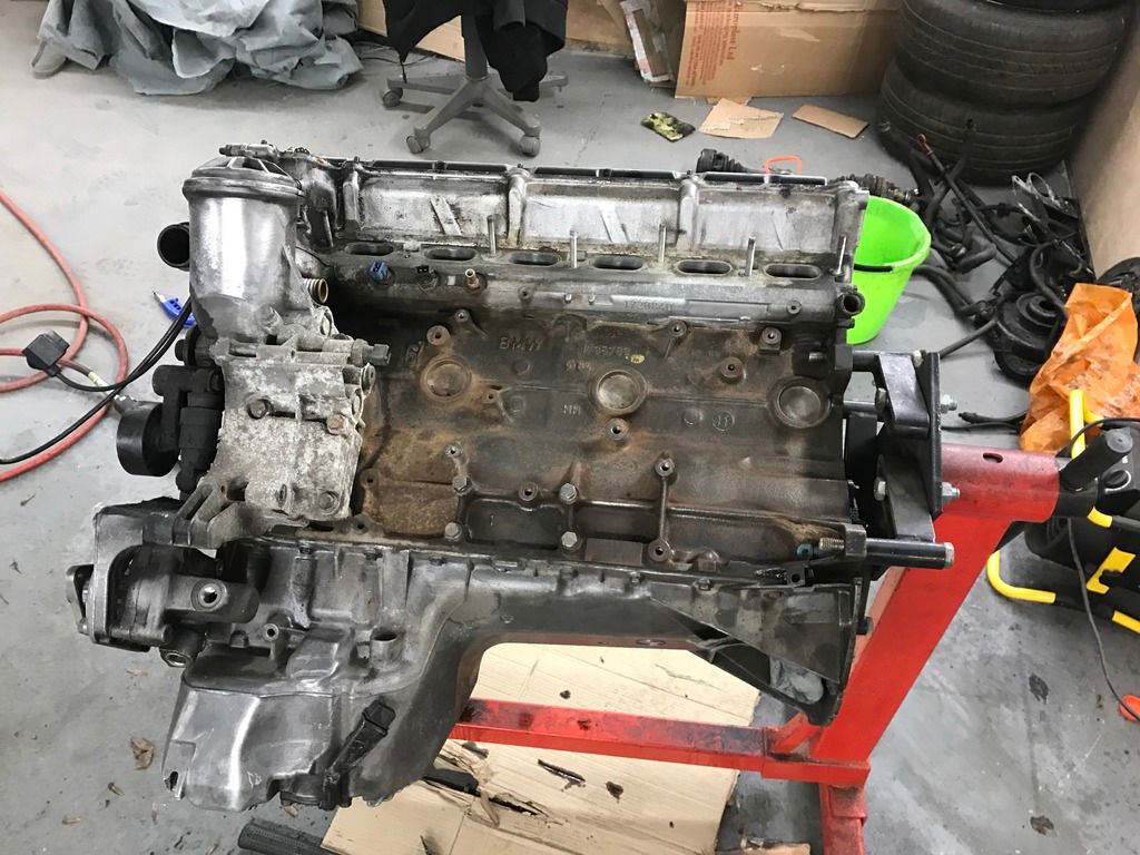

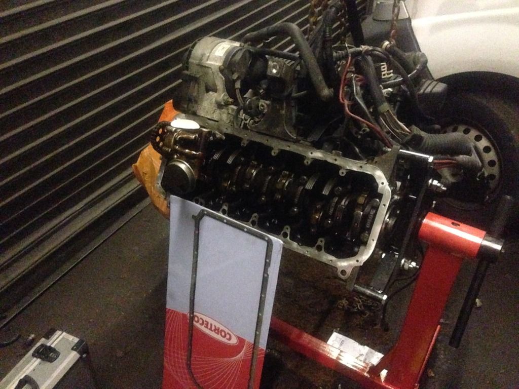

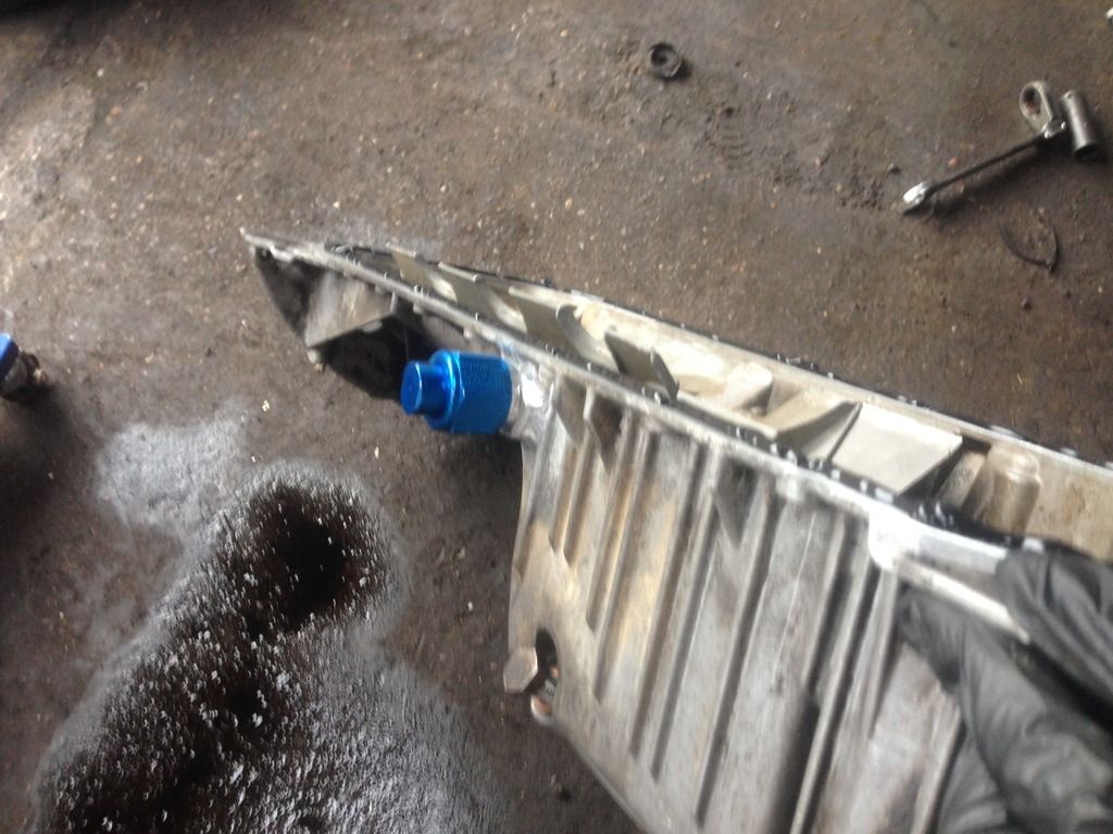

Bought an engine stand and removed the sump to swap the oil pump and pickup.
This because i've read all the horror stories
525i sump that i had modified for future snail draining needs.

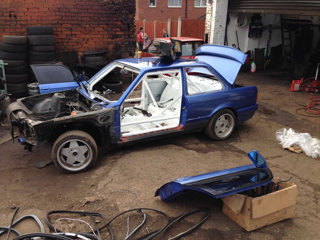

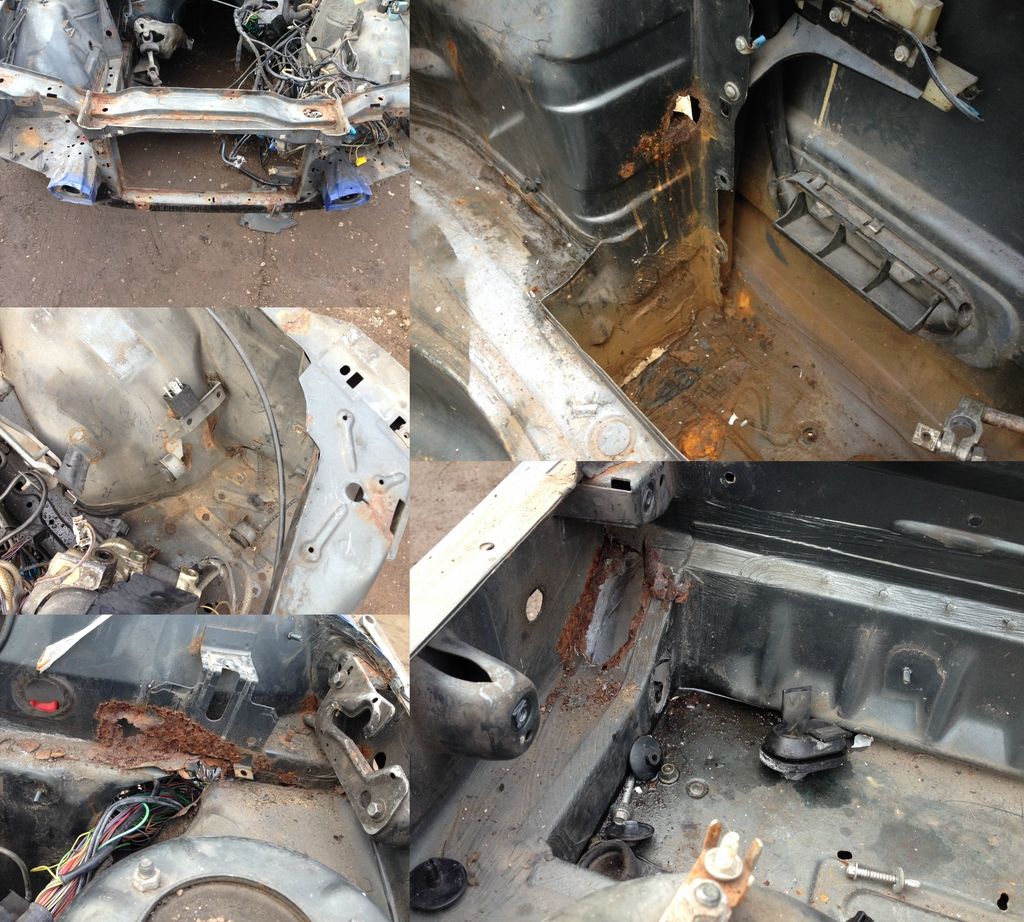

Then I started to look at my E30 and realised how unhappy I was with the condition of the body shell. It looked nice in pictures but was by no means up to the standard I wanted and as we all know e30’s are prone to a bit of rot.
So i decided to pull the trigger and acid dip the shell!

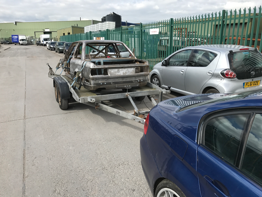

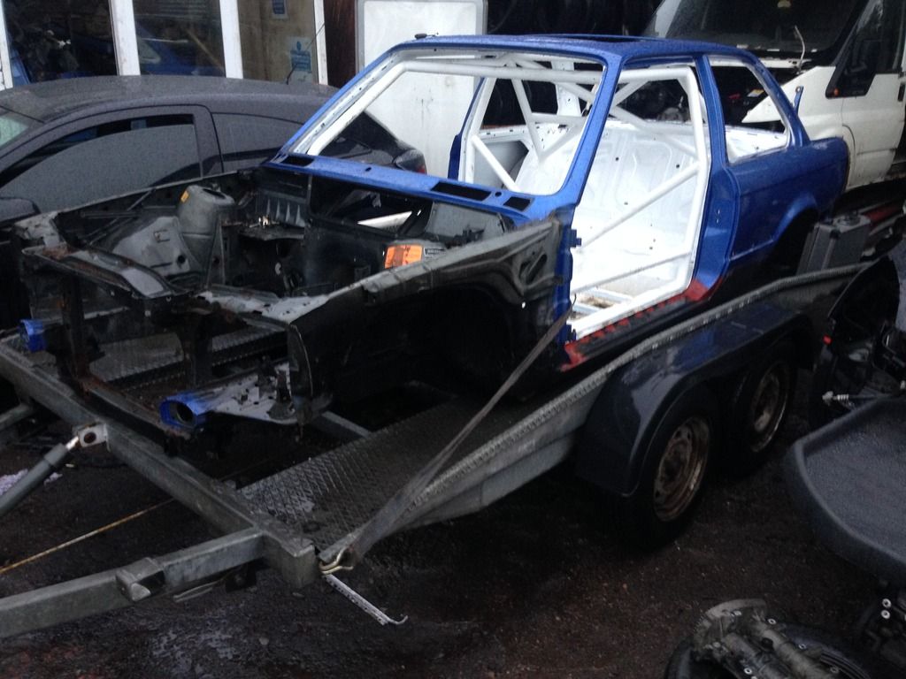

Dropping the shell off to get dipped
Oh yea, and then i kinda got delayed by this little project cause using my friends unit was becoming impractical.

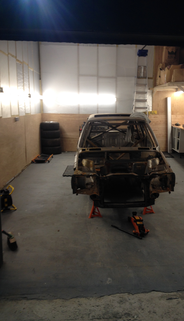

So yea, got there in the end

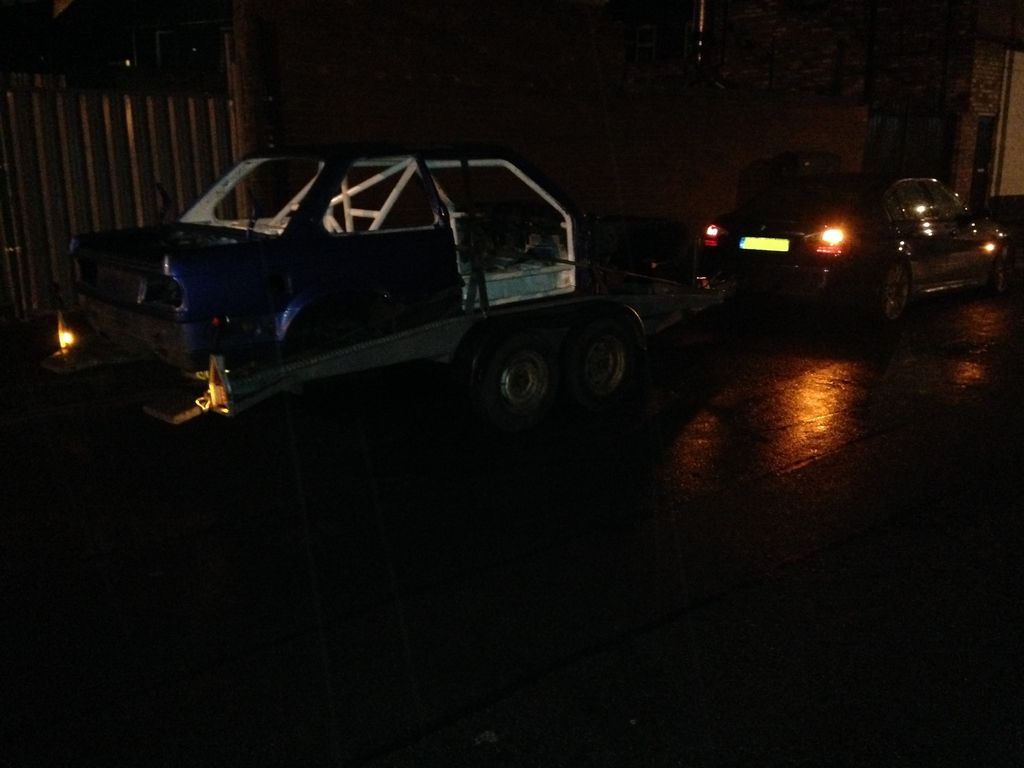

Only problem is the shell got rained on, badly... so it has surface rust everywhere :cry:
Anyway crying over spilt milk just leaves you with.... erm... dead cats or something like that.
So, life goes on. Once all the repairs to the shell have been completed it will be getting dipped again and then painted.

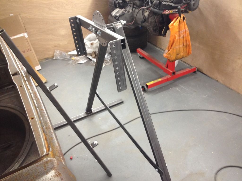

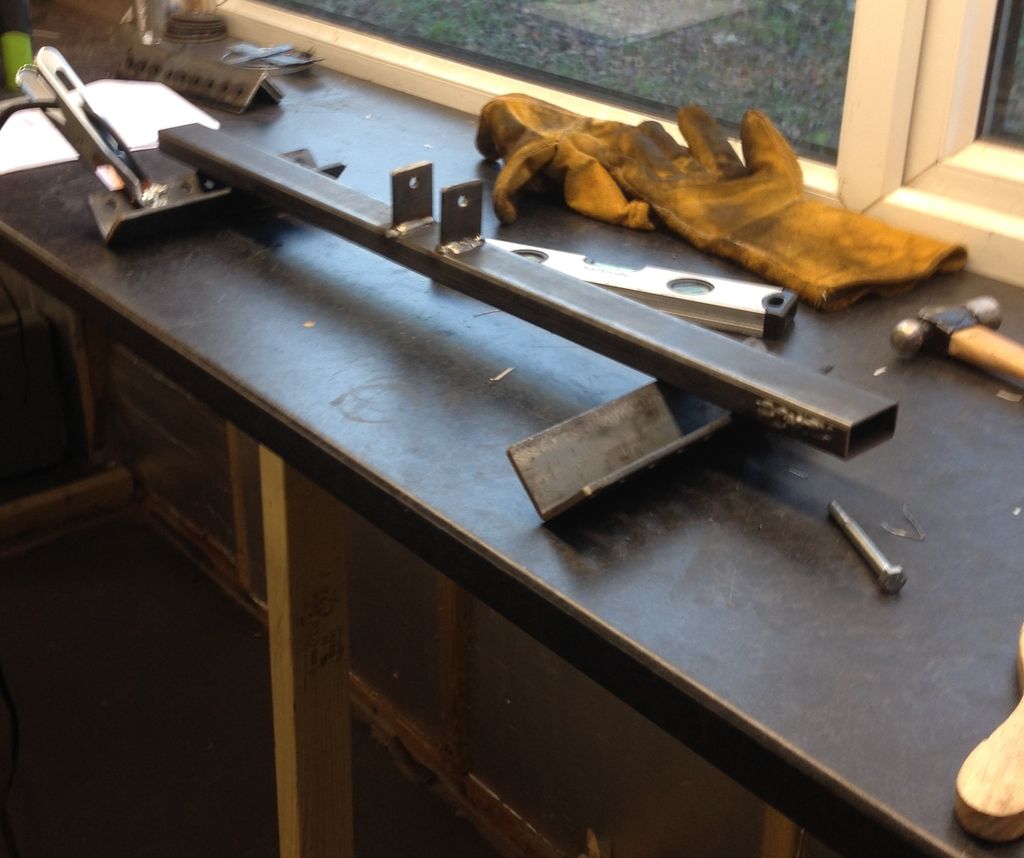

Anyways! I missed going sideways so much i put this kit together:
See what i did there

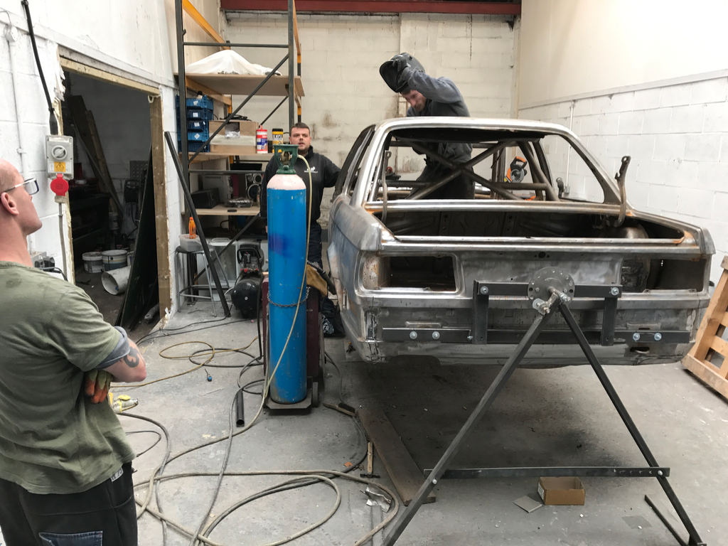

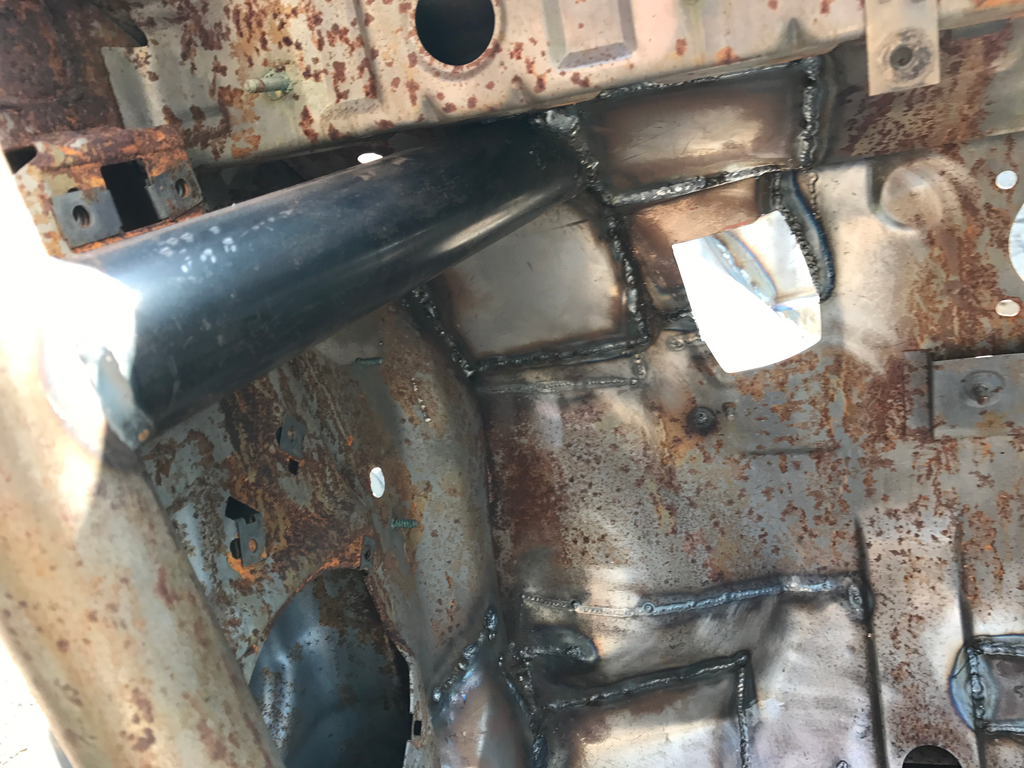

And here we are at present day. I've found some mobile welders who are coming out this week to start repairing all the holes, fully seam weld, extend the cage to the front shock towers and reinforce the cage mounting points etc![/b]

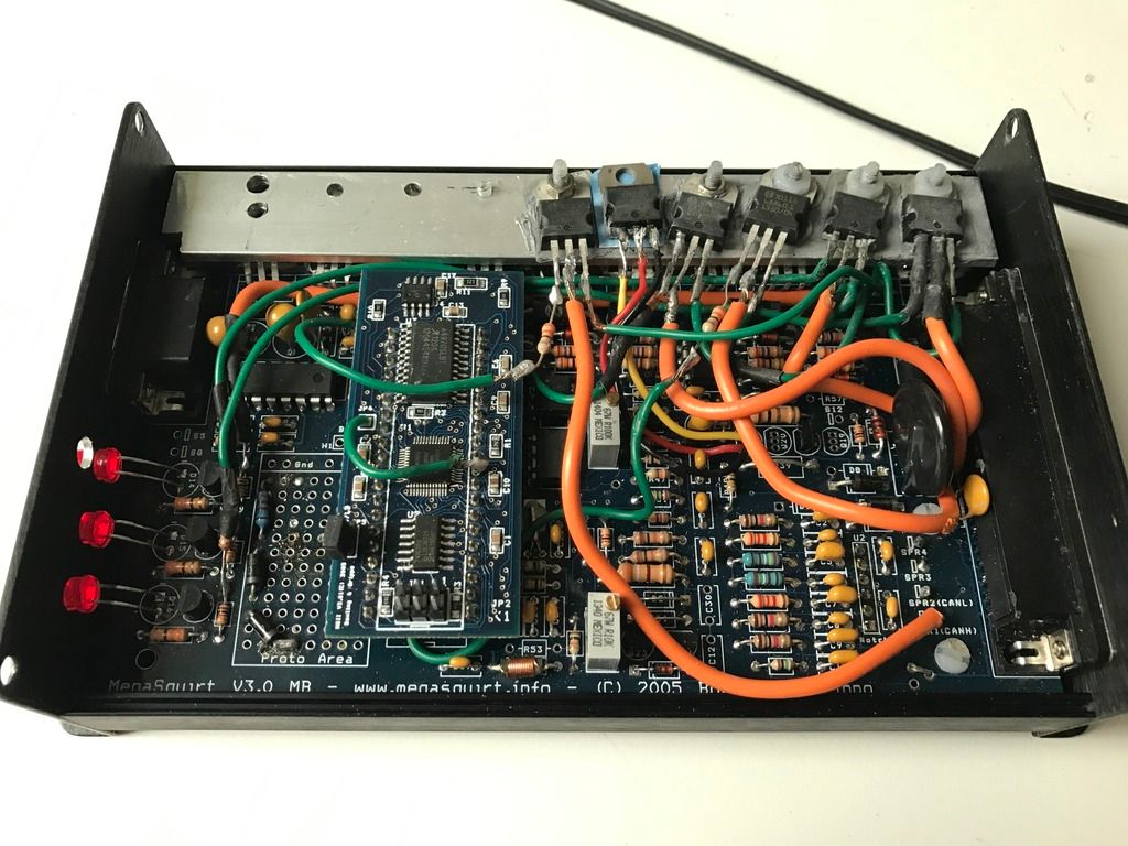

Upgraded the Squirt with 3 more coil drivers for 6Cyl sequential Coil on Plug, excuse the pikey soldering :roll:

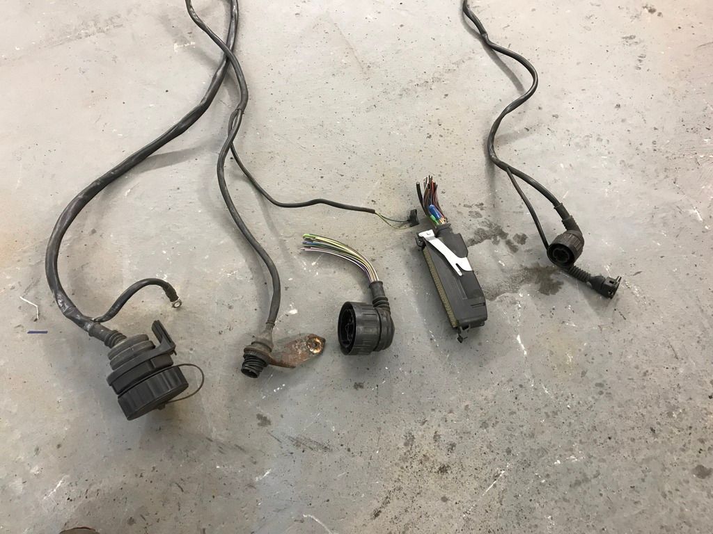

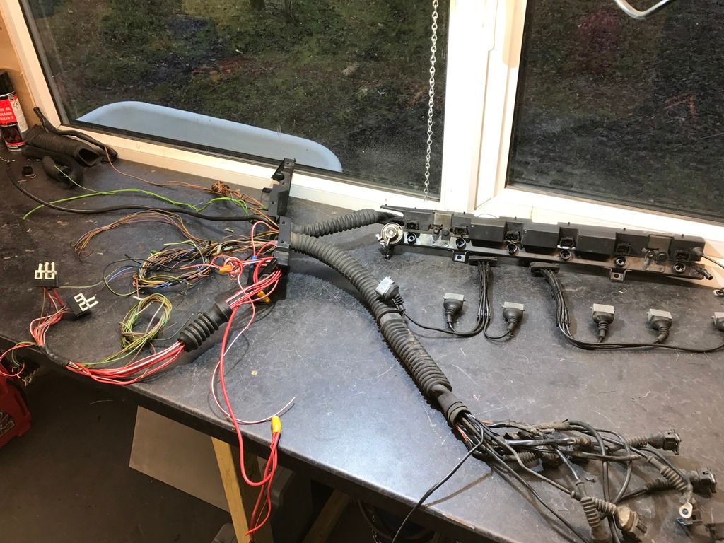

Ok So the shell has been collected and is off to get welded! In the meantime i've been striping down my m50 lump to clean off all the caked on oil and grime. I intend to give it all a lick of paint too at some point. Injectors are out, baged and soon off to injectortune for a bath.

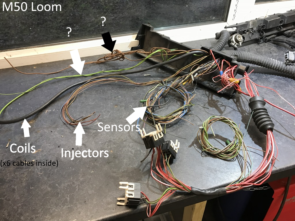

Then i started chopping out unnecessary stuff to create a hybrid megasquirt loom:
So i ended up with this. I wanted to keep the factory injector, spark and sensor plugs:
Thought I'd make this diagram just incase someone wants to do the same in future. Can anyone point out what the mystery green and brown wires are for?

JakeusSnakeus wrote: Can anyone point out what the mystery green and brown wires are for?
Plain brown, with no tracer, are normally earth wires. Plain green, also with no tracer, are normally ignition switched, unfused, 12 volts +.
For more info, I'll need to know where they end up.

Brianmoooore wrote: Plain brown, with no tracer, are normally earth wires. Plain green, also with no tracer, are normally ignition switched, unfused, 12 volts +.
Yea they're all plain with no tracer.
They all head towards the little track of wires above the fuel rail leading to injectors and coil connectors etc... I'l take a picture tomorrow if you think it will help

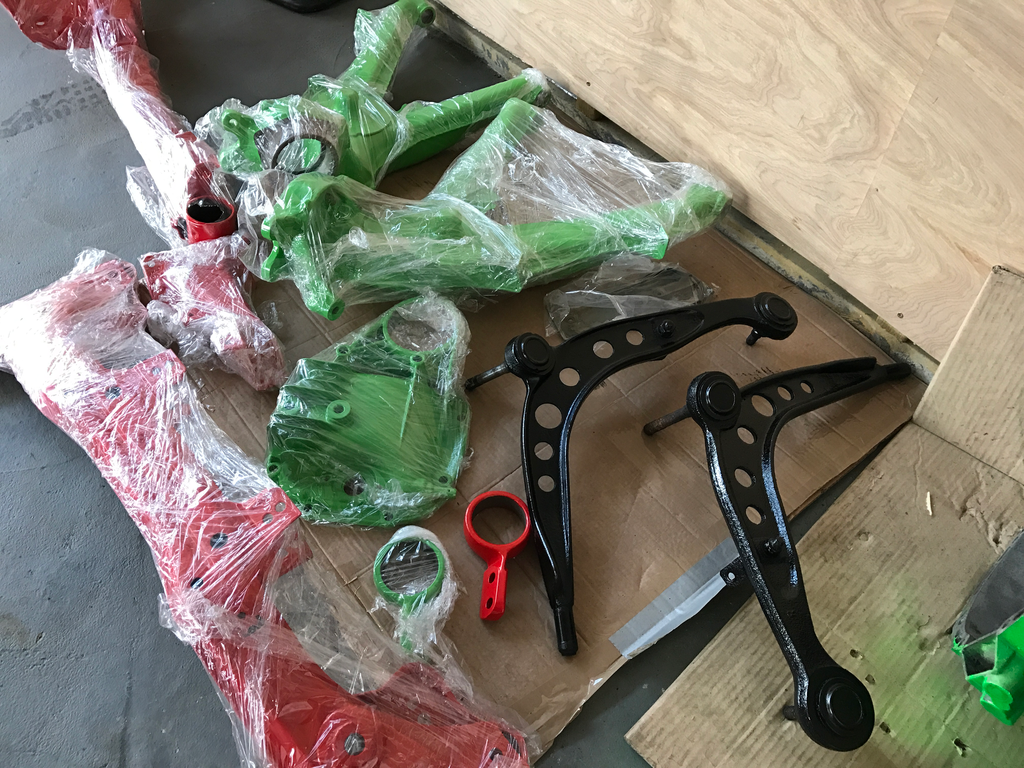

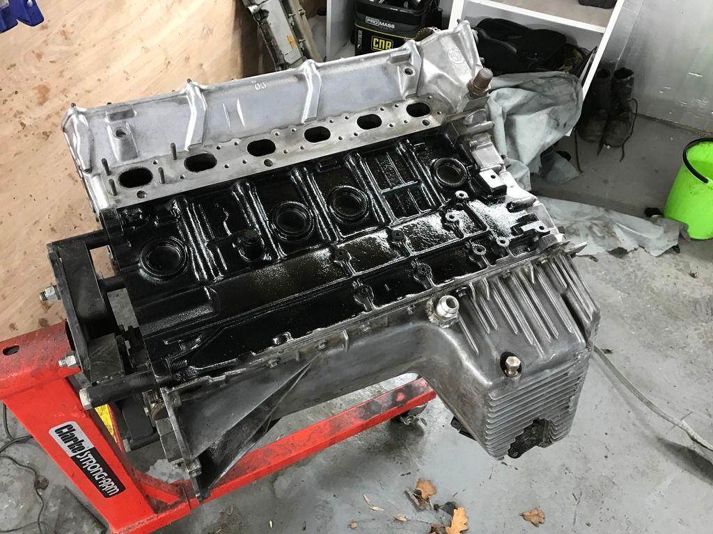

Murdered 60 odd quid today in halfrauds buying spraypaint, degreaser and a few wire brushes etc ect so i could start cleaning up this lump. I forgot to take a before pic but it was absolutely caked in grease at least a few cm thick... I have to say this stuff works great, not sure if i'm preaching to the quior here but the grease just melted away with only a paint brush

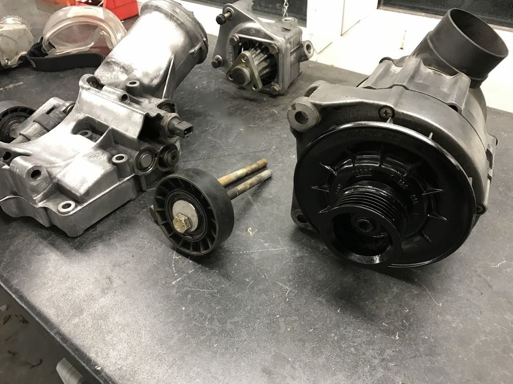

So yea here's the block after some degreasing and a going over with a wire brush in the grinder
Paint
More bits removed degreased and wire brushed, lick of black paint to hide the rust
Stay tuned folks!
If they're heading for the coils, then the greens are the 12 volts supply to the coil primaries, straight from the ignition switch, and the browns are the earth returns for the coil secondaries, which should ultimately connect to the earth terminal on the top of the RH suspension strut.
Thanks this will help once i start making the loom up.

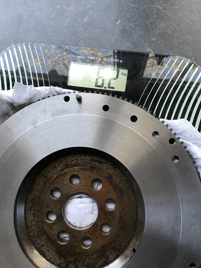

Had the flywheel Shaved:

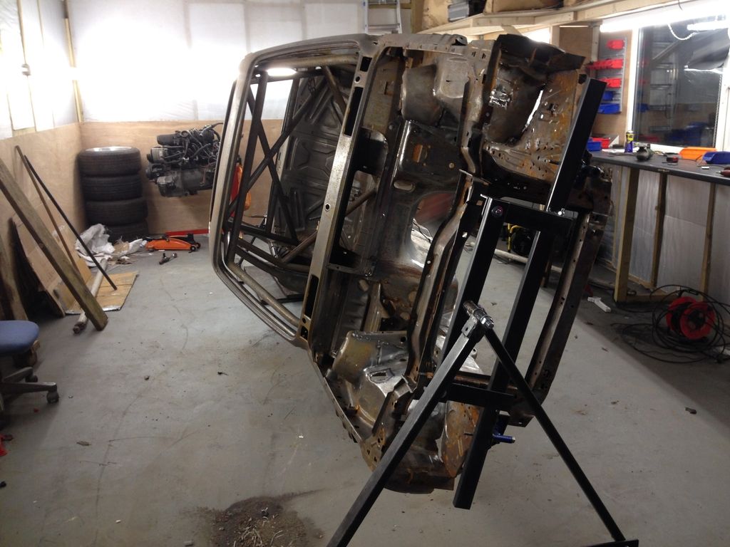

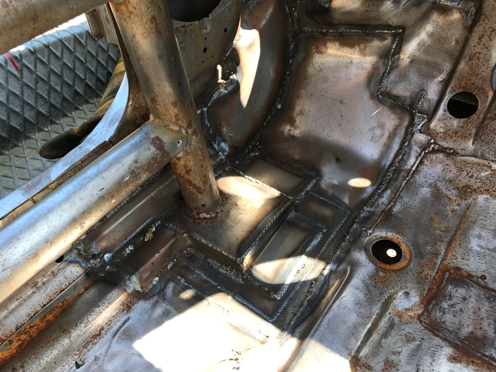

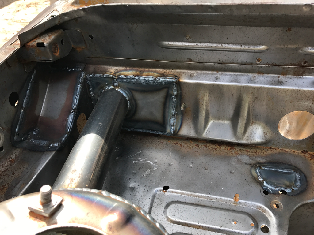

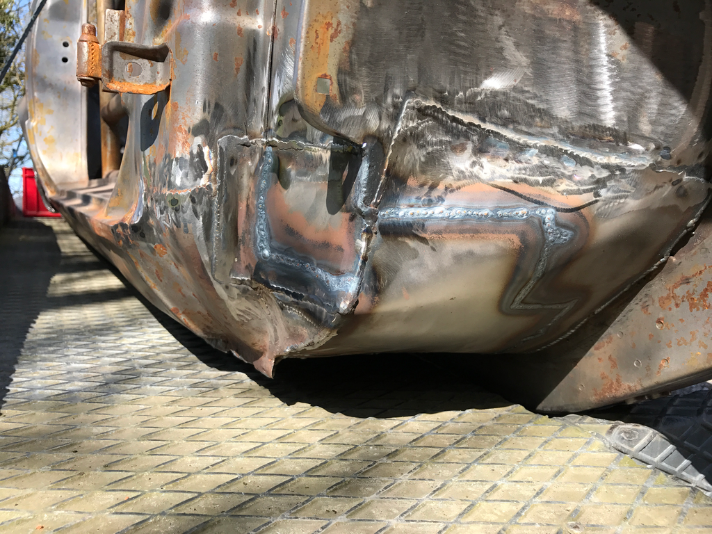

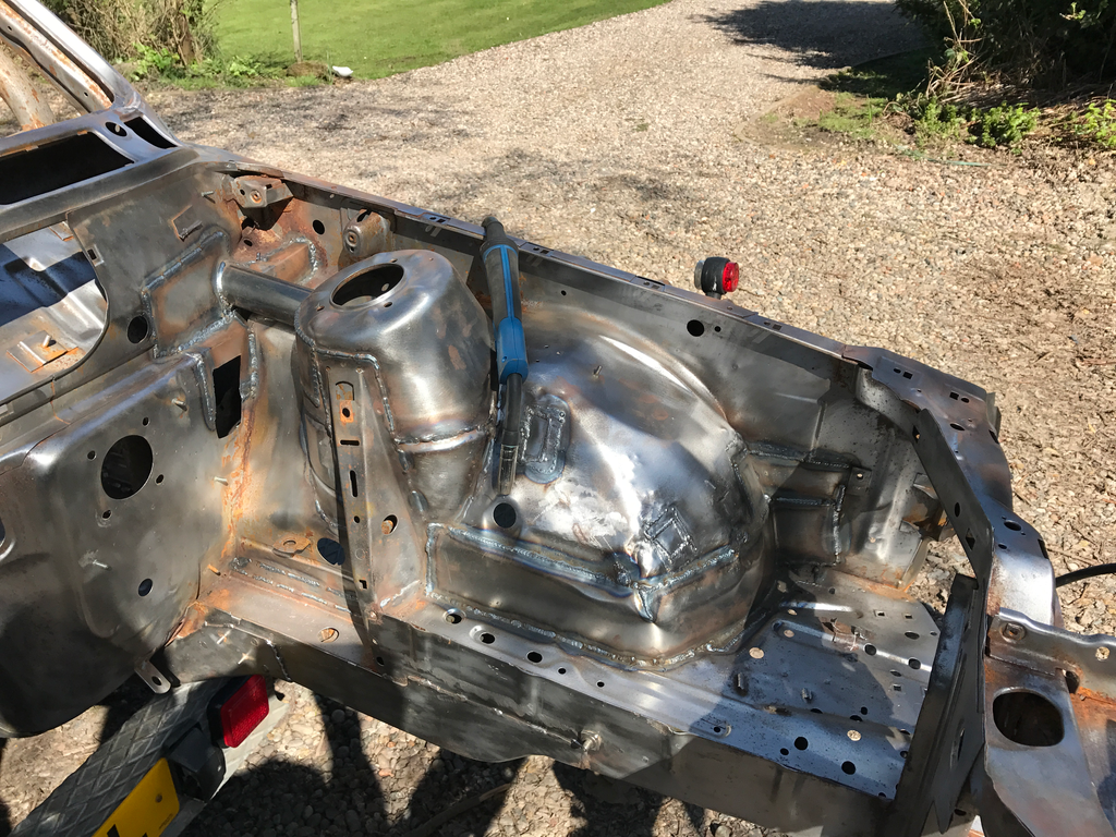

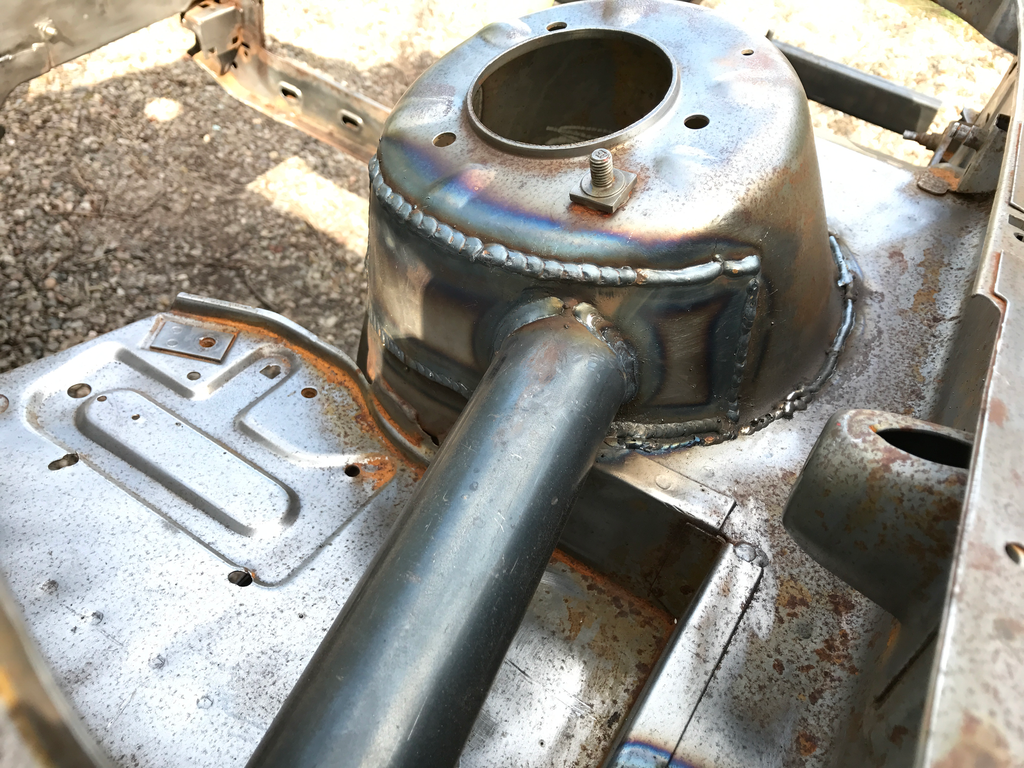

Got the shell back from the welders:
Cage extended to front shock towers:
Floor plates strengthened
Also nine trillion other holes fixed:
Shell being dropped back off for a quick re-dip and Epoxy coating
So..... more waiting :(

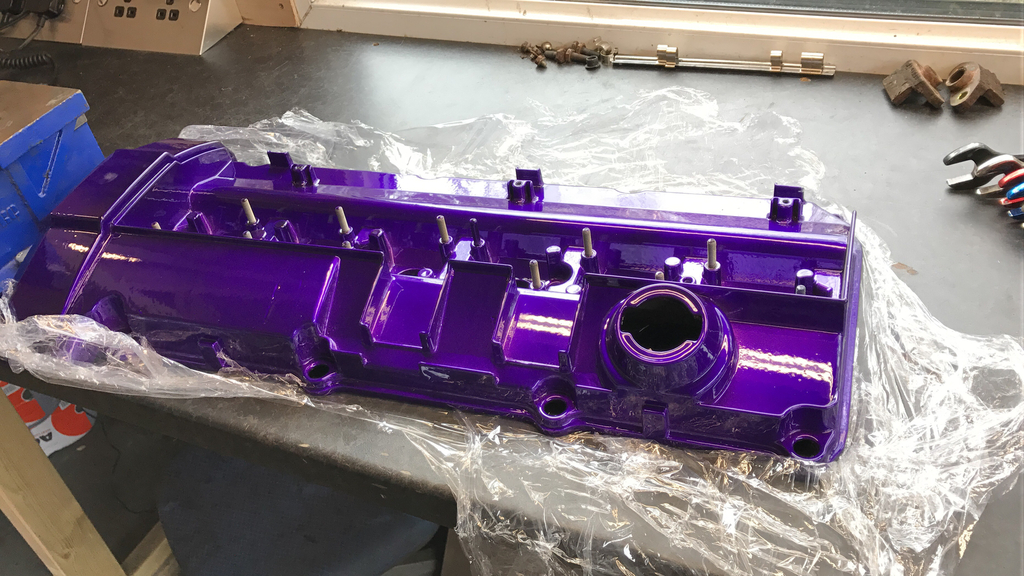

Colourful parts!!
