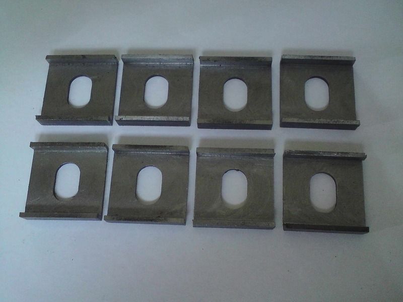

Cheers Mike, as said Pete I can supply either the brackets needed for this mod which you weld to the beam yourself, or I can supply a completed beam thats been sandblasted and powder coated ready to go
Send a pm for price & availability info

re:the slots..
If I get them, is it just a case of welding them onto original position..
Do the outer ones have the horizontal slots to reduce toe out and inner have the vertical slots to reduce camber?? Or other way around..
Anybody who has used these.. Can u finish with say 1 degree +ve camber and 1 deg toe in
Cheers pete

It depends how much you lower by for the camber, toe in is easily achievable though regardless of height.
I can't see how you would get + camber with a lowered car though, you would have to fit the plates above the hole, with maximum adjustment I can't get the wheels vertical on my track car, its at a decent height not massively low

Correct, camber is adjusted on the inside, toe on the outside
You can fit them higher on the inside to give you more + camber but I would offer the plate up to the beam with it still fitted to the car first, as a guess id say just half overlap the hole, don't take the plate above the hole completely
