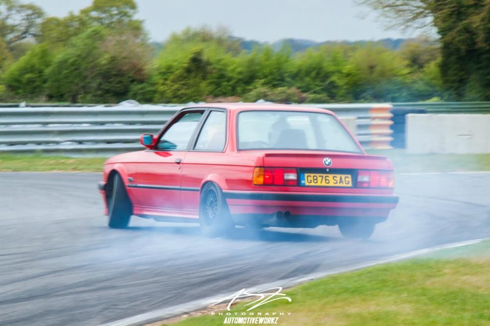

Short skid video. Didn't manage to get any decent onboard footage as unfortunately the GoPro ran out of battery quite early on.
Car probably isn't going to do any more drift days. Just did one day so I could get to grips with the car.

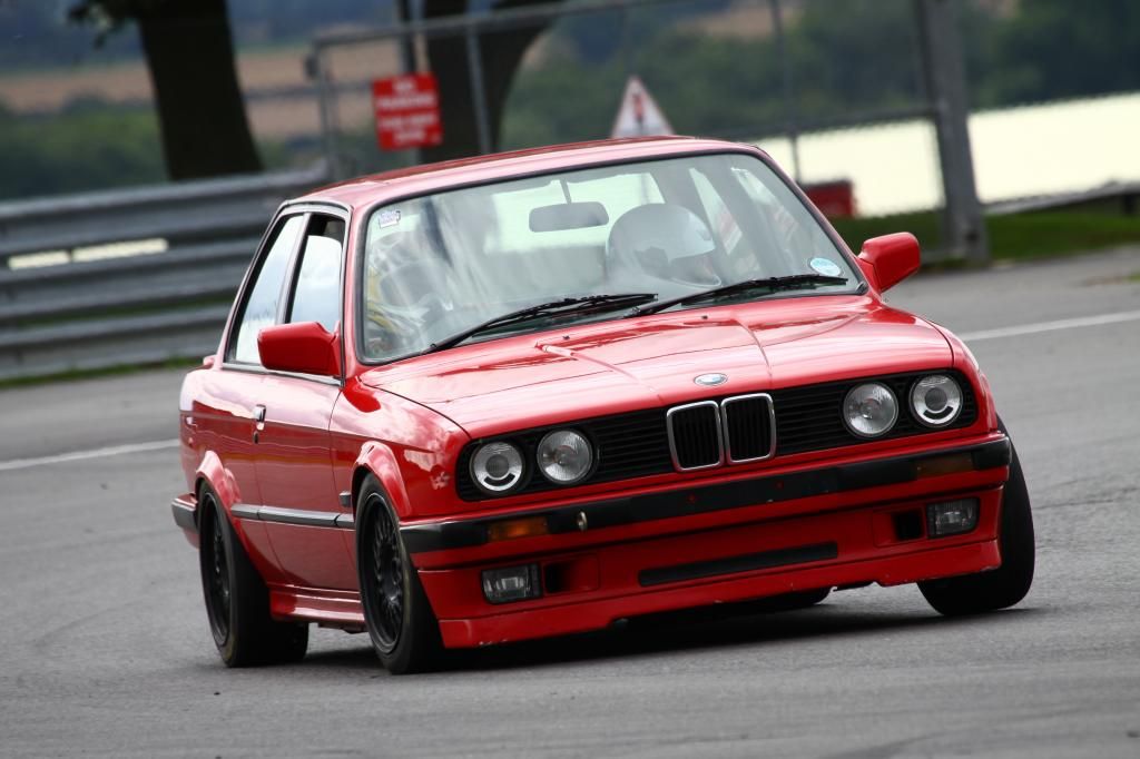

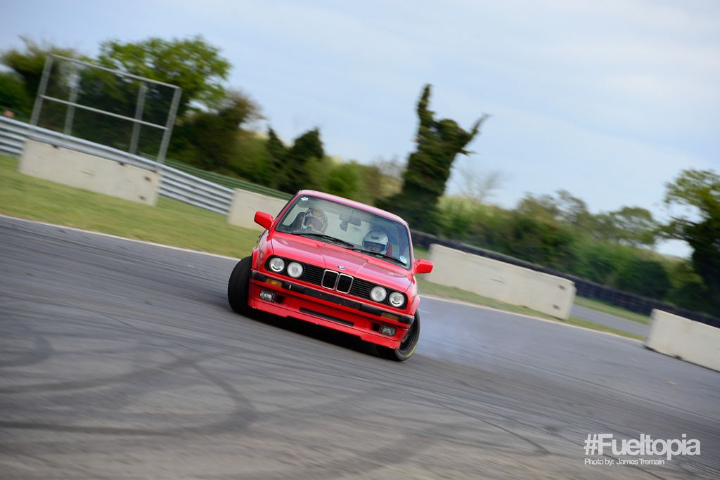

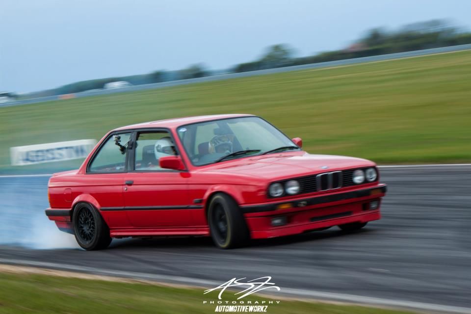

Well, did another drift day at Snetterton
made a couple of changes since last time. Metal thermostat housing, new metal waterpump and new 88C thermostat. Raised the seating position a bit and some changes to geometry.
Thinking of upping the springs rates, especially on the rear. ATM they're 8Kg front and 6Kg rear (with inboard spring so a lower effective rate).
Heres a video of the drifting. Think i need to upgrade the engine mounts as the gearstick seems to be moving around quite a bit. They are new e21 gearbox mounts and new e28 m5 cylindrical engine mounts.

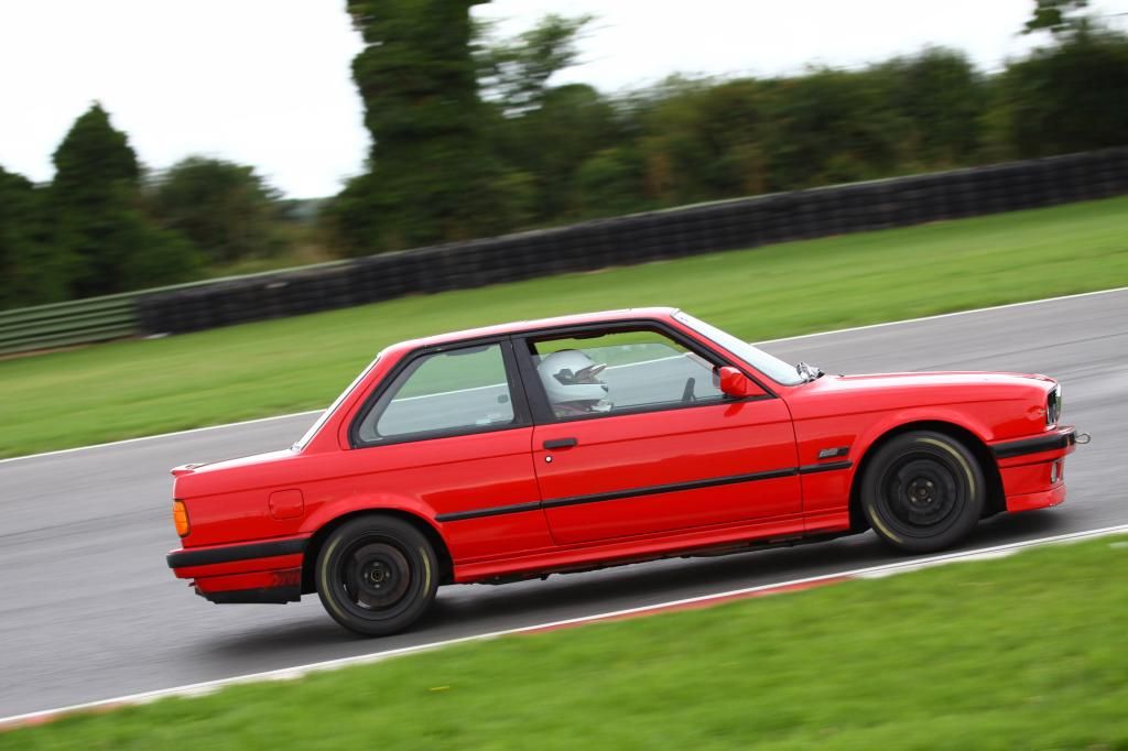

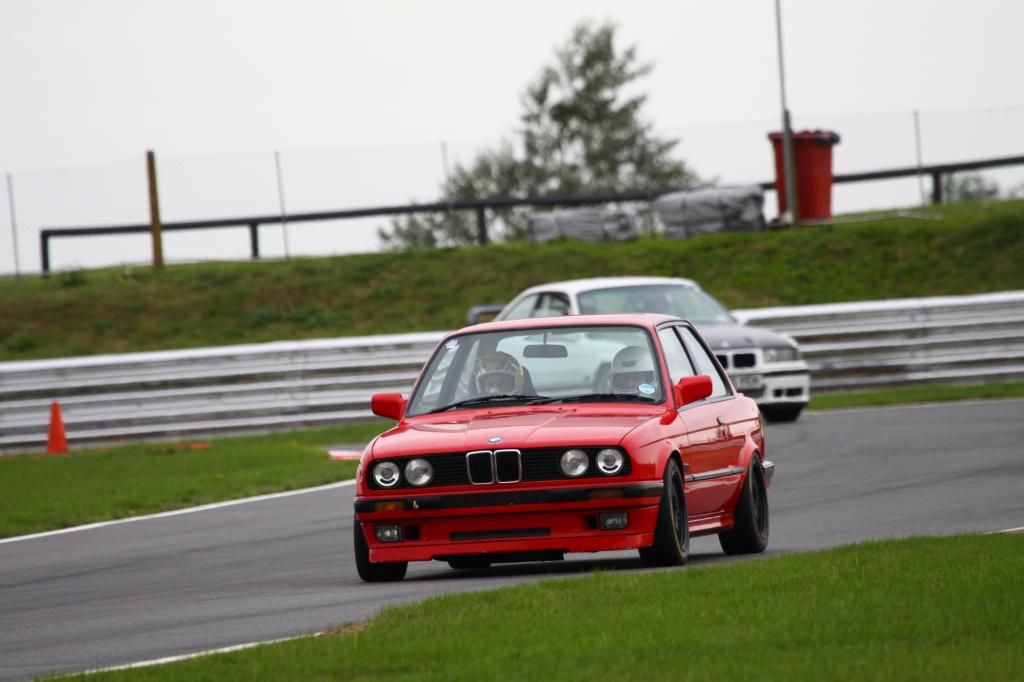

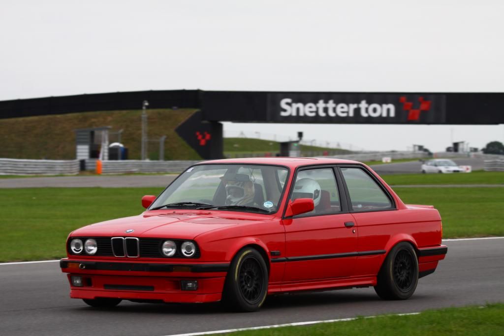

Did a grip track day at Snetterton last weekend. Was great, had lots of fun.
The pin that holds the shifter linkage on to the geearbox fell off in the morning. Very random. Got that fixed though and enjoyed the rest of the day. Otherwise, the car was faultless! Was really impressed with the power the M52 was pushing out. After 4K RPM it just wants to rev all the way! Would like to get some S52 cams in there to give it even more top end.
Got some more updates planned for the car;
Roll cage and full respray of interior
Three pedal bias pedal box
Harder spring rates
Anti roll bars
Possibly some aero
Then eventually some fender flares and run 17s with a proper tyre size rather than 195s.

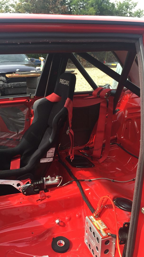

The car has come along a lot over the past month.
It was last used at the northloop Rockingham day which was early 2015. Unfortunately one of the valve caps snapped and it bent a valve. The car sat outside for a year and a half looking pretty sorry for itself.
Made a short list of what had to be done to get the car roadworthy again;
Sourced a nice, low mileage steel liner replacement engine for only £150 which was popped in one weekend.

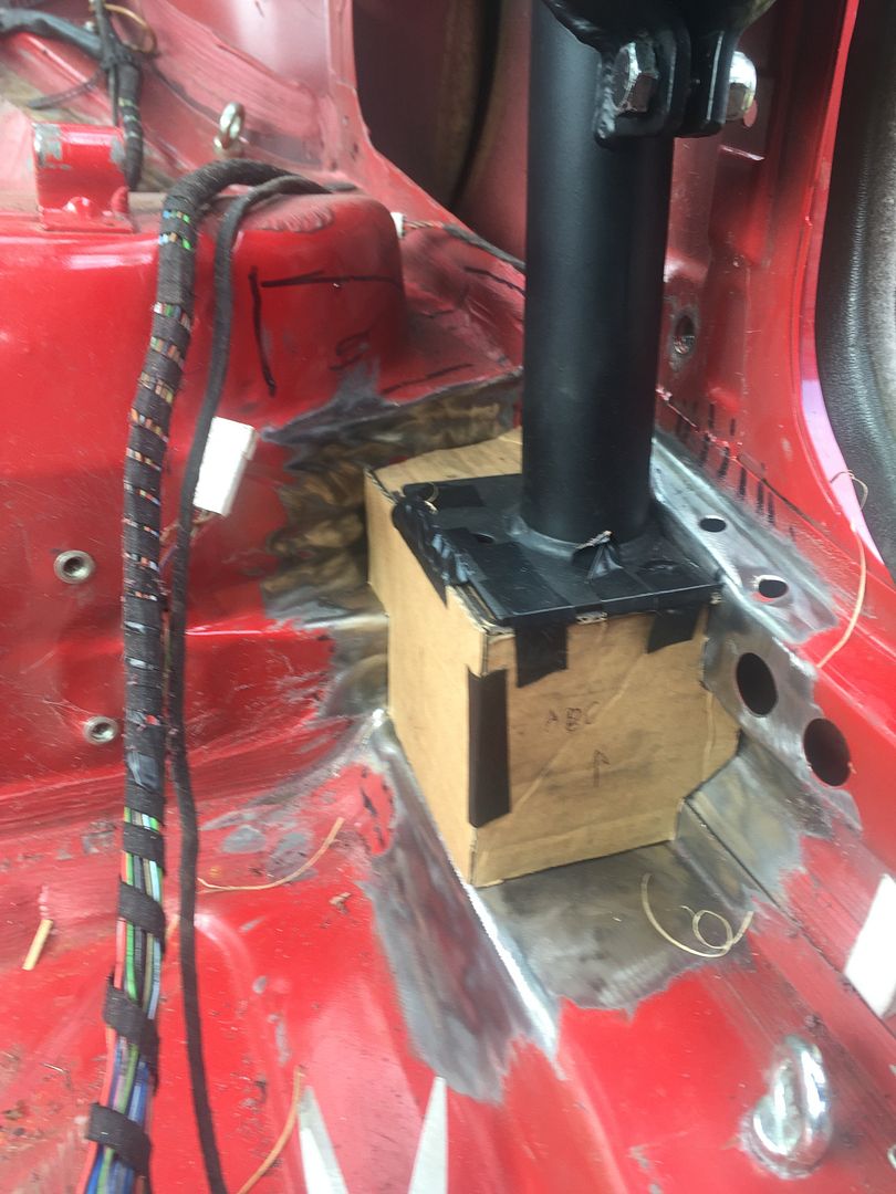

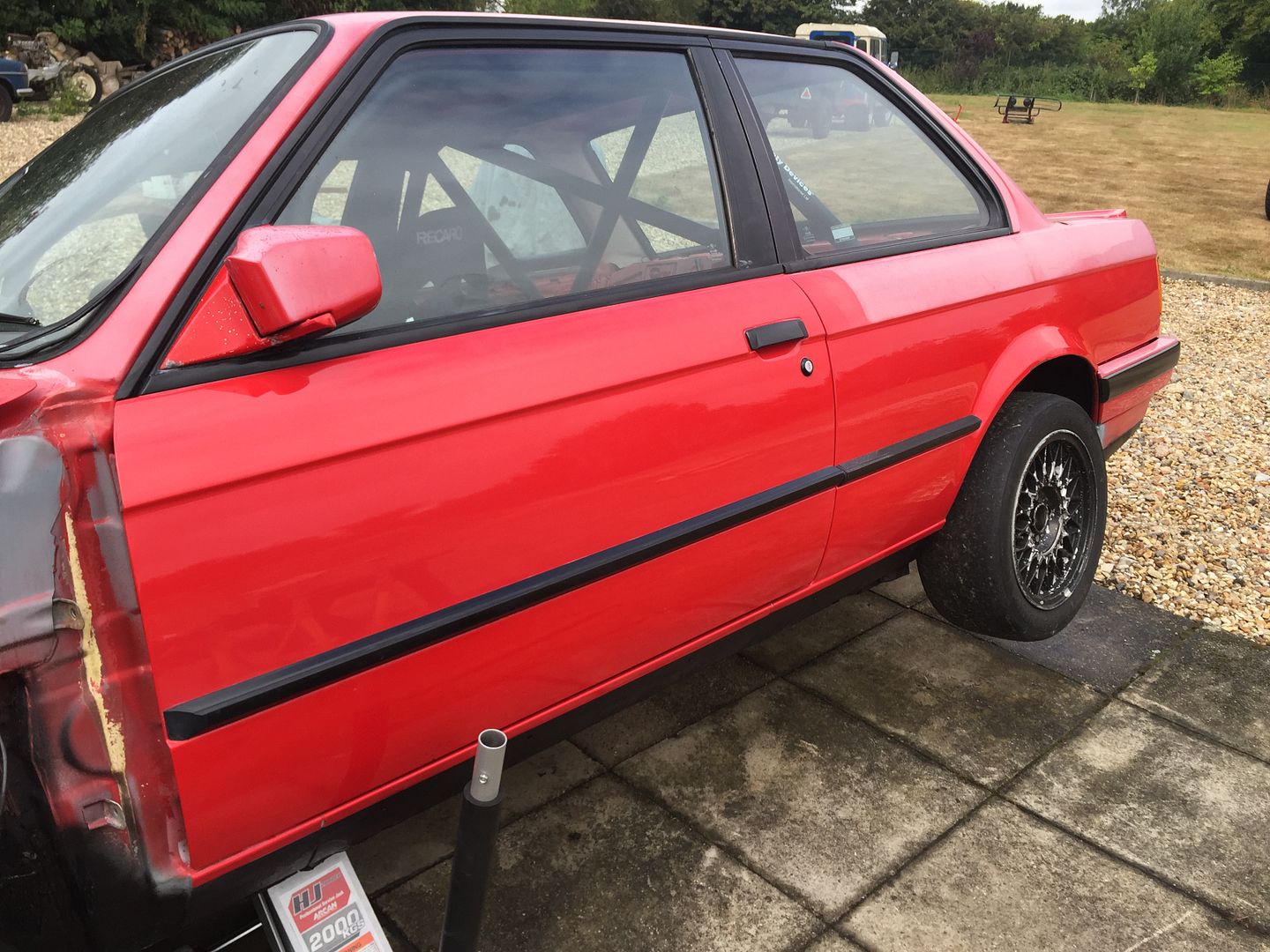

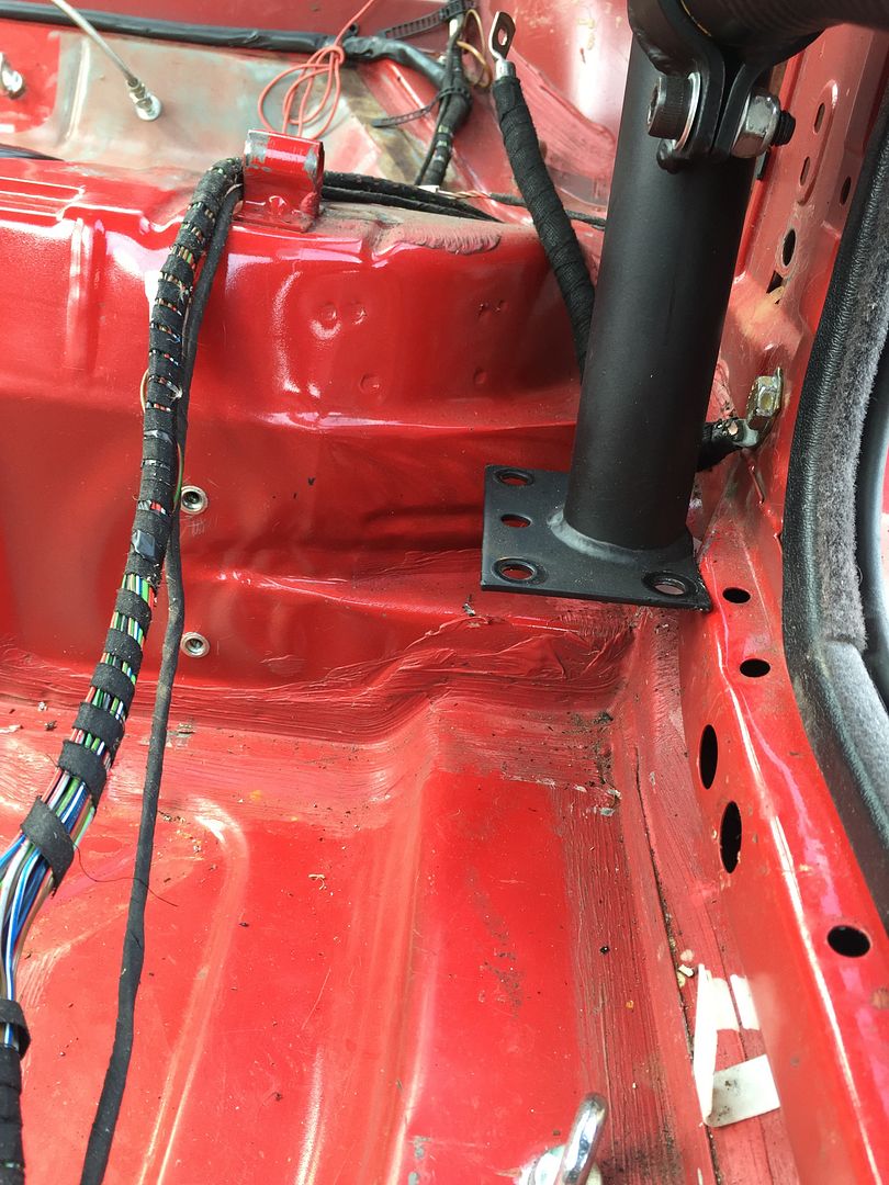

Bought a safety devices roll cage.
Restored the braking setup back to a servo and master cylinder using brand new ATE e32 750i master cylinder, clio servo and a wilwood proportioning valve.
Replace mechanic handbrake setup.

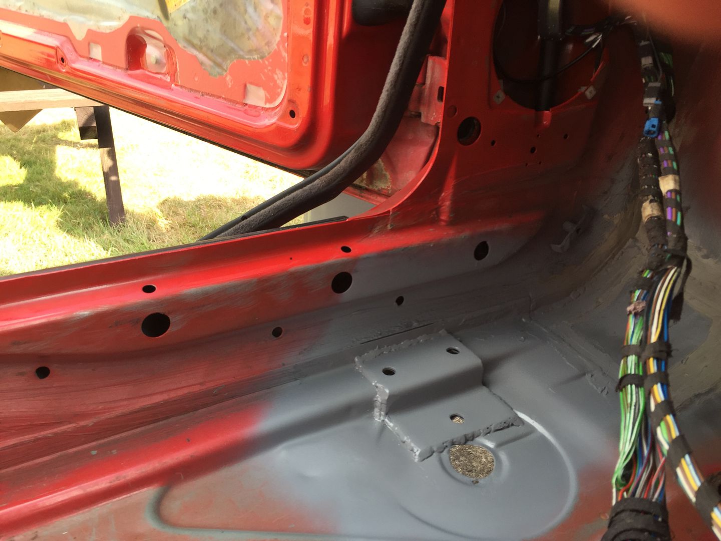

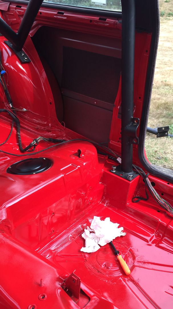

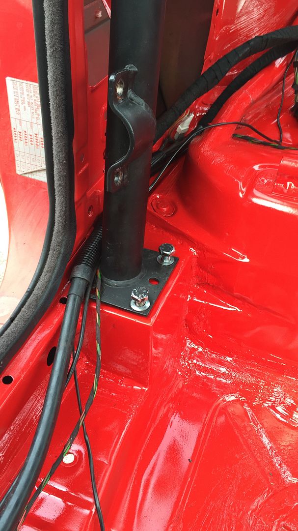

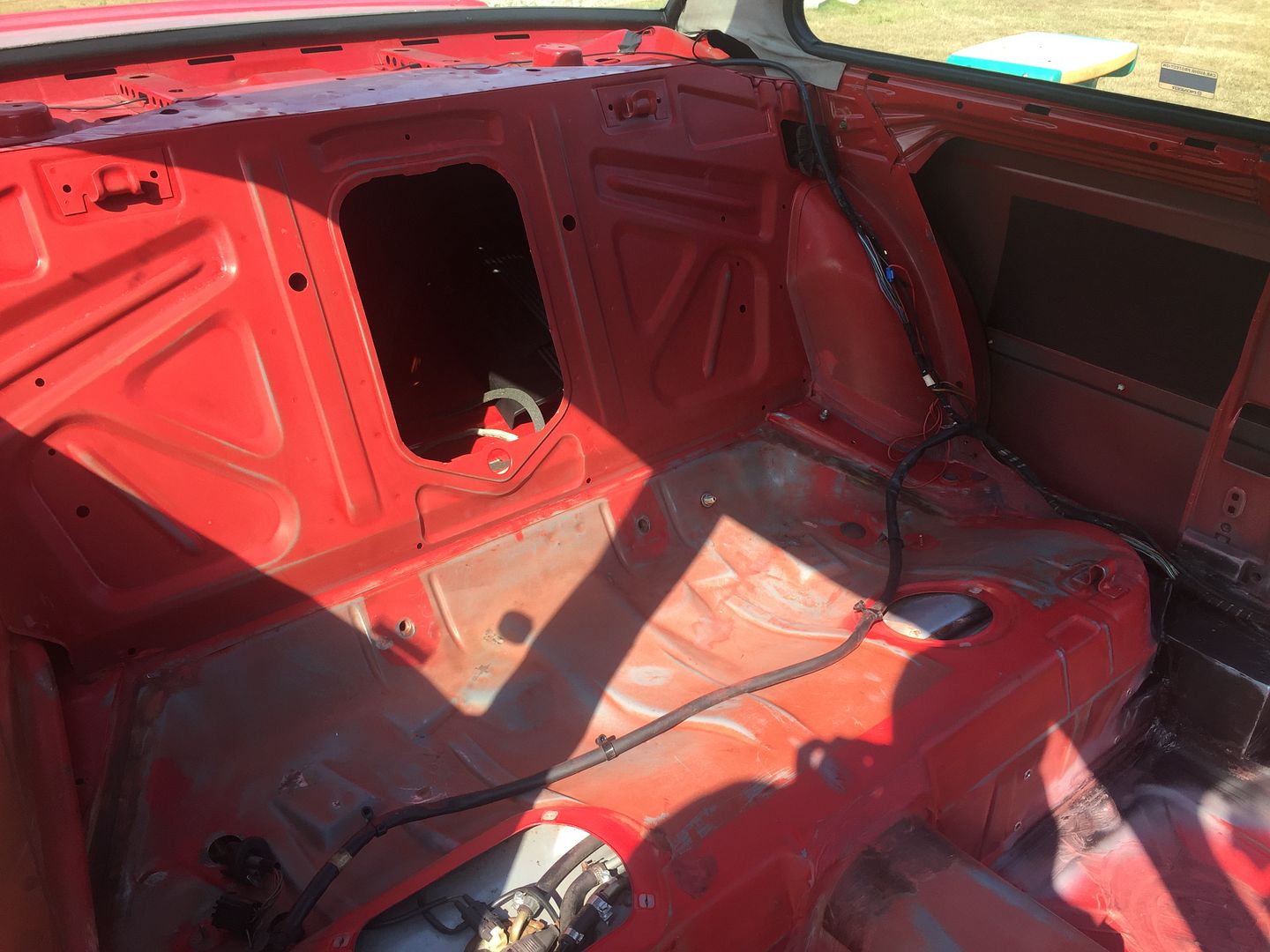

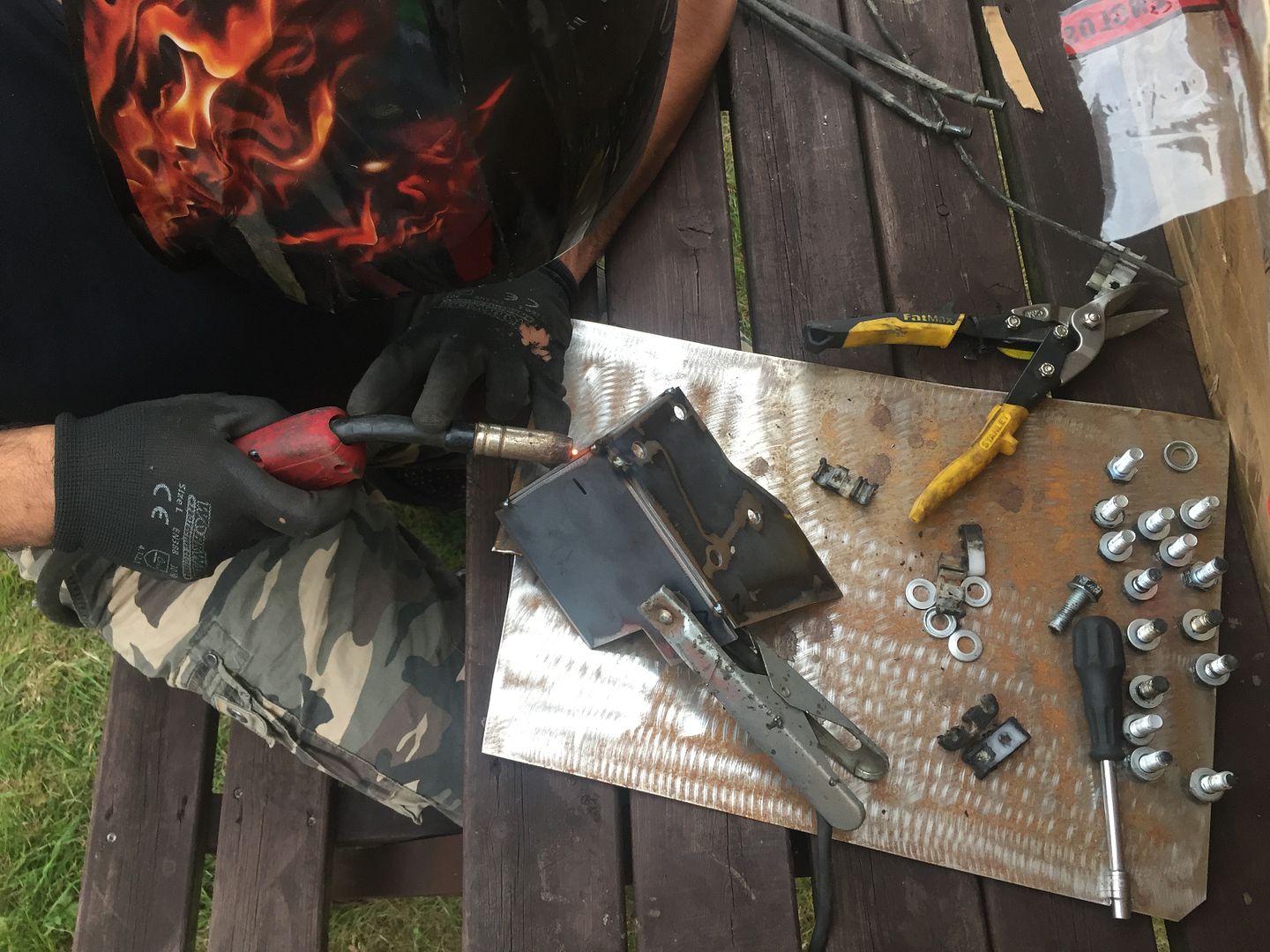

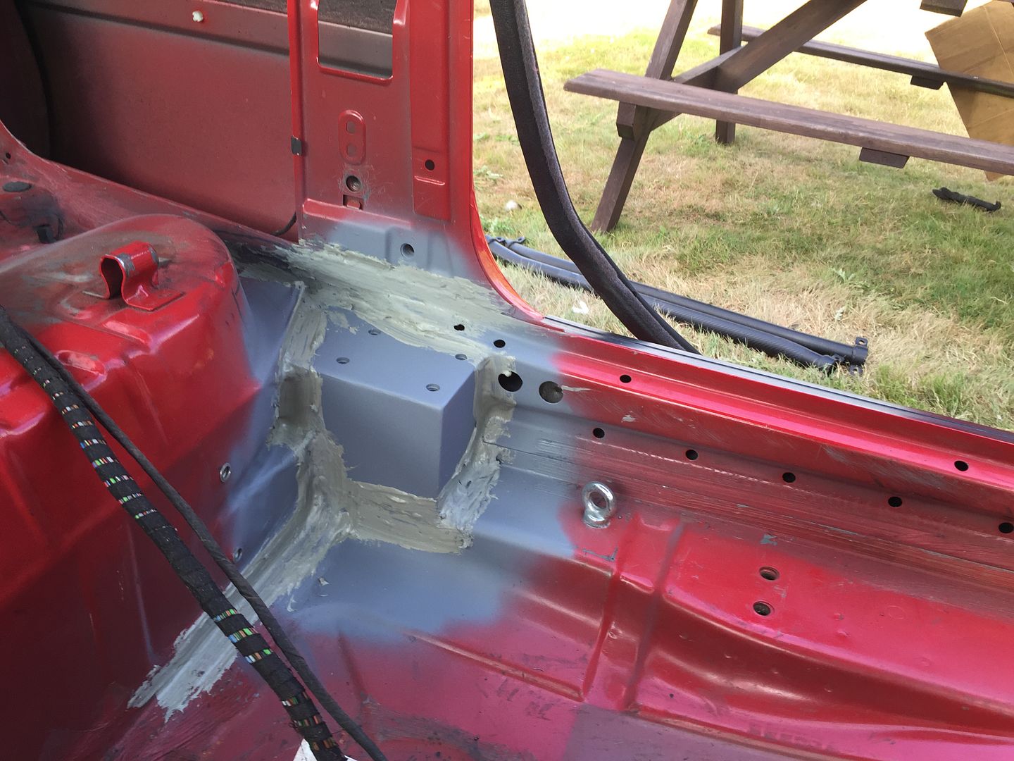

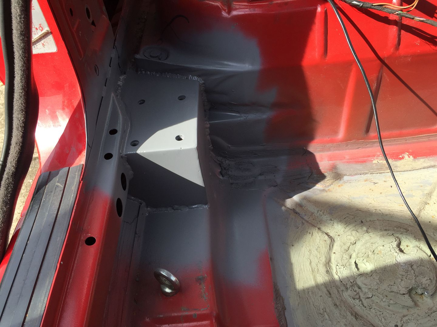

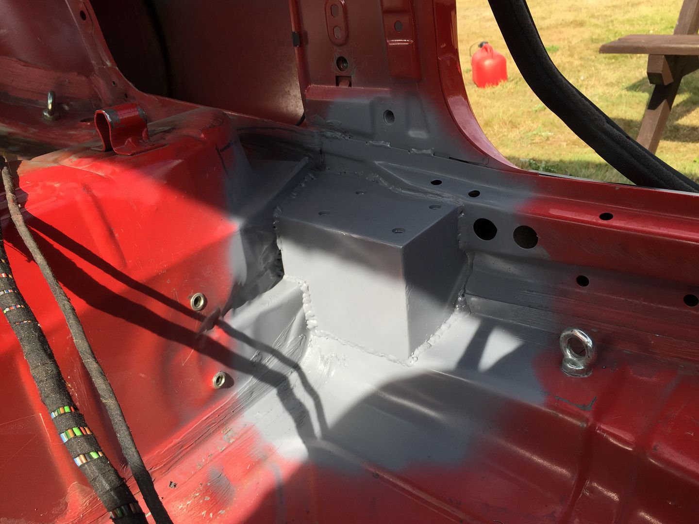

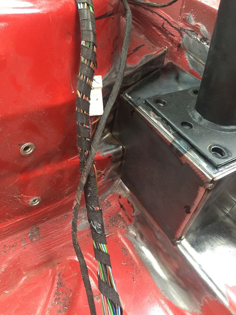

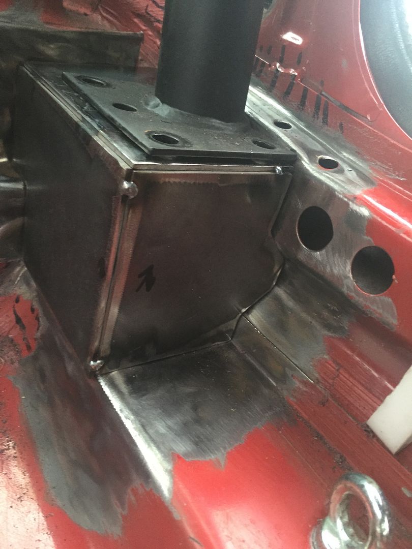

So to start with, Karan came round and did all the rust removal and welding up of the jacking pads.
Later in the week we made the boxes for the roll cage to sit on and those were welded in also.

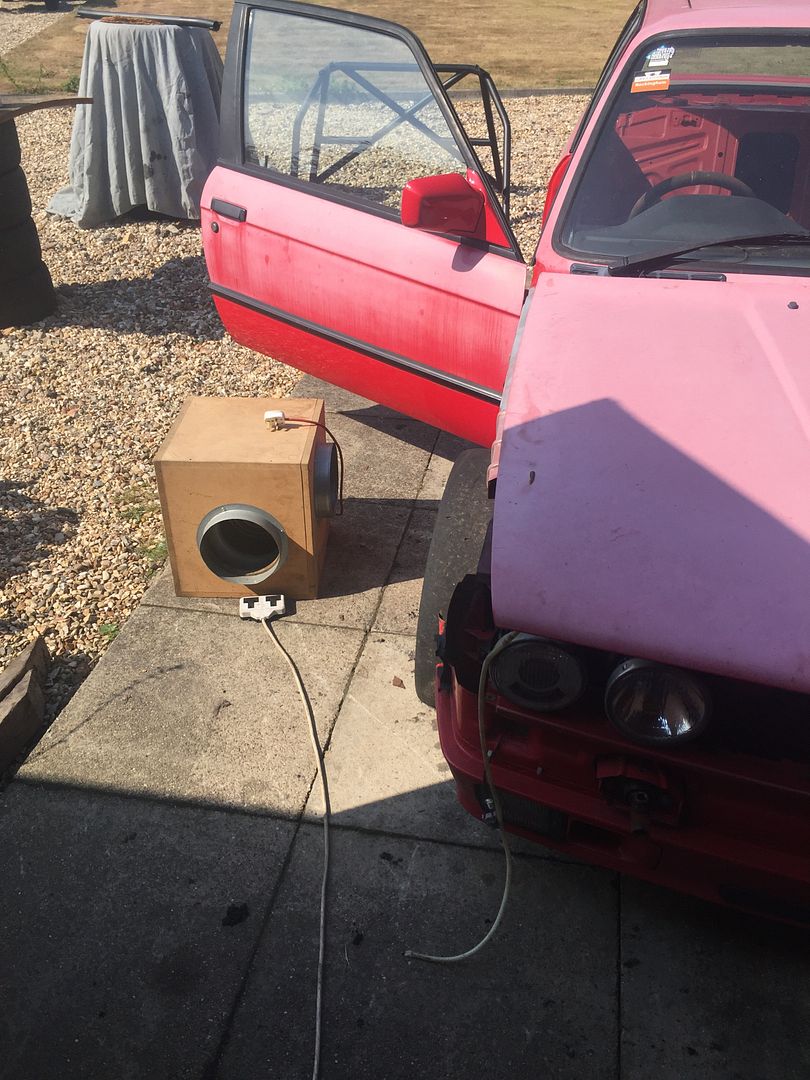

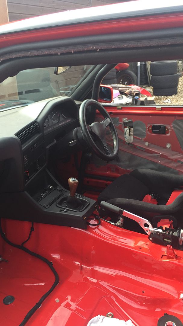

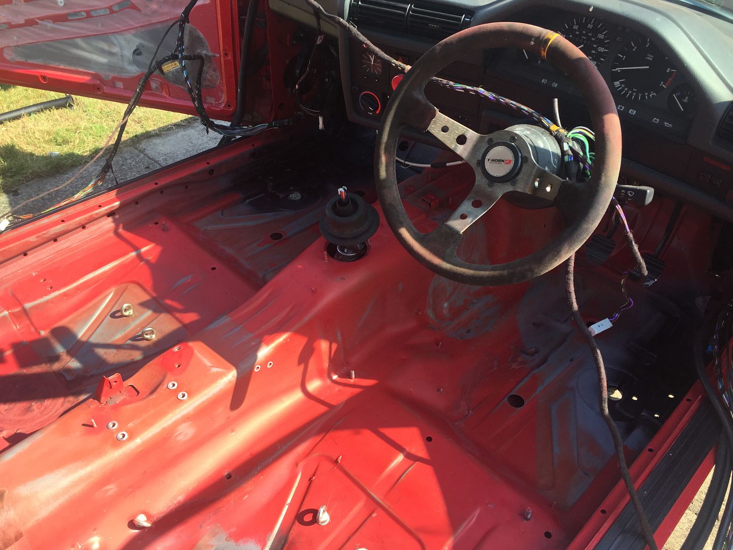

I have never sprayed the interior of this car before, but on my quest to make it a more presentable road/track car I thought that it would be a perfect opportunity to do it now.
So I spent two days rubbing down the inside of the car with red scotchbrite pads to get it looking like this.
Ordered some colour matched BMW 308 brilliantred paint and sprayed the inside of the car.
The interior was all refitted carefully and necessary parts tidied up along the way. Also fit my DTM steering wheel.
That got us up to this point and I was quite happy with the results;

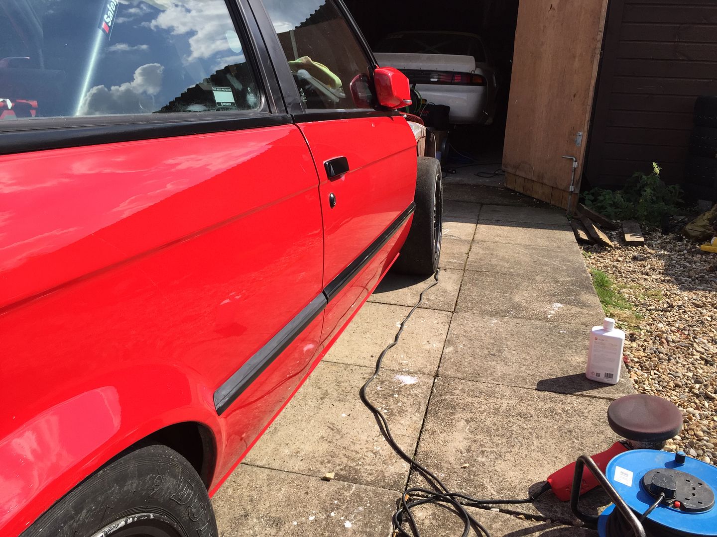

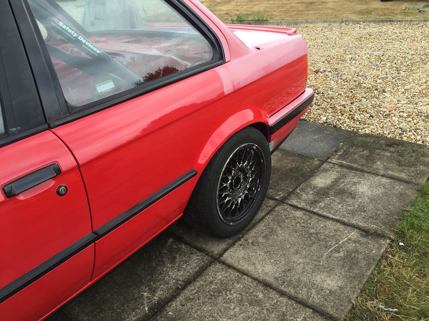

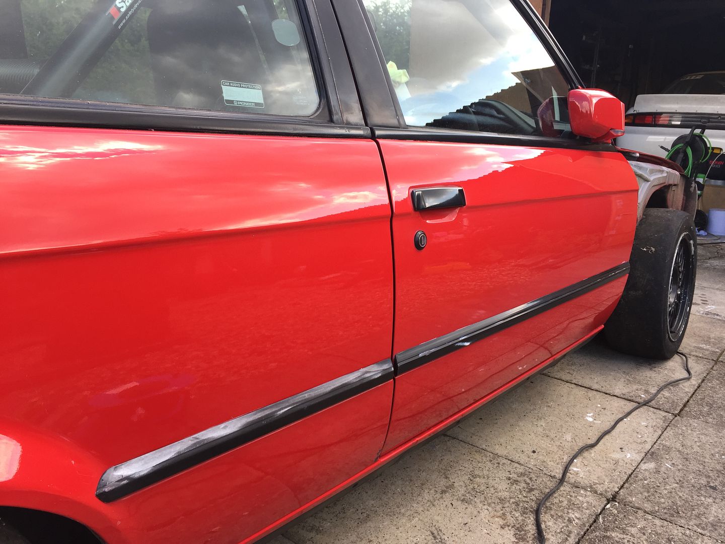

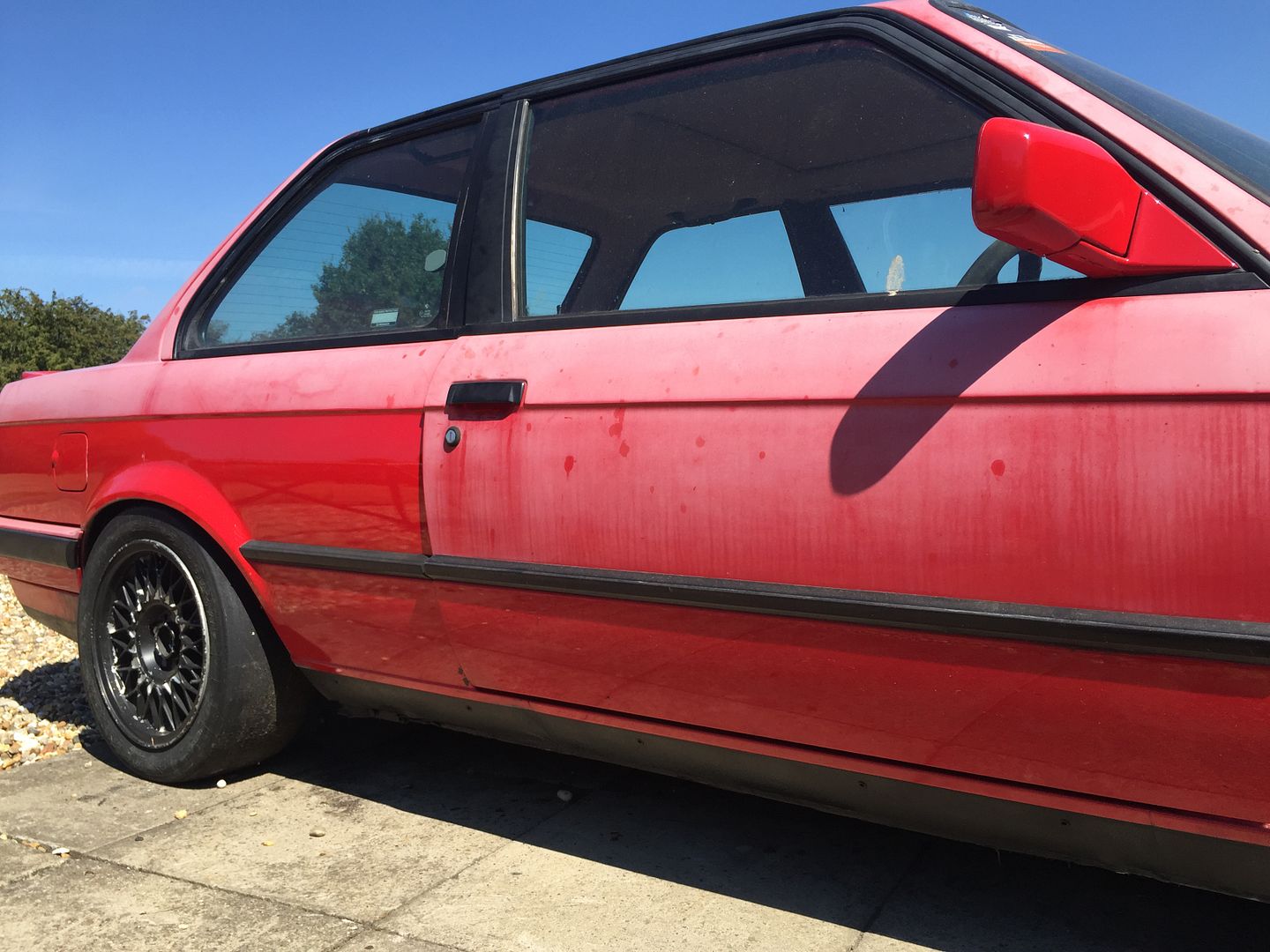

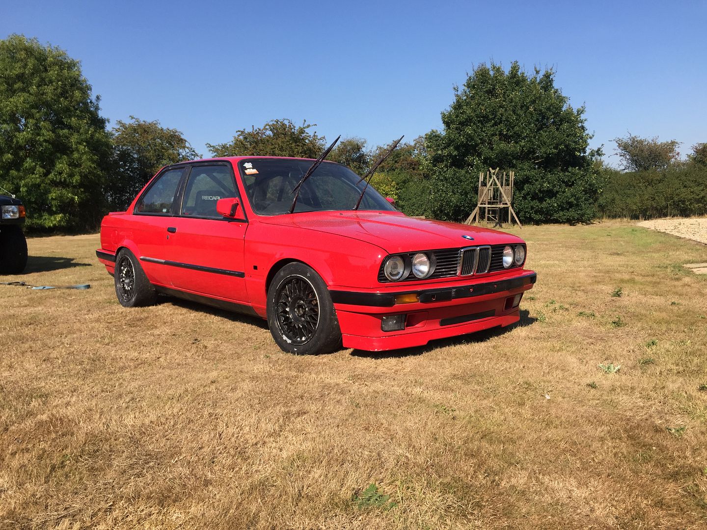

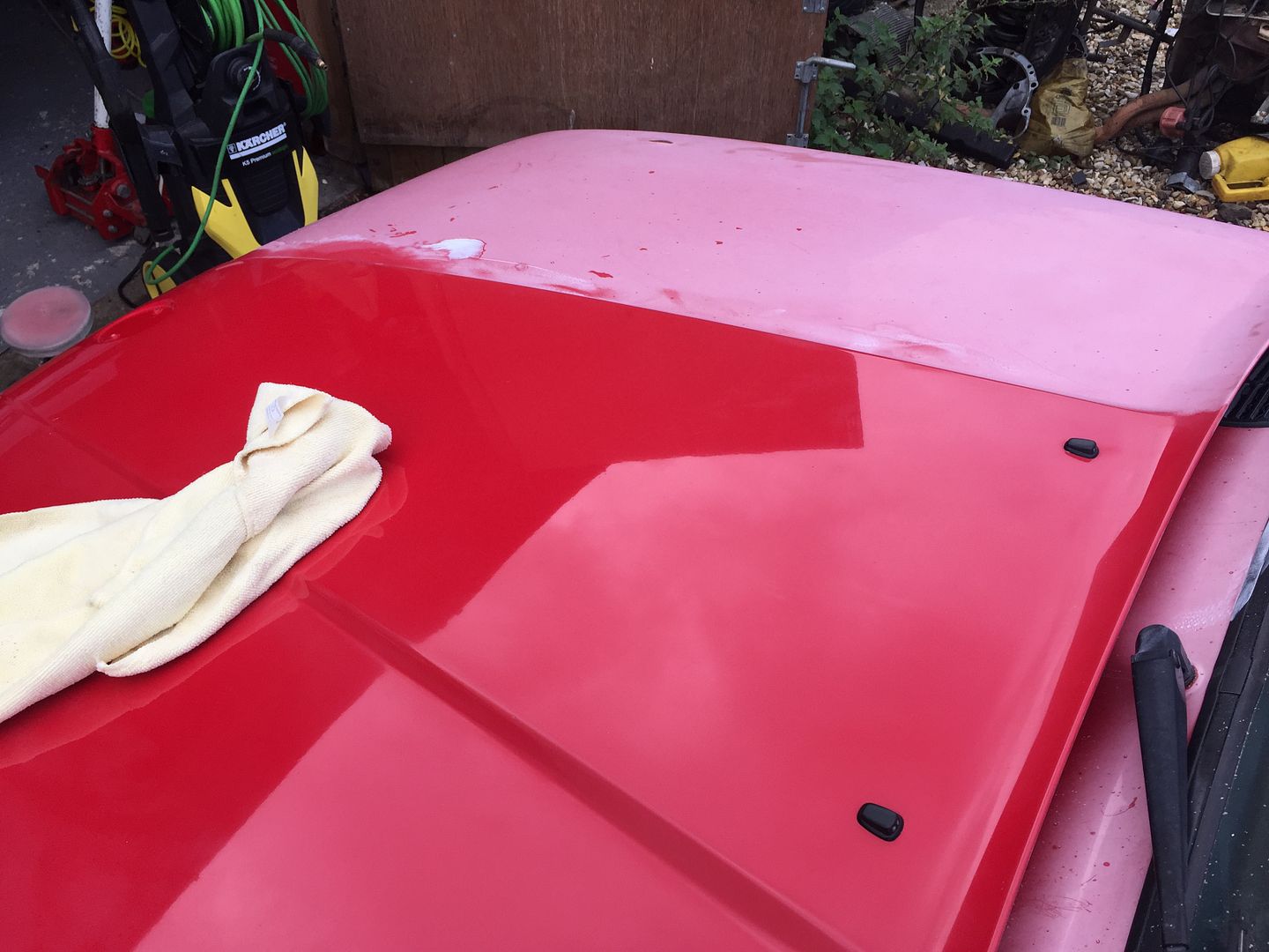

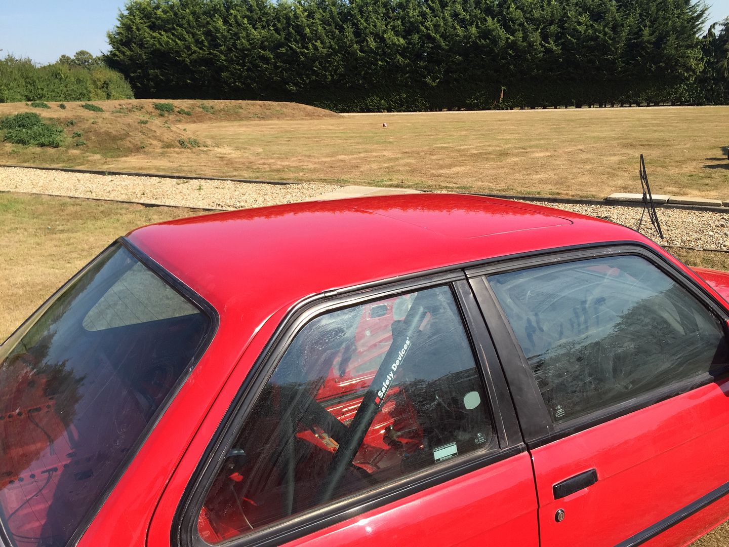

With the interior nearly sorted I set my attention to rectifying the badly faded paint. The paint was beyond saving with a simple hand polish. So with some advice I bought a 3M fast cut cutting compound with the 3M green compound pad and DA polished the whole car. This took 3 full days but I am more than happy with the results.
After cutting with the 3M fast cut, I used Autoglym super resin polish on a softer pad and then used a good few coats of Mer wax.

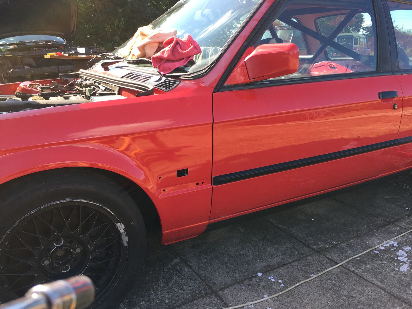

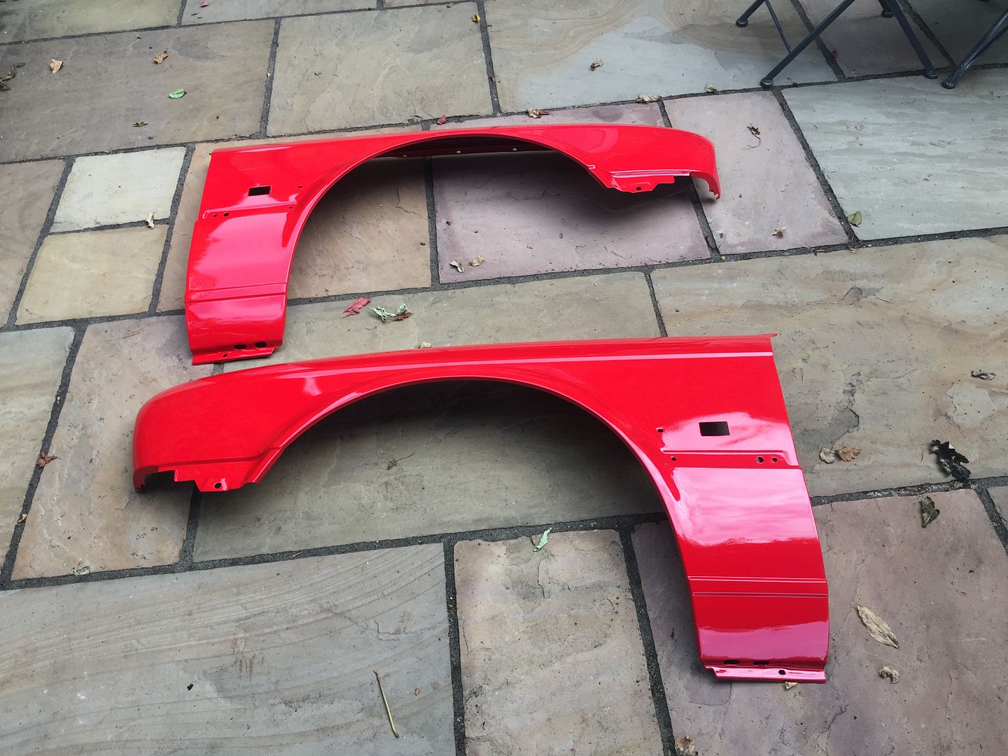

I also fit new front wings and again, was pretty happy with the colour match.
And that's where we're up to now with the car. I only have a few small jobs remaining here and there to get it completely up to scratch. Unfortunately I don't have as much time to work on the car as my holidays are over, but I hope to get these done fairly quickly as they aren't long/complicated jobs.
