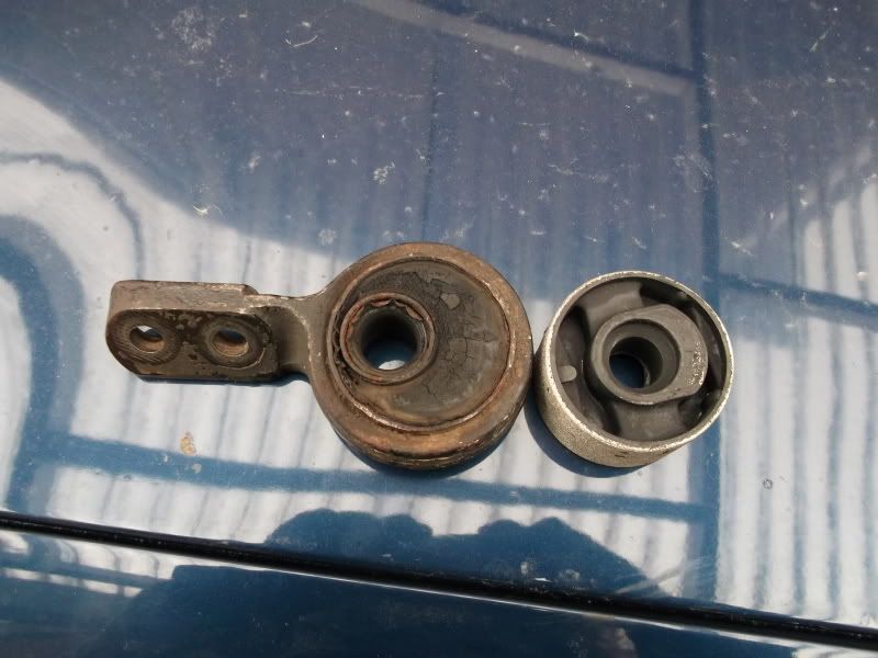

maxfield wrote:The bushes should be pressed so the hole is as close to the centre of the car. The should be in line with the 'stick' of the lollipop.
The hole in the bush should be fitted outwards, so it brings the wishbone out and the wheel forward
Good thing you don't work on cars for a living....

Cheers Dan, have fitted them this way. Well tomorrow is the day to remove the whole backend underneath the new car and replace with cleaned and painted parts with all new bushes. Hopefully it will go smoothly lol

Sorry my bad. Was meant to be worded different but didn't re read it.

No worries mate, as it happens i hadnt seen the other replies before fitting them. Luckily i somehow fitted them the opposite to how you suggested anyway lol

Well what a day! The new backend has been built on the floor, this took a while on its own. The welded tabs on the subframe seem to offer some good adjustment and trailing arms appear to be moving freely with the powerflex bushes which is great.
Hours, have been spent this afternoon and evening removing the old backend from the car, the main subframe bushes that attach to the chassis were absolutely welded on. We have some fantastic equipment on hand but even then it was still a pig of a job! But, it is now off.

Lemforder control arms with new ball joints and M3 eccentric bushes
Subframe with drums replaced. New subframe bushes, powerflex control arm bushes, welded tabs to offer toe and camber adjustment, Pagid discs and new disc shields, Greenstuff pads (as they came with the other car and were in good condition), rebuilt S 4.10 LSD with new bush, Eibach anti-roll bar, handbrake cables run through the car and everything freshly painted :)
