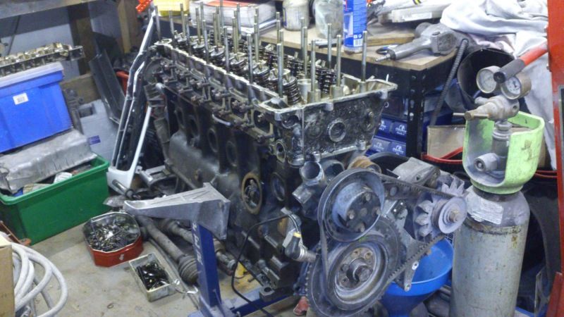

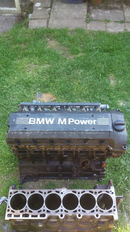

So the start of the plan, I had to decide what head I was going to use to hybrid with an M20. Obvious choice here is an early M50, non vanos. I did a bit of reading, took a few measurements from a spare head at a friends workshop, and decided it would basically bolt onto the M20 block fine, and a decent amount of the oil/waterways would line up. However there was alot of random drain holes at the back of the head that looked like they could cause issues, and require alot of work having externals drains fitted. In any case it was certainly do-able. My concern was either an M50 or 52 head would maybe need some work in the ports to get the sort of figures I was after.
Then was measuring up some things in the workshop one day, and noticed the S50B30 throttle bodies I have sitting on the bench. Immediately wondered if that head would be suitable, as it would be a far better candidate with the fact it runs on a much larger capacity engine so probably had the flow right out the box to support my needs. Again more pictures were looked at, pages of text poured over, and wat do you know- the S50 heads are actually a better fit on an M20 block than an M50/52 would be! Pretty much all the oil and waterways line up exactly, to the point where I could even use an M20 head gasket. This was a major breakthrough, and pretty much cemented the plan to go ahead with this.
The next issue was going to be the real meat of this project though. An M20 is cambelt driven as I'm sure you are all aware. An S50 is chain driven, so either the block or the head was going to have to be converted to run one or the other. After much thought, my father suggested the best thing to do was get an entire S50 engine, and then I could physically see what was going to work and what wasn't. I also had an idea that I could use the S50B30 pistons too, as the series rules I was building to allowed me to go anything up to 400cc over the cars original capacity, and still stay within the class I was aiming for.
So I decided to sell my freshly bored M20B20 block, and get hold of a B25 block so I could safely go out to 86mm. Byron (Maggspower) bought the block and now redundant 12v head, and was kind enough to donate an ETA block free of charge once I explained what I was trying to do. I'm assuming pity was involved in this, as he is well aware of the size of the task I am undertaking! :D 8O
With that sorted I put a wanted up on here for an S50, and within an afternoon I had something sorted! Ajay had a pretty much complete but nut and bolt stripped S50B30 engine in one of his lockups, all it was missing was an oil filter housing (didn't think I would need this), and the throttle bodies (have some already). Super helpful and friendly guy, ran up to his place in the city one Saturday and I had an S50 in my possession!
S50 head dumped on M20 block (had to be done winkeye ):
Now the real benefits of buying a complete engine would become apparent, as I had a S50 block to measure up and compare to the M20, as I attempted to fit everything in....

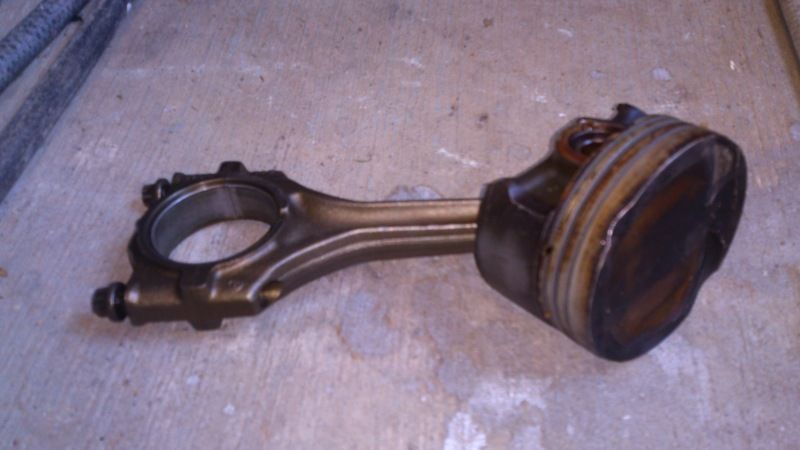

Measuring up started! I wanted to start from the ground up, so stuck the M20 and S50 blocks side by side and measured their height. From rough measuring, the S50 block was 276mm tall overall, which is 10mm more than an M20. However it appeared that the crank centreline to deck measurement didnt run quite true to this, as the S50 was 216mm, and the M20 ETA 205.5mm. Again all of these are rough measurements, but it gives me a decent idea and meant I could start working out compression ratios with an S50 head and pistons when they are only compressing just over 2.5l of charge rather than 3l. I really wanted to use the 140mm M52 rods I have with the 75mm M20 crank, as it gives a really very nice rod/stroke ratio. I was concerned they just physically weren't going to fit into the shorter block with the S50 pistons though.
Here is an M52 rod fitted with an S50 piston.
The little ends are 1mm smaller in the S50 pistons, so I would have to get the rods re-bushed if I was to use them. Obviously I will need to add on 0.5mm to any crown height measurements before this is done to account for the slack when its in the bore! The M52 rods are a very nice lightweight design, and these are the non cracked big end type, so have a uniform mating surface and positive locating dowels for the caps like the M20 rods do.
Anyway after a bit of measuring using the piston and rod in the S50 block with an M20 crank (obviously doesn't fit in the M20 block at the moment as the bore isnt big enough!), and transferring the measurements over, I was really very happy to see it would all fit, albeit with a gasket thats about 1mm thicker than standard (2.7mm roughly). What I didnt realise before I had a set sitting in front of me is that the S50 rods are 142mm, id assumed they would be the general standard 135mm that BMW seem to like! I also didnt realise they had a 5mm bigger big end than an M20/50/52- so running S50 rods requires an S50 crank! Obviously no immediate bother to me, but it does allow some interesting future developments with regard to capacity though (offset ground understroked S50 crank...?! :cool: ).
This pretty much made my mind up on pistons and rods- S50 pistons and M52 rods. The pistons will need some work, as the engine will 'only' be displacing 2,619.02cc with an 86mm bore and 75mm stroke, so will need to intrude into the combustion chambers to reach my target compression ratio of 12:1. I will leave the details of this alone for now, as I have more fundamental parts of the build to decide on. Suffice to say I'm happy its do-able with modified standard S50 pistons though.

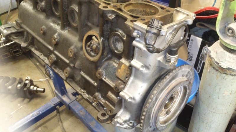

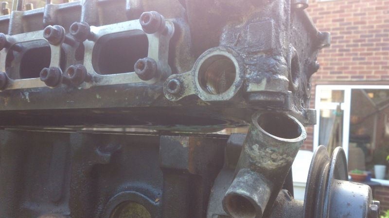

Ok, so the head issue. An M20 has a cambelt, an S50 has a cam chain, but more importantly the cam pulleys and chain are in an integral casing which shares oil with the head, and drains back to the block. After a quick look/think, I was 75% sure I wanted to convert the head to run a cambelt, but as I had all the necessary parts for the cam chain too, thought it would be silly not to mock that up and see how it went.
Firstly I fitted an M52B25 crank I have, which has the longer nose to house the front oil/chain casing. Then fitted the front case up. Straight away it was obvious every bolt hole would need redrilling, and that the case itself would have to be slimmed down to fit the M20 block, which is fundamentally a different shape due to different locations for the oil and water pumps. The water pump I knew would have to be moved, however it became apparent that the oil pump too would not be able to stay in the original M20 position. The casing covered half of the drive stub, and even if this was modified, it then ran slap bang into the location of one of the chain tensioners. Add to this the need for a totally different sump to the baffled one I already had for an M20, aswell as having to make all the mounting posts for the chain guides and tensioners, as well as the fact that the head would still need to be slightly modified to work with the M20 block- it was a no go. I did think maybe it was more of an option right up until the need for external oil and water pumps became apparent!
So that idea was out, sort of a shame as the cambelt option was do-able, but required me to take some extra strength bravery pills with one particular part...
Onto the cambelt option! First I mocked up the block with all the basic parts an M20 would have on it. So M20 crank, front cover, oil pump sprocket, alternator, cam tensioner, crank sensor etc. First issue was the water pump catching the head:
This was a minor issue as you will see. Basically to fit cam pulleys I was going to have to perform MAJOR surgery to the front of the head. At the moment its integral with all the oil galleries in the head itself as part of the large front casting which houses the cam gears and the Vanos bridge etc. So this needed sealing off. My plan was basically to cut the front casting off of the head, and then machine a bolt of 'motor plate' for the front of the head. This plate would seal off the front of the head, house an oil drain back to the sump, and have 2 cam seals in it which would pick up on the 6 bolt Vanos hub mountings.
I did ALOT of measuring to make sure what I was about to do was going to be able to work! Then went from this:
To this:
So thats me committing to that then! Now I had room for the head to miss the waterpump which was great, and also room to fit cam pulleys. My plan with these had always been to use 2 M20 vernier pulleys, and then find a suitable belt/tensioner/idler setup. However a problem became immediately apparent with that too. An M20 cam pulley is 124mm in diameter, and the S50 cam jounals are only 118mm apart centre to centre- so the pulleys wouldn't fit side by side! This meant I realistically needed to find a pair of pulleys which were no wider than 115mm to give me clearance. I soon found something closer to home than I thought:

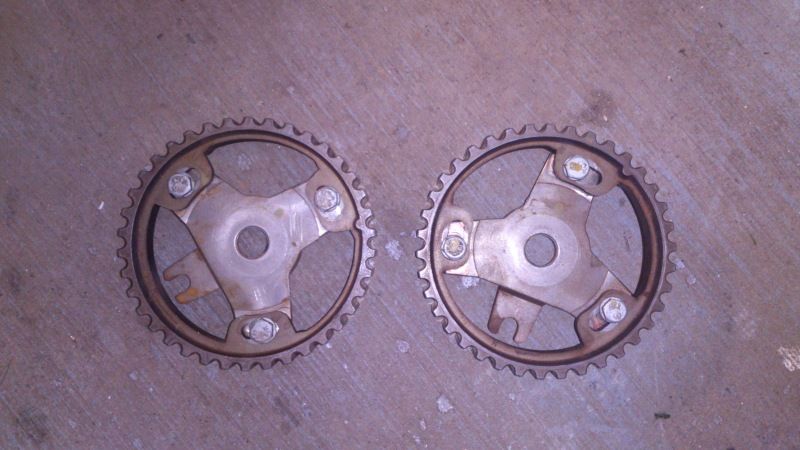

These are a standard pair of cam pulleys from a Peugeot 106 Gti/Saxo VTS. They are 113.7mm OD, so will fit easily side by side on the S50 head, and as an added bonus they are a standard 3 bolt vernier pulley, something that is quite common on PSA group engines of this era.
This means I will need to get the crank pulley machined down so it has an OD of 56.85mm. I considered getting a 106 Gti one of those to fit, but the M20 one has the hub on it for the timing ring/alternator pulley integral with it, so its going to be far easier to get a machine shop with gear cutting capabilities to just machine the M20 one down.
Next I could start to realistically look at the cambelt routing. The first thing that became apparent is the water pump is massive, and right in the way! To get a belt on with the standard M20 waterpump in place, it was going to have to follow the standard M20 route, but just be longer to accommodate 2 cams. I didnt much like this idea, as it left no room for an idler pulley (just the standard M20 belt tensioner), and it meant the belt entered the exhaust pulley at a very steep angle, and would have been wrapped around very little of the inlet pulley before it diverted off to the oil pump pulley. So the standard waterpump will be deleted, and an electric pump remotely fitted instead. This gives me a ton of room to fit a proper idler and tensioner, and means I can run the belt up the exhaust side of the block to the exhaust cam pulley. It also gives room to fit a better oil drain to the front plate of the head. I will control the water pump via a proper controller, so will have no need for a thermostat. This solves a small problem in itself, as the thermostat housing for the S50 head mates up to the S50 waterpump- so is completely useless for me! I had been considering just running without a thermostat full stop which I wasn't too keen on.
So that was the next piece of the puzzle in place, and maybe the biggest issue tackled to the point where I knew where I was going. Next up was mounting the cam pulleys on the correct centreline with the crank pulley, and making adaptors to fit them to the S50 cams without modification... Oh and the one small but major difference between the mating of an M20 block and an S50 head....

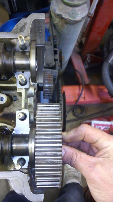

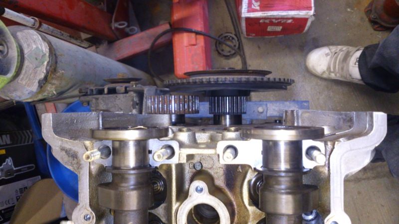

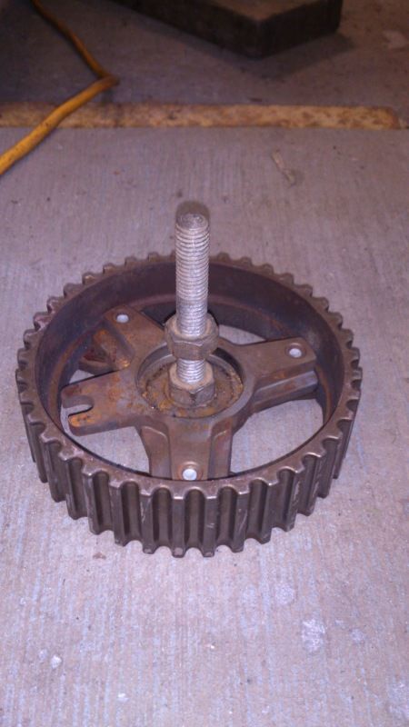

So onto the next stage, and what I had decided was the first part that needed to be finalised and machined so I could lead onto everything else. The cam pulleys needed an adaptor made to convert from the 6 bolt flange on the S50 cams to a single bolt hub on the 106 pulleys. I was keen to keep the cams unmodified, mainly because if I end up buying a set of expensive aftermarket S50 cams, I dont want to start machining them so they only fit in this engine, it leaves me free to sell them on if I need to. Also the 6 bolt hub will act as a good register for an oil seal in the front plate for the head.
Firstly I needed to find some way of solidly holding the pulleys so I could accurately measure and make sure they were in line with the crank/oil pump pulley.
Came up with this, the bolt slots nicely into the drilling in the exhaust cam, then used the nut as a stop and adjuster so I could hold the pulley in a solid position to measure.
This was the correct position. Measured it off of the oil pump pulley which was 1mm narrower than the cam pulley, so using a long straight edge held against the outside of the oil pump pulley, I needed 0.5mm overlap onto the cam pulley. After subtracting the depth of the small depression in the centre of the cam so the measurement was effectively taken from the hub face, I ended up needing an 18.2mm spacer. Just big enough to have the centre bolt hole blind, as the cams are oil fed and I dont want oil leaking out the centre of the cam pulleys!
Anyway these measurements are now with my machinist, along with a cam and pulley so he can make 2 up. Hes going to do the bolting face for the cam at the same diameter as the cam is to give a wider seat for the oil seal. Once these are back and the crank pulley is turned down I can decide on a cambelt, and then design the front plate for the head.

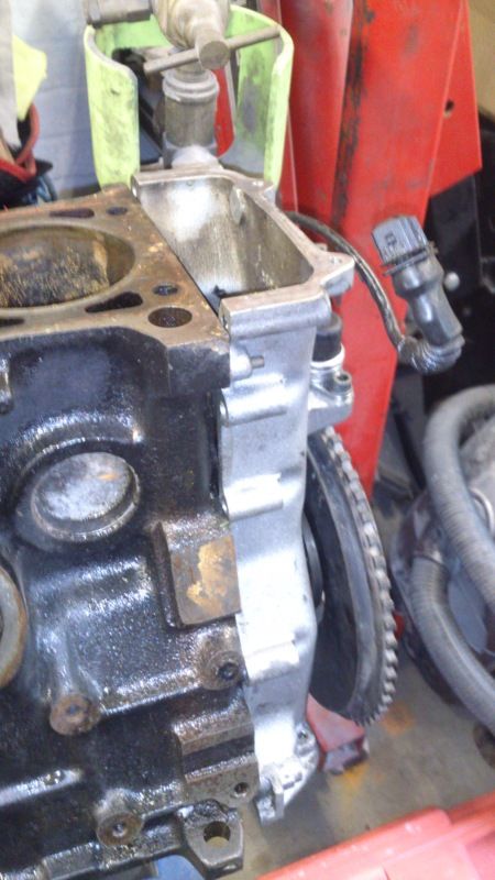

Now onto the sneaky little problem with fitting the head to the block. Apart from having to slightly eek out some of the oil drain holes in the head which will be half shaded by the M20 head gasket, the blocks are pretty much identical with regard to waterways etc. However the pressure oil feed, which comes up through the S50 block into the centre of the head is different! The feed itself is the same shape etc as the M20 one, but it comes up through the block on the inlet side, where its on the exhaust (ie oil filter) side of the M20. This means I am going to have to do an external drilling on the block, and run oil pipes up to the head to tap into the oil supply galleries.
At first I thought this would be a slight headache, but now I think I have identified that the oil is supplied to the S50 head through 2 gallery rails which run front to back. Handily these galleries have external grub screws which can be removed, presumably giving access for the head to be thoroughly cleaned. So my plan is to tap into either the block to pick up the standard oil feed to the head or maybe the oil cooler sandwich plate, then feed both of these oil galleries from the rear of the head. I am aware that the S50 has a problem with retaining oil in some way when its on track which can make it smoke a bit, but I plan to look at this in full once the basics of the engine being bolted together are sorted. Obviously I will have key differences to a full S50, different oil pump, no oil spray bars under the pistons, no front gallery on the head etc. Plus I also have the option to use the big M20 oil drain on the inlet side of the block if need be.
Anyway, thats me pretty much up to date now, more will follow once I have the cam spacers back.
