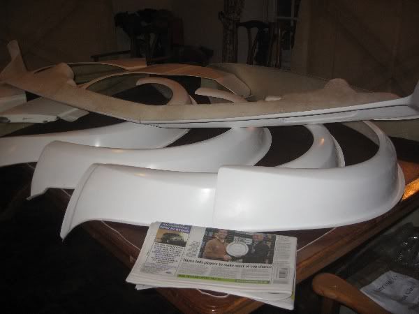

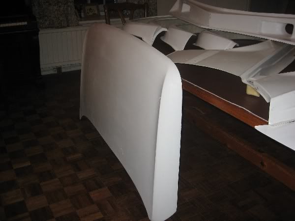

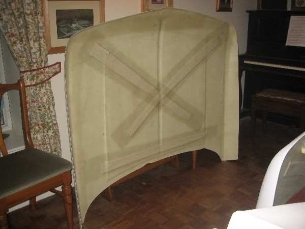

Ordered M3 arch kit today, from the good folks at Pesch Motorsport. I only got the arches & side skirts though, as I'm not looking to pretend it's an M3. I just think the box arches look better than the alternatives on an e30.
http://translate.google.co.uk/translate ... md%3Dimvns
Kind of look I want, although sticking with satin finish.

Cool, how are you going to join the rear arches. Are they fibreglass?
Are the arches going to be tubbed also?

I think it's Polish but the cost for both front wings, both rear quarters and the side skirts was £340 delivered to the UK. The quality of their stuff is very high too.

If it is Polish Zloty, a fibreglass bootlid is coming in at nearly £400
Also they are the exact pictures that ABS motorsport use. You sure they are legit?

I must have the currency wrong then, as the whole kit is about that price. The bootlid is less than the front wings, which were £145 a pair.
Yes, they're definitely legit - I think Duracell (with the yellow race e21 who's on here) bought the group2 tii kit they list) A few other people I know of used them too.
Czech Republic I think?

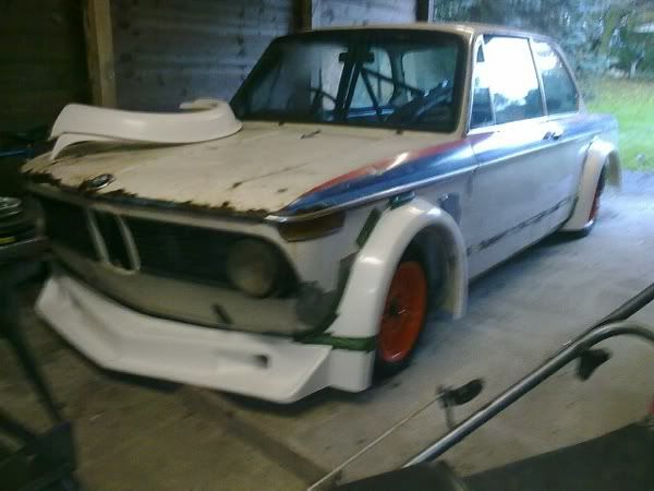

We bought a few panels. Very thin and lightweight, pretty good fit as well.Hoobs wrote:I must have the currency wrong then, as the whole kit is about that price. The bootlid is less than the front wings, which were £145 a pair.
