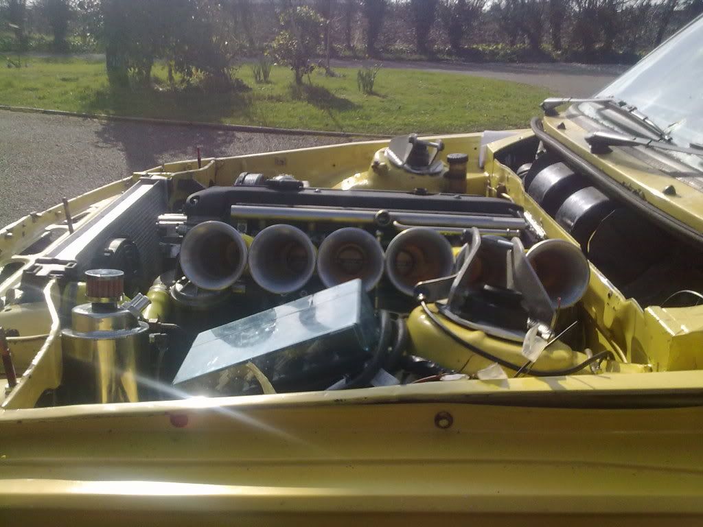

I do want to fit something, its just finding any socks that fit over these huge trumpets, they are about 100mm OD at the mouth and taper down to 55mm over about 120mm.
I think the plan will be a mesh plenum box to stop anything big getting through and causing a major failure. Untill I get some socks I'll need to live with a higher wear rate from the smaller particles that get through. At least we're not in Bahrain with sandstorms going through an engine.

Welded diff should be no prob other than in the wet it will push on a bit, and hairpins will be a bit of an issue.
I'm more concerned about the way the trumpets are joined with those joiners, I expect there is a step there which isn't great.
duracel79
Posts: 106
Location: Stevenage
Wed Apr 25, 2012 8:09 pm
Karan wrote:Lovely car.
Not the best picture but theres virtually no step inside

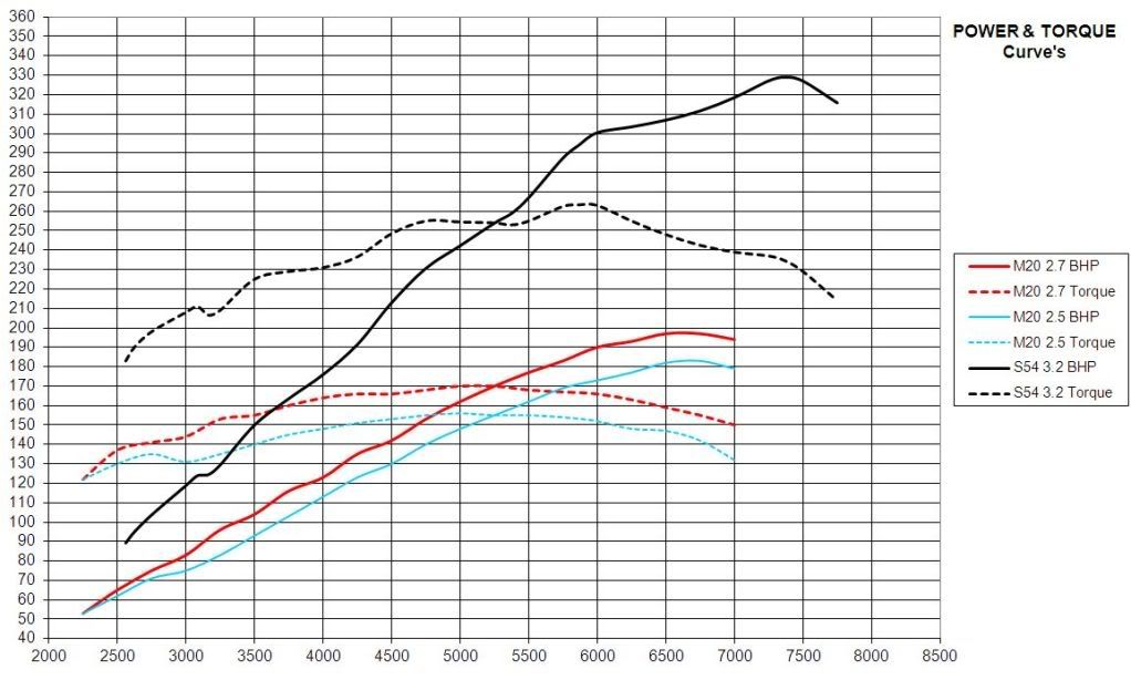

These are the power charts from Emerald's RR for my old 2.7 and 2.5 M20's compared to the new S54:
Bear in mind Emerald's RR is very accurate and doesn't overestimate as much as some others (Evolve charted the 2.7 as +6% on these figures).
Best to just look at the increases from the other runs.
Comparison with a very fast S50B32 M Coupe with Schrick Race Cams, VANOS delete and every possible bolt on (Exhaust/intake etc)

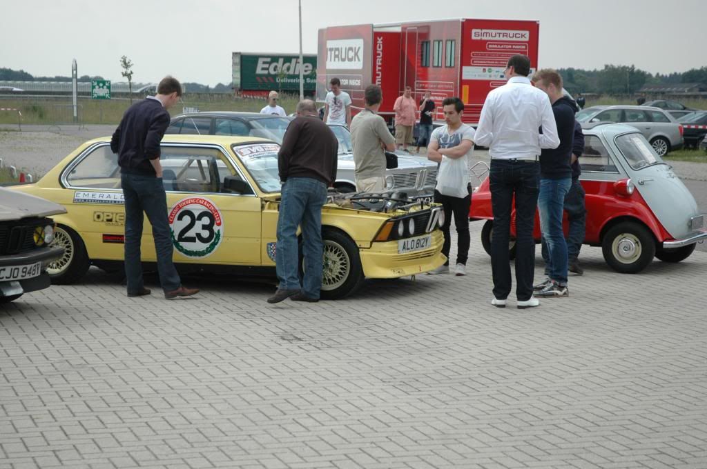

July 2012 at Santa Pod ran a 12.7s quarter @ 111mph

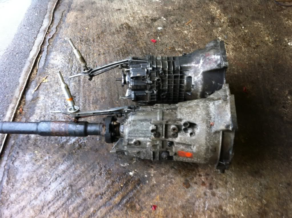

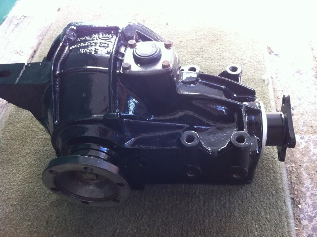

After two E30 Getrag 260 gearbox's died/broke, I upgraded to an E36 328i ZF box:
LSD unit was sourced from an E9 CSL in 3.25 ratio to suit the gearbox. Rebuild by Gareth with better ramp angles.

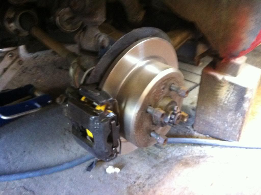

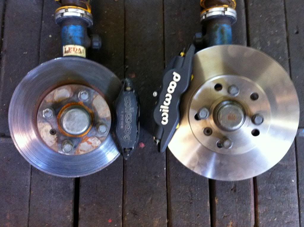

Brakes were also found wanting so upgrade time again:

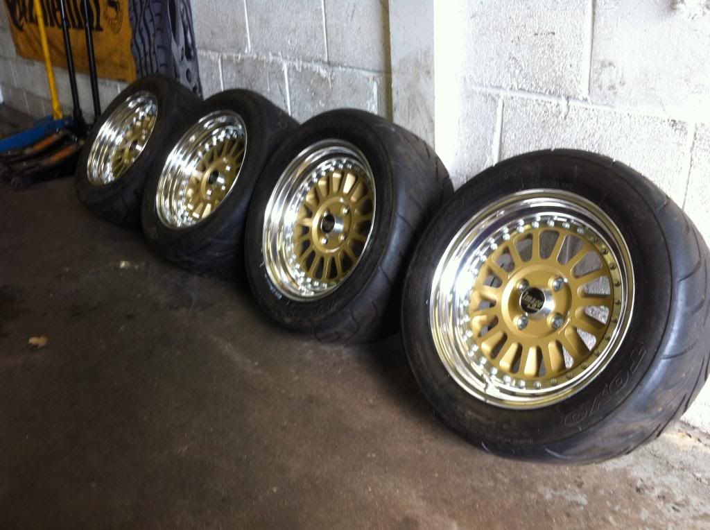

Wheels wouldn't fit over the new brakes so splashed out on a new set of Image rims
Old wheels vs New wheels - makes an amazing difference to tha car.
Electric E24 speedo fitted with external diff chopper wheel on driveshaft - and its reasonably accurate (within 10%)
Then went on a little 2500 mile trip round Europe and the Alps

gareth wrote:Aaah, I saw this at the Raw/Ergen track day in March but never twigged who's it was!
How's the diff?
Hi Gareth,
Diff was ok then Half way round Europe it stopped locking up.
When I checked it out back in the UK it was the teeth had sheared on the friction discs (Didn't think this would happen before any slip). My guess is they were just old original ones that the surface was still very good when you did the rebuild. Bit like new old stock parts that had gone brittle. My car was heavily loaded up with spares/tools/camping etc. and all those hairpins was putting too much load through the diff. i suppose an S54 doesn't help either.
Anyway I got some new discs and dog plates from Driveand traction, gave the diff a flush and put it all back together with fresh oil. Used the running in procedure detailed on Hardeman Motorsports pages. Not had any issues with it since and it locks up nicely again.

gareth wrote:Wow, not see that happen before! 8O S54's are brutal though!
Did you get away without any damage from the sheared teeth?
Hopefully I've got away with it. I carefully flushed all the bits of metal out of the diff and LSD, also cleaned all the bearings.
