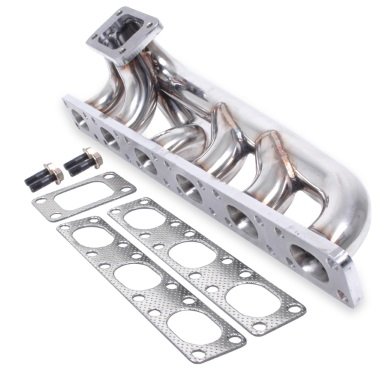

The plan is to get this lovely cheap ass manifold off ebay
and a HX35-W 12cm housing turbo

Pink injectors are only good for 240hp ish and management for £250 ?
That would be my worry.

£250 for a standalone P'n'P ecu? thats a bit cheap.
might be worth looking into what make the ecu is, for that price i'd say it was a version of mega squirt.
contact them & see what they have to say about it.

I am sure the ECU is megasquit based but that doesn't seem too bad to me. I have seen M50s run reasonable power on megasquirt. What injectors would I need and how well will this work without a decompression plate?
steve_k
- Posts: 8044
i thought that ECU might be MS, just depends which version,
as for the injectors & decomp plate? not a clue sorry.
