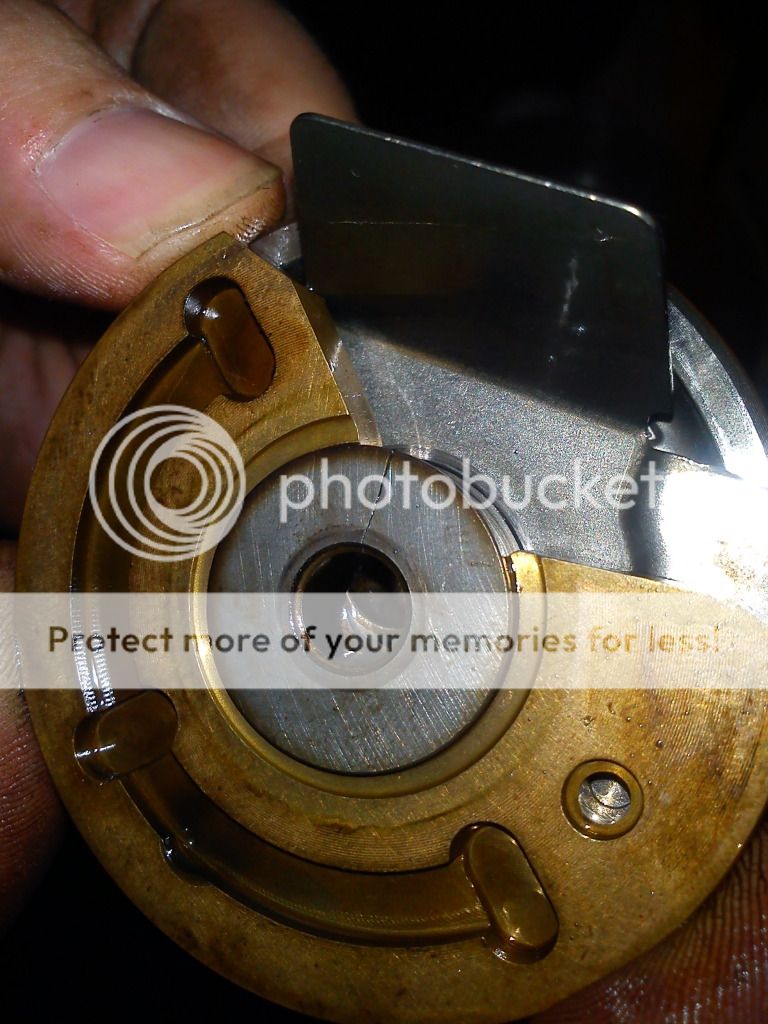

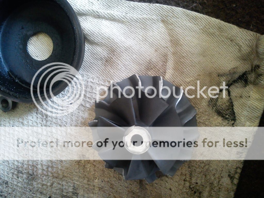

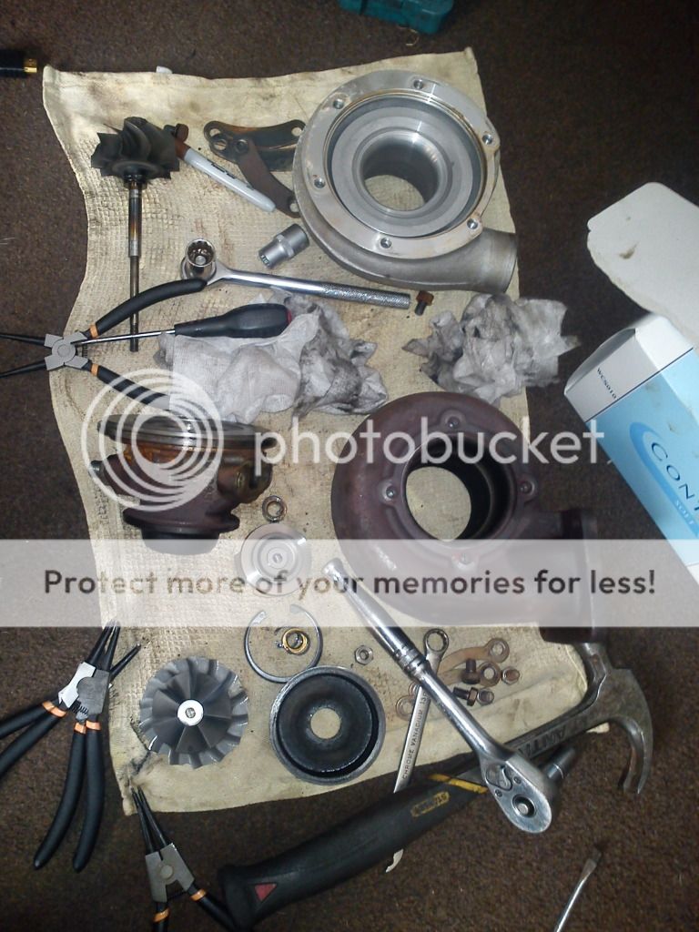

Post Wed Aug 27, 2014 5:27 pm
Well, in for a penny and all that.....
#sickasfuck

id be screwing
you should have some side to side play thats just the oil tolerence but that fook

I think i'm more shocked than anything else,
I thought it was just the oil seal that had blown, until i stripped it down :eek:
but your right, it's f u c k e d

i cant get over that crack 8O

I'm going to strip the engine to the bare bones, just to make sure there was nothing on that side that caused it,
But going on first looks,
The center bearing has cracked causing the excess movement, that's fooked everything else.
